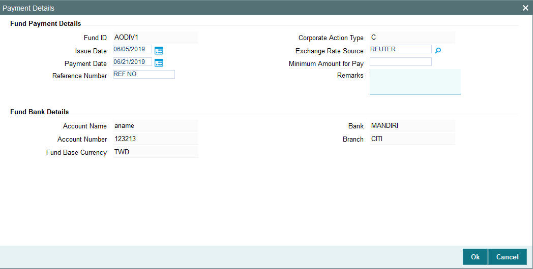

You can the reference number for the dividend payment in the Fund Dividend Payment screen, which you can access from the Process Dividend Payment screen by clicking the ‘Payment Details’ button.
The Dividend Payment Date
In the Fund Dividend Payment screen, the system defaults the payment date as follows:
Dividend Payment Date = Last dividend processed date + Dividend payment frequency + Payment lag, if any.
Here, the holiday rule specified for the fund and dividend type in the Corporate Actions profile is used to arrive at the payment date.

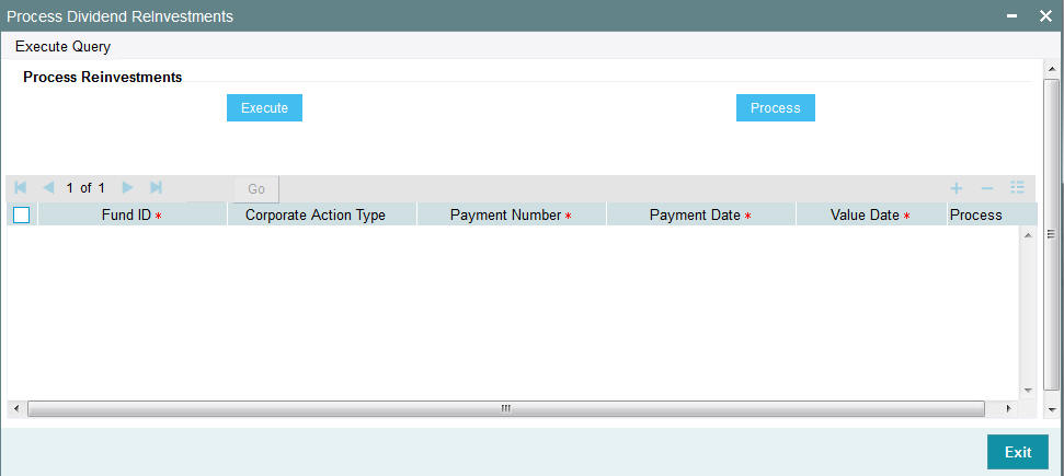

You can initiate the reinvestment transactions through the Process Reinvestments screen. You can access this screen from the Batch menu category in the Browser menu.
If a reinvestment lag has been specified for the fund and dividend type in the Corporate Actions profile, the initiation of the reinvestment transactions is deferred accordingly.
The End of Day processes will allocate the reinvestment transactions on the date of entry, using the prevalent price for subscriptions.

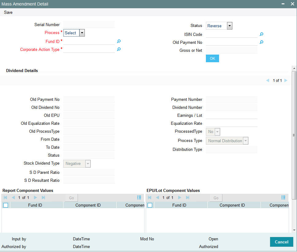

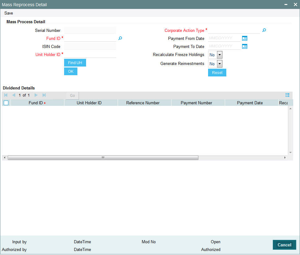

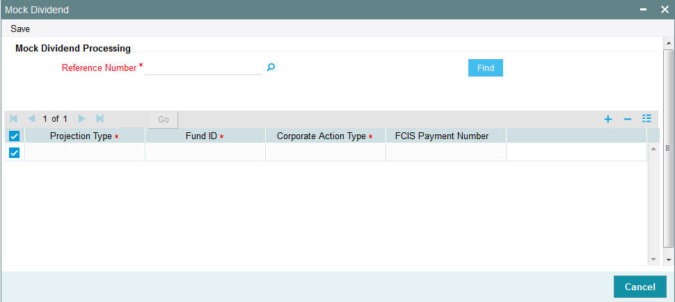

You can also perform Mock Dividend processing, Interim Dividend processing, Dividend Re-processing, Dividend Amendment and Reversal on the dividend paid out.

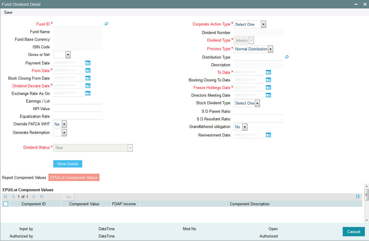

You can use this screen to maintain the dividend declaration details for a fund, for either a cash dividend or a stock dividend. This maintenance also supports the following:
Invoke the ‘Fund Dividend Detail’ screen by typing ‘UTDFUDIV’ in the field at the top right corner of the Application tool bar and clicking on the adjoining arrow button. The Fund Dividend Detail screen is displayed. Select ‘New’ from the Actions menu in the Application tool bar or click new icon to enter the details of the fund dividend.
Fund ID
Alphanumeric; 6 Characters; Mandatory
Select the Fund ID, for which the dividend is being set up, from the list provided. The list will display all the funds that have been authorized, along with their latest rule enabled. When you specify the ID of the fund, the ISIN Code of the fund is displayed in the ISIN Code field.
Fund Name
Display
The system displays the fund name for the selected fund ID.
Fund Base Currency
Display Only
After you select the Fund ID, the base currency for the selected fund is displayed in this field.
ISIN Code
Display
The system displays the ISIN Code of the selected fund.
Gross or Net
Optional
Select if the fund is Gross or Net from the drop-down list. The list displays the following values:
Payment Date
Date Format; Optional
Select the payment date from the adjoining calendar.
From Date
Date Format, Mandatory
The Dividend From Date is the start date of the period for which dividend is being declared. The system defaults this date based on the following criteria:
If overridden, the Dividend From Date should be equal to or later than the Dividend Start Period and equal to or earlier than the Dividend End Period.
To Date
The Dividend To Date is the end date of the period for which dividend is being declared.
The Dividend To Date should be later than the Dividend Start Period and earlier than the Dividend End Period. It should also be later than the Dividend From Date.
Book Closing From Date
Date Format, Mandatory ONLY if Book Closing To Date is specified.
The Book Closing From Date is the start date of the period during which the books of the fund are closed. Any transactions accepted during this period will be allotted only after the book-closing period is over.
If specified, the Book Closing From Date should be the same as or later than the Dividend To Date. It should also be the same as or later than the System Application Date.
Date Format; Mandatory ONLY if Book Closing From Date is specified.
The Book Closing To Date is the end date of the period during which the books of the fund are closed. If specified, it must be the same as or later than the Dividend To Date, and the Book Closing From Date.
Dividend Declare Date
Specify the date on which the dividend is to be declared.
The system defaults this date to be the same as the Dividend To Date. You can override it if necessary.
The Dividend Declare Date should be later than the Directors Meeting Date.
Exchange Rate as on
Date Format; Mandatory if Dividend Declare Date is specified.
This field is applicable only if the Exchange Rate Basis specified for the fund is Reference Date. In such a case, the exchange rate to be considered is the rate on the reference date specified here.
Earnings / LOT
Numeric, Mandatory if Dividend Declare Date and Exchange Rate As On are specified, and only for cash dividends.
Specify the Earnings per Unit per Lot, announced during dividend declaration, in the case of cash dividends.
You must specify this value only if the Earnings per Unit are not to be defined in terms of components, but as a single value. If the EPU is to be defined in terms of components, as specified in the Corporate Actions record for this fund and the System Parameters at the Agency Branch, this field is locked for data entry, and you must specify the EPU in terms of its components. To do so, click the EPU/LOT Component Values link to invoke the Fund Dividend Component screen, where you can specify the values for each component.
NPI Value
Numeric; 20 Characters; Optional
Specify the NPI value.
Equalization Rate
Numeric; 20 Characters; Mandatory for Dividend Equalization Funds
Specify the dividend equalization rate to be applied for the units that have not yet received any benefit (income or dividend) so far. You can input a value only if the fund for which you are maintaining dividend is a ‘Dividend Equalization Fund’. In case of other funds, the system will default null here and will not allow any change in the value.
Override FATCA WHT
Optional
Select if FATCA WHT for that particular dividend cycle has to be overwritten or not from the drop-down list. Following are the options available in the drop-down list:
Generate Redemption
Optional
Select if redemption should be generated or not for negative cash dividends from the drop-down list. The list displays the following values:
Corporate Action Type
Mandatory
Select the type of corporate action for which the dividend is being declared from the drop-down list. The list displays the following values:
Dividend Number
Numeric, Display
The serial number of the dividend being declared, generated by the system, is displayed. In generating this number, the dividend number of the last, most recent declaration is incremented by 1.
Dividend Type
Display Only
If the dividend being entered is part of the dividend cycle for the selected fund, it is a regular dividend. If it is an ad-hoc declaration, it is an interim dividend.
Process Type
Mandatory
Select the process type from the drop-down list. The list displays the following values:
By default, the Non Zero Distribution option is selected here, if you are entering a new dividend. If the dividend is to be skipped, select Skip. If Zero Distribution is selected, then the system processes the record with the Earnings per Unit (EPU) as ‘Zero’. Also, the income equalization field will be systemically set to zero. Dividend reversals are also enabled for the zero distribution process. This amendment process supports the following:
Distribution Type
Alphanumeric; 3 Characters; Optional
The system displays the following options based on the values maintained in the Corporate Action tab of the Fund Rule Maintenance screen:
The system validates whether the distribution type is of Corporate Action type ‘Cash’. The list of values are populated based on the fund maintenance, that is, if the fund has only dividend distribution type or two to three distribution types maintained, then the values are populated accordingly.
Description
Display
The system displays the description for the selected distribution type.
Freeze Holdings Date
The system defaults the freeze holdings date, from the specifications made in the Corporate Actions profile for the fund and corporate action type, as follows:
Freeze Holdings Date = Dividend Declare Date – Freeze Holdings Lead Time.
The Dividend Declare Date is also defaulted in this screen, to be the same as the Dividend To Date.
You can override this default date if necessary. When you override the default date, you can specify a past date if necessary. (i.e., earlier than the application date),
Date Format, Optional
The Directors’ Meeting Date is the day after the Book Closing To Date. It is during the directors’ meeting that the dividend is declared. This date must be earlier than the next date on which a regular dividend is due for processing, for the fund and corporate action type.
The system displays the application date in this field, by default. You can override it, if necessary.
Stock Dividend Type
Optional
Select the type of stock dividend from the drop-down list. Following are the options available in the drop-down list:
This field is mandatory if the dividend type is stock dividend.
Whenever a negative stock dividend is declared a redemption transaction should be passed at current NAV/TXNBP 03 based on maintenance. The number of units that has to be redeemed will depend on the negative stock dividend ratio.
S D Parent Ratio
Numeric; 22 Characters; Mandatory for stock dividends
For stock dividends, specify the stock dividend ratio that is to be applicable for the dividend declaration.
This field is the parent, which represents the units eligible for dividend in the ratio.
S D Resultant Ratio
This field is the resultant, which represents the number of units that is gained by the unit holder as dividend for the specified number of parent units eligible for dividend.
For instance, if you specify 2 in the S D Parent Ratio field and 1 in the S D Resultant Ratio, then, for every two units eligible for dividend, the unit holder receives one unit as dividend.
Grandfathered obligation
Optional
Select to mark the dividend as grandfathered obligation from the drop-down list. Following are the options available in the drop-down list:
If you select Yes, then the WHT will not be applicable.
Reinvestment Date
Select the reinvestment date from the adjoining calendar.
Dividend Status
Display Only
The system displays the status of the dividend, based on the status of the fund. The dividend could be a new one, or the fund could be in its book-closing period, or after the directors meeting. This information is displayed here by the system.
Click ‘Show Details’ button to view the fund dividend details.
You can view report component values by clicking ‘Report Component Values’ tab in ‘Fund Dividend Detail’ screen.
You can view the following report component details:
You can use this screen to specify the values for each component in the Earnings per Unit/Lot, which are to be applicable for the cash dividend declaration. You can access it by clicking the ‘EPU/Lot Component Values’ tab in the Fund Dividend Detail screen. This link is only available if the EPU is designated as defined in terms of components, in the Corporate Actions profile defined for the fund and the corporate action type.
You can view the following EPU/Lot Component details
The system performs a sum of all the EPU component values that have been entered. If the sum is a negative value, an error message is displayed, and you must alter the values till a positive sum is obtained. Once this is done, the Fund Dividend Component Screen is closed, and the sum so obtained is populated in the Earnings Per Unit/LOT field.
If the EPU for the dividend is captured as negative value, then the system will calculate the dividend amount as negative.
While processing the dividend payment, if system finds out the negative payment amount, then system will generate a redemption transaction with the transaction amount same as the negative dividend amount. For instance, if the dividend amount is 1000 in USD then the transaction amount 1000 in USD.
Note
The Earnings Per Unit should always be greater than zero. Negative EPU components can be specified only if your installation has specifically requested for this feature. An exhaustive note on negative EPU components is found in the Annexure.
In the case of dividends that are declared according the dividend cycle and the declaration frequency, the system generates the dividend record for declaration during the Beginning of Day process on the next dividend date.
To maintain the details for this record, you must:
In the case of dividends that are declared apart from the normal dividend cycle and declaration frequency, you can maintain the details through the Fund Dividend Maintenance (Detail) screen.
To maintain details of declaration for a cash dividend for a fund in this screen,
For an interim dividend, only the fund base currency, dividend status, dividend number, dividend type (interim) and the Dividend From Date are defaulted.
For Zero Distribution of Funds, you can select ‘Zero Distribution’ in the Process Type field. Once this value is selected, the system processes the record with EPU as Zero.

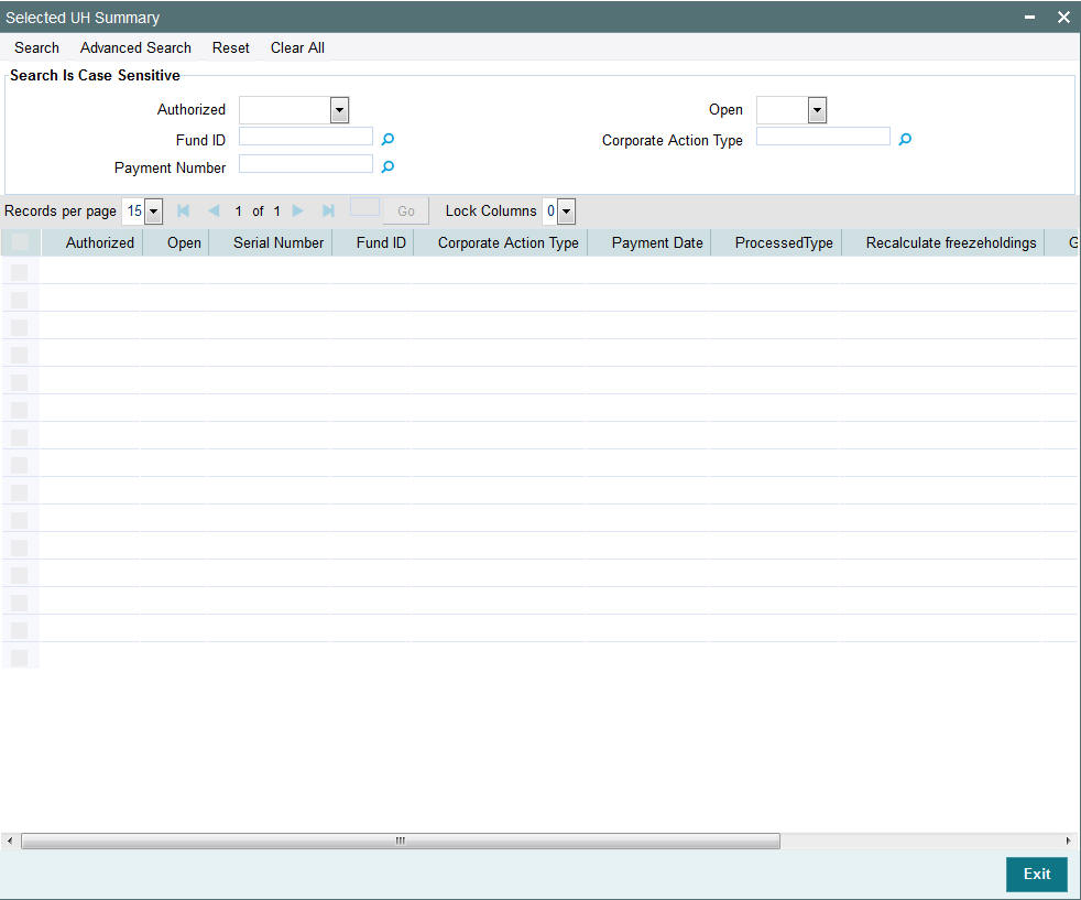

You can retrieve a previously entered record in the Summary Screen, as follows:
Specify any or all of the following details in the corresponding details.
Click ‘Search’ button to view the records. All the records with the specified details are retrieved and displayed in the lower portion of the screen.
Note
You can also retrieve the individual record detail from the detail screen by querying in the following manner:
You can perform Edit, Delete, Amend, Authorize, Reverse, Confirm operations by selecting the operation from the Action list. You can also search a record by using a combination of % and alphanumeric value.
You can search the record for Fund ID by using the combination of % and alphanumeric value as follows:-

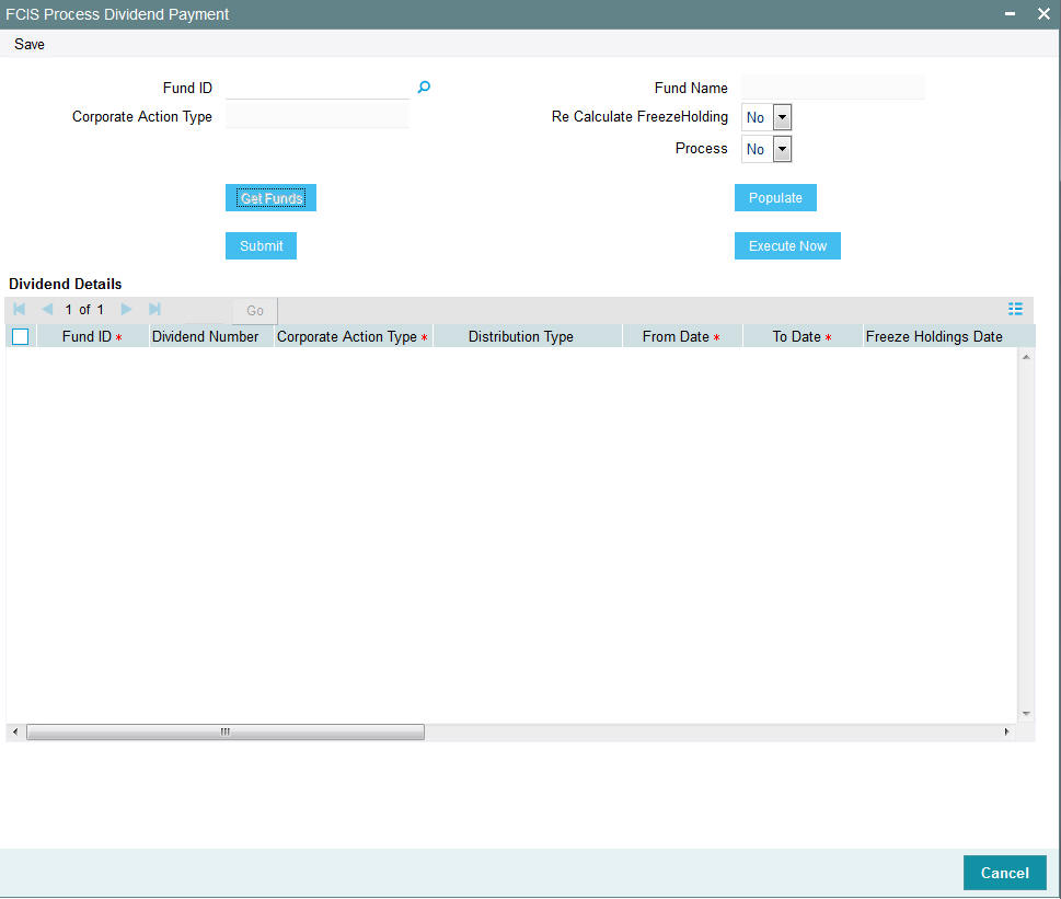

You can use this screen to trigger the processing for a declared dividend, either for a single fund and corporate action type, or a group of funds and corporate action types, as well as for all funds and corporate action types.
Invoke the ‘FCIS Process Dividend Payment’ screen by typing ‘UTDDIPMT’ in the field at the top right corner of the Application tool bar and clicking on the adjoining arrow button. The ‘FCIS Process Dividend Payment’ screen is displayed. Select ‘New’ from the Actions menu in the Application tool bar or click new icon to enter the details of the dividend payment to be processed.
When you open this screen, all funds for which processing of any of the corporate actions are due on the application date are displayed.
You need to click ‘Get Funds’ button to select the funds.
The following details are displayed for each fund and corporate action type:

Recalculate Freezeholding
Optional
Select the recalculate freezeholding status from the drop-down list. The list displays the following values:
Process
Optional
Select the process status from the drop-down list. The list displays the following values:
Click ‘Populate’ button to populate the following dividend details.
Optional
Process
Mandatory
Click ‘Payment Details’ button to provide payment details..
Fund ID
Display
The system displays the fund ID.
Display
The system displays the corporate action type.
Issue Date
Enter the Date on which the Dividend Payment is to be issued. This date must be before or the same as the application date.
By default, the application date is displayed here.
Payment Date
Enter the Date on which the Dividend Payment is to be done. This must be later than or the same as the application date and must be before the next payment end period.
The system defaults the payment date for the dividend as follows:
You can override the defaulted date. If you do so, the date you specify must not be earlier than the application date.
If the payment date is a system/Fund/Currency holiday then the system will display an error message as ‘The payment Date cannot be a holiday’. The currency calendar of the fund base currency of the respective fund will be used for currency calendar validation.
If the entered payment date is less than the dividend process date (application date), the system will display an error message as ‘Payment Date cannot be less than dividend process date’.
If the value date (reinvestment transaction date) field is less than the application date, then the system will display an error message as ‘Reinvestment value date cannot be less than the application date’.
Reference Number
Alphanumeric; 20 Characters; Optional
Enter the Reference Number for the dividend payment.
Exchange Rate Source
Alphanumeric; 6 Characters; Optional
The system displays the exchange rate source. However, you can amend this value.
Min. Amount for Payment
Numeric; 22 Characters; Optional
Specify the minimum amount that can be paid out as dividend, through the dividend payment that you are processing. For a unit holder, if the dividend to be paid falls below this amount, it is distributed according to the Default Distribution Mode defined for the fund and the Income Distribution options (IDS) specified for the unit holder is ignored.
Remarks
Alphanumeric; 255 Characters; Optional
You can specify any narrative for the dividend payment, as free format text, in this field.
The bank details are displayed by the system in this section, from the details of the fund account to which the dividend payment was made.
Account Name
Display Only
The name of the account, to which the proceeds due to dividend have been credited, for this fund, is displayed here. This will typically be the fund bank account.
Account Number
Display Only
The account number of the account, to which the proceeds due to dividend have been credited, for this Fund, is displayed here. This will typically be the fund bank account.
Fund Base Currency
Display Only
The currency of the account, to which the proceeds due to dividend have been credited, for this Fund, is displayed here. This, typically, is the fund base currency.
Bank
Display Only
The name of the Bank through which the payment is done is displayed here.
Branch
Display Only
The name of the Branch through which the payment is done is displayed here.

To trigger the processing of a cash dividend for which any part of the dividend is being distributed through payment,
After the processing is complete, you must process the reinvestments for the dividend using the Process Reinvestment screen. You can access the Process Reinvestments screen from the Batch menu category of the Browser menu.
In the Process Dividend Payment screen, you can trigger the dividend processing for all funds and corporate action types together.
You can use this screen to trigger the processing of any reinvestment transactions resulting out of dividend processing, for both cash and stock dividends.
Invoke the ‘Process Dividend Reinvestments’ screen by typing ‘UTDPRRIN’ in the field at the top right corner of the Application tool bar and clicking on the adjoining arrow button. The ‘Process Dividend Reinvestments’ screen is displayed. Select ‘New’ from the Actions menu in the Application tool bar or click new icon to enter the details of the dividend reinvestment to be processed.
When you open this screen, the funds and corporate action types for which reinvestments are due to be processed as on the application date are displayed.
The system defaults the Value Date for the reinvestment transactions as the application date, if there is no lag specified for reinvestments in the Corporate Action profile. If a lag is specified, then the Value Date is defaulted accordingly. You can override the defaulted date, if necessary.
You have the facility to change the reinvestment date to a previous date, called backdating. In the payment date field you have the option to specify the date, here you may enter a previously specified date, in case you receive a delayed instruction from the client on the reinvestment.
For instance, a dividend period from 01 July to 31 July has the date of Dividend Payment processing as 15 August. You can change the date to the 1 August, which is accepted by the system.
The following details are displayed for each reinvestment record:
To process the reinvestment,
To process all the records at the same time,
You may need to reverse a dividend that has been processed. Invoke the ‘Mass Amendment Detail’ screen by typing ‘UTDMASAM’ in the field at the top right corner of the Application tool bar and clicking on the adjoining arrow button. The ‘Mass Amendment Detail’ screen is invoked. Select ‘New’ from the Actions menu in the Application tool bar or click new icon to enter the details of the dividend to be amended.
In this screen, you must specify the following details for the dividend you wish to reverse:
Serial Number
Display
The system displays the serial number.
Process
Mandatory
Fund ID
Specify the fund ID. Alternatively, you can select fund ID from the option list. The list displays all valid fund ID maintained in the system.
Alphanumeric; 1 Character; Mandatory
Specify the corporate action type.
Status
Optional
Select the status from the drop-down list. The list displays the following values:
ISIN Code
Alphanumeric; 12 Characters; Optional
Specify the ISIN code.
Old Payment No
Alphanumeric; 25 Characters; Optional
Specify the old payment number.
Gross or Net
Display
The system displays if the dividend is gross or net for calculation of distribution as maintained in the Corporate Actions tab in the Fund Rule Maintenance screen.
The system will display the following details:
Select the Reverse option in the Process field in this screen, to signify reversal.
The reversal of the dividend can be authorized by selecting the Authorize option in the Actions list.
After authorization, the reversal is processed by reversing the dividend and reinvestment entries passed, and posting the applicable adjustment entries.
The system will reverse the normal and negative stock dividends.
On the day of execution of reprocessing of dividend, the system prints the Income Advice as part of the End of Day processes, displaying the results of the reprocessing.
The following details are displayed:
If a reversal has been executed, the Reversal Advice is also printed, containing negative values for all details, to indicate the reversal.

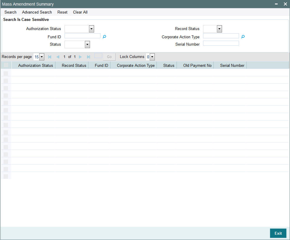

Invoke the ‘Mass Amendment Summary’ screen by typing ‘UTSMASAM’ in the field at the top right corner of the Application tool bar. Click on the adjoining arrow button and specify any or all of the following details in the corresponding details.
Note
You can modify the details of Mass Amendment record that you have already entered into the system, provided it has not subsequently authorized. You can perform this operation as follows:
Click Save to save your changes. The Mass Amendment Detail screen is closed and the changes made are reflected in the Mass Amendment Summary screen.
To view a record that you have previously input, you must retrieve the same in the Mass Amendment Summary screen as follows:
You can delete only unauthorized records in the system. To delete a record that you have previously entered:
When a checker authorizes a record, details of validation, if any, that were overridden by the maker of the record during the Save operation are displayed. If any of these overrides results in an error, the checker must reject the record.
After a Mass Amendment record is authorized, it can be modified using the Unlock operation from the Action List. To make changes to a record after authorization:
An amended Mass Amendment record must be authorized for the amendment to be made effective in the system. The authorization of amended records can be done only from Fund Manager Module and Agency Branch module.
The subsequent process of authorization is the same as that for normal transactions.

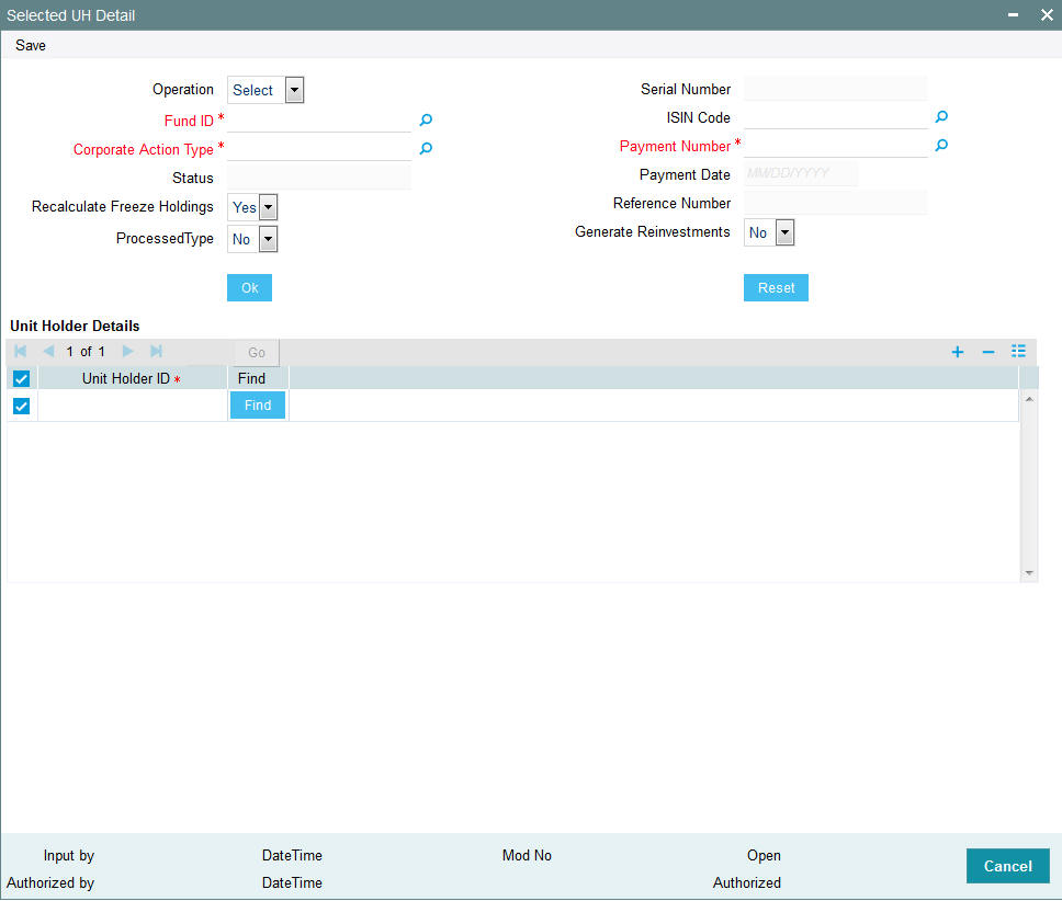

Invoke the ‘Selected UH Detail’ screen by typing ‘UTDSELUH’ in the field at the top right corner of the Application tool bar and clicking on the adjoining arrow button. The ‘Selected UH Detail’ screen is invoked. Select ‘New’ from the Actions menu in the Application tool bar or click new icon to enter the details of the selected UH for whom the dividend to be amended or reversed.
In this screen, you can:
You can specify the following fields in this screen:
Operation
Optional
Select the operation that you wish to perform. The following operations can be performed through the screen:
Fund ID
Alphanumeric; 6 Characters; Mandatory if ISIN Code is not entered
Select the ID of the fund for which the last processed dividend is being reversed / amended for the selected corporate action, for the specified unit holders.
To select the fund, you can either indicate the Fund ID or the ISIN Code of the fund. When you select the fund and the corporate action, the Payment Number and Dividend Reference Number of the last processed dividend are also displayed for the combination.
Serial Number
Display
ISIN Code
Alphanumeric; 12 Characters; Mandatory if Fund ID is not entered
Select the ISIN Code of the fund for which the last processed dividend is being reversed / amended for the selected corporate action, for the specified unit holders.
Select the corporate action for the selected fund that resulted in the dividend, which is being reversed / amended for the specified unit holders.
Payment Number
Numeric; 5 Characters; Mandatory
Choose the payment number generated by the system from the option list.
Status
Display
The system displays the status.
Payment Date
Display
The system displays the payment date.
Reference Number
Display
The system displays the reference number.
Recalculate freezeholdings
Optional
Select if freeze holdings has to be recalculated or not from the drop-down list. The list displays the following values:
You can use this field to indicate whether the freeze holdings calculation must be performed again for the amendment to the dividend to come into effect in respect of the selected unit holders. When you enter a reversal in this screen, recalculation of freeze holdings is performed by the system as a mandatory process, when the reversal is processed.
Processed Type
Optional
Select the processed type status from the drop-down list. The list displays the following values:
Generate Reinvestments
Optional
You can use this field to indicate whether reinvestments resulting from the dividend amendment are to be generated when the amendment is processed, in respect of the selected unit holders from the drop-down list. The list displays the following values:
Unit Holder ID
Specific unit holders for whom the reversal / amendment of dividend is to be applicable.
You can select Unit Holder ID by clicking on ‘Find’ button. After you have specified the unit holder number, click on Add. Each unit holder you select in this fashion is displayed in the text box. Click on Remove to remove a selected unit holder number from the list.
In the Selected UH Dividend Reversal/Amendment screen, you can amend a dividend payment for specific unit holders as follows:
After an amendment of a processed dividend has been entered as described above, it must be authorized in order to come into effect.
In the Selected UH Dividend Reversal/Amendment screen, you can reverse a dividend payment for specific unit holders as follows:
After a reversal of a processed dividend has been entered as described above, it must be authorized in order to come into effect.
After a processed dividend has been reversed or amended for specific unit holders, the reversal or amendment must be authorized in order to come into effect. The authorization can be effected through the Selected UH Dividend Reversal/Amendment screen, as follows:
When a dividend reversal/amendment for specific unit holders is processed, the following operations are performed by the system:
Invoke the ‘Selected UH Summary’ screen by typing ‘UTSSELUH’ in the field at the top right corner of the Application tool bar. Click on the adjoining arrow button and specify any or all of the following details in the corresponding details.
Note
You can modify the details of Selected UH record that you have already entered into the system, provided it has not subsequently authorized. You can perform this operation as follows:
Click Save to save your changes. The Selected UH screen is closed and the changes made are reflected in the Selected UH Summary screen.
To view a record that you have previously input, you must retrieve the same in the Selected UH Summary screen as follows:
After a Selected UH record is authorized, it can be modified using the Unlock operation from the Action List. To make changes to a record after authorization:
An amended Selected UH record must be authorized for the amendment to be made effective in the system. The authorization of amended records can be done only from Fund Manager Module and Agency Branch module.
Oracle FLEXCUBE Investor Servicing provides you the facility of reprocessing multiple dividends for a combination of unitholder and fund. You can also specify the dividend that needs to be reprocessed.
To perform mass reprocessing, you can use the ‘Mass Reprocess Detail’ screen. You can invoke this screen by typing ‘UTDMASRE’ in the field at the top right corner of the Application tool bar and clicking on the adjoining arrow button.
To perform mass reprocessing for dividends in this screen,
Serial Number
Display
Fund ID
Select the ID of the fund for which the dividend is being reprocessed for the selected corporate action, for the specified unit holder.
ISIN Code
Select the ISIN Code of the fund for which the last processed dividend is being reprocessed for the selected corporate action, for the specified unit holder.
Select the corporate action for the selected fund that resulted in the dividend, which is being reprocessed for the specified unit holder.
UnitHolder ID
Select the ID of the unitholder for whom the dividend is being reprocessed for the selected corporate action, for the specified fund.
You can also search unit holder by clicking ‘Find UH’ button.
Payment From Date
Specify the date from which dividend payments need to be re-processed. By default, the application date is displayed here. However, you can modify the defaulted date.
In case of dividend corrections due to reversal of a subscription in the past, you can specify the transaction date of the subscription. In case of dividend corrections due to inaccurate information at UH IDS level, you can specify the date for which changed UH IDS information should be effective.
Payment To Date
You can specify Date up to which dividend payments need to be re-processed. By default, the application date is displayed here. However, you can modify the defaulted date.
In case of dividend corrections due to reversal of a subscription in the past, you can specify the system application date in this field. In case of dividend corrections due to inaccurate information at UH IDS level, you can specify the system application date in this field.
On clicking ‘Ok’ button, all dividend payments processed for the specified Unit holder Id and Fund Id combination in the given date range are displayed. Check the Select option associated with each record to select that record for reprocessing.
Recalculate Freeze Holdings
Optional
If you select ‘Yes’, then system will recalculate freeze holdings for all the records.
Optional
If you select ‘Yes’, then system will generate reinvestments for all the records.
Clicking ‘OK’ button, the system displays the following dividend details:
Mass Reprocess Process
On authorization, system will identify all the dividend payments for the specified unitholder ID and Fund ID combination in the given date range. Dividend Reprocessing will happen sequentially in the order of payment numbers / payment dates. Once a dividend payment record is picked up for reprocessing, system will reprocess the dividend, reverse the reinvestment transactions generated during initial dividend processing and generate new dividend reinvestments and payments as the case may be.
If units associated with a particular reinvestment have already been aged out due to a redemption/switch out transaction, system will log an error and will not continue with reprocessing of UH dividend payments. However, the system will not rollback the reprocessing of payments, which is successfully processed prior to this record. Redemption transactions must be reversed and reprocessing must be restarted for the remaining unit holder dividend payments so that underlying reinvestments can be re-processed.
You can alternatively decide to halt the reprocessing due to dependent transactions and then delete the unprocessed/aborted UH dividend payment records using mass reprocessing screen. Once reprocessing is successfully completed, system will allocate the new reinvestment transactions generated. Since these new reinvestments will be allotted as of current reprocessing date, you can not select the freeze holdings method “Based on Allocation Date”.
In case an Unauthorized Mass Reprocess record exists for a Unitholder ID and Fund ID combination, then system will not allow amendment of dividend for that Fund through “Mass Amendment” and Unitholder ID- Fund combination through “Selected UH Amendment”. Also, you will not be allowed to authorize or edit a Mass reprocess record for the specific unitholder-Fund ID combination record through Select UH amendment screen.

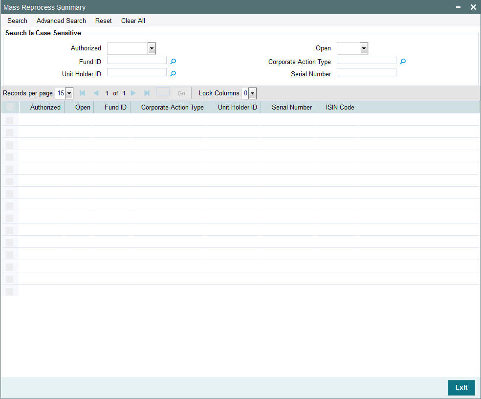

Invoke the ‘Mass Reprocess Summary’ screen by typing ‘UTSMASRE’ in the field at the top right corner of the Application tool bar. Click on the adjoining arrow button and specify any or all of the following details in the corresponding details.
Note
You can modify the details of Mass Reprocess record that you have already entered into the system, provided it has not subsequently authorized. You can perform this operation as follows:
Click Save to save your changes. The Mass Reprocess Detail screen is closed and the changes made are reflected in the Mass Reprocess Summary screen.
To view a record that you have previously input, you must retrieve the same in the Mass Reprocess Summary screen as follows:
After a Mass Reprocess record is authorized, it can be modified using the Unlock operation from the Action List. To make changes to a record after authorization:
An amended Mass Reprocess record must be authorized for the amendment to be made effective in the system. The authorization of amended records can be done only from Fund Manager Module and Agency Branch module.

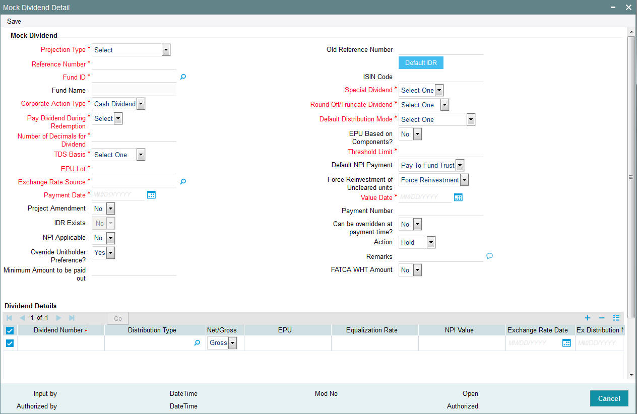

Oracle FLEXCUBE Investor Servicing provides you the facility of ‘mock-processing’ dividends and obtaining projections of dividend payment.
Through mock processing, you can view the projected details of a dividend that has not been processed. You can also view the effect of changes in EPU or stock ratio in respect of a dividend that has been processed.
Note
To perform mock processing, invoke the ‘Mock Dividend Detail’ screen by typing ‘UTDMOCKD’ in the field at the top right corner of the Application tool bar and clicking on the adjoining arrow button. Select ‘New’ from the Actions menu in the Application tool bar or click new icon to enter the details of the mock dividend being performed.
You can specify the following details:
Old Reference Number
Display
For each dividend for which you perform mock processing in this screen, you must provide a unique identification reference number. You can execute the mock processing, and obtain projection reports based on the reference number.
Click ‘Default IDR’ button to default Old Reference Number.
Projection Type
Mandatory
Select the projection type from the drop-down list. The list displays the following values:
Reference Number
Alphanumeric; 16 Characters; Mandatory
Specify the reference number.
Fund ID
Fund Name
Display
The system displays the name of the fund for the selected fund ID.
ISIN Code
If you have selected fund ID, the system displays the ISIN code for the selected fund ID. However, you can amend this value.
Mandatory
Select the corporate action type from the drop-down list. The list displays the following values:
Pay Dividend During Redemption
Mandatory
Select if dividend is paid during redemption or not from the drop-down list. The list displays the following values:
Number of Decimals for Dividend
Specify the number of decimals for dividend.
TDS Basis
Mandatory
Select the TDS basis from the drop-down list. The list displays the following values:
EPU Lot
Numeric; 6 Characters; Mandatory
Specify the EPU lot details.
Specify the exchange rate source. Alternatively, you can select exchange rate source from the option list. The list displays all valid exchange rate source maintained in the system.
Payment Date
Project Amendment
Optional
Select if project is amended or not from the drop-down list. The list displays the following values:
IDR Exists
Optional
Select if IDR exists or not from the drop-down list. The list displays the following values:
NPI Applicable
Optional
Select if NPI is applicable or not from the drop-down list. The list displays the following values:
Override Unitholder Preference?
Optional
Select if unit holder preference is overridden or not from the drop-down list. The list displays the following values:
Minimum Amount to be paid out
Specify the minimum amount to be paid out.
Special Dividend
Mandatory
Select if dividend is special or not from the drop-down list. The list displays the following values:
Round Off/Truncate Dividend
Mandatory
Select if dividend is round off or truncate from the drop-down list. The list displays the following values:
Mandatory
Select the default distribution mode from the drop-down list. The list displays the following values:
EPU Based on Components?
Optional
Select if EPU is based on components or not from the drop-down list. The list displays the following values:
Threshold Limit
Numeric; Mandatory
Specify the threshold limit.
Default NPI Payment
Optional
Select default NPI payment from the drop-down list. The list displays the following values:
Force Reinvestment of Uncleared Units
Optional
Select the uncleared units status from the drop-down list. The list displays the following values:
Value Date
Select the value date from the adjoining calendar.
Payment Number
Numeric; 5 Characters; Optional
Specify the payment number.
Can be overridden at payment time?
Optional
Select if the dividend can be overridden at payment time or not form the drop-down list. The list displays the following values:
Action
Optional
Select the action from the drop-down list. The list displays the following values:
Remarks
Specify remarks, if any.
FATCA WHT Amount
Optional
Select to deduct the FATCA WHT amount from the drop-down list. Following are the options available in the drop-down list:
Dividend Number
Specify the dividend number.
Distribution Type
Specify the distribution type. Alternatively, you can select distribution type from the option list. The list displays all valid distribution type maintained in the system.
Net/Gross
Optional
Select if the dividend is net or gross.
EPU
Specify the Earnings per Unit (EPU) for cash dividends. You can provide the EPU based on components. You can also specify any EPU reporting components.
Equalization Rate
Specify the equalization rate.
NPI Value
Exchange Rate Date
Select the exchange rate date.
Ex Distribution NAV Date
Select ex distribution NAV date from the adjoining calendar.
Select freeze holdings date from the adjoining calendar.
Select dividend declare date from the adjoining calendar.
Click EPU button to view the EPU details.
Click ‘Report’ button to view the following details:
You can also specify any EPU components that would be used for reporting purposes, by clicking on the Report Component Values link. The Reporting Components screen is displayed. The list of EPU reporting components is pre-shipped for your installation according to your requirements, and you can specify the EPU values for each reporting component.
Mock Processing for Processed Dividends
You must also specify whether the mock processing is for a dividend in respect of which payment has already been processed, or one for which it has not been processed. To mock process a dividend for which the payment has been processed, check the Project Amendment box. You must also specify the payment number of the dividend for which the changed values of EPU (or stock ratio) would apply, for the mock processing, in the FCIS Payment Number field.
Dividend Details
If Income Distribution Rules have been defined for the fund that you have selected, the following specifications for the dividend are defaulted and displayed:
If no Income Distribution Rules have been defined, you can make these specifications for the selected fund, for which you wish to mock process a dividend, in this screen.
For details about these specifications, refer to the chapter Setting up Fund Rules, in the Fund Manager user manual.
You must also provide the following projected details to perform the mock processing, just as you would during normal dividend processing:
Note
If the fund is a dividend equalization fund, you can specify an ‘Equalization Rate’ that would be applied to the G2 units.
Refer the section ‘Maintaining G1-G2 conversion Details’ in this User Manual for more details on dividend equalization.
If you are maintaining the specifications for mock processing of a dividend that has already been processed, the exchange rate date, ex-distribution date, freeze holdings and dividend declare dates of the dividend payment number that you indicate, are defaulted.
To specify EPU in terms of components, check the EPU Based on Components box. You can specify the EPU in terms of components in the Fund Dividend Component screen, just as you would for a normal dividend.
For details about these specifications, refer to the section Fields in the Fund Dividend Maintenance screen, found earlier in this chapter.
Click ‘Ok’ button to save the mock-processing dividend record. You must have it authorized by a user with requisite authorization rights. After authorization, you can execute the mock processing in the Mock Dividend Processing screen.

After a mock dividend record has been authorized, you can execute the process in the ‘Mock Dividend’ screen. Invoke this screen by typing ‘UTDMCKDV’ in the field at the top right corner of the Application tool bar and clicking on the adjoining arrow button.
Reference Number
Alphanumeric; 25 Characters; Mandatory
Specify the reference number of the mock dividend you wish to process.
Click ‘Find’ button to view the following details:

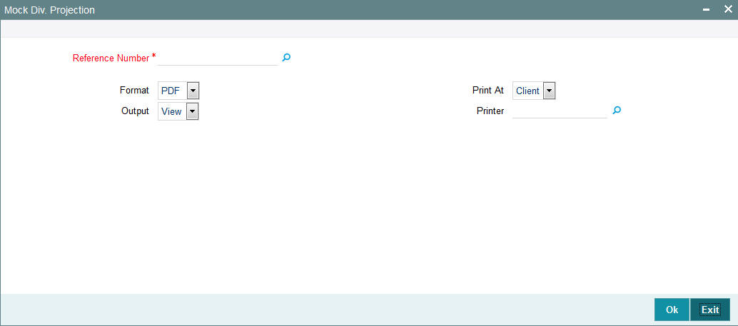

To obtain the details of projected dividend as a result of mock processing, use the Mock Dividend Report screen. You can invoke ‘Mock Dividend Projection’ screen by typing ‘UTR00178’ in the field at the top right corner of the Application tool bar and click the adjoining arrow. The screen is displayed below:
Reference Number
Specify the reference number of the mock dividend for which you need to obtain the report.
Format
Optional
Select the format from the drop-down list. The list displays the following values:
Output
Optional
Select the output from the drop-down list. The list displays the following values:
Print At
Optional
Select the printing location from the drop-down list. The list displays the following values:
Printer
Alphanumeric; 15 Characters; Optional
Specify the printer details from adjoining option list.
The following details are displayed for mock processing of dividend that has not been processed:
The following details are displayed for mock processing of dividend that has been processed and for which new values have been specified for EPU:

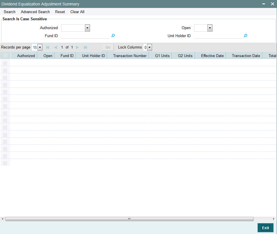

Invoke the ‘Dividend Equalization Adjustment Summary’ screen by typing ‘UTSDIVEQ’ in the field at the top right corner of the Application tool bar and clicking on the adjoining arrow button.
Specify any or all of the following details in the corresponding fields:
Note
You can modify the details of Dividend Equalization Adjustment record that you have already entered into the system, provided it has not subsequently authorized. You can perform this operation as follows:
To view a record that you have previously input, you must retrieve the same in the Dividend Equalization Adjustment Summary screen as follows:
An unauthorized Dividend Equalization Adjustment record must be authorized in the system for it to be processed. To authorize a record:
After a Dividend Equalization Adjustment record is authorized, it can be modified using the Unlock operation from the Action List. To make changes to a record after authorization:
An amended Dividend Equalization Adjustment record must be authorized for the amendment to be made effective in the system. The authorization of amended records can be done only from Fund Manager Module and Agency Branch module.
If you want to create a new Dividend Equalization Adjustment record with the same attributes of an existing maintenance, you can copy the attributes of an existing Dividend Equalization Adjustment record to a new one.
To copy the attributes:

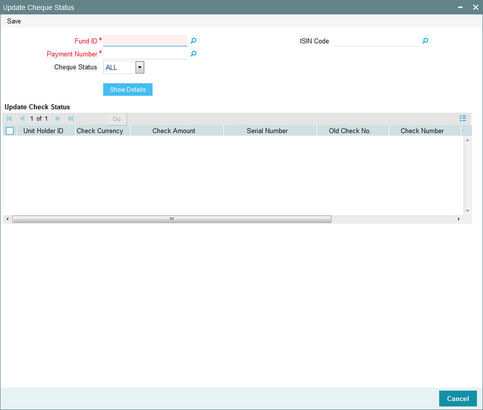

Check Status
Optional
Select the cheque status from the drop-down list. The list displays the following values:

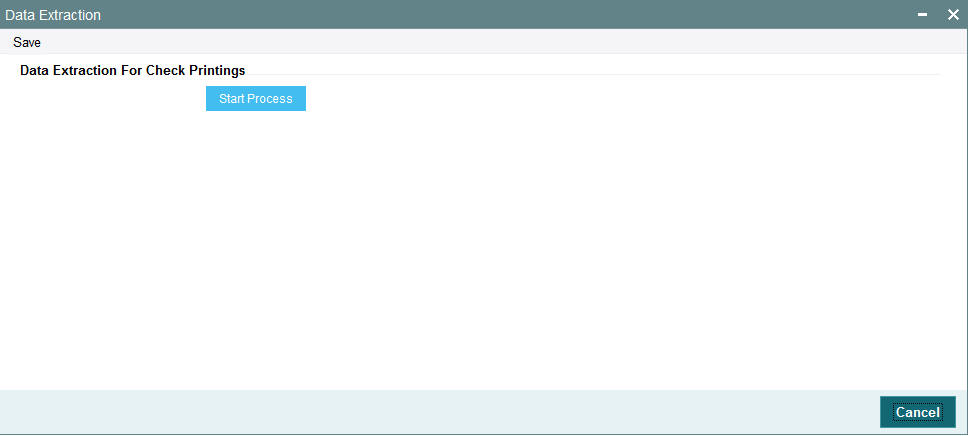

You can use the ‘Data Extraction’ screen to extract the payment information. You can invoke this screen by typing ‘UTDDTEXT’ in the field at the top right corner of the Application tool bar and clicking on the adjoining arrow button.
The ‘Data Extraction’ screen is displayed. Select ‘New’ from the Actions menu in the Application tool bar or click new icon to trigger the data extraction process..
Data Extraction for Check Printings
The extraction of data for the generation of pay-in slips on a given date retrieves all transactions in a fund, (subscriptions or IPO) for which a payment has been received from the unit holder, as on the given date.
Click ‘Start Process’ to start the data extraction process.
The extraction of date for redemption transactions, fees / incentives, or dividend payments in the Data Extraction screen extracts all transactions in respect of which a redemption or dividend payment, or fee / incentive payment has been received on the given date, for the fund.
Note
You must perform the data extraction for any kind of payment check or pay-in slip before you attempt to actually print the instrument.

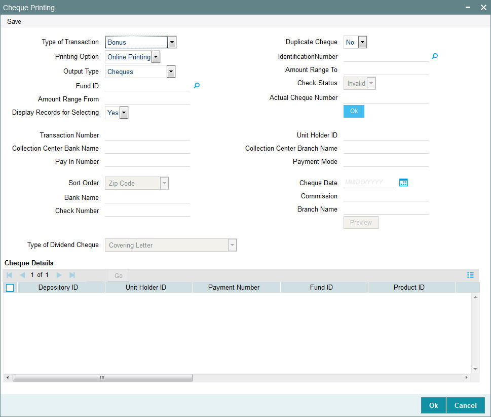

To print redemption, dividend or fee / incentive checks in the Check Printing screen, specify the following information:
After you have specified this information, click ‘Ok’ button. If you have selected the ‘Display Records for Selecting’ box, all the transactions in respect of which the instruments are to be printed, are displayed in the lower Display section of the screen.
The Check Printing Information section is also displayed, where you can indicate your sorting specifications, for selecting the instruments to be printed.
In this section, you specify the following sorting information:
Type of Transaction
Optional
Select the type of transaction from the adjoining drop-down list. Following are the options available:
The parameters according to which the transactions retrieved by the search function must be sorted.
The date to be printed on the payment instrument.
For online printing, the starting instrument number.
The transactions are now displayed, sorted according to your sorting options.
For dividend checks, the following information is displayed:
For redemption or fee / incentive checks, the following information is displayed:
The Payout Bank details
The default bank accounts to which the payment will be directed, is sorted based on the zip code in the address details of the unit holders cashing the payment, and is extracted from the AGY Bank Branch Details maintenance.
The sorting of payment collection details is based on the following parameters:
These parameters are extracted from the AMC Bank Branch Details maintenance.
You can change the payout bank account details, and specify any of the other banks maintained in the AGY Bank Branch Details for the AMC, redemption or dividend payments, and fund ID combination. Select from the drop down list.
For outstation checks, you can also specify the relevant commission amount.
After specifying your sort options, select the transaction in respect of which you want to print the payment instrument, and click the Print button to trigger printing.

You can use the Check Printing screen to print checks for any of the following types of payments:
When you print dividend checks, you can print the following documents too:
You can also use the Check Printing screen to print pay-in slips containing details of payments made towards subscriptions and IPO transactions.
You must select the type of instrument that must be printed for the payment, which will be given to the unit holder as an encashable instrument.
For payment amounts that fall below than the limit amount for the default payment bank or correspondent bank (as applicable), you can select the instrument type as ‘Check’. For payment amounts that are greater than the limit amount for the default payment bank or correspondent bank (as applicable), you can select the instrument type as ‘Demand Draft’. For unit holders that cannot be serviced through either the default payment bank or the correspondent banks, you can select the instrument type as ‘Outstation Check’.
The output type is not applicable for pay-in slips.
You can specify an amount range within which the check amounts must be found, during printing. Use the From and To Amount Range fields to specify an amount range. Only those amounts that fall within the specified amount range will be printed.
In the Check Printing screen, you can select the printing options that suit your requirement, in the Printing Options field. Accordingly, you can:
Online Printing
When you choose to print checks online, you must specify the number of the first check to be printed, as the start number for printing.
Offline Printing
If you choose to print checks offline, you need not specify start check number. The system spools all checks that are in a range of serial numbers, into a spool file. Serial numbers are internal tags or identifications for the checks. Each check number is associated with a serial number. At a later juncture, you can print the actual checks using the spooled file. You must upload the numbers of the actual checks into the system after printing, so that the serial numbers and the check numbers may be matched.
Spooling to a hand-off file
If checks are to be printed by an external check-printing agency, you must spool the check information to a hand-off file, either an ASCII text file or an Excel worksheet. You must provide a serial number range for the checks. As with offline printing, you must upload the numbers of the actual checks into the system after they are printed by the external agency, so that the serial numbers and the check numbers may be matched.
You can print duplicate payment checks for a dividend, redemption or fee / incentive payment, if deemed necessary, in the Check Printing screen.
Select the Duplicate Check box, to indicate that you choose to print duplicate checks. The Duplicate Printing popup screen is displayed. You must specify the status of the check as Duplicate, and also specify the original check number.
To print a pay-in slip for a single subscription or IPO transaction, you can specify the number of the transaction.
To print a pay-in slip for all subscription or IPO transactions of a specific unit holder, you can specify the ID of the unit holder.
To print all pay-in slips that will be paid to the collection account of a specific collection center bank, specify the name of the bank and the branch. You can print duplicate pay-in slips or pay-slips for offline spooled pay-in numbers in this way.
To print pay-in slips for all subscription or IPO transactions with a specific mode of payment, specify the mode of payment as search criteria.
The system generates a unique pay-in number for each pay-in slip that you print for a transaction or a set of transactions. If you are retrieving the record of a slip that has already been printed, you can specify the pay-in number as search criteria.
The pay-in number generated for a pay-in slip for a single transaction or a set of transactions is unique. It can be generated for a transaction or a set of transactions included in printing a pay-in slip only once. Subsequently, you can print the pay-in slip again, as a duplicate copy.
The pay-in number is a number comprising 12 numerals. The first six numerals represent the date of printing of the pay-in slip, and the remaining six numerals represent a running serial number. For instance, the pay-in number 060602000001 represents the first pay-in slip printed on 6th June 2002.
In the extracted information list, you can sort the checks you want to print as follows:
You can select the required sort option in the Sort Order field, in the Check Printing Information section.
If you choose to print the checks online, you must specify a starting number for the checks.
For offline printing or spooling, the system will spool data with serial numbers for the checks, which can be assigned to the check numbers at a later juncture.
In the case of spooling, when the checks are printed by an external agency, the numbers of the printed checks must be uploaded back into the system so that they can be tracked.
You can specify the date of issue that is to be printed on the checks, in the Check Date field.
After you have specified the sort options for the checks, the system displays the payment bank details. The bank to which the payment will be directed, from which the unit holder would cash the payment instrument, is the payment bank. The system displays the payment bank details from the AGY Bank Branch Details maintenance, for the AMC, transaction type, payment / sub payment mode and fund ID combination involved in the transaction.
You can alter the payment bank displayed by the system, and specify the appropriate bank details, by choosing from the list.

You can monitor as well as update the status of checks issued for dividend payments as well as redemption and fee / incentive payments in the system. Use the ‘Update Cheque Status’ screen to do this.
You can invoke this screen by typing ‘UTDUPCHQ’ in the field at the top right corner of the Application tool bar and clicking on the adjoining arrow button. The screen is displayed. Select ‘New’ from the Actions menu in the Application tool bar or click new icon to enter the details of the cheque whose status you are updating.
Specify the following information in this screen to view or update the status of checks:
Fund ID
Select the Fund ID, for which the cheque is being printed, from the list provided. When you specify the ID of the fund, the ISIN Code of the fund is displayed in the ISIN Code field.
ISIN Code
Select the ISIN Code of the fund for which you want to process payments, from the options provided. If you specify the ISIN Code of a fund, the ID of the fund is displayed in the Fund field.
If you have specified fund ID, then system defaults the ISIN code and vice versa.
Payment Number
In the case of dividend payments, specify the Payment Number of the dividend for which the payment check was issued.
Click ‘Show Details’ button to view the following check status:
You can define dividend interface log using ‘Dividend Interface’ screen. You can invoke this screen by typing ‘UTDDIVIN’ in the field at the top right corner of the Application tool bar.
You can view the following dividend interface log:
