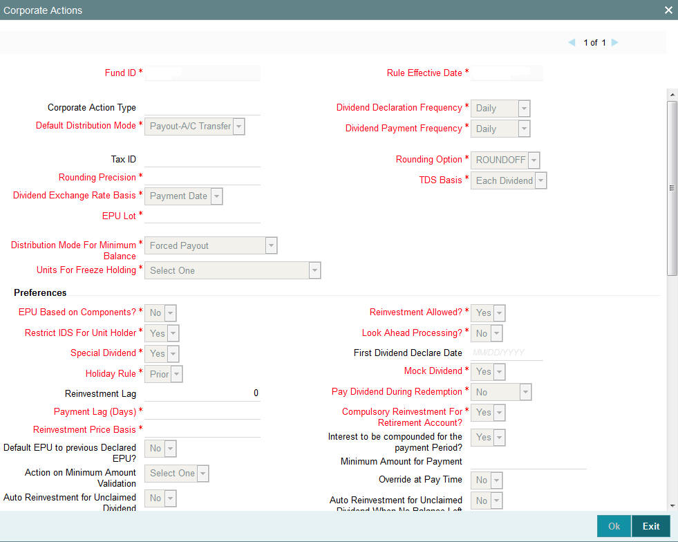

Corporate Actions
In this section, you can specify the rules that will govern the pattern of processing corporate actions for the fund. This includes the income distribution by the fund to its unit holders. These rules include the Dividend Declaration and Payment frequencies, the Default Distribution Mode, Tax Deducted at Source (TDS) details, the lead times for the different dates such as the Book Closing, Freeze Holdings, and Dividend Payment dates.
Setting up this rule is optional, and you can set it up for a fund as and when required. It is recommended that you set it up before you authorize the fund.
For corporate actions such as dividend, you can set up individual, separate rules for processing cash dividend as well as stock dividends for the same fund.

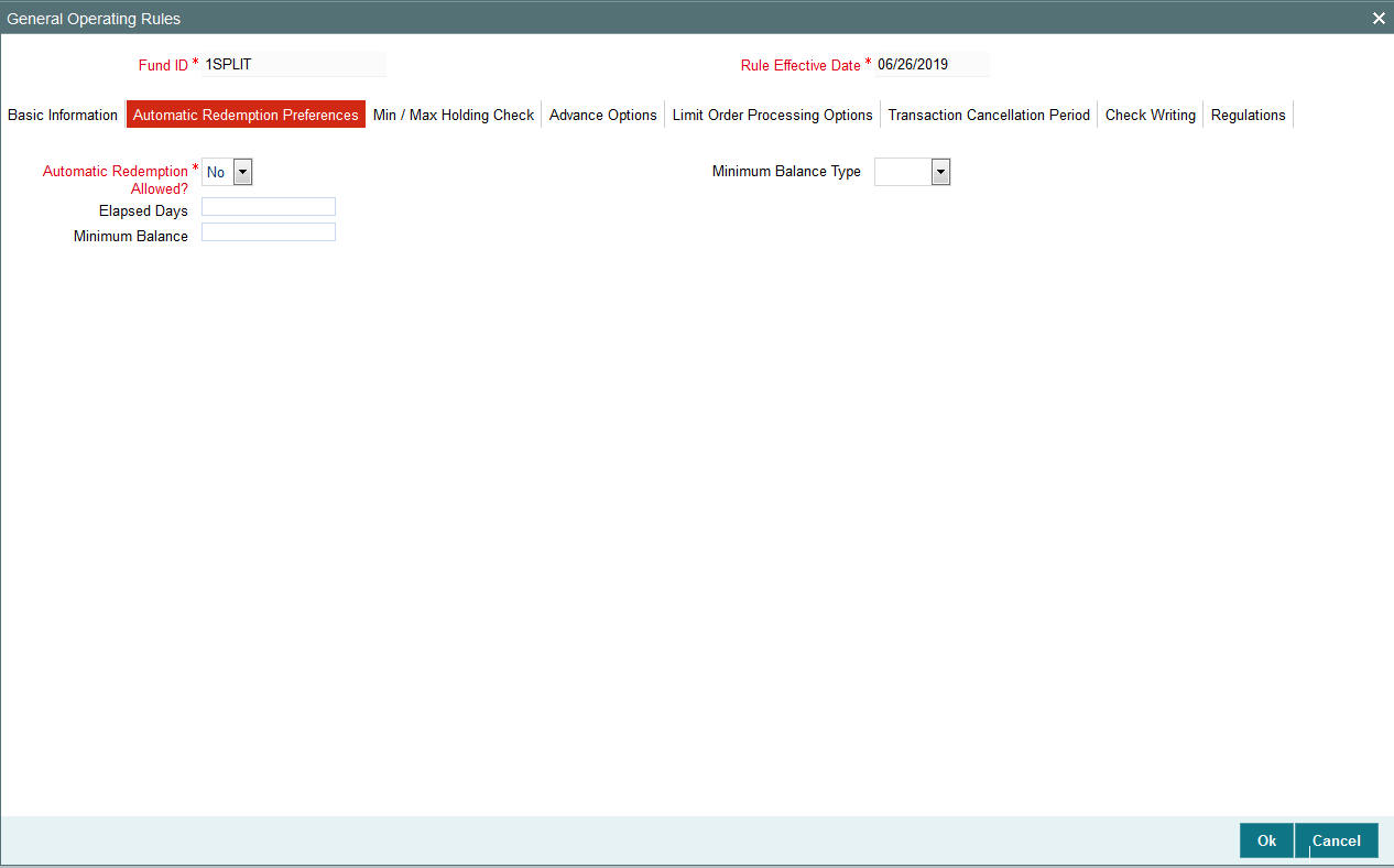

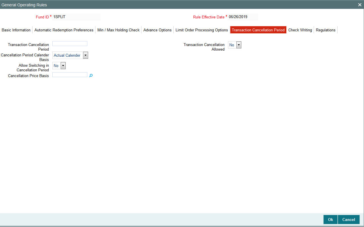

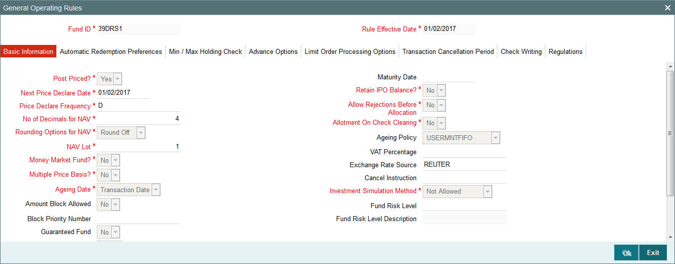

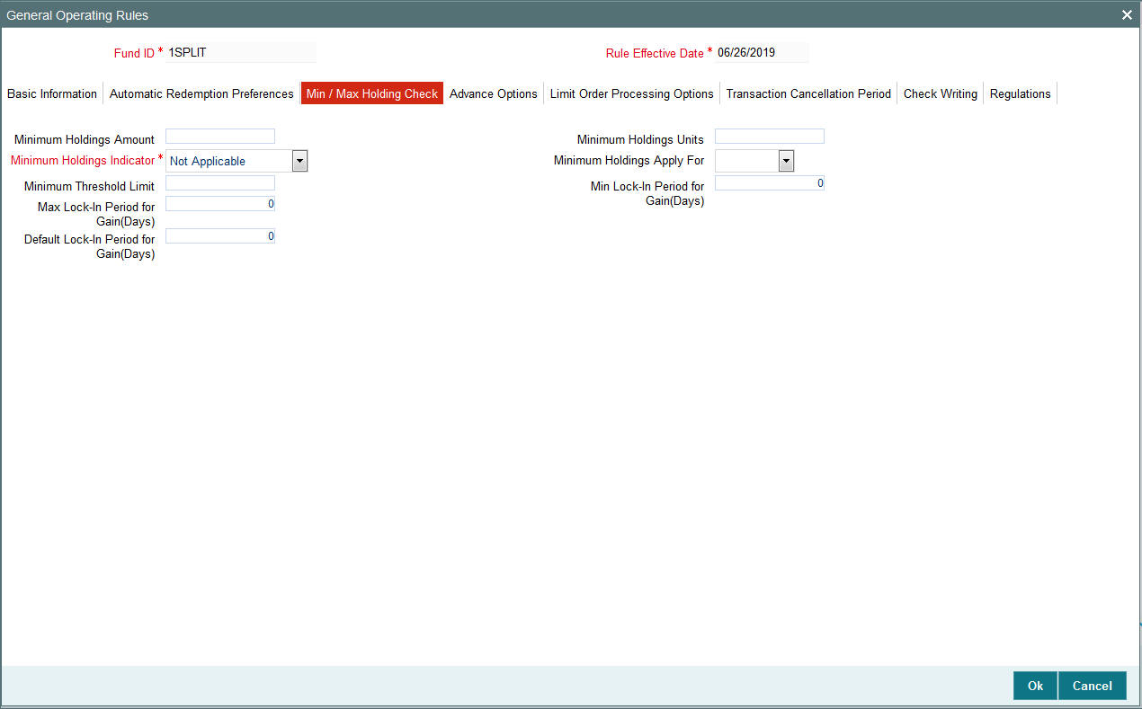

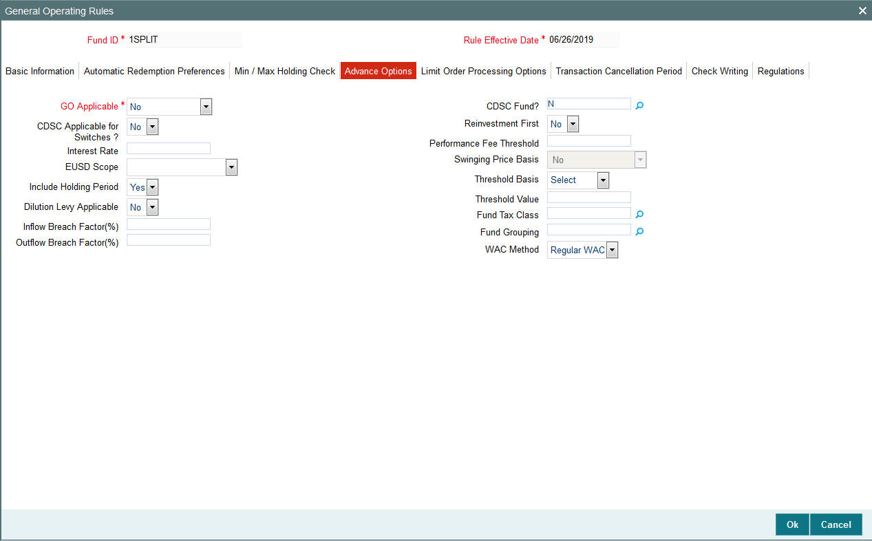

General Operating Rules
In this section, you can designate the rules that will govern the operation of the fund. You can specify the frequency at which the fund price is declared. You can also designate a fund to have automatic redemption.
This is a mandatory fund rule, and you must set it up before you authorize a fund.

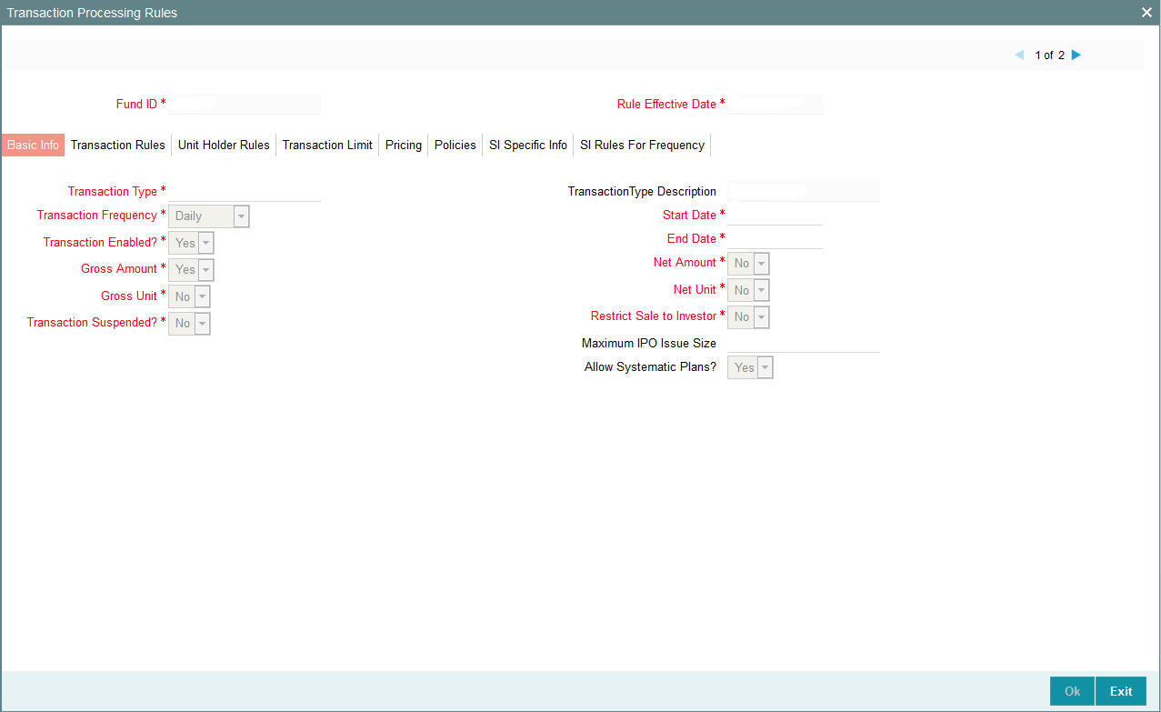

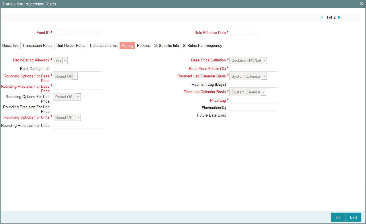

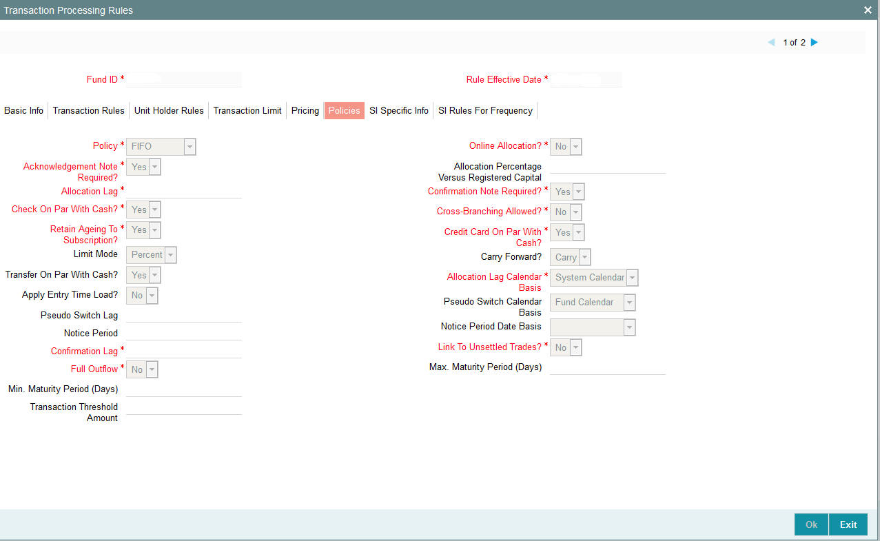

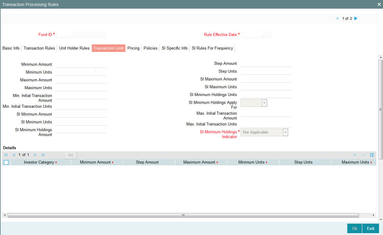

Transaction Processing Rules
These rules govern the parameters by which each transaction is processed in the fund, and these rules may be set up according to each transaction type. These parameters typically include the ranges of volumes allowed for each transaction type, the range of periods and times for the processing of a transaction, the processing policy for each transaction type and the base price definition types and factors. You may enable or disable a transaction type as the requirement may be.

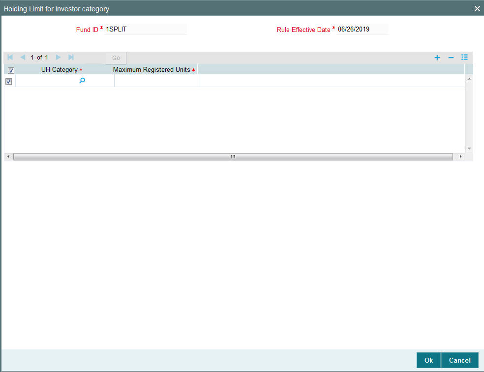

Setting up the Amount/Units Limits for Investor Categories
The limits in the volume of investment for each category of investors can be setup using this fund rule. This is a sub-rule that you can maintain as part of the Transaction Processing Rules rule.
Setting up the Amount/Units Limits for Communication Modes
The limits in the volume of investment for each communication mode can be set up using this fund rule. This is a sub-rule that you can maintain as part of the Transaction Processing Rules rule.

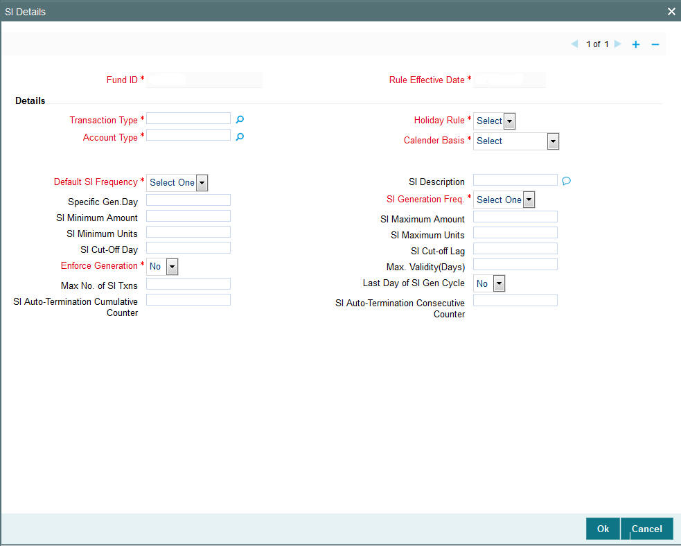

Setting up the Amount/Units Limits for Investment and Standing Instructions
The limits in the volume of investment for initial investments and standing instructions can be set up using this fund rule. This is a sub-rule that you can maintain as part of the Transaction Processing Rules rule.

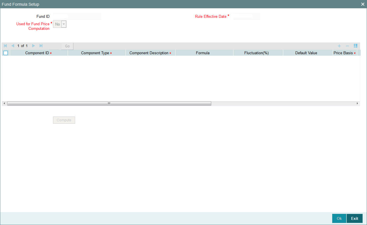

Fund Formula Setup
This fund rule facilitates the specification of any expression that will be used in estimating the base prices or the Net Asset Value for any transaction type.

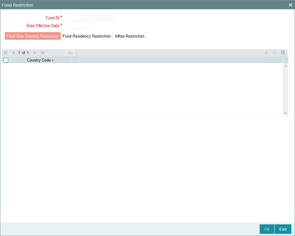

Fund Residency Restriction Setup
This fund rule enables the Fund Manager to make restrictions with respect to the nationality of the unit holders who subscribe to the fund.
Fund Sale Country Setup
If some funds are not to be opened for investment in specific countries, restrictions can be made in respect of that country, identifying that the fund cannot be sold in that country.
Fund Transaction Currencies Setup
The Fund Manager can also identify the currencies that the fund can transact in, and restrict the use of other currencies for transactions. Therefore, each Fund can have a set of identified currencies that may be used as transaction currencies, and other currencies may be disallowed for transactions.

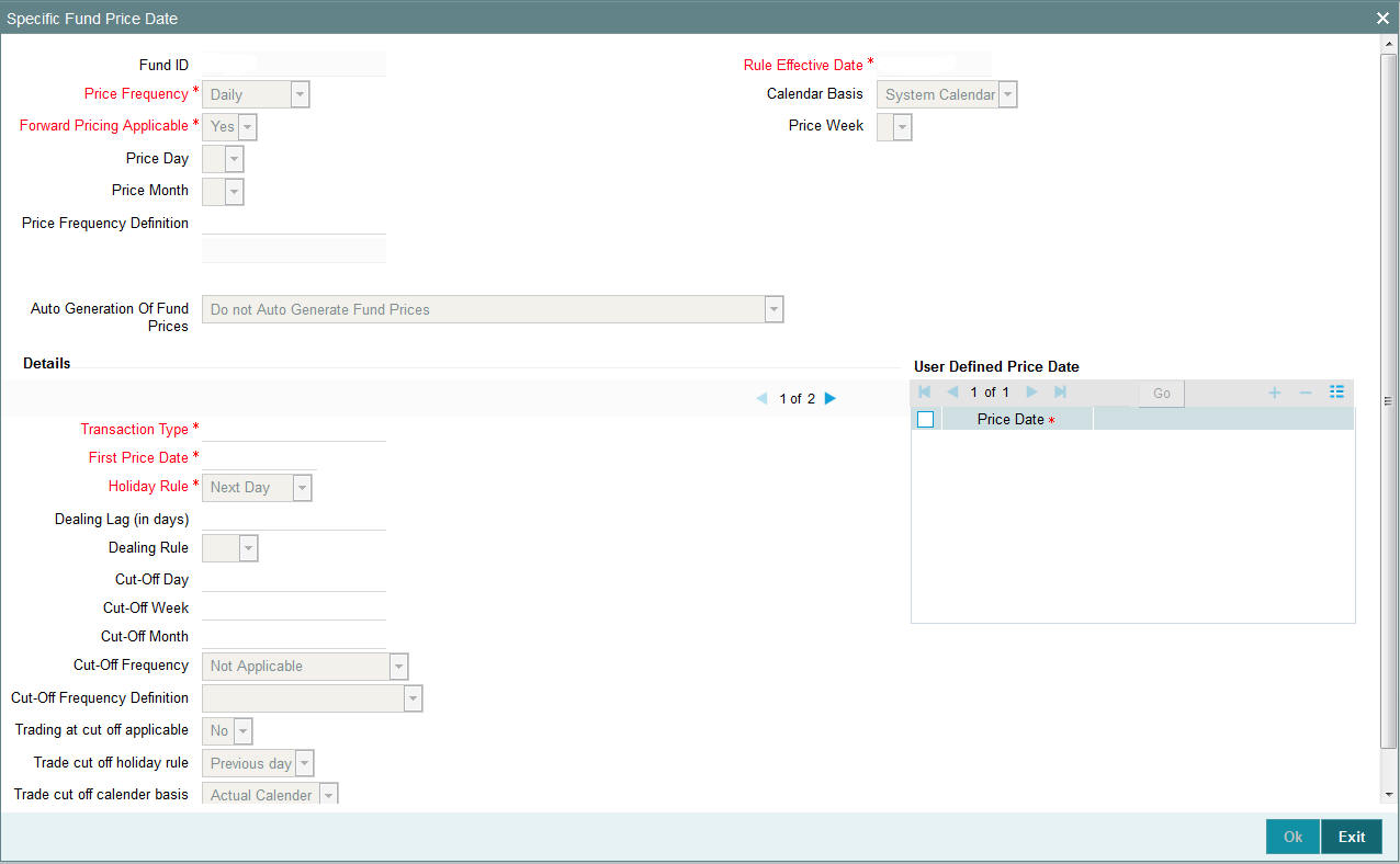

Specific Fund Price Date Setup
You can use this fund rule to specify specific price dates to be operable at a specific frequency for certain transaction types, for a fund. Setting up the specific price date is an optional fund rule, and may be edited, authorized or amended just as the other fund rules.

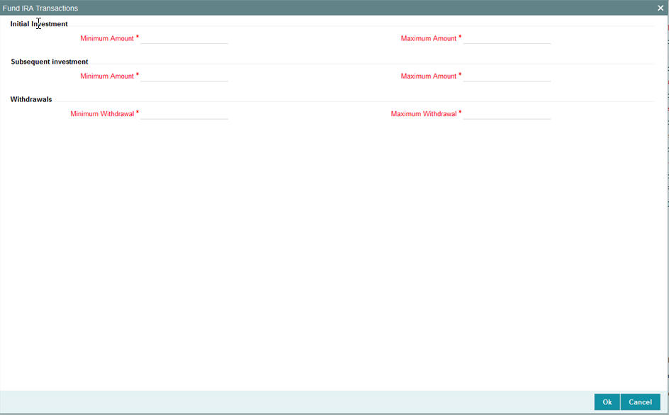

Amount Limits for IRA Transactions
For funds that form part of the investment portfolio of retirement products that you offer to investors, and in which you have opted to allow investment into retirement accounts (IRA), you can define the limits for the different kinds of transactions into such accounts that would apply to the fund.
This is an optional rule, and must be maintained only in the event of IRA investment being allowed for the fund.

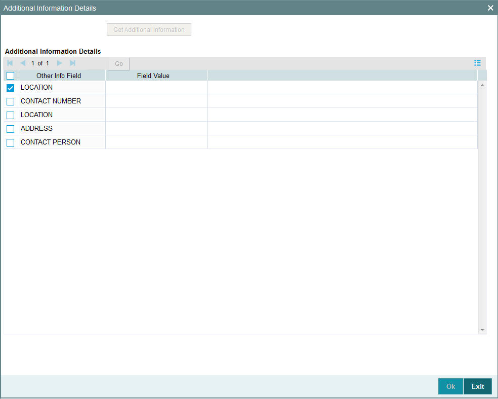

Additional Information Setup
You can also maintain additional information for a fund, if additional information heads have been maintained for the AMC, to be applicable for funds.
Though maintenance of additional information is not, strictly speaking, a fund rule, you can only maintain the information through the Fund Demographics screen, when you are setting up a fund, along with all the other fund rules.

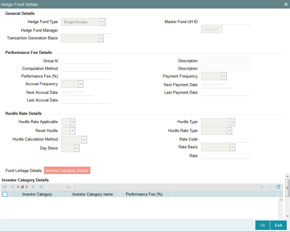

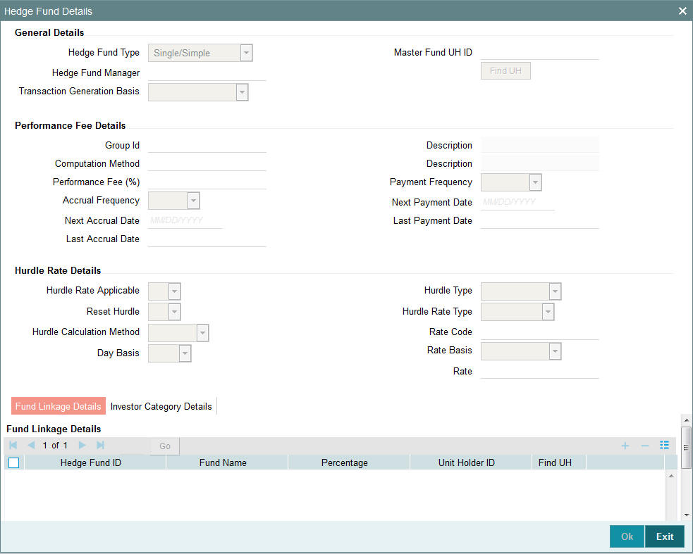

Hedge Fund
Optional
Select ‘Yes’ from the drop-down list to indicate that the selected fund is a hedge fund and select ‘No’ to indicate otherwise.

3.1.5.1 Holding Limit for Investor Category Button
You can specify the limits in terms of units that can be allowed for any given investor category. You may either skip this maintenance or specify limits for one or more investor categories. Use the Holding Limit for Investor Category screen to specify the limits.
Click ‘Holding Limit for Investor Category’ button from the ‘Share Characteristics’ screen to invoke this screen.
Fund ID
Display
This field indicates the ID fund for which you are setting up the Shares Characteristics profile. This information is defaulted from the Fund Demographics screen.
Rule Effective Date
Display
The Rule Effective Date for the fund, which you specified in the Fund Demographics screen, is displayed here.
UH Category
Alphanumeric; 2 Characters; Mandatory
Enter one of the valid investor categories. During unitholder amendment the system will validate if the amendment breaches the limit set up at the investor category level. System will not allow the amendment if the limits are breached and displays an appropriate error message.
Maximum Registered Units
Numeric; 27 Characters; Mandatory
Specify the maximum registered units.
You can click add icon to add details on Investor Category. Similarly you can click delete icon to delete the details.
The allocation of the following transactions will be impacted:
System will check if any limit has been set for the maximum registered capital at the fund level as well as fund - investor category level. If yes, system will calculate the balance in the fund at the fund level as well as investor category level, after considering the effect of the transaction to be allotted. If any of the limit is breached the transaction will not be allocated and marked as error. This transaction will get picked up in the subsequent EODs and may or may not be allotted based on the holding on that day. The validation for the balances will always be made for the latest fund rule only, regardless of the transaction being backdated or current dated.
3.1.6 General Operating Rules Tab
This fund rule facilitates the maintenance of guidelines that will govern the operation of the fund with respect to the following parameters:
To set up the General Operating Rules for a fund, use the General Operating Rules screen. You can invoke this screen by clicking ‘General Operating Rules’ tab from the Fund Rules Detail screen.
Note
Before you set up a General Operating Rules profile record for a fund, it is desirable to en­sure that the fund already has an existing, unauthorized profile record.
You can specify the following details in this screen:
Fund ID
Display
This field indicates the ID fund for which you are setting up the General Operating Rules profile. This information is defaulted from the Fund Demographics screen.
Rule Effective Date
Display
3.1.6.1 Basic Information Tab
Click ‘Basic Information’ tab in ‘General Operating Rules’ screen.
Post Priced?
Mandatory
Select ‘Yes’ from the drop-down list to indicate that the price for the fund will be announced Post Transactions.
Next Price Declare Date
Date Format; Mandatory
Specify the next date upon which the fund price is to be declared. This date must be after the Rule Effective Date of the fund, and the current system date.
Price Declare Frequency
Alphanumeric; 1 Character; Mandatory
Select a value to specify the frequency with which the price will be announced, from the options provided.
If you are specifying the General Operating Rules for a Post-priced Fund, you must specify this frequency as Daily
No of Decimals for NAV
Numeric; 22 Characters; Mandatory
Indicate the maximum number of decimals that would be reckoned for rounding precision, for the NAV.
Rounding Options for NAV
Mandatory
Select the rounding options for the value of the NAV for the selected transaction type, for the fund from the drop-down list. The list displays the following values:
Example
Let us suppose that the NAV for the fund on a certain date 02-03-2003 is 10.561234, and that this value must be rounded to the 3rd decimal place.
If you indicate rounding up, then the value reckoned would be 10.562.
If you indicate rounding off, then, applying normal rounding off rules, the value reckoned would be 10.561.
If you indicate rounding down or truncation, then the value would be truncated as it is, in the 3rd decimal place, and it would be reckoned as 10.561.
NAV Lot
Numeric; 6 Characters; Mandatory
Specify the NAV lot.
Money Market Fund?
Mandatory
Select ‘Yes’ from the drop-down list if the fund is for money market.
Multiple Price Basis?
Mandatory
You can use this field to indicate whether multiple price bases are allowed for the fund. Select one of the options from the drop-down list:
If you select this option, price bases other than the standard bases such as NAV and the Transaction Base Prices are also allowed for the fund.
Ageing Date
Mandatory
Select the ageing basis for the fund from the drop-down list. The list displays the following values:
Based on the ageing date specified here, ageing for period based loads are calculated.
By default, the ageing date is the transaction date. You are allowed to specify the ageing basis if you are creating a new fund. You cannot modify this value, post authorization of the fund.
Amount Block Allowed
Optional
Select ‘Yes’ from drop-down list to indicate that the amount block is allowed at the fund level.
Note
You will be allowed to enter details in the Amount Block Maintenance screen provided this box is checked for the fund. Moreover, the amount blocked will not be available for re­demption.
Block Priority Number
Numeric; 4 Characters; Optional
The funds are selected in the ascending order of the priority number .When blocking is done at UH/ CIF level across funds. During Unblock, funds will be selected in the reverse priority of Block.
This is field is not optional, if check box 'Amount Block Allowed' is Y, it is mandatory. If check box is N, Block priority will be disabled.
Guaranteed Fund
Optional
Select the option ‘Yes’ if you want the system to:
Dividend Equalization Applicable
Optional
Select ‘Yes’ from drop-down list to indicate dividend equalization is applicable.
Funds typically consist of units which have received some benefit in the form of income or dividend distribution and units which have not received any such inflows. The former are G1 units and the latter G2 units.
Since the income and dividend distribution rates are different for units belonging to the G1 and G2 groups, you can apply an equalization rate to equalize the benefit for the G2 units during dividend distribution. This rate will be considered only for the G2 units. To enable application of this rate, select ‘Yes’. Else you can retain the default value ‘No’ to carry out normal dividend distribution.
Note
You cannot maintain stock dividend if you select this option.
Allow Fee Calculation in Transaction Currency
Mandatory
If you select ‘Yes’ from drop-down list, then the field ‘Fee Calculation Basis’ will be provided at the transaction level, where you can indicate that load should be computed in terms of the transaction currency in addition to the fund base currency for the fund.
Maturity Date
Specify the maturity date for the fund. This field is only visible and enabled if the fund is close-ended.
Retain IPO Balance?
Mandatory
Select ‘Yes’ from drop-down list to indicate that the IPO Balance of unit holders must to be stored for later use.
Allow Rejections before Allocation
Mandatory
Select ‘Yes’ from drop-down list to indicate that a rejection of a transaction as applicable, for all authorized transactions, prior to allocation. If this is not specified, then all authorized transactions will be taken up for allocation directly.
Allotment on Check Clearing
Mandatory
Select ‘Yes’ from drop-down list to indicate that allocation must be done on the check clearing date, using the price prevailing on that date, for transactions in which the payment mode is Check.
Ageing Policy
Optional
By default transactions are ordered in a First In First Out (FIFO) basis. If the unit holder has specified as to how transactions are to be ordered, then click on the drop-down menu and select Txn-Receipts. The drop-down list displays the following values:
For AMCs, those service distributors, where the distributor books are maintained in the AMC at hierarchical levels mutually decided on through a service level agreement, the option of ageing based on the hierarchy is available.
For funds in which there is a daily declaration of dividend (typically money market funds), and in which redemption transactions would be requested across non-taxable and taxable products, you can select the FIFO Across Products option if required. This feature is available only if your installation has specifically requested for it.
For Funds where IOF and IRRF taxes are applicable on the profits the ageing policy should selected to be ‘IOF/IRRF’ Optimization.
In case of Certificate Option funds, i.e. if certificate issue is to be based on the choice of the investor at the time of transacting, then the ageing policy can be specified as ‘Hierarchy’.
The USERMNTFIFO aging policy will use the Aging sequence maintained in Fund Preference Maintenance (UTDFPMNT) screen during allocation of outflow transaction.
VAT Percentage
Numeric; 5 Characters; Optional
Specify the VAT percentage.
Exchange Rate Source
Alphanumeric; 6 Characters; Optional
You can specify the exchange rate source from which the exchange rate for cash dividends must be obtained. By default, the exchange rate source that you specify here is used for cash dividends.
Cancel Instruction
Alphanumeric; 2 Characters; Optional
You can use this field to indicate whether standing instructions defined in respect of a unit holder, in the fund, are to be cancelled. If you select this option, the standing instructions for the transaction are cancelled, including those that are to be generated after an automatic redemption occurs. Select the ‘Standing Instruction’ option in this field to indicate cancellation of standing instructions.
If this option has been chosen in the General Operating Rules, the automatic redemption process generates redemption transactions for unit holders in the fund, with the ‘Cancel Instruction’ option automatically set.
If this option is set for an outflow transaction such as redemption, switch or transfer, the End of Day process cancels all standing instructions (irrespective of the transaction type) for the unit holder in the fund after the outflow transactions involving the unit holder have been allocated for the day.
Investment Simulation Method
Mandatory
Specify if the investment simulation option would be applicable for the fund or not by selecting an option from the drop down list. The options are:
Refer to the chapter ‘Generating Reports’ in Volume II of the Agency Branch User Manual for further information regarding investment simulation.
Fund Risk Level
Numeric; 3 Characters; Optional
Specify fund risk level details. Alternatively, you can select fund risk level from the option list. The list displays all valid fund risk level maintained in the system.
If restricted fund is selected as ‘Yes’, then Fund risk level will be defaulted to null. You can modify it.
Note
You can configure Fund risk level and investor risk level at param maintenance for FUN­DRISKPROFILE and INVRISKPROFILE param codes respectively. The system will vali­date the fund risk for an investor in ‘Investor Fund Risk Rating Mapping’ screen.
Fund Risk Level Description
Display
The system displays the description for the selected fund risk level details.
3.1.6.2 Automatic Redemption Preferences Tab
If the fund is to have automatic redemption of units of the unit holder based on the threshold balance, the preferences and guidelines may be laid down in this section.
Click on ‘Automatic Redemption Preferences’ tab to maintain these details:
Automatic Redemption Allowed?
Mandatory
Select ‘Yes’ from drop-down list to indicate that Automatic Redemption is to be allowed for the fund. This is applicable only for Open Ended funds. When the balance the unit holder falls below a defined minimum level, then the investor will be intimated about it and will be provided with some lead-time to either increase the balance above the minimum level or redeem all his units. After the elapsed lead- time, if the unit holder balance still lies below the defined minimum level, then the automatic redemption of those units will be done.
If automatic redemption is allowed for the fund, and this box is checked, the following fields are enabled:
Elapsed Days
Numeric; 22 Characters’ Optional
Enter the number of days from the date of intimation after which Automatic Redemption will be initiated. This is the lead-time provided to the investor.
Minimum Balance
Numeric; 30 Characters’ Optional
Enter the minimum balance (in amounts / units based on what balance type has been specified above) to be maintained for Automatic Redemption.
Minimum Balance Type
Optional
Select the type of Minimum balance to be maintained for Automatic Redemption from the drop-down list. The list displays the following values:
3.1.6.3 Min / Max Holding Check Tab
You can indicate the minimum/maximum holdings balance that is required for redemption, switch or transfer transaction, for a CIF or an individual unit holder, in the fund. The minimum holdings value can be specified either as an amount, number of units, or redeemable value of units.
Click on ‘Min / Max Holding Check’ tab to maintain these details:
As part of the minimum holdings options, you can also indicate whether the holdings considered for validation are those of all unit holders under a CIF, or for an individual unit holder.
Note
The above check is not validated online during transaction capture or authorization. When there are transactions into a fund violating the minimum holdings validation, the system logs an exception in the Pre-End of Day Check screen. During the End of Day processes, the system allocates the transactions, logging the exceptions in respect of them.
Minimum Holdings Amount
Numeric; 18 Characters; Mandatory if Minimum Holdings Indicator is specified
Specify the minimum redeemable value of holdings in the fund, for a redemption, switch or transfer transaction involving a CIF or individual unit holder.
Example
For the Royal Trust Growth Fund, you have selected the ‘Amount’ option as the Minimum Holdings Indicator for redemption, switch and transfer transactions. You have also specified the Minimum Holdings Amount value as 1200 USD (the fund base currency is USD).
The minimum holdings validation is required to be enforced for individual unit holders and not for CIFs.
Therefore, the redeemable value of total number of units held by an individual unit holder, in the Royal Trust Growth Fund must exceed or equal 1200 USD, for a redemption, switch or transfer transaction involving the unit holder.
Mandatory
Select the basis upon which the minimum holdings check is performed from the drop-down list. The list displays the following values:
If you choose either of the last two options (Lower of Amount/Units or Higher of Amount/Units), you must specify the applicable minimum amount in the Minimum Holdings Amount field as well as the applicable minimum number of units in the Minimum Holdings Units field. Also, in either case, the redeemable value of the total number of units held by all investors under the CIF is considered for validation, if the check is to apply at CIF level.
Minimum Threshold limit
Specify the percentage value to be applied on minimum balance amount or units setup here.
Max Lock-in Period for Gain (Days)
Specify the maximum lock-in period beyond which if the subscription is redeemed gains would be passed over to the Unitholder and so IOF and IRRF taxes will be applicable. This should be greater than or equal to the Min Lock-in Period.
Note
When a transaction is redeemed within the Lock-In period, redemption happens at the low­est applicable NAV as on date of Subscription or on the date of Redemption.
Default Lock-in Period for Gain (Days)
Specify the default lock-in period within which if the subscription is redeemed no gains would be passed over to the Unitholder and so IOF and IRRF taxes will not be applicable.
Note
The default lock-in period should be within the minimum and maximum lock in period.
Numeric; 27 Characters; Mandatory if Minimum Holdings Indicator is specified
Specify the minimum number of units required to be held by an individual unit holder, or a CIF, in the fund, for a redemption, switch or transfer transaction.
Example
For the Carey Bugle Growth Fund, you have selected the ‘Units’ option as the Minimum Holdings Indicator for redemption, switch and transfer transactions. You have also specified the Minimum Holdings Units value as 1000.
Therefore, the total number of units held by an individual unit holder, in the Carey Bugle Growth Fund must equal or exceed 1000 units, for a redemption, switch or transfer transaction involving the unit holder.
A note on the minimum holdings validation
If the Minimum Holdings Indicator selected is ‘Lower of Amount/Units’, the redeemable value of the specified Minimum Holdings Units is arrived at, and compared with the Minimum Holdings Amount specified. The lower of the two values is considered as the minimum holdings value against which the minimum holdings validation would be made. Similarly, if the Minimum Holdings Indicator selected is ‘Higher of Amount/Units’, the redeemable value of the specified Minimum Holdings Units is arrived at, and compared with the Minimum Holdings Amount specified, and the higher of the two values is considered as the minimum holdings value against which the minimum holdings validation would be made.
Example
For the Burton Carey Growth Fund, you have selected the ‘Lower of Amount/Units’ option as the Minimum Holdings Indicator for redemption, switch and transfer transactions. You have also specified the Minimum Holdings Amount value as 1200 USD, and the Minimum Holdings Units value as 1000 units.
The minimum holdings validation is required to be enforced for CIFs, and not for individual unit holders.
To arrive at the minimum holdings value against which the validation would be made, the redeemable value of 1000 units is computed, at the redemption price. If the redemption price is 0.8, the redeemable value = 1000 * 0.8 = 800 USD.
The redeemable value obtained (800 USD) is compared with the Minimum Holdings Amount specified (1200 USD). Since the Minimum Holdings Indicator chosen is ‘Lower of Amount/Units’, the minimum holdings value to be validated against, is 800 USD. Therefore, the redeemable value of total number of units held by all unit holders under a CIF, in the Burton Carey Fund must equal or exceed 800 USD, for redemption, switch or transfer transaction involving a CIF.
If the Minimum Holdings Indicator were selected as ‘Higher of Amount/Units’, the higher value (1200 USD) would be considered as the minimum holdings value against which the validation would be made. Therefore, the redeemable value of total number of units held by all unit holders under a CIF, in the Burton Carey Fund would have to equal or exceed 1200 USD, for a redemption, switch or transfer transaction involving a CIF.
Minimum Holdings Apply For
Optional
Select whether the minimum holdings check is applicable for CIFs, or for individual unit holders from the drop-down list. The list displays the following values:
If you select ‘CIF’ option, the redeemable value of the total number of units held by all unit holders under the CIF in the fund is considered for validation.
Min Lock-in Period for Gain (Days)
Specify the minimum lock-in period applicable for the fund. During subscription transaction, the lock-in period specified at the transaction level should be equal to or greater than the minimum period indicated here.
3.1.6.4 Advance Options Tab
Click on ‘Advance Options’ tab to maintain specify advance options:
You can specify the following fields in this screen:
GO Applicable?
Mandatory
Select if GO is applicable or not from the adjoining drop-down list. Following are the options available:
.If the value ‘Yes’ is selected, then the fund will be eligible for ‘GO’ generation. If the value ‘No’ is selected, then the fund will not be eligible for GO generation. However, if the value ‘with trading box’ is selected, then the fund will be eligible for GO generation by applying the trading box functionality and not the GO Maintenance feature.
Refer the Suspense Accounts, Statutory Accounts and Trading chapter in the Fund Manager
User Manual for a fuller discussion of the trading functions available in the FC-IS system.
CDSC Fund?
If Contingent Deferred Sales Charge (CDSC) is applicable for transactions in this fund, then specify the CDSC calculation method to be used for the fund. The options are:
The CDSC load should be of period based. CDSC fund load set up for redemption method to derive the CDSC amount is calculated as follows:
CDSC Load Amount = NR Units * Redemption TBP * CDSC Load %
CDSC Applicable for Switches?
Optional
Select ‘Yes’ from drop-down list to indicate that the Contingent Deferred Sales Charge (CDSC) must be applicable to switch or exchange transactions.
Reinvestments First
Optional
Select ‘Yes’ from drop-down list to indicate that reinvestment transactions must be taken up first for aging during computation of Contingent Deferred Sales Charge for redemption transactions in this fund.
This field is not applicable for onshore funds having ‘USERMNTFIFO’ ageing Logic.
Interest Rate
Numeric; 15 Characters; Optional
Specify the interest rate.
Performance Fee Threshold
Specify the performance fee threshold details.
EUSD Scope
Optional
Select the EUSD scope of the fund from the drop-down list. The list displays the following values:
i.e. if EUSD is applicable only for redemption and switch transactions or only for dividend or for both.
Swinging Price Basis
Display
The system displays the Swinging Price Basis as maintained at the Fund Family Level.
If swinging price basis is not ‘No’ at the fund level, then reference currency and exchange rate source fields should be maintained at the fund family level. The sale value of the funds is converted to the reference currency to arrive at the swinging price.
Include Holding Period
Optional
Select whether the holding period should be considered or not from the drop-down list, while calculating the age of investments during computation of Contingent Deferred Sales Charge.
Note
This option will be enabled only for CDSC applicable funds.
Threshold Basis
Mandatory if the swinging price basis is semi swinging
Select the basis as Amount or Percentage from the drop-down list.
Dilution Levy Applicable
Optional
Select ‘Yes’ from drop-down list if dilution levy is applicable for the fund or else select ‘No’. Outflow and inflow breach factor can be maintained only if the value in this field is maintained as ‘Yes’. To arrive at dilution breach limit amount the system considers the inflow breach factor for IN transactions and the Outflow breach factor for OUT transactions.
Threshold Value
Numeric; 30 Characters; Mandatory if the swinging price basis is semi swinging
Specify the threshold value for the semi swinging price basis fund.
Only daily priced funds can be grouped under a fund family. For non daily price funds, if swinging price is applicable, each fund will have to be mapped to a separate family.
Inflow Breach Factor(%)
Specify the breach factor for inflow transactions, as a percentage of the fund value upon which dilution levy is applicable.
Outflow Breach Factor
Specify the breach factor for outflow transactions, as a percentage of the fund value, upon which dilution levy is applicable.
Fund Tax Class
Alphanumeric; 3 Characters; Optional
Specify tax class of a fund details. Alternatively, you can select fund tax class details from the option list. The list displays all valid fund tax Class details maintained in the system.
Fund Grouping
Specify fund grouping details to group the funds under one fund. Alternatively, you can select fund grouping details from the option list. The list displays all valid fund grouping details maintained in the system.
You can group the different Tax Class Funds under one group for Tax Class Switch using this field. If you want to create four funds in the system, then the fund group ID should be one of the fund IDs of the four funds that you intend to create.
WAC Method
Optional
Select the WAC method from the drop-down list. The list display the following values:
If you select Life WAC and Base Cost is not provided while capturing a transaction, then the system will calculate Weighted Average Cost (WAC) as follows:
LIFE WAC = ((No of units in the fund before inflow) * (WAC before inflow) + (No of units in the inflow for fund) * (Unit Price of inflow)) / (Total Units in Fund)
Where,
Unit price = (Net investment amount) / number of units purchased
Net Investment amount = Gross investment amount – all Fee except the ones which are paid to AMC
The net investment amount will not exclude any Fee for which To Entity is AMC. The system will deduct any other fee (apart from those where To Entity is AMC) from the gross investment amount to arrive at the net investment amount.
Total units in Fund = (No of units in the fund) + (No of units in the inflow for the fund)
If you select a product with WAC method as LIFE WAC, and if a Switch transaction is done within the same Fund Family and Base Cost is not provided while capturing the transaction then the system will calculate WAC as follows:
Life WAC = ((No of units rolling over) * (WAC in ‘From’ Fund) + (No of units in the ‘To’ fund) * (WAC in ‘To’ Fund)) / (Total Units in ‘To’ Fund)
Where Total units in ‘To’ Fund = (No of units rolling over into To Fund) + (No of units in the ‘To’ fund)
The system will calculate Capital Gain or Loss as follows:
Gain / Loss = Units surrendered / redeemed from Fund* ((Price of fund on the date of Redemption / Surrender) – WAC for fund)
If there is a gain then Capital Gain Tax has to be deducted.
To deduct the capital Gain Tax, a separate Load will be mapped under Product load mapping as post allocation load. If the Slab basis is selected as weighted average then this load will be applied on the Gain portion and tax will be deducted and only the net amount will be paid to the customer.
If the Fund Family of Switch Out and Switch In Fund is same, the calculations for the Switch Out Leg will change to the extent wherein Gain will be calculated as 0.
Processing of Swinging Price
For a swinging price fund, the system computes the net transaction of sales value (Inflow - Outflow) on the application date (current date) at fund family level for the given fund and arrives at the fund price
The gross amount in the fund family base currency is used for the net of sales value computation. For unit based transactions, the net sales is computed as follows: units applied * latest available NAV.
For Semi Swinging Funds, the system computes the net of sales value (Inflow – Outflow) for transaction date at fund family level for the given fund and arrives at the fund price based on threshold basis at fund level as follows:
If Threshold Basis is Amount then:
If Threshold Basis is Percentage then:
Net asset value of the fund is computed as the BOD outstanding units * latest available NAV. The reference types mapped at fund family level is used to compute the net of sales value. The swinging price computed is used for unitizing all transaction types mapped at fund family level.
For transaction types not mapped at fund family level, the system does not use swinging price. The system uses the gross amount in fund base currency for net of sales value computation. For unit based transactions, the net of sales is computed by using units applied * latest available NAV.
A mini EOD computes and populates the swinging price and swinging price basis for Swinging Price and Semi Swinging Price Fund. This mini EOD is run during the day to arrive at the Total Inflow, Total Outflow, and Net Sales value.

3.1.6.6 Transaction Cancellation Period Tab
In this section, you must maintain the options in the fund rules for processing cancellations of transactions. Click on the ‘Transaction Cancellation Period’ Tab to maintain the details:
You can specify a number of calendar days that represents a period from the date of transaction within which cancellations are allowed.
Transaction Cancellation Allowed
Optional
Select whether cancellation is allowed for the fund. Choose ‘Yes’ from the drop-down list if you wish to allow cancellation or else choose ‘No’.
Cancellation Period Calendar Basis
Optional
Select the cancellation period from the drop-down list. The list displays the following values:
Allow Switching in Cancellation Period
Optional
You can specify if you wish to allow switch transactions any time within the cancellation period. Choose ‘Yes’ from drop-down list to allow switches in the holdings due to the transaction else choose ‘No’.
Cancellation Price Basis
Alphanumeric; 10 Characters; Optional
Specify the price basis to be followed for cancellations. The price basis could be NAV for a single pricing fund. For other type of funds, the basis could be Bid or Offer Price.
The current market value computation as well as the cancellation amount would depend on the bid / offer / NAV.
The system will consider original Subscription price as cancellation price during allocation. While adding subscription load amounts to redemption proceeds, the system will consider only Fee paid by the unitholder.

Mandatory
You can use this field to indicate whether a stop payment request can be applied on a cheque issued by a unit holder availing cheque writing facility, for this fund. Select ‘Yes’ from drop-down list to indicate that a stop payment can be applied.
Minimum and Maximum Check Amount Violation
Mandatory
You can use this field to indicate whether a violation of the minimum and maximum cheque amounts by a unit holder using the cheque writing facility in this fund, must be validated for. Select ‘Yes’ from drop-down list to indicate validating of violation of the maximum and minimum cheque amounts.
Minimum Holding Period (Days)
Numeric; 5 Characters; Optional - If check writing is allowed for the fund, then this information is mandatory.
Specify the minimum number of days for which units must be held in the investor account before they can be redeemed through a redemption cheque.
Account Closure
Mandatory
You can use this field to indicate whether an investor can close the unit holder account through cheque redemption. Select ‘Yes’ from drop-down list to indicate that account closure through cheque writing is allowed.
Penalty Applicable
Mandatory
You can use this field to indicate whether an investor can close the unit holder account through a cheque redemption. Select ‘Yes’ from drop-down list to indicate that account closure through cheque writing is allowed.
Insufficient Account Balance
Mandatory
You can use this field to indicate whether insufficient balance in this fund, in the account of a unit holder using the cheque writing facility must be validated for. Select ‘Yes’ from drop-down list to indicate validating of insufficient balance situations.

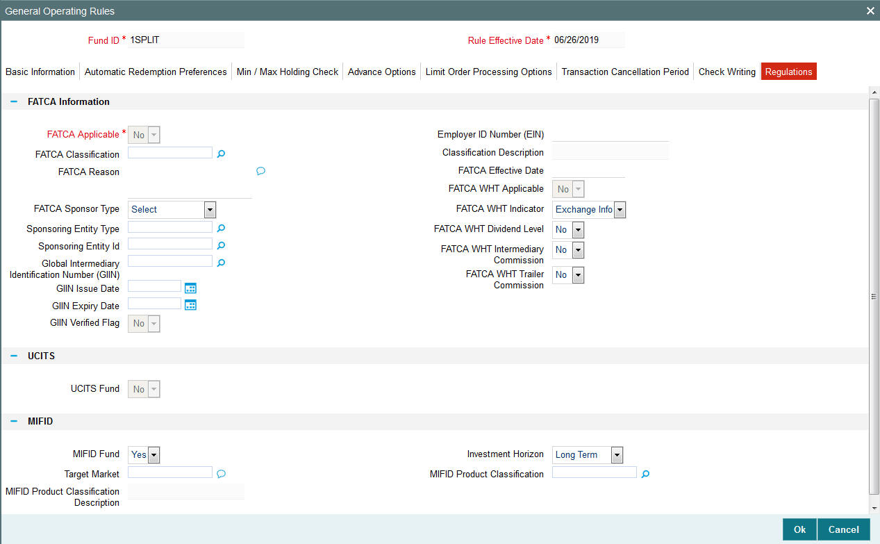

3.1.6.8 Regulations Tab
In this section you can capture the details regarding Foreign Account Tax Compliance Act. Click on ‘Regulations’ tab to maintain the details.
FATCA Information
FATCA Applicable
Mandatory
Select Yes or No from drop-down list to indicate whether FATCA is applicable. However, the system defaults the value ‘No’.
Employer ID Number (EIN)
Display
The system displays the employer ID number.
FATCA Classification
Alphanumeric; 25 Characters; Optional
Select the classification of FATCA from the adjoining option list. FATCA Classification is mandatory if FATCA Applicable is ‘Yes’.
Classification Description
Display
The system displays the description for the selected FATCA classification code.
FATCA Reason
Alphanumeric; 255 Characters; Optional
Specify the reason for FATCA classification.
FATCA Effective Date
Date Format; Optional
Specify the FATCA Effective Date if FATCA is applicable.
FATCA Effective Date cannot be lesser than the fund start date.
FATCA Sponsor Type
Optional
Select the type of FATCA sponsor from the drop-down list. Following are the options available in the drop-down list:
FATCA WHT Applicable
Optional
Select if FATCA WHT is applicable or not from the drop-down list. Following are the options available in the drop-down list:
Sponsoring Entity Type
Alphanumeric; 1 Characters; Optional
Specify the sponsoring Entity type. You can also select the valid sponsoring entity type from the adjoining option list.
FATCA WHT Indicator
Optional
Select the FATCA WHT indicator from the drop-down list. Following are the options available in the drop-down list:
Sponsoring Entity ID
Alphanumeric; 12 Characters; Optional
Specify the sponsoring Entity ID. You can also select the valid sponsoring entity ID from the adjoining option list.
FATCA WHT Dividend Level
Optional
Select the FATCA WHT dividend level from the drop-down list. Following are the options available in the drop-down list:
Global Intermediary Identification Number (GIIN)
Alphanumeric; 30 Characters; Optional
Specify the global intermediary identification number.
FATCA WHT Intermediary Commission
Optional
Select the FATCA WHT broker commission from the drop-down list. Following are the options available in the drop-down list:
GIIN Issue Date
Specify the GIIN issue date.
The GIIN issue date cannot be greater than the application date.
FATCA WHT Trailer Commission
Optional
Select the FATCA WHT trailer commission from the drop-down list. Following are the options available in the drop-down list:
GIIN Expiry Date
Specify the GIIN expiry date.
The GIIN expiry date cannot be lesser than the GIIN issue date.
GIIN Verified Flag
Display
System displays the GIIN verified flag based on the GIIN. If you specify the GIIN then, GIIN verified flag gets displayed as ‘No’. If you select the GIIN then, GIIN verified Flag gets displayed as ‘Yes’.
UCITS Fund
UCITS Fund
Optional
Select if the fund is UCITS or not from the drop-down list. The list displays the following values:
MIFID
MIFID Fund
Optional
Select if the fund is scoped under MIFID regulation or not from the drop-down list. The list displays the following values:
Target Market
Specify the country code of the Country to which the product is sold as part of MIFID regulation. Alternatively, you can select the country code maintained in the system. The system displays all valid country code maintained in the system.
Investment Horizon
Optional
Select the investment objective from the drop-down list. The list displays the following values:
MIFID Product Classification
Alphanumeric; 1 Character; Optional
Specify the MIFID Product Complexity details. It is a mandatory field for MIFID funds.
MIFID Product Classification Description
Display
The system displays the description of the selected MIFID Product Complexity.

3.1.7 Transaction Processing Rules Button
This fund rule lays down the guidelines according to which transactions of each transaction type will be processed for each fund. These guidelines include the following:
To set up the Transaction Processing Rules for a fund, use the Transaction Processing Rules screen.
You can invoke this screen by clicking ‘Transaction Processing Rules’ button from the ‘Fund Rules’ screen.
The screen displays the details of the fund for which the rules are being set up, in the Fund Information section, and the details of all Transaction Processing Rules already maintained for any transaction type, in the Maintained Transaction Details section. It also contains the following data entry sections, each of which can be invoked by clicking the appropriate tab:
The details of rules that have already been made for any transaction types, if any, are displayed in the Maintained Transaction Details section. The following information is displayed in the box for each transaction type, and clicking on the row of each transaction type will cause the transaction processing rules profile for that transaction type to be displayed in the lower portion of the screen, and in each of the sections.
If you need to view all the details of a particular transaction processing rules profile for a transaction type in the fund, click that transaction type in this box and the profile will be populated in the lower half of the screen and in the sections.
Note
Before you set up a Transaction Processing Rules profile record for a fund and transaction type, it is desirable to ensure that the following information is already setup in the system:
You can specify the following fields:
Fund ID
Display
This field indicates the ID fund for which you are setting up the Transaction Processing Rules profile. This information is defaulted from the Fund Demographics screen.
Rule Effective Date
Display
3.1.7.1 Basic Info Tab
Transaction Type
Specify the transaction type for which a transaction processing rules profile has been maintained for the fund.
Transaction Type Description
Display
The system displays the description for the selected transaction type.
Transaction Frequency
Mandatory
Select the frequency at which the transaction type will operate for the fund from the drop-down list. The list displays the following values:
Transaction Enabled?
Mandatory
Select ‘Yes’ from the drop-down list to indicate that the transaction is enabled for the fund. It is possible to set up a temporary suspension of transactions, even if the transactions are open for the fund.
Start Date
Specify the date from which the transaction type is enabled for transaction entry and processing for the fund.
End Date
Specify the date up to which the transaction type is enabled for transaction entry and processing for the fund.
Gross Amount
Mandatory
Select if the processing mode for transaction type is gross or not from the drop-down list.
Net Amount
Mandatory
Select if the processing mode for transaction type is Net or not from the drop-down list.
Gross Unit
Mandatory
Select ‘Yes’ for gross units from the drop-down list.
For transactions with a gross processing mode, the value of the transaction, whether as an amount or a number of units, will be processed as a gross value from which any applicable charges will be deducted.
Note
Opting for a gross or net mode in transaction processing is mode is only available for IPO, subscription or redemption transactions.
Net Unit
Mandatory
For transactions with a net processing mode, the amount value of the transaction will be processed as a net value apart from the charges.
Transaction Suspended?
Mandatory
You can use this field to suspend transactions of specific types for a fund. Check this box to indicate that the transactions of the selected type are suspended for the fund. The suspension would be enforced for transactions of the specific type both entered through the Transaction Detail screens as well as system-generated and uploaded transactions.
Note
If the fund is suspended (as specified in the Fund Demographics), transactions of all types are not allowed into the fund. If the fund is not suspended, transactions of specific types that have been suspended for the fund in the Transaction Processing Rules (if any) are not allowed
Restrict Sale to Investor
Mandatory
You can use this field to indicate that transactions of the selected type, into the fund must only be available to existing customers, and not to new customers. Select ‘Yes’ from drop-down list to indicate this.
If no such restrictions are applicable, select ‘No’ in this field.
When the system applies this restriction, it considers a new investor to be one whose balance holding in the fund is zero. This restriction is only applicable to the inflow transaction types subscription, switch in and transfer.
Maximum IPO Issue Size
Numeric; 27 Characters; Optional
Specify the maximum issue size for IPO transactions in the fund. This value places a restriction on the total IPO order value for the fund. If the total order value units exceed the maximum issue size, the number of allocated units is computed as follows:
Quantity allotted = Quantity applied * (Maximum issue size / Total order value)
Allow Systematic Plans?
Optional
Select ‘Yes’ from drop-down list to allow systematic plans. Select ‘No’ if you do not wish to allow systematic investment plans.
This indicator would be allowed for capture for IPO Subscription, Subscription, Redemption, Transfer and Switch type of transactions.

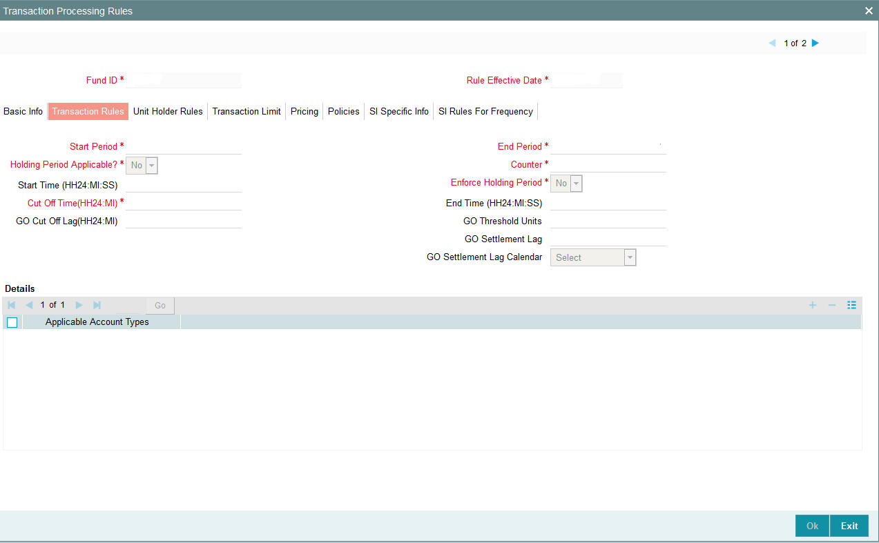

3.1.7.2 Transaction Rules Tab
In this section, the following details may be captured:
Start Period
Enter a value to specify the Start Period within the frequency mentioned above. Within a particular frequency, you have an option to restrict it to a particular period.
End Period
Enter a value to specify the End Period within the frequency mentioned above.
Example
Transaction Frequency is WEEKLY, Start Period is 2 and End Period is 5. This means that the Fund is open for this transaction from second day till the fifth day of the week.
The End period has to be within the Transaction Frequency i.e., it can take values up to 7 (weekly) and not greater than that.
Holding Period Applicable?
Mandatory
Select ‘Yes’ in this field to indicate that a lock in period is applicable for the investors investing in a money market mutual fund. If you select this option, then you must specify whether the holding period is to be enforced.
This feature is only available if your installation has requested for it.
Counter
Enter a value to specify the total number of transactions to be allowed in this transaction type.
Enforce Holding Period
Mandatory
Select ‘Yes’ from drop-down list to indicate that the minimum holding period specified for the fund in the Fund Demographics profile must be enforced as mandatory for the transaction type, by selecting this option.
Start Time (HH24:MI:SS)
Time (hh: mm format); Mandatory
Enter a time to specify the start time for a given working date. On a given day when the fund is open for this transaction, you can start entering transactions from this time.
End Time (HH24:MI:SS)
Time (hh:mm format); Optional
Enter a time to specify the end time for a given working date beyond which you cannot enter any transactions for this transaction type.
Cut Off Time(HH24:MI)
Time (hh:mm format); Mandatory
Specify the time, on a given working day before which a transaction of the selected type will be accepted with the transaction date being the current date. Beyond this time on a working day, the transaction date will be set by default to be the next working date.
If electronic order (SWIFT/Upload) is received after cut off time, the system will automatically move to the next business day without displaying any warning message.
For SWIFT messages, message creation time to be considered for cut off time validation.
A new user maintainable parameter “UPLDCUTOFFTIME’ will be introduced.
If turned on and order received date and time is not present in upload file, the system will consider the time of transaction creation as order received time and trade date to be derived.
The appserver time will be taken into consideration for cut off time determination.
GO Threshold Units
Specify the Global Order threshold units.
If the difference units are more than the threshold units maintained then this will be handled manually.
If the difference units falls under the threshold units maintained, the system will automatically rounded off.
If the AMC confirmed units are more than that the system has allotted, then system calculates Negative (-ve) differential units.
If the AMC confirmed units are less than that the system has allotted, then system calculates Positive (+ve) differential units.
GO Cutoff Lag(HH24:MI)
Specify the additional time for the fund cut-off. The cut-off lag/time will be in addition to the cut-off time maintained for the fund for a selected AMC.
If a GO has been generated prior to amendment the new cut-off lag will be affected for the next GO generation onwards only. Already generated GO for the day will not be affected. However, if the GO is generated after the amendment, the system will consider the same with latest value.
The automated generation of GO will be achieved by using a time based scheduler. A procedure will be enabled to run the time-based scheduler after a predefined time interval say after every 5 minutes or 10 minutes. The time based scheduler will trigger automated Global Order generation process by adding the Cutoff time to the Fund Cut-Off Time. Once GO for a fund is generated the scheduler will mark the Global Order as generated.
The cut-off lag will accept any late transaction received in the system after the fund cut-off time and allows additional time before the GO is generated. This functionality is applicable only for Global Orders and not for Trading.
GO Settlement Lag
Numeric; 22 Characters; Optional
Specify the Global Order settlement lag details.
GO Settlement Lag Calendar
Optional
Select the Global Order settlement lag calendar details from the drop-down list. Following are the options available:
Details
Applicable Account Types
Select one or more account types for which fund transfer is allowed. If you do not select any particular option, then all account types will be allowed. The validation of this rule will happen during the save of Standing Instruction as well as the different transactions including subscription and redemption.

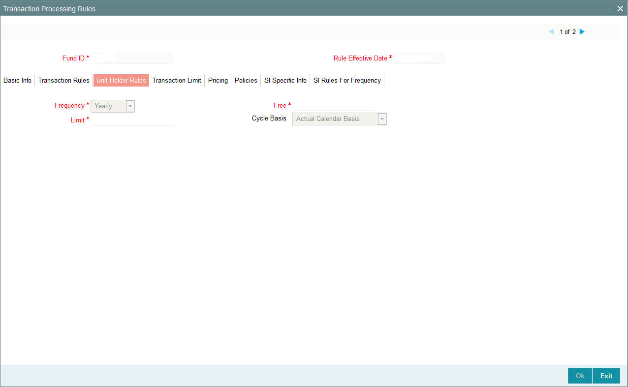

3.1.7.3 Unit Holder Rules Tab
The limits on the number of transactions allowed for a unit holder in this transaction type and in this fund are captured in this section.
Frequency
Mandatory
This is to specify the frequency with which a unit holder can carry out any number of transactions within the limit specified earlier. Select the frequency from the drop-down list. The list displays the following values:
Free
Enter a value to specify the number of free transactions within the permitted transactions. This definition will override all loads that will be set for this transaction
Note
You can not modify the frequency or the cycle basis of the Unitholder limits. However you are allowed to modify the number of free transaction number which will only be applicable from the subsequent cycles and not immediately.
While tracking free transactions, pseudo switch transactions will be treated on par with switch transactions. The Redemption leg of the pseudo switch transaction will be treated on par with Switch from and the subscription leg of the pseudo switch transaction will be treated on par with switch to.
Limit
Enter a value to specify the number of transactions that are allowed for a unit holder. You can restrict the unit holder from operating more than the specified limit for transactions.
Cycle Basis
Optional
Provided the frequency selected is yearly, you are allowed to specify the period basis during which the free transactions will be applicable. Select the cycle basis from the drop-down list. The list displays the following values:
The option ‘Actual Calendar Basis’ will be enabled only if the frequency is ‘Yearly’.
Note
If the free transaction is reversed and the transaction date of the transaction belongs to the current cycle, the free transaction counter will be increased by 1. If it belongs to the previ­ous cycle the counter will not be affected.
3.1.7.4 Transaction Limit Tab
You can use this screen to indicate the minimum volume limits for initial transactions and the limits for standing instruction transactions for investors in a fund, for a certain transaction type.
You can also specify the minimum holdings balance for an IPO or subscription transaction in respect of a standing instruction, for a CIF or an individual unit holder, in the fund.
You can access this screen from the Transaction Processing Rules profile screen for each fund, by clicking on the Limits for SI/Investment link in the Transaction Limits section.
When you save your specifications in this screen, it will be closed and you will be returned to the main Transaction Processing Rules screen. When you save the transaction processing rule record for the fund, the specifications you have made in this screen are saved as part of the same record, in the database.
The volume limits on transactions in the transaction type are captured here.
The limits that may be specified here depend upon the Application Mode specified for this transaction type. If the Mode specified is Amount, then the Amount limits in this section are mandatory. If the Mode is Units, the Units limits are mandatory. If the Mode is ‘Both’, then both limits are mandatory.
Minimum Amount
Specify the minimum transaction amount allowed for this transaction type in this fund.
Minimum Units
Specify the minimum number of units that may be applied for in this transaction type in this fund.
Maximum Amount
Enter a value to specify the Maximum Transaction Amount that a unit holder can invest or redeem. This is the maximum amount that can be accepted for the fund for this given transaction type.
Maximum Units
Enter a value to specify the Maximum Transaction Units that a unit holder can invest or redeem.
This operates in lines similar to that of the Transaction Amount.
The maximum volume (in terms of units) of a single transaction that is entered should never exceed or be equal to the figure of one billion.
For instance, if a user wishes to enter a transaction of 1.5 billion units, he will have to consider entering two transactions, with neither exceeding a maximum limit of 999999999.999999 units.
Min. Initial Transaction Amount
Numeric; 30 Characters; Optional
Specify the minimum amount permitted for an initial transaction, for an investor in this fund.
Min. Initial Transaction Units
Numeric, Optional
Specify the minimum number of units permitted for an initial transaction, for an investor in this fund.
SI Minimum Amount
Specify the minimum amount allowable for a standing instruction transaction in this fund.
SI Minimum Units
Specify the minimum number of units allowable for a standing instruction transaction in this fund.
SI Minimum Holdings Amount
Specify the minimum redeemable value of holdings in the fund, for an IPO or subscription transaction in respect of a standing instruction involving a CIF or individual unit holder.
Example
For the Royal Trust Growth Fund, you have selected the ‘Amount’ option as the Minimum Holdings Indicator for IPO or subscription transactions that would be generated in respect of standing instructions. You have also specified the Minimum Holdings Amount value as 1200 USD (the base currency of the fund is USD).
Therefore, the redeemable value of total number of units held by an individual unit holder, in the Burton Carey Fund must exceed or equal 1200 USD for an IPO or subscription transaction in respect of a standing instruction involving the unit holder.
Step Amount
Enter a value to specify the steps of amount in which a unit holder can invest or redeem.
Step Units
Enter a value to specify the steps of units in which a unit holder can invest or redeem. This will operate above the Minimum Transaction Units.
SI Maximum Amount
Specify the maximum amount allowable for a standing instruction transaction in this fund.
Note
If the client country parameter is set to “SIRULEATFREQ” for your bank, in order to main­tain SI specific details click on the link ‘SI Rules for Frequency under the Transaction limit tab. For further reference please refer to the Annexure.
SI Maximum Units
Specify the maximum number of units allowable for a standing instruction transaction in this fund.
Note
SI Minimum Holdings Units
Specify the minimum number of units required to be held by an individual unit holder, or a CIF, in the fund, for an IPO or subscription transaction in respect of a standing instruction.
Example
For the Carey Bugle Growth Fund, you have selected the ‘Units’ option as the Minimum Holdings Indicator for IPO or subscription transactions that would be generated in respect of standing instructions. You have also specified the Minimum Holdings Units value as 1000.
Therefore, the total number of units held by an individual unit holder, in the Carey Bugle Growth Fund must equal or exceed 1000 USD, for an IPO or subscription transaction in respect of a standing instruction involving the unit holder.
Example
For the Burton Carey Growth Fund, you have selected the ‘Lower of Amount/Units’ option as the Minimum Holdings Indicator to be validated for successful generation of an IPO or subscription transaction in respect of a standing instruction. You have also specified the Minimum Holdings Amount value as 1200 USD, and the Minimum Holdings Units value as 1000.
The redeemable value obtained (800 USD) is compared with the Minimum Holdings Amount specified (1200 USD). Since the Minimum Holdings Indicator chosen is ‘Lower of Amount/Units’, the minimum holdings value to be validated against, is 800 USD. Therefore, the redeemable value of total number of units held by all unit holders under a CIF, in the Burton Carey Fund must equal or exceed 800 USD, for an IPO or subscription transaction in respect of a standing instruction involving a CIF.
If the Minimum Holdings Indicator were selected as ‘Higher of Amount/Units’, the higher value (1200 USD) would be considered as the minimum holdings value against which the validation would be made. Therefore, the redeemable value of total number of units held by all unit holders under a CIF, in the Burton Carey Fund would have to equal or exceed 1200 USD, for an IPO or subscription transaction in respect of a standing instruction involving a CIF.
SI Minimum Holdings Apply For
Optional
If the check is to apply at CIF level, the redeemable value of the total number of units held by all investors under the CIF in the fund is considered for validation.
Max. Initial Transaction Amount
Specify the maximum amount permitted for an initial transaction, for an investor in this fund.
Max. Initial Transaction Units
Specify the maximum number of units permitted for an initial transaction, for an investor in this fund.
SI Minimum Holdings Indicator
Mandatory
Amount/Units Limit for Investor Category
The volume ranges of a transaction, for each transaction type, can be limited for each investor category, for a Fund. The limits can be defined in terms of units or amount of the transaction type.
You can set up these limits as part of the Transaction Processing Rules profile for each fund, and, as such, may be set up through that maintenance screen.
You can also access this screen from the Amount / Units Limits for Investor Category menu of the Fund Manager component. If you have accessed the screen in this manner, the limits defined here will supersede the limits defined in the Transaction Processing Rules profile for the fund and transaction type.
Before you set up an Amount/Units Limits on Investor Categories profile record for a fund, it is desirable to ensure that the following information is already setup in the system:
Details
Investor Category
Specify the category of Investor for whom the amount/units limit is to be set up.
Minimum Amount
Specify the minimum amount that an investor who falls under this category can transact in this fund and transaction type.
Step Amount
Numeric; 18 Characters; Optional
Specify the amount, in steps of which an investor who falls under this category can transact in this fund and transaction type.
Maximum Amount
Specify the maximum amount that an investor who falls under this category can transact in this fund and transaction type.
The maximum volume of a single transaction that is entered should never exceed or be equal to the figure of one trillion.
For example, if the user wishes to enter a transaction of 1.5 billion, he will have to consider entering two transactions, neither exceeding a maximum limit of 999999999999.999.
Minimum Units
Specify the minimum number of units that an investor who falls under this category can transact in this fund and transaction type.
Step Units
Specify the number of units, in steps of which an investor who falls under this category can transact in this fund and transaction type.
Maximum Units
Specify the maximum number of units that an investor who falls under this category can transact in this fund and transaction type.
The maximum volume of a single transaction that is entered should never exceed or be equal to the figure of one billion, in terms of units.
For example, if the user wishes to enter a transaction of 1.5 billion units, he will have to consider entering two transactions, neither exceeding a maximum limit of 999999999.999999 units.
Communication Mode Amount / Units Limits Screen
The volume ranges of an IPO or subscription transaction, for each transaction type, can be limited for each means of purchase or communication mode, for a fund.
To set up these limits, use the Limit for Communication Mode screen. You can access this screen from the Transaction Processing Rules screen for each fund, by clicking on the Max/Min for Communication Mode link in the Transaction Limits section.
You can also access this screen from the Amount / Units Limits for Communication Mode menu item in the Maintenance menu category of the Fund Manager component. If you have accessed the screen in this manner, the limits defined here will supersede the limits defined in the Transaction Processing Rules profile for the fund and transaction type.
Before you set up these limits for a fund, it is desirable to ensure that the following information is already setup in the system:
Details
Communication Mode
Alphanumeric; 2 Character; Mandatory
From the list, select the means of purchase or communication mode for which you are setting up the transaction limits. You can set up the limits for any of the following modes, from the list:
If you have selected ‘Internet’, then the system will not consider transaction cut-off time maintained at transaction processing rules.
Minimum Amount
Specify the minimum amount that an investor who subscribes through the selected means of purchase can transact in this fund, through an IPO or subscription transaction.
Maximum Amount
Specify the maximum amount that an investor who subscribes through the selected means of purchase can transact in this fund, through an IPO or subscription transaction.
Minimum Units
Specify the minimum number of units that an investor who subscribes through the selected means of purchase can transact in this fund, through an IPO or subscription transaction.
Maximum Units
Specify the maximum number of units that an investor who subscribes through the selected means of purchase can transact in this fund, through an IPO or subscription transaction.
Disallow First Transaction
Optional
Select ‘Yes’ from drop-down list to ensure that the users transacting in this fund are not allowed to communicate through the selected communication channels.
This option is applicable for the first subscription for the combination unit holder and fund.
Note
3.1.7.5 Pricing Tab
In this section, you can set up the pricing details, such as the basis of price definition, the base price factor, the number of decimals for the price, the price lag and the back dating limits.
Back-Dating Allowed?
Mandatory
Select ‘Yes’ in this field to specify that backdating should be allowed for this fund. This means that on any given date, for this transaction type, the system will allow the user to enter transactions dated earlier to the current date.
Back Dating Limit
Enter a value to specify the number of days that one can back date. This is applicable only if Allow Back Dating is True. This has to be later than the transaction start date. Fund Price as effective on that date will be taken into account during allocation.

Mandatory
Select whether the base price value must be rounded off or truncated from the drop-down list, for the selected transaction type, for the fund. The list displays the following values:
Rounding Precision for Base Price
Indicate the maximum number of decimals that would be reckoned for rounding precision, for the transaction base price.
Rounding Options for Unit Price
Optional
Select the rounding options for the value of the unit price for the selected transaction type from the drop-down list. The list displays the following values:
Example
Let us suppose that the unit price computed for a subscription transaction is 10.561234, and that this value must be rounded to the 3rd decimal place.
Rounding Precision for Unit Price
Indicate the maximum number of decimals that would be reckoned for rounding precision, for the unit price for the selected transaction type.
Rounding Options for Units
Mandatory
Select the rounding options for the computation of the units allotted in respect of a transaction, for the selected transaction type from the drop-down list. The list displays the following values:
The rounding options specified for the fund in the Shares Characteristics profile is displayed here by default, and you can alter this specification if necessary. The rounding option specified in this field will be deemed as the final specification for the fund and transaction type.
Rounding Precision for Units
Specify the decimal value or negative value for the units and the units would be reckoned for rounding precision.
Base Price Definition
Mandatory
Select the Base Price definition for the transaction, from the drop-down list. The list displays the following values:
The Unit Price will be calculated based on this price and loads defined for this transaction.
Base Price Factor (%)
Numeric; 7 Characters; Mandatory
Enter a value to specify the Percentage of Base Price value that is defined above. This percentage will be applied to the price arrived from the above calculations to arrive at the Base Price for this transaction type for the fund.
Payment Lag Calendar Basis
Mandatory
Select whether the payment lag days should be considered based on the holiday calendar for the fund, the actual calendar, the System calendar or the payment currency calendar from the drop-down list. The list displays the following values:
Payment Lag (Days)
Specify a value to indicate the number of days by which the settlement for a transaction would be lagged or deferred, after it has been allotted and confirmed.
In the case of redemption transactions, to arrive at the actual date of redemption settlement, both the confirmation lag (if specified) and the payment lag (if specified here) are taken into consideration. For instance, if the redemption transaction was allocated on 15th January and both the confirmation lag and payment lag were specified as 2, then the actual redemption payout to the unit holder would be effected on 19th January (15 + 2+ 2), provided it is not a holiday in the system, and provided there are no intervening holidays.
Price Lag Calendar Basis
Mandatory
Select whether the price lag days should be considered based on the holiday calendar for the fund, the actual calendar or the System calendar from the drop-down list. The list displays the following values:
Price Lag
If you require the price applied for transactions of the selected type in the fund to be the prevalent price as on a date earlier than the transaction date (for cash-based transactions) or the clearing date (for instrument-based transactions), you can specify the number of lag days in this field.
The number of days you specify is considered based on the Price Lag Calendar Basis specified.
For instance, if you specify a price lag of 2, and the lag is based on the fund calendar, and the transaction date for a cash-based transaction is 12th December 2003, the price as of 10th December is used for allocation, provided both 11th and 10th December is working days for the fund. If the lag is based on the actual calendar, the price as of 10th December is used.
Fluctuation (%)
You can specify the fluctuation allowable in the base price for the transaction type, for the fund. When prices are entered for the transaction type for the fund, for the day, the system validates whether the fluctuation is within the allowable limit specified in this field.
Future Date Limit
Indicate the number of days (in terms of fund calendar days) up to which the future dating will be allowed. The transaction date should be within the future dating limit.
3.1.7.6 Policies Tab
In this section, you can set up the following information:
Policy
Mandatory
Select ‘First In First Out’ or ‘Proportionate’ option from drop-down list to specify the policy for allocation in case the maximum limit is reached for a given day. This policy is with respect to the allocation percentage that is allowed against the fund corpus.
Acknowledgment Note Required?
Mandatory
Select ‘Yes’ from drop-down list to indicate that the Acknowledgment Slip is to be printed after every transaction. Otherwise this can be printed only at the User’s request.
Allocation Lag
Enter a value to specify when the transaction should be allocated if the transaction is ‘T’. T + X, where ‘X’ signifies the number of lag days. Lag can only be positive.
Check On Par with Cash
Mandatory
Select ‘Yes’ from drop-down list to indicate that all cheque / Demand Draft transactions are to be treated on par with cash transactions. If this is true, then during allocation, the cheque / demand draft transactions will be taken for allocation for the same day. The units allocated will be provisional, and will be confirmed only after the cheque is cleared.
Retain Ageing to Subscription?
Mandatory
Select ‘Yes’ from drop-down list to indicate that the aging principle must be applied to subscription transactions in the fund. Aging is the process of keeping track of a transaction from the transaction date right up to when it is cleared in full from the account of the unit holder. Depending upon the policy specified for aging, (i.e., either FIFO or Proportionate), aging is applied.
In case of CDSC funds it is mandatory for you to select ‘Yes’.
Limit Mode
Optional
Select the mode based on which redemption will be limited from the drop-down list. The list displays the following values:
Transfer On Par With Cash
Mandatory
Select ‘Yes’ from drop-down list to indicate that all transfer transactions to be treated on par with cash transactions. If this is true then during allocation the transfer transactions will be taken for allocation for the same day. The units allocated will be provisional, and will be confirmed only after the bank transfers are cleared.
Apply Entry Time Load?
Optional
For exit fee loads applied on outflow transactions such as redemption, switch-out and transfer, you can choose to apply the return values prevalent at the time of initiation of the inflow subscription or IPO transaction being aged, or the return values prevalent at the time of the outflow transaction.
To indicate that the entry load values must be applied, select ‘Yes’ from the drop-down list. To indicate that exit load values must be applied, select ‘No’ in this field.
Pseudo Switch Lag
Specify the pseudo switch lag.
Notice Period
Notice period is the number of days which an investor has to inform the Transfer Agent in advance before certain number of days, in case of transaction (Subscription / Redemption / Switch / Transfer/ IPO transaction) in a fund.
A notice period is set at each transaction type level for a fund. The system tracks the transaction breaches if any from the notice period. The person who authorizes the transaction is made aware of the notice period breach.
The following details are captured in the Fund rules - transaction processing rules screen to capture Notice period and the Notice period date basis:
The system raises a warning message for breach in notice period if the transaction date added to the notice period is greater than the dealing date during transaction capture. You can view the overridden warning messages at the time of transaction authorization.
The system internally tracks a transaction level indicator to indicate the breach in notice period. The criteria based flat percentage or amount based load can be setup for transactions which breached the notice period based on this indicator.
Note
There is no change in deriving dealing date logic. The system will not re-validate the trans­action for any changes in the holiday calendar post transaction save.
Confirmation Lag
Enter a value to specify when the redemption transaction should be picked for confirmation after allocation. T + X, where ‘X’ signifies the number of lag days. Lag can only be positive.
The confirmation lag can be defined to be applicable to both AMC as well as Distributor installations.
Full Outflow
Mandatory
Select ‘Yes’ from drop-down list to allow full outflow of a fund. Else select ‘No’.
If this option is checked for a redemption transaction, then partial redemption will not be allowed for the fund.
Note
If this checked then the maturity date of a fund will not be displayed and the transaction mode will be defaulted as “Percent” and transaction value as “100” in the redemption screen.
Min Maturity Period (Days)
Specify the minimum maturity period of the fund here. During subscription transaction, maturity date will be defaulted as the sum of the application date and the minimum maturity period specified here.
Transaction Threshold Amount
Specify a threshold amount for redemption type transaction. On saving a redemption transaction, the system will display a warning message if the transaction amount (in fund base currency) is greater than the maintained threshold amount.
In case of unit based transaction, units applied and latest available NAV will be used to derive the basis value for comparison. The system will use the par value if latest NAV is not available. Similarly, for multi-currency transaction, to derive the basis value for comparison, the transaction base currency is converted to fund base currency based on the transaction exchange rate. If transaction’s exchange rate is not available, then the system will use the latest available exchange rate (as per project allocation logic). The system will not validate the transaction value with maintained threshold amount if the exchange rate is not available.
Online Allocation?
Mandatory
Select ‘Yes’ from drop-down list to indicate that Online Allocation is to be allowed for the given transaction type. This can be enabled only if the fund is pre-priced.
For Post Priced Fund with Allocation as Online, the Transaction Frequency is Allocation.
Allocation Percentage Versus Registered Capital
Numeric; 20 Characters; Optional
Specify the percentage up to which allocation can be allowed for a given registered capital on a given day, for the selected transaction type.
Confirmation Note Required?
Mandatory
Select ‘Yes’ from drop-down list to indicate that the Confirmation Slip is to be printed after every transaction. Otherwise this can be user initiated after allocation of the transaction.
Cross Branching Allowed?
Mandatory
Select ‘Yes’ from drop-down list to indicate that the transactions of the selected type can be entered from a different branch.
Credit Card On Par With Cash?
Mandatory
Select ‘Yes’ from drop-down list to indicate that all credit card transactions to be treated on par with cash transactions. If this is true then during allocation the credit card transactions will be taken for allocation for the same day. The units allocated will be provisional, and will be confirmed only after the credit card transaction is cleared.
Carry Forward?
Optional
Select the manner in which the balance over redeemed quantity to be treated from the drop-down list. The list displays the following values:
Allocation Lag Calendar Basis
Mandatory
Select whether the allocation lag days should be considered based on the holiday calendar for the fund, the System calendar or the actual calendar. Select one of the options from the drop-down list:
Pseudo Switch Calendar Basis
Optional
Select the pseudo switch calendar basis option from the drop-down list. The list displays the following values:
Notice Period Date Basis
Optional
Select the notice period date basis option from the drop-down list. The list displays the following values:
Link to Unsettled Trades?
Mandatory
Select the option ‘Yes’ from the drop-down list to indicate redemption transactions can be linked to unsettled inflow transactions. Select the option ‘NO’ to indicate redemption transactions can be linked to settled inflow transactions only.
Note
This field, by default, will be set to ‘NO’.
If entry time loads are being applied as specified here, and the loads are overridden at the time of transaction entry, the overridden load values are applied.
Similarly, if entry time loads are being applied, and a unit holder deal has been specified for the unit holder, the deal values are applied.
Note
This feature is only available if your installation has specifically requested for it.
Max Maturity Period (Days)
Specify the maximum maturity period applicable for the fund.
Note
Once the maturity date is reached, automatic redemption of the fund will take place as a BOD activity provided there is no judicial block (partial or full) on the subscription.
3.1.7.7 SI Specific Info Tab
In this section, you can maintain the rules for standing instruction generation that are to be applicable for the fund.
You can maintain the following rules:
For instance, if SI start date is 28th of every month, assuming, post maintaining the SI transactions 28th, 29th and 30th of that month has been marked as holiday. If the holiday rule is set as After, then the system will generate SI for that month on the next available Business day. There will not be any change in regular transaction of that month, i.e. the system will generate another transaction on 28th again.
The system will increment the successful debit counter on the date when clearing happens
Example
Assume SI Start date is 28th Mar 2017 and if the holiday rule is set as ‘Next’. Holiday is marked for 28th, 29th, 30th and 31st of March. In such cases, the system will generate SI on 03-Apr-2017. The next processing date will be on 28-Apr-2017
If the holiday rule is set as Prior, then the system will generate SI for that month on the previous available Business day.
Note
You can specify the following details:
Holiday Rule
Optional
Select holiday rule from the drop-down list. The list displays the following values:
Specific Gen.Day
Specify the specific generation day.
Default SI Frequency
Optional
Select default SI frequency from the drop-down list. The list displays the following values:
SI Cut-Off Day
Specify the SI cut-off day.
Enforce Generation
Optional
Select ‘Yes’ from drop-down list to enforce generation.
Max No. of SI Txns
Specify the maximum number of SI transactions.
SI Lead Time
Specify SI lead time.
SI Auto-Termination Cumulative Counter
Specify the SI auto termination cumulative counter.
Default SI Description
Specify the default SI description.
Calendar Basis
Optional
Select the calendar basis from the drop-down list. The list displays the following values:
SI Generation Freq.
Optional
Select SI generation frequency from the drop-down list. The list displays the following values:
SI Cut-off Lag
Specify the SI cut-off lag details.
Max. Validity(Days)
Specify the maximum validity in days.
Inflow Overridable Msg
Optional
Select ‘Yes’ from drop-down list to inflow overridable message.
Last Working Day
Optional
Check this box to indicate the last working day.
SI Auto-Termination Consecutive Counter
Specify SI Auto-Termination Consecutive Counter details.

3.1.8 Fund Restriction Button
To set up a fund restriction, use ‘Fund Restriction’ screen. You can invoke this screen by clicking ‘Fund Restriction’ button in ‘Fund Rule Details’ screen.
Fund ID
Display
The system displays the fund ID.
Rule Effective Date
Display
The system displays the rule effective date.
3.1.8.1 Fund Sale Country Restriction Tab
This fund rule facilitates the maintenance of restrictions in respect of the fund being allowed for sale or operations in certain countries. You can maintain a list of countries as the only countries where the fund is allowed for sale.
To set up the country of sale restrictions for a fund, use the Fund Sale Country Restriction screen. You can invoke this screen by clicking the ‘Fund Sale Country Restriction’ Tab in ‘Fund Restriction’ screen.
Checks
Before you set up a Fund Sale Country Restriction profile record for a fund, it is desirable to ensure that the following information is already setup in the system:
Country Code
Alphanumeric; 3 Characters; Mandatory
Specify the country code. The adjoining option list displays all valid accounts maintained in the system. You can choose the appropriate one.
3.1.8.2 Fund Residency Restriction Tab
This fund rule facilitates the maintenance of restrictions in respect of the nationalities of unit holders who must not be allowed to transact in the fund. You can maintain a list of countries that must not be excluded from operating in the fund, and all unit holders whose country of domicile is found in this list will be allowed to subscribe into the fund.
To set up the nationality restrictions for a fund, use the Fund Residency Restriction screen. You can invoke this screen by clicking the ‘Fund Residency Restriction’ Tab in ‘Fund Restriction’ screen.
Checks
Before you set up a Fund Residency Restriction profile record for a fund, it is desirable to ensure that the following information is already setup in the system:
Country Code
3.1.8.3 Inflow Restriction Tab
In this tab you can specify the inflow restriction details.
Restricted Fund
Optional
Select if transaction type or ref types should be allowed or not from the adjoining drop-down list. Following are the options available:
Ref Types
Optional
Select if ref type is allowed or not.
If you have selected ‘Restricted Fund’ field as ‘Yes’, then you should choose the allowed/ disallowed option and provide restriction list.
If you have selected ‘Allowed’ option, then on transaction posting, the system will display warning message for the transaction/ reftypes, which are not part of the restriction list.
If you have selected ‘Disallowed’ option, then on transaction posting, the system will display warning message for the transaction/ reftypes, which are part of the restriction list.
If you have selected ‘Restricted Fund’ field as ‘No’, then the system will validate that no transaction should be provided in the restriction list.
Ref Type for Share Class Restriction
Transaction Type
Specify the transaction type. The adjoining option list displays all valid transaction type maintained in the system. You can choose the appropriate one.
For switch / transfer transaction, the system will display the warning message if the Restricted fund field is enabled for the To fund.
Ref Type
Specify the ref type. The adjoining option list displays all valid ref type maintained in the system. You can choose the appropriate one.
Ref Type Description
Display
The system displays the description for the selected Ref type.
In case of fund transaction suspension, RSP will continue to generate transaction. This can be achieved by maintaining Fund Restriction in Fund Rule Maintenance (UTDFNDRL) by only allowing transaction type ‘02’ and ref type ‘41’ (RSP).
In case of fund transaction suspension, DRSP will continue to generate transaction. This can be achieved by maintaining Fund Restriction in Fund Rule Maintenance (UTDFNDRL) by only allowing transaction type ‘02’ and ref type ‘45’ (DRSP).

3.1.10 Corporate Actions Button
This fund rule facilitates the definition of the guidelines that will govern the distribution of income derived from the fund by the unit holders that subscribe to the fund. You can define the framework according to which corporate actions such as dividend declaration and processing must be performed for a fund. Through this screen the system can also process multiple distributions of a fund on the same day and process the distribution on the same day.
To set up the Corporate Action rules for a fund, use the Corporate Actions screen. You can invoke this screen by clicking ‘Corporate Actions’ button from the Fund Rules screen.
Note
This screen cannot be used to maintain parameters for corporate actions such as liquida­tion, split, reverse split and merger. To maintain these, you must use the Corporate Ac­tions Maintenance screen, which you may invoke by clicking on Corporate Actions in the Maintenance menu, and Detail under it.
For more information on these corporate actions and the Corporate Actions Maintenance screen, refer the chapter Other Fund Activities in this user manual.
Note
Before you set up a Corporate Actions profile record for a fund, it is desirable to ensure that the fund already has an existing, unauthorized profile record.
Fund ID
Display
This field indicates the ID fund for which you are setting up the Corporate Actions profile. This information is defaulted from the Fund Demographics screen.
Rule Effective Date
Display
Corporate Action Type
Select the type of corporate action for which this rule is being set up. It could be either a cash dividend or a stock dividend. It could be either a cash dividend for income, or capital gains earnings.
For stock dividends, the following information is accepted by default:
Dividend Declaration Frequency
Mandatory
Select the frequency with which the dividend is to be declared from the drop-down list. The list displays the following values:
Mandatory
If the Income Distribution Setup for the unit holder has not yet been specified, the fund level default Unit Holder Distribution Mode to be considered for the unit holder can be specified here. Any one of the options from the drop-down list may be chosen. The following values may be entered:
If the rules are being setup for a share class fund for which reinvestment is mandatory, then this field is defaulted to Full Reinvestment and locked for data entry.
For stock dividends, the option ‘Full Reinvestment’ is selected here by default, and cannot be changed.
Dividend Payment Frequency
Mandatory
Select the frequency with which the declared dividends are to be paid from the drop-down list. The list displays the following values:
As the system supports accumulation of dividends, the payment could be for any dividend that has been declared earlier.
The Dividend Payment Frequency must not be less than Dividend Declaration Frequency.
Tax ID
Alphanumeric; 15 Characters; Optional
Enter the tax ID for the fund that is being set up.
Rounding Option
Mandatory
Select the rounding options for the value of the dividend, designated for the fund from the drop-down list. The list displays the following values:
Example
Let us suppose that the dividend earned by an investor, Mrs. Laurie Klein, in the ABC Growth Fund is 700.679263 currency units, and that this value must be rounded to the 3rd decimal place.
If you indicate rounding up, then the value reckoned would be 700.680.
If you indicate rounding off, then, applying normal rounding off rules, the value reckoned would be 700.679.
If you indicate rounding down or truncation, then the value would be truncated as it is, in the 3rd decimal place, and it would be reckoned as 700.679.
Rounding Precision
Numeric; 5 Characters; Mandatory
Indicate the maximum number of decimals that would be reckoned for rounding precision, for the dividend. You cannot indicate a precision higher than 6 decimal places.
Dividend Exchange Rate Basis
Mandatory
Select the basis upon which the exchange rate will be applied for dividend processing from the drop-down list. The list displays the following values:
TDS Basis
Mandatory
This is to indicate whether slab should be looked for every dividend payment separately or whether consolidated on a fiscal year basis. Choose one of the options from the drop-down list. The list displays the following values:
For stock dividends, the option “Tax –Exempt” is selected here by default, and cannot be changed.
EPU LOT
Numeric; 6 Characters; Mandatory if EPU is applicable
Specify the number of units for which the EPU quote is deemed to be applicable, for the fund.
Setting up EPU components is not applicable for stock dividends.
Distribution Mode For Minimum Balance
Mandatory
Indicate how the income derived from the fund is to be distributed, in respect of unit holders whose holdings balance falls below the minimum holdings specified for the fund.
Select the mode of distribution for minimum balance from the drop-down list. The list displays the following values:
Units For Freeze Holding
Mandatory
Select the units for freeze holding from the drop-down list. The list displays the following values:
Preferences
EPU Based on Components?
Mandatory
Select ‘Yes’ from drop-down list if EPU is based on components. Else select ‘No’.
Restrict IDS for Unit Holder
Mandatory
Select ‘Yes’ from drop-down list to indicate that specific income distribution setups for unit holders may be overridden.
Special Dividend
Mandatory
Select ‘Yes’ from drop-down list to indicate that special dividends are applicable for the fund. This feature is only available if your installation has requested for it.
Holiday Rule
Mandatory
Select the rule to be applied if the dividend processing date falls on a holiday. You can select either the PRIOR rule (the previous working day is considered) or the AFTER rule (the next working day is considered), for the dividend type from the drop-down list.
The holiday rule you select here will be applicable to all dividend-processing dates that have been arrived at using a frequency. They are not applicable to dates arrived at using lead times or lag periods.
Reinvestment Lag
Specify the reinvestment lag as the number of days to enable reinvestment on a different date or the same day as the payment date. The default value is 0. If the value is considered as 0, then the reinvestment is made on the same day as the payment date. For a value other than 0, the system calculates the reinvestment date from the payment date. For example: If the number of days entered is 10 and the payment date is 30th June, then the reinvestment date will be 10th July.
Payment Lag (Days)
Numeric; 3 Characters; Mandatory
Specify a lag period (in days) for the payment of dividend. The lag value is interpreted in calendar days, and is used to arrive at the payment date for the dividend. The payment date is arrived at as follows:
Dividend Payment Date = Dividend Declaration Date + Payment Lag
Reinvestment Price Basis
Numeric; 10 Characters; Mandatory only if default distribution mode is ‘Reinvestment’.
Reinvestment transactions into the fund can be put through either at the NAV for the day or the transaction base price. You can use this field to indicate the price that must be used.
Default EPU to Previous Declared EPU?
Optional
Specify whether the previous day’s Earning Per Unit (EPU) needs to be defaulted during the generation of a dividend record. You can select either ‘Yes’ or ‘No’ from the drop-down list.
If you select the option ‘Yes’, the system will default the previous day’s EPU while generating the dividend record at the Beginning of Day (BOD). This record will be an authorized record. However, you will be able to modify it. If the previous day’s EPU is zero, the system will still default the value and generate an authorized record. You can enter the EPU value for this record.
This field is available only for Money Market funds. Also, if ‘Dividend Declaration Frequency’ and ‘Dividend Payment Frequency’ are the same, this field will be disabled.
Action on Minimum Amount Validation
Optional
Select the options from drop-down list. The list displays the following values:
Auto Reinvestment for Unclaimed Dividend
Optional
If you select ‘Yes’ from drop-down list, system will automatically reinvest when dividend is unclaimed, i.e., dividend check is not encashed within the expiry date.
Note
By default, this option will be ‘No’.
Track Dividend for Uncleared Transactions?
Optional
Indicate whether dividend payment/re-investment should be tracked for an individual un-cleared transaction.
If you select ‘Yes’ from drop-down list, dividend will be held back temporarily for subscription transactions whose cheques are not cleared as on the Dividend Declaration Date. Dividend will be released when the payment is cleared.
Note
Pay Ungenerated Reinvestments?
Optional
Select ‘Yes’ from drop-down list to indicate that in case the re investment results in zero units allotment, the amount should be paid out to the investor.
If you select ‘Yes’, then system executes the following steps:
If the number of units in the result of step 3 is greater than zero, re-investment transaction will be generated. If the result is zero then the amount should be paid out to the investor in the unit holder preferred currency. In case any specific preference has been set at the unitholder fund level then the respective currency will be used.
Reinvestment Allowed?
Mandatory
Select ‘Yes’ from the drop-down list to indicate that reinvestment is allowed for the fund. If the rules are being setup for a share class fund for which reinvestment is mandatory, then this field has a default ‘Yes’ and locked for data entry.
Look Ahead Processing?
Mandatory
Select ‘Yes’ from the drop-down list to indicate that in the event of intervening holidays, the system would obtain the EPU information and process dividends for the holiday period, ahead of the prior business day, for the fund.
First Dividend Declare Date
Specify the first date for dividend declaration, for the fund. The system considers the first dividend date in arriving at the date for dividend processing, as follows:
First dividend processing = First Dividend Declare Date – Dividend Declaration Frequency + Dividend Payment Frequency.
The system also uses the first dividend declare date to arrive at the next dividend declare date, applying the specified declaration frequency.
If you do not specify the first dividend declare date, the fiscal year specified for the fund is used to determine the next dividend declare date.
Mock Dividend?
Mandatory
Select ‘Yes’ from drop-down list to indicate the applicability of mock dividends for the fund. This feature is only available if your installation has requested for it.
Pay Dividends During Redemption?
Mandatory
Select this option to indicate that dividends may be paid during redemption from the drop-down list. The list displays the following values:
Compulsory Reinvestment for Retirement Account?
Mandatory
You can use this field to indicate that dividend due from the fund on an IRA account must be compulsorily reinvested. Select ‘Yes’ from drop-down list to indicate compulsory reinvestment.
Interest to be compounded for the payment Period?
Optional
Indicate whether the dividend interest needs to be compounded for the entire payment period or not. You can select either ‘Yes’ or ‘No’ from the drop-down list.
If you select ‘Yes’, the system will calculate the dividend on the amount instead of multiplying the units by the EPU. The EPU value maintained as ‘As amount’ will be directly used in the dividend calculations.

3.1.10.1 Dividend Processing for Fund
In Oracle FLEXCUBE Investor Servicing, there are two types of dividend that can be processed for a fund:
In the case of cash dividends, the unit holders receive the dividend in monetary form. If an income distribution setup record is defined for an investor, then the dividend received is reinvested according to the framework of the same. Cash dividends could be declared for capital gains or income.
In the case of stock dividends, the unit holders receive dividend in the form of units in addition to their holdings as on the record date, which are reinvested in the same fund.
In Oracle FLEXCUBE Investor Servicing, you can define an individual corporate actions record for each of the dividend types, in the Corporate Actions screen. For a fund, if both cash and stock dividends are declared, a separate Corporate Actions profile must be set up for each of the dividend types.
Refer the chapter Dividend Maintenance in the Fund Manager User Manual for information
about the static maintenance for processing dividends in the system.
Setting up Rules for Cash Dividend for Fund
To set up the guidelines for a cash dividend for a fund in the Corporate Actions screen,
  1. The ID of the fund and the Rule Effective Date are filled in from the Fund Demographics screen.
  2. In the Corporate Action type field, select “Cash Dividend”. If you are defining a cash dividend for capital gains, choose Cash Dividend – Capital Gains. For a cash dividend for income, choose Cash Dividend – Income.
  3. Specify the frequencies for declaration and payment of dividend, in the Dividend Declaration Frequency and Dividend Payment Frequency fields respectively.
  4. Specify the rounding rules for dividend, in the Rounding Options and Rounding Precision fields.
  5. Specify the default mode of distribution for the cash dividend – payment by cheque, transfer or reinvestment.
  6. Specify the basis upon which exchange rate for dividend will be obtained, in the Dividend Exchange Rate Basis field.
  7. Specify the first dividend declaration date for the fund, in the First Dividend Declare Date field.
  8. Specify the tax ID for the fund, as well as the basis for tax deduction at source, in the TDS Basis field.
  9. Specify the units to be considered for the record date (freeze holdings) for dividend eligibility, in the Units for Freeze Holding field.
  10. If EPU components are applicable for the fund, select the Allow EPU Component Setup option and specify the EPU Lot. The default value for EPU lot will be 1.
  11. If look-ahead dividend processing for holidays is to be applicable for cash dividends for the fund, select the Look Ahead Processing option.
  12. Specify a lag period for dividend payment, if necessary, in the Payment Lag field.
  13. Specify a lag period for reinvestments, if necessary, in the Reinvestment Lag field.
  14. Specify the holiday rule to be applicable for cash dividends for the fund.
  15. In the Lead Times section, specify the lead times for freeze holdings, book closing, directors’ meeting and dividend payment, as applicable for cash dividends for the fund.
Setting up Rules for Stock Dividend for Fund
To set up the guidelines for a stock dividend for a fund in the Corporate Actions screen,
  2. In the Corporate Action type field, select “Stock Dividend”. The following information is considered by default for stock dividends:
  3. Since stock dividends are exempt from tax, the TDS Basis field has a default value, “tax-exempt”, and is locked for data entry.
  4. Income Distribution Setup options are not applicable for unit holders eligible for stock dividends, and the option Restrict IDS for Unit Holders is selected and cannot be changed. Also, the distribution mode for such dividends is taken by default to be Reinvestment.
  5. EPU components are not applicable for stock dividends.
  6. Specify the frequencies for declaration and payment of dividend, in the Dividend Declaration Frequency and Dividend Payment Frequency fields respectively.
  7. Specify the rounding rules for dividend, in the Rounding Options and Rounding Precision fields.
  8. Specify the basis upon which exchange rate for dividend will be obtained, in the Dividend Exchange Rate Basis field.
  9. Specify the first dividend declaration date for the fund, in the First Dividend Declare Date field.
  10. Specify the units to be considered for the record date (freeze holdings) for dividend eligibility, in the Units for Freeze Holding field.
  11. If look-ahead dividend processing for holidays is to be applicable for stock dividends for the fund, select the Look Ahead Processing option.
  14. Specify the holiday rule to be applicable for stock dividends for the fund.
  15. In the Lead Times section, specify the lead times for freeze holdings, book closing, directors’ meeting and dividend payment, as applicable for stock dividends for the fund.

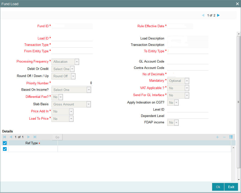

3.1.11 Fund Load Button
This fund rule enables you to designate different fees or incentives that are levied during the processing of transactions, as applicable for transactions in specific funds. A simple mapping can be done where the appropriate fees or incentives, called loads in the system, may be tagged as applicable to the appropriate transaction types for the appropriate funds.
You can also designate the loads as applicable to certain reference types of transactions, such as standing instructions, policy transactions and so on.
The load details maintained will be attached to the funds using this maintenance screen. Only authorized loads can be attached to a fund, whose fund rules are not authorized.
To map loads to a fund, use the Fund Load Setup screen. You can invoke this screen by clicking the ‘Fund Load’ tab from the Fund Demographics screen.
Before you set up a Fund Load mapping profile record for a fund, it is desirable to ensure that the following information is already setup in the system:
Fund ID
Display
This field indicates the ID fund for which you are setting up the Fund Load Setup profile. This information is defaulted from the Fund Demographics screen.
Rule Effective Date
Display
Load ID
Specify the name of the Load (fee/incentive) that must be applied for the selected Fund. You may make your choice from the options provided in the drop-down list.
Note
Load Description
Display
The system displays the description for the selected load ID.
Transaction Type
Specify the transaction type for which the loads are being defined. The adjoining option list displays all valid transaction type codes along with their description. You can choose the appropriate one.
Transaction Description
Display
From Entity Type
Specify the entity that bears this load. Alternatively, you can select From Entity Type from the option list. The list displays all valid entity types maintained in the system.
To Entity Type
Specify the entity that will be recipients of the load. Alternatively, you can select To Entity Type from the option list. The list displays all valid entity types maintained in the system.
Processing Frequency
Mandatory
Select the frequency at which this load is to be applied from the drop-down list. The list displays the following values:
Note
Capital Gains Tax may also be designated as an allocation time load.
GL Account Code
Specify the code that will be used to map this load to its corresponding charge code in the external system.
When transaction information is exported to an external system, if separate books of accounts are to be posted for different loads, this code will be used to identify this load information in the export data.
Debit or Credit
Optional
Indicate whether the applied load would result in a debit or credit for the fund from the drop-down list. The list displays the following values:
This data is captured for information purposes only and has no processing implications in the system database.
Contra Account Code
Specify the code that will be used to identify the second leg of accounting entries for any transaction, in the event of exporting of transaction information to an external system.
Round Off / Down / Up
Optional
Indicate the rounding options for the load amount for the selected transaction type, for the fund.
Example
Let us suppose that the load amount computed for a subscription transaction is 10.561234, and that this value must be rounded to the 3rd decimal place.
No. of Decimals
Numeric; 1 Character; Mandatory
Indicate the maximum number of decimals that would be reckoned for rounding precision, for the load amount.
Priority Number
Enter a value to specify the priority number in case of optional loads.
For a mandatory load, the priority number is set to 0 and for an optional load the priority number should be unique, i.e., for a given fund, no more than one load can have the same priority number.
Mandatory
Mandatory
Select Mandatory or Optional from drop-down list to specify whether the load is mandatory or optional.
Based on Income?
Optional
Select the based on income details from the drop-down list. The list displays the following values:
If the load is a Capital Gains Tax, and it is to be applied based on the gross amount after allocation, choose the Capital Gains – Gross option in this field, for such a load.
If indexation is being applied for capital gains tax computation, choose the Capital Gains – Indexation option in this field. The capital gains load is then applied using appropriate indexation, according to the option chosen by the investor.
If Contingent Deferred Sales Charge (CDSC) is applicable for transactions in this fund, choose the option CDSC option in this field to identify the CDSC load. This option will be available only when Fund chosen is CDSC applicable Fund.
If the ageing policy for the fund has been specified as ‘IOF/IRRF’ optimization in the General Operating Rules screen, then the following additional options are available:
If Dilution Levy is selected, then the system applies the load only if the sum of transactions for the combination of unit holder, fund, and transaction type exceeds the breach factor (inflow/outflow) for the corpus, even though all other criteria are satisfied. An EOD batch computes the aggregated net transaction amount at unit holder, fund, and transaction type level for dilution levy enabled fund. If dilution levy limit of a fund is breached, then the system applies the dilution levy load is applied for specific or all transactions for that unit holder, fund and transaction type combination based on the parameter set.
A system parameter DILUTIONLEVY governs whether Dilution Levy needs to be applied for specific or all Unit Holder (for Unit Holder, Fund, Transaction Type combination) transactions. The parameter value S indicates that Dilution Levy is applicable for specific transactions only whereas parameter value A indicates that Dilution Levy is applicable for all transactions for Unit Holder, Fund, and Transaction Type combination.
The above options are provided under the criterion that the transaction type is redemption and price to load is set to ‘No’. These options are applicable only for normal and systematic withdrawal ref types.
Note
You can select the load with Short Trade Units option to calculate penalty charge for outflow transactions with short trade units, i.e., in case of outflow transaction captured with Nominee Account and Short Trade Units Details are entered.
You can select the load with Short Trade Period option to calculate penalty charge for outflow transactions when the transaction is captured for other than Nominee account.

VAT Applicable?
Mandatory
Select ‘Yes’ from drop-down list to indicate that the Load to Price is applicable. Therefore VAT Load to Price is dependent on Load to Price.
Differential Fee?
Mandatory
Select ‘Yes’ from drop-down list to indicate that the differential fee in the case of switch transactions for any fund is to be applicable.
Send for GL Interface
Mandatory
Select ‘Yes’ from drop-down list to indicate that accounting entries due only to the selected load must be posted to the external asset management system, for the fund.
Slab Basis
Optional
Select the basis on which the slabs will be reckoned for an amount-based load that you are designating as applicable for the fund from the drop-down list. The list displays the following values:
Apply Indexation on CGT?
Optional
If the load is a capital gains tax load, you can use this field to indicate whether indexation is to be applied on capital gains tax computation, for transactions in this fund. Select ‘Yes’ from drop-down list to indicate application of indexation. Else select ‘No’.
Price Add In
Mandatory
Select ‘Yes’ from drop-down list to indicate that the add-in factor is to be applicable for computing the return value for the load, for the selected transaction type. The add-in factor is used to arrive at the return value for a load, at the time of allocation.
Level ID
Indicate the order in which the load is to be applied. Load is computed based on the fund transaction amount and applied in the order of level id specified.
Note
Level ID is not applicable for LTP loads.
Load To Price
Mandatory
Select ‘Yes’ from drop-down list to indicate that this load is to be loaded to the base price.
Note
Load To Price to be set to No at fund load level.
Dependent Level
Indicate the dependent level for the selected load, if any.
In case the load has a dependent level, then load will be applied on the difference between the transaction amount and the sum of all dependent level load amounts, without considering all recursive levels.
Note
The dependent level Id must be less than the Level Id. The dependent level Id is not ap­plicable for LTP loads.
FDAP Income
Optional
Select ‘Yes’ from drop-down list to indicate the load maintenance is a FDAP income.
This field is applicable only when ‘To Entity’ is Broker/Agent/Agency Branch/AO/IFA and ‘From Entity’ is fund/AMC/Unit holder. For other cases, if you check this field, then the system will display the warning message. However, if you wish to continue, then the system will do the WHT deductions and processes.
Details
Ref Type
Alphanumeric; 4 Characters; Optional
To designate a load as being applicable for a reference transaction type for the selected fund, select the load reference type from the Available Reference Types box and move it to the Mapped Reference Types box, using the arrows.
If loads are to be designated applicable to reference types for a fund, you must set up an individual fund-load mapping record in this screen for each reference type for the fund, just as you do for each transaction type.
Example
If the AMC wants a fee to be charged on subscription transaction but not on reinvestment transaction, it can map only subscription transaction in the Ref Type field and not the reinvestment.
Note
It must be remembered that, while mapping a load to a reference transaction type, the sys­tem does not support the mapping of the Ref Type 68 (Funding Repayment) to any load.
For more information, refer the chapter ‘The Allocation Process’ in the ‘Fund Manager User Manual’.
3.1.12 Fund Formula Setup Button
This fund rule is an optional one that facilitates the definition of mathematical expressions and factors that will be used in computation of any of the components in the NAV, Transaction Base Prices, etc.
To set up a formula for a fund, use the Fund Formula screen. You can invoke this screen by clicking the ‘Fund Formula Setup’ link from the Fund Demographics screen.
Before you set up a Fund Formula record for a fund, it is desirable to ensure that the following information is already setup in the system:
Fund ID
Display
This field indicates the ID fund for which you are setting up the Fund Formula. This information is defaulted from the Fund Demographics screen.
Rule Effective Date
Display
Used for Fund Price Computation
Mandatory
Select ‘Yes’ from drop-down list if the rule is for fund price computation or not.
Fund Formula Section
Component ID
Alphanumeric; 10 Characters; Mandatory
Specify the component of the fund price, for which an expression is being defined for computation, by selecting any one of the Component ID’s, from the list given. This is an Alphanumeric ID that is used to build the fund formula.
The component could be one of the standard price bases such as the Net Asset Value or Transaction Base Prices; or an additional price basis such as Offer Price, Bid Price, Price Before Performance, Price After Performance and so on. These additional price bases are built on the appropriate parent standard price bases.
For instance, the additional price basis ‘Offer Price’ could have the standard price basis TBP02 as its parent.
Additional price bases can be defined only if multiple price bases are allowed as indicated in the General Operating Rules for the fund.
If multiple price bases are defined, you must also indicate the applicable inherent fees or incentives.
Component Type
Alphanumeric; 5 Characters; Mandatory
Specify the component type. Alternatively, you can also select component type from the option list.
Component Description
Alphanumeric; 50 Characters; Mandatory
Enter any text message or remark regarding the formula. This is a free format text.
Formula
When Formula is selected as the Component Type, then this field becomes mandatory. Any text or value entered here should be equal to the result of the formula. When Formula is not selected as the Component Type, then this field becomes unavailable for data entry.
Fluctuation(%)
You can specify the fluctuation allowable in the additional components (typically tax components) for the transaction type, for the fund. When prices are entered for the transaction type for the fund, for the day, the system validates whether the fluctuation is within the allowable limit specified in this field.
Default Value
Specify the data value.
Price Basis
Mandatory
If multiple price bases are allowed as indicated in the General Operating Rules for the fund, you can use this field to indicate whether price bases other than the NAV and Transaction Base Prices are being specified for computation of the fund price component, using the formula specified.
For the NAV and Transaction Base Price components, the ‘Yes’ option is defaulted in this field and cannot be changed. For additional components, you can select ‘Yes’ to indicate additional bases, or ‘No’ if no additional bases are being used in the formula.
Parent Basis
For components used for additional price bases, specify the standard price basis from which the additional price basis derives, in this field. You can select either the NAV or the Transaction Base Price as the parent price basis. NAV can be chosen as the parent price basis only for NAV components.
Additional price bases can only be defined if allowed for the fund in the General Operating Rules.
For components used for standard price bases such as NAV and Transaction Base Price, the parent price basis is defaulted to the component itself.
Inherent Fee
If multiple price bases are defined, you must also indicate the applicable inherent fee in this field. You can use the ‘Find’ link to select the applicable loads. The selection list displays loads tagged as Price Basis Loads in the Load Definition.
For Transaction Base Prices, the inherent fee / incentive cannot be parameterized.
Note
Any loads that have been defined as price basis loads are only used as the indicator for computing load values, and are not picked up during evaluation of criteria. That is, the oth­er load details specified for such loads, such as the return value, slabs and so on, are not taken into consideration. The difference between the Transaction Base Price and the Price Basis defined for the transaction is considered as an inherent fee or incentive, during allo­cation.
For instance, if the Price Basis for a transaction is ‘Offer Price’, and Transaction Base Price is 1.009 and the Offer Price is 1.060, the difference (1.06-1.009 = 0.051, without currency rounding) is considered as the inherent fee (since the TBP is less than the offer price). If the offer price were less than the TBP, the difference between the two is considered an inherent incentive.
Inherent Incentive
If multiple price bases are defined, you must also indicate the applicable inherent incentive loads in this field.
Exclude
Mandatory
Select ‘Yes’ option from drop-down list indicate that the selected price component must be excluded from capital gains computation. This specification can only be made for the user-entered components.
Default
Mandatory
For each of the standard price basis components that are used as parent price bases, (that is, the NAV and the Transaction Base Prices) you must assign one default price basis value. Check this box to default price basis value.
For instance, you have defined the components Offer Price 1 and 2, with the parent price basis TBP02. You must choose either Offer Price 1 or 2 as the default price basis value for TBP02.
Click ‘Compute’ button to compute the fund price.
3.1.12.1 Entering Fund Formulae

3.1.13 Additional Information Button
To maintain any additional information for a fund, click on the Additional Information button in the Fund Demographics screen. The Additional Information Details screen is opened, with the different information heads maintained for the AMC, where you can specify the information.
You can only maintain additional information if any information heads have been maintained in the System Parameters, to be applicable for funds, for the AMC.
Click ‘Get Additional Information’ button to view the following additional information details:
The information heads that you maintain are user defined. You will have to map the same against the entity type ‘Fund’ in the Entity Mapping Maintenance screen.
Note
The Additional Information section allows you to capture valuation data and has no pro­cessing implications.
Refer to the chapter Maintaining System Parameters in Volume 1 of the Fund Manager User Manual for further information.
3.1.14 Specific Fund Price Date Button
The price (Real NAV) applicable for a fund is declared on a daily basis by the Fund Manager. On any business day, the transactions that are entered are picked up and allocated by the End of Day process using the Real NAV declared for that business day.
You can also set up a specific date on which all transactions entered during a period can be allocated, using the price as on that date. This specific date can be maintained for each transaction type mapped to a fund. A specific pricing frequency can also be set up for the application of the specific pricing date.
Example
For the Carey Bugle Memorial Fund, a specific price date has been maintained for IPO and subscription transactions, which is the 15th January 2002. The specific pricing is to be applied on a monthly frequency basis, the first specific price date being 15th January 2002. The declared price on this date is 12.45 for IPO, and 12.34 for subscription.
All IPO and subscription transactions that have been entered into the Carey Bugle Fund from the 1st January 2002 till the 15th January 2002 will be allocated on 15th January 2002, using the prices 12.45 and 12.34 respectively.
Any IPO or subscription transactions entered between 1st January and 15th can be redeemed by the concerned unit holders only after 15th January.
The next specific pricing date for IPO and subscription transactions will be 15th February 2002, (the pricing frequency being monthly), and all IPO and subscription transactions entered between 16th January 2002 and 15th February 2002 will be allocated on this date.
Note
If specific pricing has been defined for a fund, the specific pricing parameters would take precedence over the pricing method and frequency defined in the General Operating Rules for the fund.
To set up specific price dates for any transaction types mapped to a fund, use the ‘Specific Fund Price Date Setup’ screen. Invoke this screen from the ‘Fund Rules’ screen by clicking ‘Specific Fund Price Date’ link.
For a fund, you can specify whether specific prices are to be applicable:
Fund ID
Display
This field indicates the ID fund for which you are setting up the Specific Price Date rule. This information is defaulted from the Fund Demographics screen.
Rule Effective Date
Display
The Rule Effective Date for the fund, which you specified in the Fund Rules Detail screen, is displayed here.
Price Frequency
Mandatory
Select the frequency at which the pricing dates will occur, from the options in the drop-down list.
If you choose an option other than daily, you must define the frequency of pricing for the fund in Pricing Frequency Definition screen. The frequency of fund-price input and allocations will happen on dates based on the definitions in Pricing Frequency Definition screen
Forward Pricing Applicable
Mandatory
You can use this field to indicate whether forward specific pricing is applicable for the fund. To select this option, choose ‘Yes’ from drop-down list.
When you opt for forward pricing, you should choose the ‘User Defined’ option for Price Frequency and define the price dates in the ‘Details’ section in the Pricing Frequency Definition screen. You may, if you choose, also maintain a Cut-off frequency.
If forward pricing is applicable, then you must also indicate the parameters given below in addition to the pricing frequency and the holiday rule:
Note
Forward specific pricing can be indicated only for post-priced funds.
Calendar Basis
Optional
In this field you can indicate whether the pricing frequency takes into consideration the fund calendar, system calendar or the actual calendar. Select the desired option from the drop-down list.
Select ‘Yes’ from drop-down list if forward pricing is applicable. Else select ‘No’.
If you indicate forward pricing is not allowed, you will be able to view the fields in the screen given above. You must specify the following information in the Details section to set up a specific pricing date.
Price Day
Optional
Select the specific date on which the price used for allocation is declared from the drop-down list. Consequent to this first price date, the system will arrive at the next price date by taking into consideration the price frequency.
The date specified here must be the Rule Effective Date. Future dates cannot be specified.
Price Month
Optional
Select the month when the price is to be user input from the drop-down list.
Price Week
Optional
Price Frequency Definition
Specify the frequency at which the pricing dates will occur. The adjoining option list displays the valid price frequency definition codes maintained in the system. You can choose the appropriate one. In the option list you will find information on price frequency and the price frequency definition.
The system displays the description the adjacent field.
Auto Generation Of Fund Prices
Optional
Choose one of the following options for automatic fund price generation from the drop-down list:
Note: As mentioned earlier, if specific pricing has been defined for a fund, the specific pricing parameters would take precedence over the pricing method and frequency defined in the General Operating Rules for the fund. Also, the prices for funds with specific pricing are only picked up on the specific pricing date (the Price Day).
For such funds, you may require fund price information on all working days of the selected calendar (fund or system), even though the price is picked up for transactions only on the specific pricing date. You can indicate automatic generation of fund prices, for such funds. When you indicate automatic generation of fund prices, the system uses the last available price for the fund, and automatically generates the fund price for each working day.
You can specify the required option for automatic generation of prices, in the Auto Generation of Fund Prices field.
Note
Details
Transaction Type
Select the type of transaction for which the specific pricing date is applicable, for the fund.
First Price Date
Indicate the specific date on which the price used for allocation is declared. Consequent to this first price date, the system will arrive at the next price date by taking into consideration the price frequency.
The date you specify here should be the same as the Rule Effective Date.
If you wish to specify the first price date as a future date, then you must indicate forward pricing.
Holiday Rule
Mandatory
In the event of the price date being a holiday in the system, indicate whether the next or previous working day is to be considered as the price date.
If the next working day is to be considered, select ‘Next Day’ from the drop-down list. If the previous working day is to be considered, select ‘Previous Day’ from the drop-down list.
Dealing Lag (In Days)
Indicate the lag period (in days) for the dealing date. The lag value is interpreted in fund calendar days, and is used to arrive at the dealing date for the fund price.
Dealing date is the number of business days (based on the fund calendar) prior to/after the price date of the fund.
Dealing Rule
Optional
Select the dealing rule from the drop-down list to be applied while deriving the dealing date. Dealing date for a transaction is derived based on the forward or backward lag with regard to the fund price date.
If the dealing rule is ‘After’, then the dealing lag will be added to the price date. If the dealing rule is ‘Prior’, then the dealing lag will be deducted from the price date.
Cut-Off Day
You may choose to maintain cut-off dates for funds to facilitate ease of operation.
Cut-Off Week
Specify the cut-off week for funds
Cut-Off Month
Specify the cut-off month for funds
Cut-Off Frequency
Optional
Select the transaction cut-off date options for different frequencies, from the options in the drop down list.
Cut-Off Frequency Definition
Optional
Specify the frequency at which the cut-off should take place by choosing one of the following from the drop-down list:
Trading at cut off applicable
Optional
Select if trading at cut off is applicable or not from the drop-down list. The list displays the following values:
If you select ‘Yes’, the system will derive the transaction date as single date in the specified pricing frequency. You will not be able to change transaction date/Order received date and time post authorization.
If you select ‘No’, the system will derive the transaction date entered in the system. The Price Date will be derived using the transaction date and based on fund pricing rules that will remain unchanged.
Trade cut off holiday rule
Optional
Select the trade cut off holiday rule from the drop-down list. The list displays the following values:
Trade cut off calender basis
Optional
Select the trade cut off calendar basis from the drop-down list. The list displays the following values:
User Defined Price Date
Price Date
If you choose the option User Defined, you should specify the price dates.
You can specify the Price Dates in the Details section by clicking on the option list. This is enabled only when the Pricing Frequency Definition option is User Defined.
In all cases, if the next price date falls on a holiday, the holiday rule set for the specific date setup is applied to arrive at the next price date.
You can also specify the last day of the cycle (month, quarter, half-year or year) as the price date. To do this, check the option ‘Based on last specified day of the cycle’. Prices are made available on the last day of the cycle that you specify. You can specify any weekday from Sunday to Saturday as the last day. For instance, if you have specified a monthly frequency, enabled the ‘Based on last specified day of the cycle’ option, and specified Sunday as the last day, prices are made available on the last Sunday of each month.
Note
The prices that are generated will be used for reporting only. You will however, be allowed to Edit/Amend the Unauthorized/Authorized fund price that is generated if any Adhoc Price Dates are maintained that day.
3.1.14.1 Specifying Price Date Options for Different Frequencies
You can specify the price date options for different frequencies according to the guidelines in the table below:
Pricing Frequency
Price Day
Price Week

3.1.14.2 Specifying Cut-off date for Different Frequencies
You can specify the transaction cut-off date options for different frequencies according to the guidelines in the table below:
Cut-off Frequency
Cut-off Day
Cut-off Week
Cut-off Month
Weekly

3.1.15 Amount Limits for IRA Transactions Button
For funds in which you have allowed IRA (Individual Retirement Account) investment, you can define the transaction limits. Use the Amount Limit for IRA Transactions section in the Fund Rules Detail screen to specify the limits.
It is mandatory for you to specify the IRA Limits fund rule for funds in which IRA investments are allowed.
The following limits are specified:
You can specify the following details in this section:
Initial Investment
Minimum Amount (Initial Investment)
Numeric; 30 Characters; Mandatory if IRA investment is allowed for the fund
Specify the minimum amount that can be contributed in the initial investment into this fund, for a plan purchased in a product for which the fund forms part of the portfolio. This limit cannot exceed the corresponding limit set for the product, the portfolio of which the fund is a part.
Maximum Amount (Additional Investment)
Numeric, 30 Characters; Mandatory if IRA investment is allowed for the fund
Specify the maximum amount that can be contributed as an additional investment into this fund, for a plan purchased in a product for which the fund forms part of the portfolio. This limit cannot exceed the corresponding limit set for the product, the portfolio of which the fund is a part.
Subsequent Investments
Maximum Amount
Specify the maximum amount that can be contributed in the initial investment into this fund, for a plan purchased in a product for which the fund forms part of the portfolio. This limit cannot exceed the corresponding limit set for the product, the portfolio of which the fund is a part.
Minimum Amount
Specify the minimum amount that can be contributed as an additional investment into this fund, for a plan purchased in a product for which the fund forms part of the portfolio. This limit cannot exceed the corresponding limit set for the product, the portfolio of which the fund is a part.
Withdrawals
Minimum Amount
Specify the minimum amount that can be withdrawn through a withdrawal transaction out of this fund, for a plan purchased in a product for which the fund forms part of the portfolio. This limit cannot exceed the corresponding limit set for the product, the portfolio of which the fund is a part.
Maximum Amount

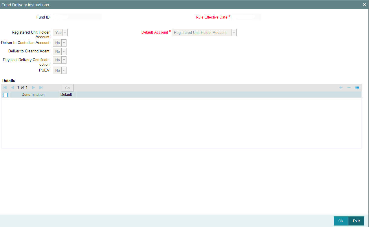

3.1.16 Fund Delivery Instructions Button
You can specify the fund delivery instructions details by clicking ‘Fund Delivery Instructions’ button in ‘Fund Rule Details’ screen.
Fund ID
Display
This field indicates the ID fund for which you are setting up the Fund Investment Account profile. This information is defaulted from the Fund Demographics screen.
Rule Effective Date
Display
Registered Unit Holder Account
Optional
Select if the unit holder account is registered or not from the drop-down list. The list displays the following values:
Deliver to Custodian Account
Optional
Select if the fund details are delivered to the custodian account or not from the drop-down list. The list displays the following values:
Deliver to Clearing Agent
Optional
Select if the fund details are delivered to the clearing agent or not from the drop-down list. The list displays the following values:
Physical Delivery - Certificate Option
Optional
Select if the certificate-based funds are physically delivered along with certificates to the customer or not from the drop-down list. The list displays the following values:
PUEV
Optional
Select if PUEV option is yes or not from the drop-down list. The list displays the following values:
Default Account
Optional
Select the default account options from the drop-down list. The list displays the following values:
Details
Denomination
Alphanumeric; 200 Characters; Optional
Specify the denomination details.
Default
Optional
Select if the denomination details are defaulted or not from the drop-down list. The list displays the following values:

3.1.18 SI Specific Information Button
In this section, you can maintain the rules for standing instruction generation that are to be applicable for the fund. Click ‘SI Details’ button in ‘Fund Rules Detail’ screen. The following window is displayed:
Fund ID
Display
Rule Effective Date
Display
Details
Transaction Type
Specify the transaction type for which the amount limitations are to be maintained. Alternatively, you can select the transaction type from the option list. The list displays all the valid transaction type maintained in the system.
Account Type
Specify the account type for which the amount limitations are to be maintained. Alternatively, you can select the account type from the option list. The list displays all the valid account type maintained in the system.
Holiday Rule
Mandatory
Calendar Basis
Mandatory
Mandatory
SI Description
Specify the SI description.
Specific Gen.Day
SI Generation Freq.
Mandatory
SI Minimum Amount
Specify the SI minimum amount.
SI Maximum Amount
Specify the SI maximum amount.
SI Minimum Units
SI Maximum Units
SI Cut-Off Day
SI Cut-off Lag
Enforce Generation
Mandatory
Max. Validity(Days)
Max No. of SI Txns
Last Day of SI Gen Cycle
Optional
Select if last day of SI generation cycle to be considered from the drop-down list. The list displays the following values:

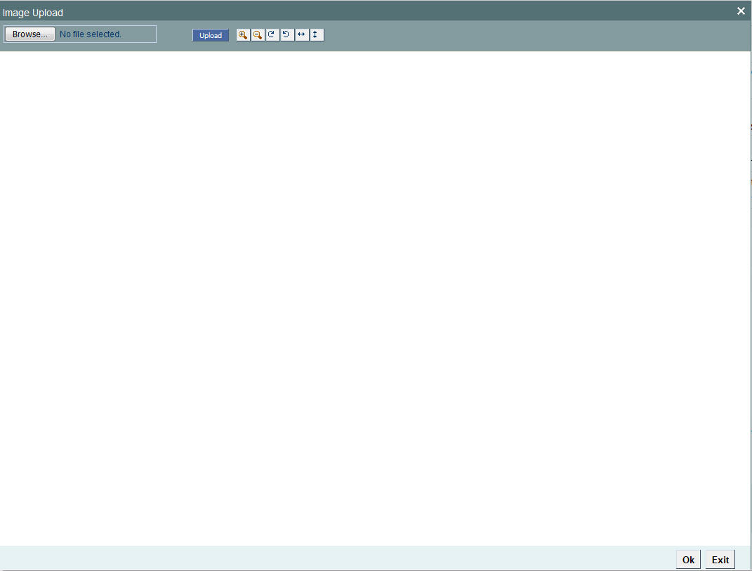

3.1.20 Documents Button
Click ‘Documents’ button in ‘Fund Rules Detail’ screen to upload the documents.
You can upload the required documents by clicking ‘Upload’ button.
3.1.21 Hedge Fund Tab
You can specify the fund rules associated with hedge funds in ‘Hedge Fund Processing Rules’ screen. To invoke this screen click ‘Hedge Fund’ button in Fund Rules detail screen. You can click this button only if the related fund has been specified as a hedge fund.
General Details
Hedge Fund Type
Optional
Select the type of the hedge fund from the drop-down list provided. The following options are available:
Note
For more details on various methods of performance fee computation, refer the section titles
‘Computing Performance Fee for Hedge Funds’ section in this user manual.
For more details on different types of hedge funds, refer Overview chapter in this user manual.
Hedge Fund Manager
Specify the name of the hedge fund manager or select the fund manager from the option list provided. All entities maintained as fund managers in ‘Entity maintenance’ screen are displayed in the list.
Transaction Generation Basis
Optional
Select the criteria based on which the transaction has to be generated. The following options are available in the drop-down list:
Note
This is applicable for master funds and fund of funds.
Master Fund UH ID
Specify the unit holder Id for which the master fund transaction is generated.
You can also query for unit holder ID by clicking ‘Find UH’ button.
Note
This is applicable only for master funds.
Performance Fee Details
Performance fee is a periodic fee collected by the fund manager from the investors of the fund, calculated as a percentage of the fund’s profit.
In this section you can specify your preferences related to performance fee calculation. The values you specify here are not applicable for side pocket type of hedge funds.
Group ID
Specify the rule group to be used for performance fee calculation or select the same from the option list provided. All valid rule groups maintained in the system are displayed in the option list.
Description
Display
The description associated with the selected rule group gets displayed here.
Computation Method
Specify the computation method to be used for performance fee calculation or select the same from the option list provided. The following options are available in the option list:
Description
Display
The description associated with the computation method selected, gets displayed here.
Performance Fee %
Specify the percentage of the fund value that needs to be given as the performance fee.
Payment Frequency
Optional
Select the frequency of payment of performance fee from the options provided in the drop-down list:
Accrual Frequency
Optional
Select the frequency of accrual of performance fee from the options provided in the drop-down list:
Next Accrual Date
Specify the date on which the accrual of the performance fee should happen next. You need to specify this value only once during initial fund setup.
For subsequent accruals, this date gets displayed automatically based on the accrual frequency.
Next Payment Date
Specify the date on which the payment of the performance fee should happen next. You need to specify this value only once during initial fund setup.
For subsequent payments, this date gets displayed automatically based on the accrual frequency.
Last Accrual Date
Display
The system automatically displays the date on which performance fee accrual happened last.
Last Payment Date
Display
The system automatically displays the date on which performance fee was paid last.
Hurdle Rate Details
Hurdle rate is the minimum fund returns necessary for a hedge fund manager to start collecting performance fees. The hurdle rate is usually tied to a benchmark rate such as LIBOR.
In this section you can specify details related to hurdle rates used for performance fee calculation. The values you specify here are not applicable for side pocket type of hedge funds.
Hurdle Rate Applicable
Optional
Select the option to indicate whether hurdle rate is applicable for performance fee calculation. Select ‘Yes’ from drop-down list to indicate that hurdle rate needs to be considered for performance fee calculation and ‘No’ to indicate otherwise.
Hurdle Type
Optional
Select the type of hurdle from the options provided in the drop-down list. The following options are available:
Reset Hurdle
Optional
Select ‘Yes’ from the drop-down list to indicate that the hurdle rate needs to be reset and ‘No’ to indicate otherwise. Hurdle rate gets reset if the fund price at the end of the performance fee calculation fee period is greater than the total of High Water Mark and hurdle rate.
Note
This is applicable only for ‘Cumulative’ type of hurdles.
Hurdle Rate Type
Optional
Select the type of hurdle rate from the options provided in the drop-down list. The following options are available:
Hurdle Calculation Method
Optional
Select the method to be used for calculating the hurdle rate. The following options are available in the drop-down list:
Rate Code
Specify the interest rate code to be used for hurdle rate calculation. You can also select the rate code from the option list provided.
Note
This is applicable only for hurdle rates of type ‘Variable’ or ‘Semi-variable’.
Day Basis
Optional
Select the basis on which the number of days is considered for hurdle rate calculation. The following options are available in the drop-down list:
Rate Basis
Optional
Select the basis on which the hurdle rate is calculated from the following options available in the drop-down list:
Rate
Specify the value associated with the rate code that is considered for computing the hurdle rate. If you have selected ‘Basis Points’ as rate basis, then a percentage value of this basis point is considered for computing the hurdle rate.
3.1.21.1 Fund Linkage Details Tab
You can indicate the linkages of a fund in this section. You can specify the following details here:
Hedge Fund ID
Alphanumeric; 6 Characters; Mandatory
Specify the fund ID of the linked fund or select the linked fund ID from the option list provided. For master funds, this list will display the list of feeder funds and for fund of funds this list will display the list of underlying funds.
If the hedge fund type is specified as ‘Follow-up Series’, you can specify the fund ID of the related ‘Lead Fund’ here.
Note
For side pocket funds the main fund name is captured here with the percentage specified as blank.
Fund Name
Display
The name of the selected fund gets displayed here.
Percentage
Specify the percentage to be used for generating the underlying transaction.
Note
For fund of funds the sum of percentage of investment in each fund should not be greater than 100.
Unit Holder ID
Specify the unit holder ID for generating the underlying transaction.
Note
Unit Holder ID is applicable only for underlying funds in case of Fund.
3.1.21.2 Investor Category Details Tab
In this section, you can override the performance fee percentage details at the investor category level. Click ‘Investor Category Details’ tab to specify these details.
Investor Category
Specify the investor category of the unit holder or select the category from the option list provided. All unit holder categories existing in the system get displayed in the option list.
Investor Category Name
Display
The name associated with the investor category selected gets displayed here.
Performance Fee %
Specify the percentage of performance fee to be paid for the selected investor category. This value overrides the performance fee percentage specified generically.

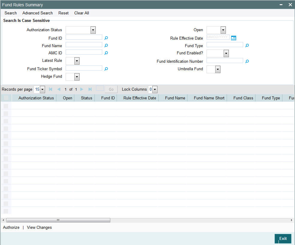

3.2 Fund Rules Summary Screen
3.2.1 Retrieving Record in Fund Rules Summary Screen
You can retrieve a previously entered record in the Summary Screen, as follows:
Specify any or all of the following details in the corresponding fields:
Click ‘Search’ button to view the records. All the records with the specified details are retrieved and displayed in the lower portion of the screen.
Note
You can also retrieve the individual record detail from the detail screen by querying in the following manner:
You can perform Edit, Delete, Amend, Authorize, Reverse, Confirm operations by selecting the operation from the Action list. You can also search a record by using a combination of % and alphanumeric value.
Example
You can search the record for Fund ID by using the combination of % and alphanumeric value as follows:

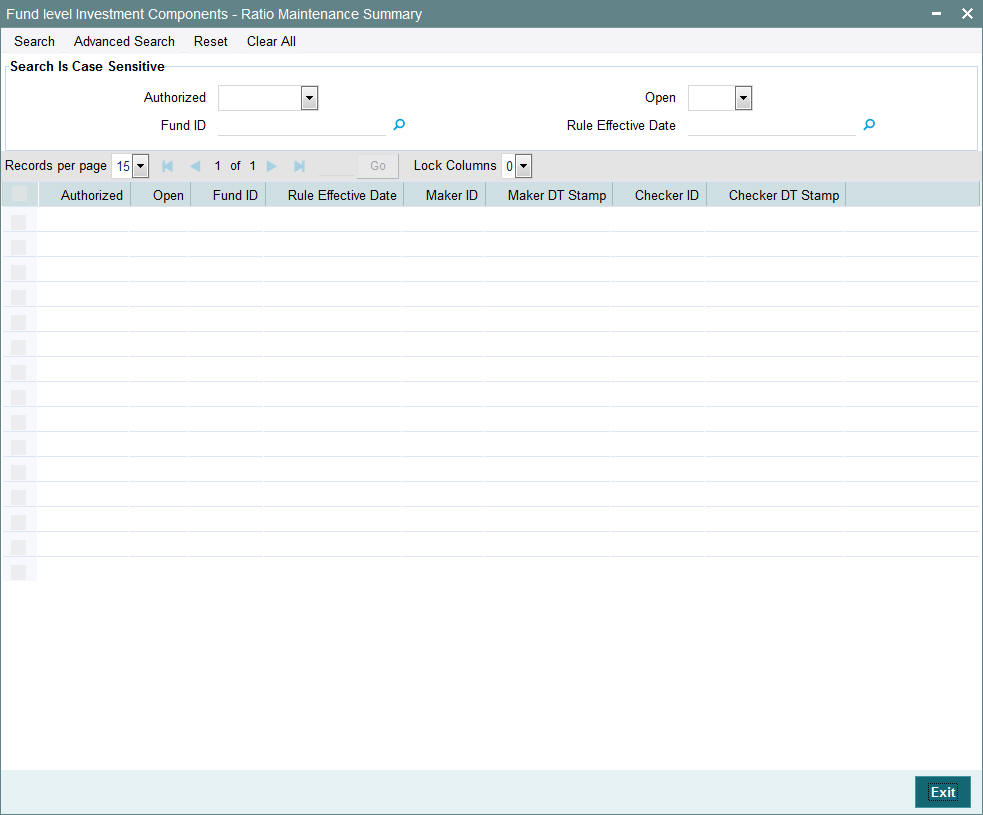

3.4 Fund Investment Component Summary Screen
3.4.1 Retrieving Record in the Fund Investment Component Summary Screen

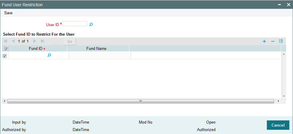

3.6 Fund User Restriction
3.6.1 Invoking Fund User Restriction Screen
You can restrict the user for particular fund using ‘Fund User Restriction’ screen. You can invoke this screen by typing ‘UTDFNDUS’ in the field at the top right corner of the Application tool bar and clicking on the adjoining arrow button.
User ID
Specify the user ID for which the funds are to be restricted for usage. Alternatively, you can select user ID from the option list. The list displays all valid user IDs maintained in the system.
Select Fund ID to Restrict For the User
Fund ID
Specify the fund ID for which the funds are to be restricted for usage. Alternatively, you can select fund ID from the option list. The list displays all valid fund IDs maintained in the system.
Fund Name
Display
The system displays the name of the selected fund ID.
