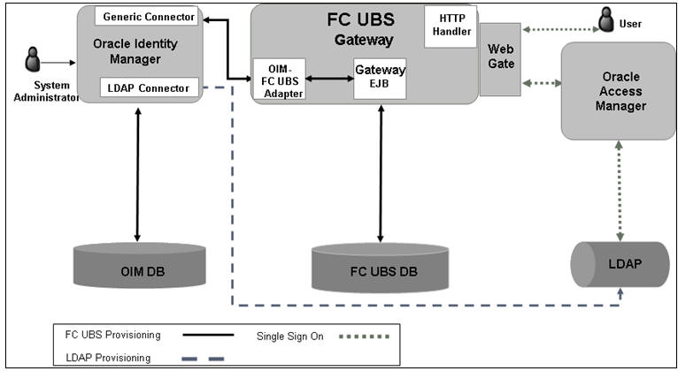

2.1 Oracle FLEXCUBE - Oracle Identity Manager Integra­tion
The integration between Oracle FLEXCUBE and Oracle Identity Manager is done via a Generic Technology Connector (GTC). The GTC provides for provisioning and reconciliation tasks via the following components:

2.2 Integration Deployment Configuration
The OIM- Oracle FLEXCUBE integration is designed to follow a Provisioning and Reconciliation deployment configuration. In this kind of deployment configuration the Oracle Identity Manager performs both provisioning and reconciliation tasks.

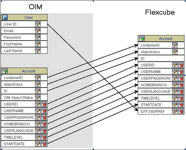

2.4.1 Data for User Provisioning
The data sent from OIM to Oracle FLEXCUBE for user provisioning will contain only the following:
The data sent from OIM to Oracle FLEXCUBE for user provisioning is illustrated below.

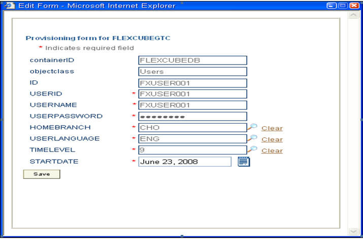

2.4.1.1 Collecting Data for User Provisioning
The data for provisioning is collected from the OIM user creation form. The fields to be collected - such as User ID, User Name and User Password – are defined in the ‘Provisioning form for Oracle FLEXCUBE GTC’.
The ‘Provisioning form for Oracle FLEXCUBE GTC’ is filled up by the OIM Administrator. OIM Administrator uses Direct Provisioning to provision Oracle FLEXCUBE to any OIM user.
The Field values like Name, Password, and User Id in the provisioning data form shall be pre-populated from the OIM user maintenance form.

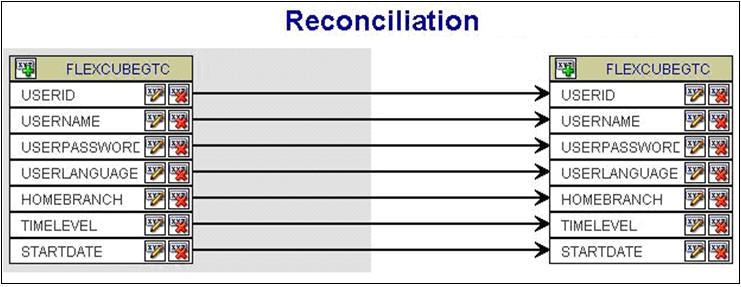

2.4.2 Data for Reconciliation
The data for reconciliation contains the same set of mandatory fields used for user provisioning.
2.4.2.1 Reconciliation File Handoff
The EOD activity ‘SMBOIMHF’ creates the handoff file for reconciliation. The handoff file will be in CSV (Comma Separated Values) format.

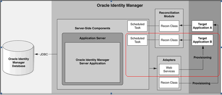

2.4.2.2 Reconciliation Process Flow
The Reconciliation process flow is illustrated in the diagram shown below.
