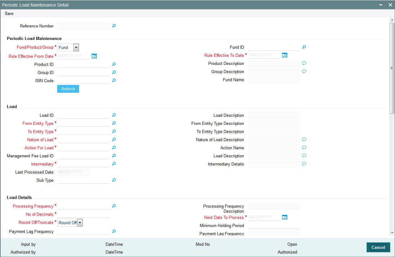

7.1 Periodic Load Maintenance
7.1.1 Invoking the Periodic Load Maintenance Screen
The Periodic Load Maintenance screen (shown below) facilitates the same. You can invoke the ‘Periodic Load Maintenance Detail’ screen by typing ‘UTDPERLM’ in the field at the top right corner of the Application tool bar and clicking on the adjoining arrow button.
Sub Type
Alphanumeric; 3 Characters; Optional
Specify the sub type to map the transaction sub type created earlier (69A or 69B or 86A) for Fee/incentive Transaction (‘69’/’86’) for given periodic load setup.
If the periodic fee is maintained at the product level, then during periodic load accrual, the amount in fund base currency gets converted to product base currency to derive the load slab.  The computation will happen in fund base currency.
On Authorization, of Periodic Load Maintenance, the system will support quarterly average holding method with yearly payment frequency only.
Transaction Choose Basis
Alphanumeric; 1 Character; Optional
Specify the transaction choose basis details. Alternatively, you can select transaction choose basis details from the option list. The list displays all valid transaction choose basis maintained in the system.
Transaction Choose Basis Description
Display
The system displays the description for the selected transaction Choose basis value as follows:
Refer to the chapter ‘Setting Up Loads’ in Volume I of the Fund Setup User Manual for further information on applying periodic load.
