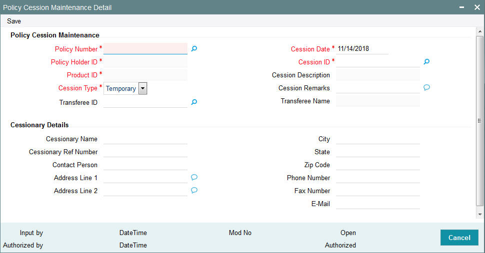

You can invoke the ‘Policy Cession Maintenance Detail’ screen by typing ‘LEDPLCES’ in the field at the top right corner of the Application tool bar and clicking on the adjoining arrow button.
You can specify the following fields in this screen:
In the Policy Cession Maintenance section, you will have to enter information in the following fields:
Policy Number
Alphanumeric; 16 Characters; Mandatory
Select the number of the Policy that must be marked with a Cession ID.
Note
This number must represent an authorized, enabled and active policy (for which at least one underlying transaction has been generated, authorized and allocated).
The Policy Number entered here must represent a Policy that comes under a Product that is authorized and active.
You can use the button alongside this field to view a list of valid policies and select the required one.
When you specify the Policy Number, all the details of the Policy are picked up from the policy record and populated in the corresponding fields in this form.
Cession Date
Display
The date on which the transfer is affected, is the Policy Cession Date. It is deemed to be the application date itself, which is displayed here by default. It cannot be changed.
Policy Holder ID
Display
The name and ID of the Policy Holder whose Policy is to be marked with a Cession ID, is displayed here.
Product ID
Display
The system displays the product ID.
Cession Type
Mandatory
Select the Cession Type that is to be applied to the specified Policy, from the drop-down list. The list displays the following values:
Note
If the type chosen here is ‘Temporary’, then only the Cession ID must be captured with remarks. If it is ‘Permanent’, then the Transferee ID must also be captured.
Cession ID
Alphanumeric; 3 Characters; Mandatory
Select the Cession ID that is to be applied to the specified policy, from the option list.
Note
The list will contain permanent cessions if the Cession Type specified is ‘Permanent’ and temporary cessions if the Cession Type chosen is ‘Temporary’.
Cession Description
Display
The system displays the description for the selected cession ID.
Cession Remarks
Alphanumeric; 255 Characters; Optional
You can capture any descriptive/narrative text pertaining to this Policy Cession record in this field.
Note
If the ‘Cession Applicable’ field at the ‘Product Level’ is checked in the ‘Cession Mainte­nance’ screen, the system will allow the policies under this product for Policy Cession Maintenance.
Transferee ID
Alphanumeric; 12 Characters; Optional
Select, from the option list, the ID of the Policy Holder to whom the policy must be transferred, when it is marked with the specified Cession ID. This must be a valid Unit Holder in the system, and must not have a Policy in the same Product.
Transferee Name
Display
The system displays the transferee name for the selected transferee ID.
Cessionary Details
In the Cessionary Details section, you will have to enter information in the following fields:
Cessionary Name
Alphanumeric; 60 Characters; Optional
Specify the name of the cessionary (policy-holder ceding the policy).
Cessionary Ref Number
Alphanumeric; 16 Characters; Optional
Specify a unique reference number that will be used to identify the transaction in the system.
Contact Person
For corporate investors, enter the name of the contact person at the cessionary office.
Address Lines 1-2
Alphanumeric; 255 Character; Optional
Specify the postal address that is to be used for correspondence with the cessionary.
City
Alphanumeric; 40 Characters; Optional
Specify the name of the city of residence of the cessionary.
State
Specify the state in which the city of residence of the investor is cessionary.
Zip Code
Alphanumeric; 10 Characters; Optional
Specify the zip code of the specified city of residence of the cessionary.
Phone Number
Alphanumeric; 15 Characters; Optional
Enter the contact telephone numbers of the cessionary.
Fax Number
Enter the fax number of the cessionary.
E-Mail ID
Alphanumeric; 30 Characters; Optional
Specify the Email address of the cessionary.
9.1.2 Saving Information Entered
When you have entered all the mandatory information, click ‘Ok’ button.
The following message will be displayed:
The system displays the confirmation message “Record Successfully Saved”.

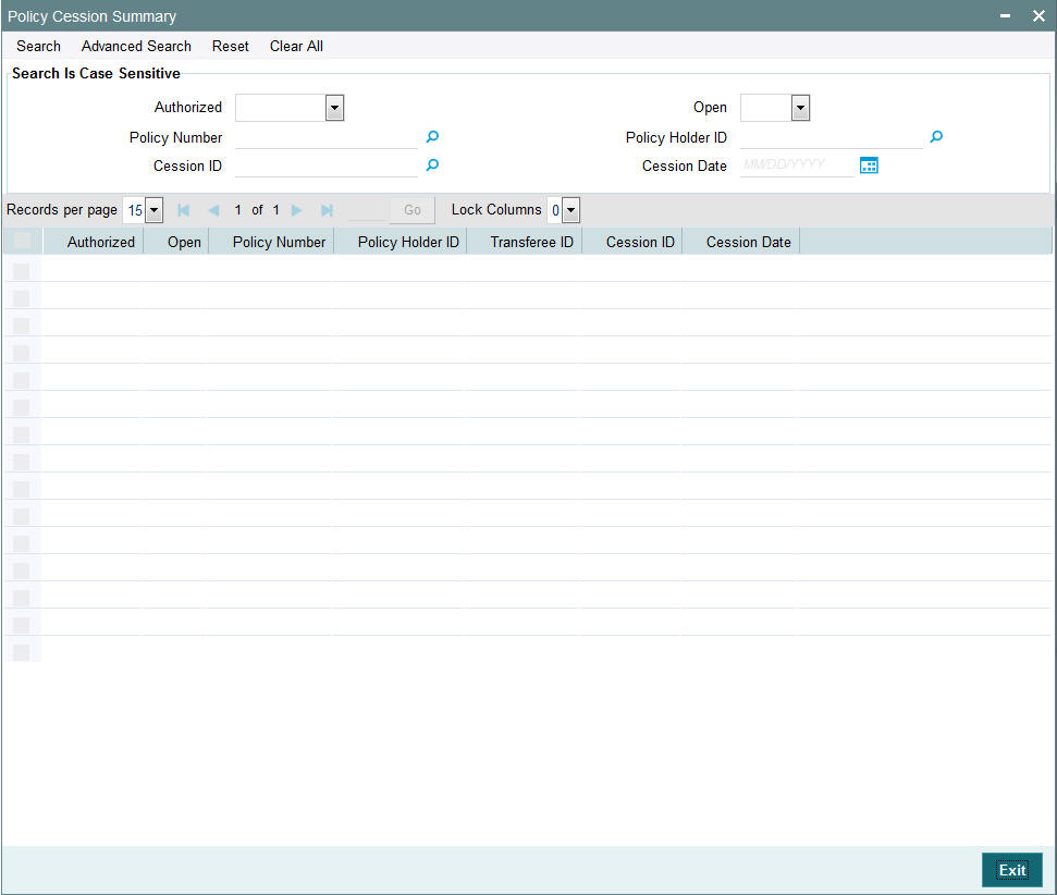

9.2 Policy Cession Summary Screen
9.2.1 Retrieving Policy Cession in Policy Cession Screen
You can retrieve a previously entered record in the Summary screen, as follows:
You can invoke the ‘Policy Cession Summary’ screen by typing ‘LESPLCES’ in the field at the top right corner of the Application tool bar and clicking on the adjoining arrow button
Specify any or all of the following details in Policy Cession Summary screen:
After you have specified the required details, click ‘Search’ button. All records with the specified details are retrieved and displayed in the lower portion of the screen.
Note
You can also retrieve the individual record detail from the detail screen by doing query in the following manner:
You can perform Edit, Delete, Amend, Authorize, Reverse, Confirm operation by selecting from the Action list.
You can also search the record by using combination of % and alphanumeric value.
Example:
You can search the record for Product Type by using the combination of % and alphanumeric value as follows:
