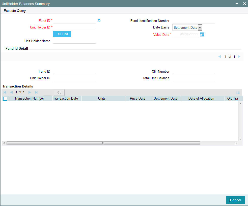

In the ‘UnitHolder Balances Summary’ screen, you can query the database to obtain fund-wise balances of unit holders, as of a price date or settlement date. You can invoke this screen by typing ‘UTDUHBAL’ in the field at the top right corner of the Application tool bar and clicking on the adjoining arrow button.
As of a price date or a settlement date, you can view the balances for:
To obtain the required balances for viewing in this screen, you must specify the following information that would be used as search criteria:
Fund ID
Alphanumeric; 6 Characters; Mandatory
Specify the ID of the fund for which you require to view the unit holder balances. Alternatively, you can select fund ID from the option list. The list displays all valid fund ID maintained in the system.
Fund Identification Number
Display
The system displays the fund identification number.
Unit Holder ID
Alphanumeric; 12 Characters; Mandatory
Specify the ID of the unit holder for which you wish to view fund-wise balances as of the indicated date. You can also query for unit holder ID by clicking on ‘UH Find’ button.
Unit Holder Name
Display
The system displays the name of the selected unit holder ID.
Date Basis
Optional
Select whether you wish to view the balances as of a price date or a settlement date from the drop-down list. The list displays the following values:
Value Date
Date Format; Mandatory
Select the value date from the adjoining calendar.
The following details are displayed in the Fund ID Detail portion of the Unit Holder Balances screen:
You can view a transaction-wise breakup details for the unit balance, in the Transaction Details section:

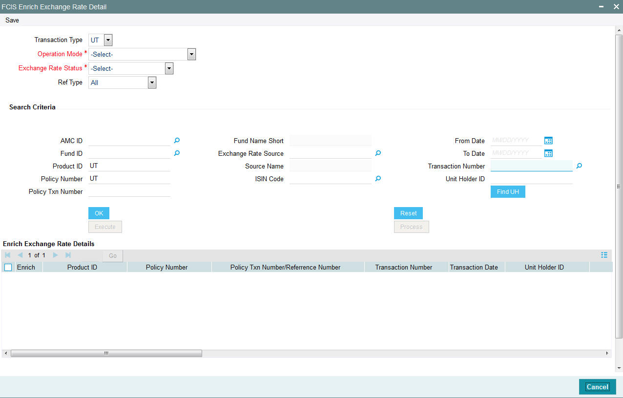

Transaction Enrichment
The process of entering the exchange rate for an exchange rate incomplete transaction is known as Exchange Rate Enrichment.
Why must enrichment be performed?
A transaction can only be picked up by the End of Day process for allocation of units only if it is authorized and all necessary details are present in the transaction record. If the exchange rate is not available, the equivalent transaction amount in fund base currency cannot be computed. In the event of the transaction being authorized before the exchange rate details are specified, it must be made “exchange rate-complete” before it can be picked up subsequently for allocation.
When to perform enrichment?
Exchange rate enrichment must be performed as a mandatory procedure before an exchange rate incomplete transaction is allocated.
Exchange rate enrichment must also be performed for authorized transactions generated due to a standing instruction.
You can specify the exchange rate for exchange rate incomplete transactions in the ‘FCIS Enrich Exchange Rate Detail’. You can invoke this screen by typing ‘UTDTXNEE’ in the field at the top right corner of the Application tool bar and clicking on the adjoining arrow button.
Enrich the exchange rate details in this screen as follows:
Transaction Type
Optional
Select the type of transaction from the drop-down list. The list displays the following values:
If u choose UT only incomplete UT transactions will be displayed for enrichment. If you choose LEP and mention the ‘Product ID’ and ‘Policy Number’, then all the underlying incomplete UT transactions of the particular policy will be available enrichment.
Operation Mode
Mandatory
Select the mode of operation from the drop-down list. The list displays the following values:
If you select ‘Enrich Exchange Rate’ or ‘Authorize’ option, then ‘Exchange Rate Status’ and ‘Ref Type’ fields will be disabled. Also ‘Execute’ and ‘Process’ buttons will be disabled.
Mandatory
Select the exchange rate status from the drop-down list. The list displays the following values:
If the transaction for which you are entering the exchange rate is an authorized transaction for which the exchange rate has not been entered, select ‘Incomplete’ option.
Ref Type
Optional
Select the ref type from the drop-down list. The list displays the following values:
AMC ID
Alphanumeric; 12 Characters; Optional
Specify the AMC ID. Alternatively, you can select AMC ID from the option list. The list displays all valid AMC ID maintained in the system.
Fund ID
Alphanumeric; 6 Characters; Optional
Specify the fund ID. Alternatively, you can select fund ID from the option list. The list displays all valid fund ID maintained in the system.
Fund Name Short
Display
The system displays the short fund name for the selected fund ID.
Product ID
Alphanumeric; 10 Characters; Optional
Specify the product ID. Alternatively, you can select product ID from the option list. The list displays all valid product ID maintained in the system.
This field is enabled only if you have selected ‘Transaction Type’ as ‘LEP’.
Policy Number
Alphanumeric; 16 Characters; Optional
Specify the policy number. Alternatively, you can select policy number from the option list. The list displays all valid policy number maintained in the system.
Policy Txn Number
Specify the policy transaction number. Alternatively, you can select policy transaction number from the option list. The list displays all valid policy transaction number maintained in the system.
Exchange Rate Source
Specify the exchange rate source. Alternatively, you can select exchange rate source from the option list. The list displays all valid exchange rate source maintained in the system.
Source Name
Display
The system displays the source name for the selected exchange rate source.
ISIN Code
Specify the ISIN code. Alternatively, you can select ISIN code from the option list. The list displays all valid ISIN code maintained in the system.
If you specify the fund ID, the system displays ISIN code and vice versa.
From Date
Date Format; Optional
Select the From date from the adjoining calendar.
To Date
Select the To date from the adjoining calendar.
Transaction Number
Specify the transaction number. Alternatively, you can select transaction number from the option list. The list displays all valid transaction number maintained in the system.
Unit Holder ID
Specify the unit holder ID.
You can query unit holder ID by clicking ‘Find UH’ button.
Clicking ‘Execute’ button, the system displays the following enrich exchange rate details:
This button will be enabled only if you have selected ‘Bulk Exchanged Rate Enrichment’ and ‘View Enrich Exchange Rate’ option in ‘Operation Mode’ field.
Click ‘Process’ button to process the exchange rate. This button will be enabled only if you have selected ‘Bulk Exchanged Rate Enrichment’ and ‘View Enrich Exchange Rate’ option in ‘Operation Mode’ field.
After specifying the necessary details, click ‘Ok’ button. This button will be enabled only if you have selected ‘Enrich Exchange Rate’ and ‘Authorize’ option in ‘Operation Mode’ field.
You can reset by clicking ‘Reset’ button. This button will be enabled only if you have selected ‘Enrich Exchange Rate’ and ‘Authorize’ option in ‘Operation Mode’ field.
Click ‘Authorize’ button to authorize the transaction.
Bulk Exchange rate enrichment is performed for authorized but un-allotted transactions in the system. To perform bulk update of exchange rates select ‘Bulk Exchange Rate Enrichment’ in the operation field.
Certain other fields will be displayed in this screen if you choose the operation as ‘Bulk Exchange Rate Enrichment’.
To invoke this screen type UTDTXNEE in the field at the top right corner of the Application tool bar and clicking on the adjoining arrow button.

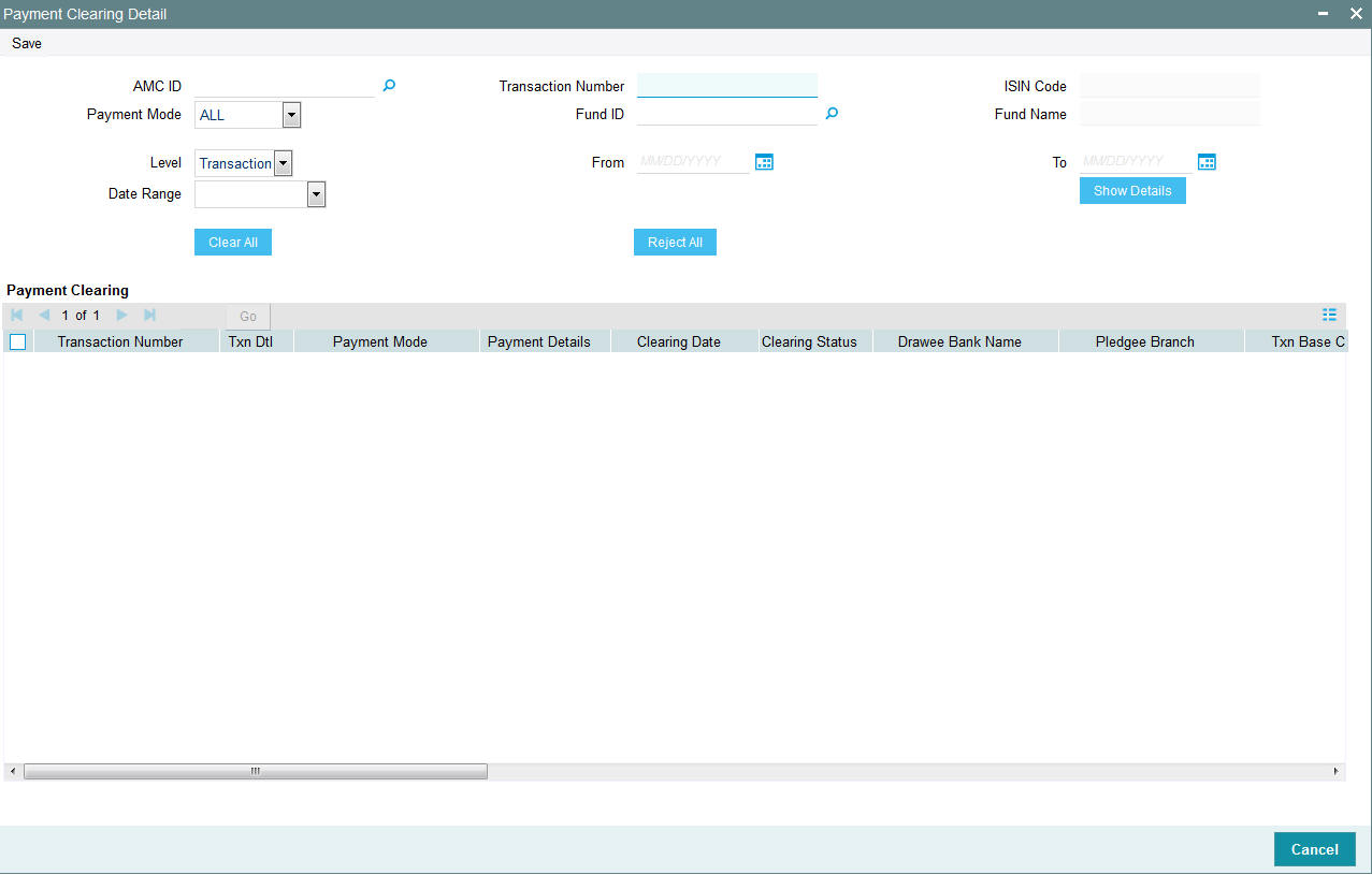

The system provides the facility to keep track of the clearing status of payment instruments for transactions, or, in the case of LEP (Life and Endowment Products), on a policy level, on an online basis.
To update the clearing status of a payment, use the ‘Payment Clearing Detail’ screen. You can invoke this screen by typing ‘UTDPYCLR’ in the field at the top right corner of the Application tool bar and clicking on the adjoining arrow button.
To update the clearing status of a payment instrument for a transaction in the Payment Clearing screen, do as follows:
AMC ID
Payment Mode
Optional
Select mode of payment from the drop-down list, specified for the transaction for which you want to update the clearing status of the payment instrument. The list displays the following values:
Level
Optional
Select transaction level from the drop-down list. The list displays the following values:
Date Range
Optional
Select range of dates from the drop-down list that would signify the period between which the transaction date or the allotted date of the transaction would be found. The list displays the following values:
Transaction Number
Fund ID
ISIN Code
Display
The system displays the ISIN code for the selected fund ID.
Fund Name
Display
The system displays the fund name for the selected fund ID.
From
To
Click ‘Show Details’ button to view the following payment clearing details:
Click ‘Clear All’ button to clear the instruments displayed. Click ‘Reject All’ button to reject the instrument details. Depending on what you choose, either Clear All or Reject All, the clearing status field under the Payment Clearing grid will display the clearing status
After marking as many instruments as necessary for clearing or rejection, click the Save button to save your changes.
The following details are displayed in the Payment Clearing screen:
After you have updated the clearing status for a transaction payment instrument, another user must authorize the clearing status, for it to be effective in the system data stores.
To authorize a clearing status in the Payment Clearing screen, do as follows:
Clearing Status
3 Character, Alphanumeric, Mandatory
Select Clear to mark the check as Cleared. Select Reject to mark the check as Returned / Rejected.
Clearing Date
Date, Mandatory
Specify the date on which the clearing takes place. By default, the clearing date is deemed to be the application date.
Remarks
255 Characters Maximum, Alphanumeric, Mandatory
Specify any relevant remarks regarding the clearing status.

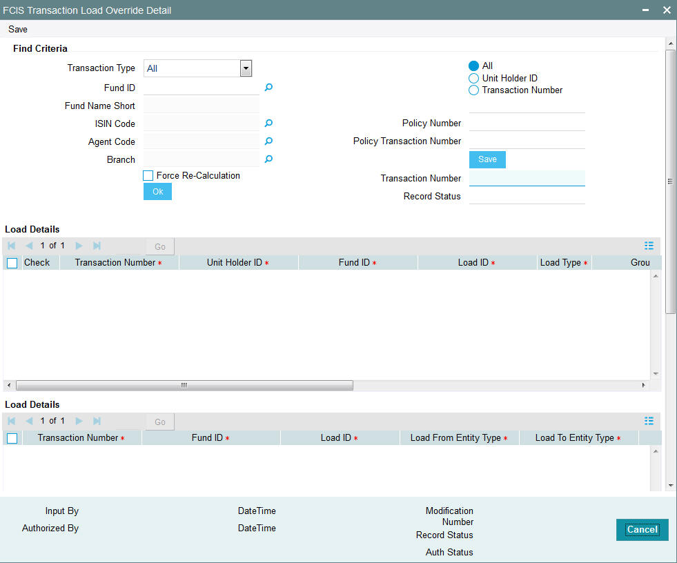

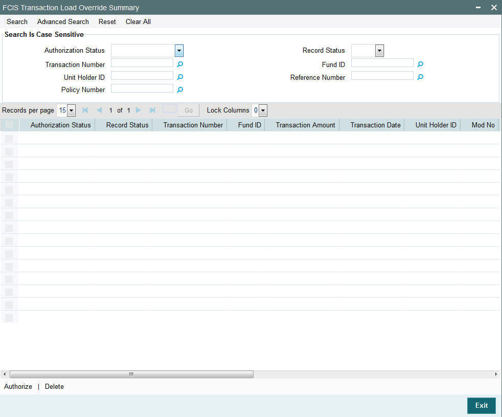

In FLEXCUBE Investor Services, you have the facility of changing the return value or final amount value of a load (charge) that is applicable for a transaction requested by an investor.
To override such a load, use the ‘FCIS Transaction Load Override Detail’ screen. You can invoke this screen by typing ‘UTDTXNLO’ in the field at the top right corner of the Application tool bar and clicking on the adjoining arrow button.
To override a load, do as follows:
Retrieve the record of the load that you want to override by specifying search parameters. You can specify any or all of the following to enable the search:
Transaction Type
Optional
Choose one of the following options and enter the associated number for the selected option in the text box below:
Fund ID
Specify the fund ID in which the transaction was put through, for which you want to override a load. Alternatively, you can select fund ID from the option list. The list displays all valid fund ID maintained in the system.
Fund Name Short
Display
ISIN Code
If you have specified Fund ID, then the system displays the ISIN code for the specified fund ID and vice versa.
Agent Code
Specify the agent code. Alternatively, you can select agent code from the option list. The list displays all valid agent code maintained in the system.
Branch
Specify the branch code. Alternatively, you can select branch code from the option list. The list displays all valid branch code maintained in the system.
Force Re-Calculation
Optional
Check this box to enable force re-calculation.
Policy Number
Policy Transaction Number
Transaction Number
Display
The system displays the transaction number.
Record Status
Alphanumeric; 1 Character; Optional
Specify the record status.
When you have specified your criteria, click ‘Save’ button to save the details. Click ‘Ok’ button to view the following details:
The system displays the following Load Details for the selected transaction number:
Investor
Display Only
The ID of the unit holder who has made the transaction is displayed here.
Transaction Number
Display Only
In this field, the transaction numbers of the transactions, based on the selection criteria, are displayed
Fund ID
Display Only
The ID of the fund on which the transaction has occurred is displayed here
Original Return Value
Display Only
The original return value percentage of each of the applicable loads before the override is displayed here.
Original Load Amount
Display Only
The original load amount of each of the applicable loads before the override is displayed here, after being calculated based on the return value.
You are allowed to override the following details in this section:
Override Return Value
Numeric, 30 Characters; Optional
Enter a value to override the original Return Value for the given load, for the given transaction. If nothing is entered then the Return Value will be taken as it is for allocation purposes provided the Override Load Amount is not changed. If the Return value specified is a percentage, you can override this percentage too.
If the Load Amount is changed, the change is also reflected in the Load Return Value field.
Enter an amount to override the original Load Amount for the given load, for the given transaction. If nothing is entered then the Load Amount will be taken as it is for allocation purposes provided the Override Return Value is not changed.
If the Load Return Value is changed, the change is also reflected in the Load Amount field.
To Override
Optional
Indicate one of the following to indicate your preference for overriding, from the drop-down list:
You can check against the transaction number for which transaction is done in the check box.,
If the load is criteria based, the criteria will be displayed in the Load Details screen.
If any derived loads are applicable, they are also displayed and can be overridden.
Load Type
Display Only
The type of load, indicating whether it is a fee or an incentive, is displayed here.
Transaction Amount
Display Only
The transaction amount of the given transaction is displayed here.
Calculation Method
Display Only
This field displays the Calculation Method (either Slab, Linear or Weighted) for the particular Load.
Amount/Percent
Display Only
This Field displays whether the Return Value is displayed in Amount or Percentage.
Display Only
The original return value of each of the applicable loads before the override is displayed here, either as a percentage or a load amount.
Click the OK button to save your changes.
The following must be borne in mind at a general level, while carrying out load overrides in this screen:
Let us suppose that the Transaction Price is 10, and the load percentage is 5%. The amount displayed is as follows:
5% of 10=0.5.per unit.
If the load is not loaded to price, then the actual load amount is displayed here. Considering the same example above, If the transaction amount is 1000 currency units, and the load percentage is 5%, with the load not loaded to price, the load amount displayed is as follows:
5% of 1000=50 currency units.
When you open the load override screen for the first time (i.e., before any load overrides have been performed) and retrieve some load records, the computed load amounts are not displayed in the Amount/Return Value fields in the Txn Load Override screen. This will be so if you have not checked the Force Recalculation? field check box in the main Transaction Load Override screen. To indicate to the system that load computation must be done, you must Select this option. When you do so, the original computed loads, before any overrides, is displayed in the Return Value/Amount fields in the Txn Load Override screen.
After you perform the load overrides and override some or all of the retrieved loads, the overridden load records are saved as unauthorized load overrides. At this stage, when you open the Load Override screen and retrieve the overridden load records by specifying search criteria, you have the following options:

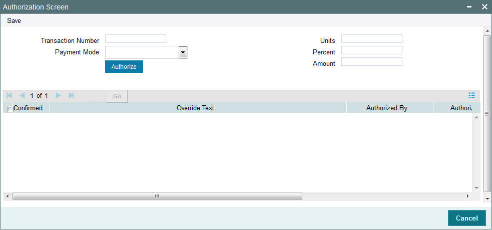

If a load override that is performed is subsequently authorized, then you will not be able to retrieve it through specifying search criteria.
A user other than the one who performed the override must authorize any override of a load.
To authorize a load override, use the Transaction Load Override Authorization screen. You can access this screen by clicking the Summary option in the Txn Load Override menu item in the Transactions Input menu category of the Agency Branch main menu.
When you open this screen, the load overrides that have been exercised, that are pending authorization, are displayed along with their details.
Mark each override you want to authorize by selecting the Authorize option in the Authorize field against the required override row.
After you have marked as many records as necessary for authorization, click the Authorize button to effect the authorization.
You can retrieve a previously entered record in the Summary Screen, as follows:
Invoke the ‘FCIS Transaction Load Override Summary’ screen by typing ‘UTSTXNLO’ in the field at the top right corner of the Application tool bar and clicking on the adjoining arrow button and specify any or all of the following details in the corresponding details.
Click ‘Search’ button to view the records. All the records with the specified details are retrieved and displayed in the lower portion of the screen.
Note
You can also retrieve the individual record detail from the detail screen by querying in the following manner:
You can perform Edit, Delete, Amend, Authorize, Reverse, Confirm operations by selecting the operation from the Action list. You can also search a record by using a combination of % and alphanumeric value
You can modify the details of Transaction Load Override record that you have already entered into the system, provided it has not subsequently authorized. You can perform this operation as follows:
Click Save to save your changes. The FCIS Transaction Load Override Detail screen is closed and the changes made are reflected in the FCIS Transaction Load Override Summary screen.
To view a record that you have previously input, you must retrieve the same in the FCIS Transaction Load Override Summary screen as follows:
You can delete only unauthorized records in the system. To delete a record that you have previously entered:
When a checker authorizes a record, details of validation, if any, that were overridden by the maker of the record during the Save operation are displayed. If any of these overrides results in an error, the checker must reject the record.
After a FCIS Transaction Load Override record is authorized, it can be modified using the Unlock operation from the Action List. To make changes to a record after authorization:
An amended FCIS Transaction Load Override record must be authorized for the amendment to be made effective in the system. The authorization of amended records can be done only from Fund Manager Module and Agency Branch module.
The subsequent process of authorization is the same as that for normal transactions.

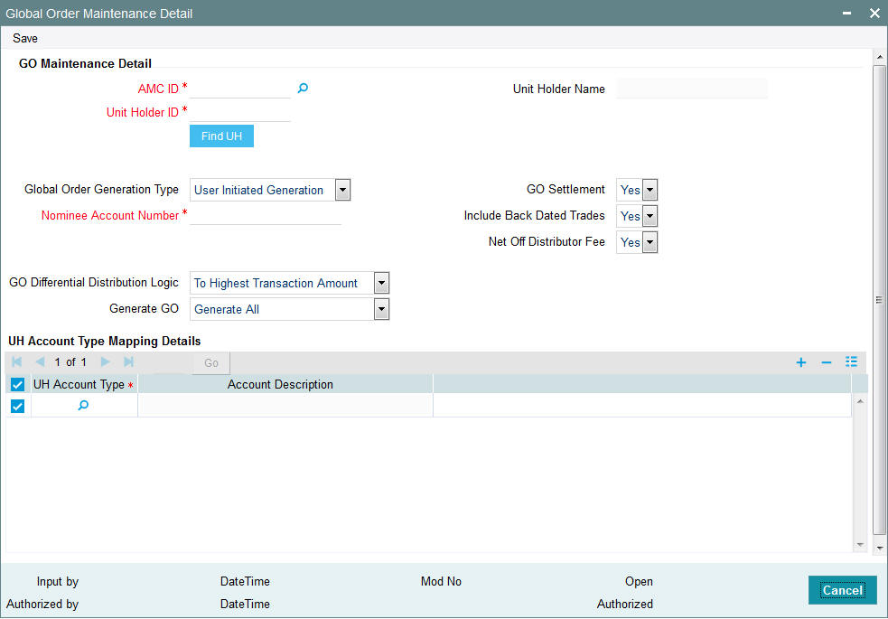

Global Order is a process where a distributor bulks their investor’s transactions including Subscriptions, Redemptions and send to the Asset Management Companies or to the Fund Houses as a single Transaction for processing before the funds cut-off time on daily basis. The distributors generally will have an identification number with the fund houses or AMC’s which is called as Nominee Account Number. On receipt of a bulk order or GO from the distributor, the fund house will confirm the units allotted to this distributor or to the Nominee Account. On receipt of confirmation from fund house, distributor will then confirm the global order at his end. If there is any discrepancy in global order, then global order will go through a reconciliation mechanism to address the difference. Once the discrepancy, if any, is resolved, distributor will allocate units to underlying unit holders.
The GO will be grouped according to Fund, transaction type (subscription and redemption), transaction mode (units/amount), Transaction Category (Advised, Execution and Legacy), Account type, Indicator (gross/Net) and transaction date. This is applicable for daily price funds. For non daily price funds, the system will generate separate GO which will not include Transaction date in grouping.
You can maintain Global Order set up using ‘Global Order Maintenance Detail’ screen. To invoke this screen, type ‘UTDGOMNT’ in the field at the top right corner of the Application tool bar and clicking on the adjoining arrow button.
Select 'New' from the Actions menu in the Application tool bar or click new icon to enter the details of the ‘GO Maintenance Detail’ screen.
AMC ID
Specify the AMC for which the GO is maintained. You can also select the valid AMC ID from the adjoining option list.
Unit Holder ID
Specify the Unit Holder for which the GO is maintained.
You can also query for unit holder ID by clicking ‘Find UH’ button.
Unit Holder Name
Display
The system displays the unit holder name for the selected Unit Holder ID.
Global Order Generation Type
Optional
Select the Global Order generation type from the drop-down list. Following are the options available in the drop-down list:
GO Settlement
Optional
Select the GO Settlement details from the drop-down list. Following are the options available in the drop-down list:
Alphanumeric; 16 Characters; Mandatory
Specify the nominee account number.
Include Back Dated Trade
Optional
Select if back dated trade is included from the drop-down list. Following are the options available in the drop-down list:
Net Off Distributor Fee
Optional
Select if distributor fee is netted off or not from the drop-down list. Following are the options available in the drop-down list:
GO Differential Distribution Logic
Optional
Select the GO differential distribution logic from the drop-down list. Following are the options available in the drop-down list:
If you maintain distribution logic as ‘To Highest Transaction Amount’ then the differential units will be adjusted to the transaction which has the highest transaction amount.
If you maintain distribution logic as ‘Highest Transaction Amount to Lowest’ then the system will distribute the difference amount from the highest transaction amount to the lowest in step up units.

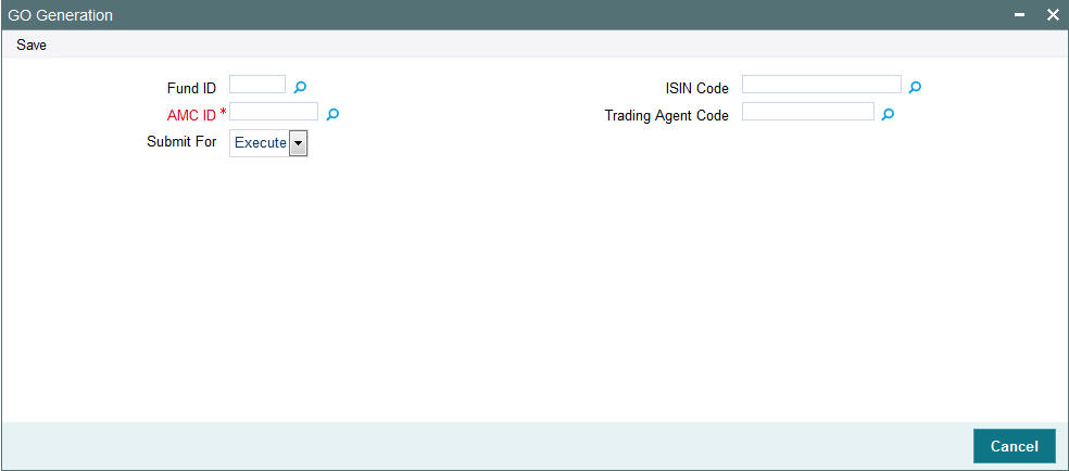

Generate GO
Optional
Select if all the GO should be generated or GO as per transaction category should be generated from the adjoining drop-down list. Following are the options available:
UH Account Type
Alphanumeric; 2 Characters; Mandatory
Specify the UH account type. You can also select the valid account type from the adjoining option list.
Account Description
Display
The system displays the description for the selected UH account type.
Once GO is generated, the system will generate subscription multiple order generation message (SWIFT) /redemption multiple order generation message for subscription/redemption global orders respectively as per the Swift pooling frequency defined in the system.
For non daily priced funds, the system will generate GO as per transaction cut-off date and it will take trade cycle override into account while generating GO.
In case for a trade TBC is different from FBC the system will only pick trades for which exchange rate is available. Exchange rate required to be maintained for the trades where exchange rate is not available. If no exchange rate is available for the trades where TBC is different from FBC then those trades will not be picked for GO.
The system will run a pre EOD batch to check if all trades for a given date have been sent across in a GO which will be based on price date.

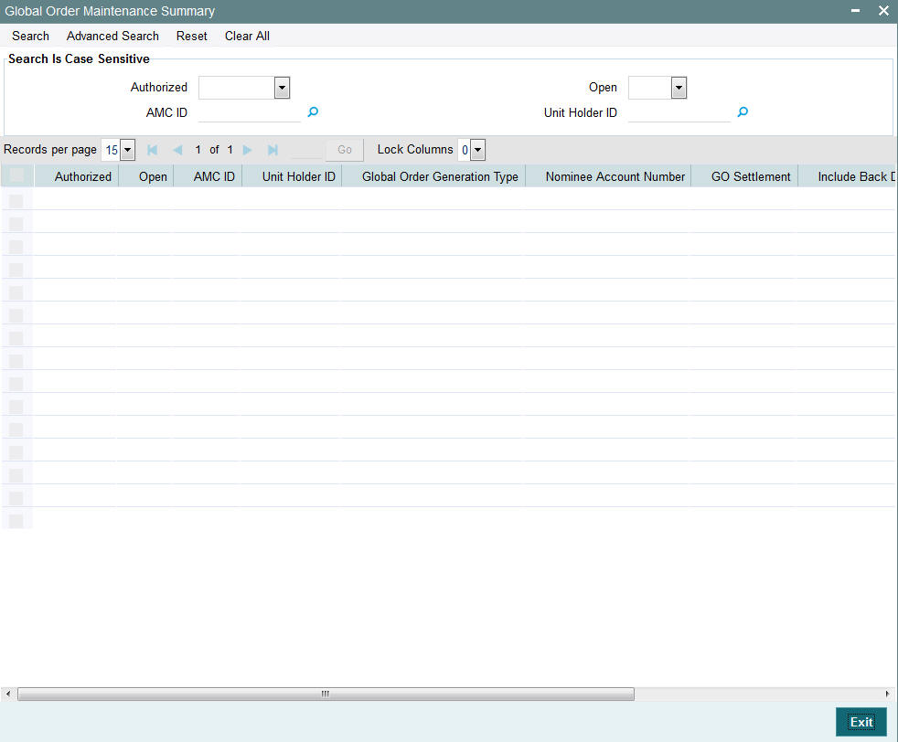

You can view Global Order details using ‘GO Maintenance Summary’ screen. To invoke this screen, type ‘UTSGOMNT’ in the field at the top right corner of the Application tool bar and clicking on the adjoining arrow button.
You can retrieve previously entered Global Order Maintenance as follows:
After retrieving a record, you can perform the following actions in the Global Order Maintenance Detail screen:
To view a record that you have previously entered, you must retrieve the same in the ‘Global Order Maintenance Summary’ screen, as follows:
You can modify the Global Order details that you have already entered into the system, provided it has not been subsequently authorized. You can perform this operation as follows:
Note
The maker of the record can only delete the unauthorized record.
Apart from the maker, someone else must authorize an unauthorized global order record deal in the system for it to be processed. To authorize a record:
After a global order record is authorized, it can be modified using the Unlock operation from Action list. To make changes to a record after authorization:
To create a new record with details similar to a previously created record, refer to the following steps:
To close an authorized record, refer to the following steps:
You can re-open any closed record at a later point in time.

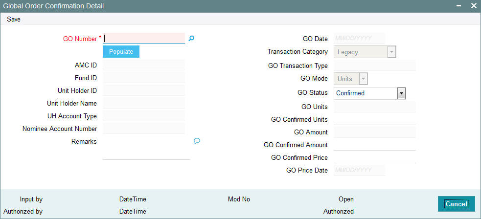

You can specify the price received from the fund house against the GO using ‘GO Confirmation Detail’ screen. the system which provide the details of price uploaded for the Global Orders. To invoke this screen, type ‘UTDGOCNF’ in the field at the top right corner of the Application tool bar and clicking on the adjoining arrow button.
Select 'New' from the Actions menu in the Application tool bar or click new icon to enter the details of the ‘GO Confirmation Detail’ screen. You can enter the following in this screen:
GO Number
Specify the Global Order number.
If you click on ‘Populate’ button, the following fields are displayed:
AMC ID
Display
The system displays the AMC ID.
Fund ID
Display
The system displays the fund ID.
Unit Holder ID
Display
The system displays the unit holder ID.
Unit Holder Name
Display
The system displays the unit holder name.
UH Account Type
Display
The system displays the UH account type.
Display
The system displays the nominee account number.
Remarks
Alphanumeric; 255 Characters; Mandatory
Specify remarks, if any.
GO Date
Display
The system displays the Global Order date.
Display
The system displays the transaction category. One of the following values are displayed in this field:
GO Transaction Type
Display
The system displays the GO transaction type.
GO Mode
Display
The system displays the GO mode. One of the following values are displayed in this field:
GO Status
Optional
Select the Global Order status from the drop-down list. Following are the options available in the drop-down list:
For Amount based order, if confirmation amount is mismatch then system will save record with Status as ‘Amount Mismatch’.
For Unit based order, if confirmation unit is mismatch then system will save record with Status as ‘Unit Mismatch’.
For Amount/ unit based order, if confirmation price is different than the fund price (for transaction date and transaction type combination) then system will save GO with status as ‘Price Mismatch’.
If unit/ amount and confirmation price matches then system will save the GO with confirmed status as ‘GO Confirmed’.
You can change the GO status manually to either GO confirmed or GO rejected in the GO Confirmation screen. All other statuses are defaulted by the system without manual intervention. Once GO is rejected, post confirmation of rejected order and all underlying transactions in the GO will be rejected. These will not be taken up for allocation.
GO Units
Display
The system displays the Global Order units.
GO Confirmed Units
Numeric; 27 Characters; Optional
Specify the Global Order confirmed units.
GO Amount
Display
The system displays the Global Order amount.
GO Confirmed Amount
Numeric; 30 Characters; Optional
Specify the Global Order confirmed amount.
GO Confirmed Price
Numeric; 22 Characters; Optional
Specify the Global Order confirmed price.
The system will consider the confirmation price received against a GO as the fund price for the GO confirmation date.
GO Price Date
Display
The system displays the Global Order price date.
The ‘GO Confirmation Detail’ screen will support all messages received via Swift Messages and will be enabled for any manual confirmation.
If no confirmation is received from the fund house, then GO will not be reversed, however, it will reflect GO status as ‘Pending Confirmation’ in ‘GO Confirmation Detail’ screen
The system will run the pre-EOD batch to check if all GOs generated for the day have been confirmed. The batch will also include unconfirmed GOs for back dated. Only if GO is confirmed, the underlying trades will be allotted.

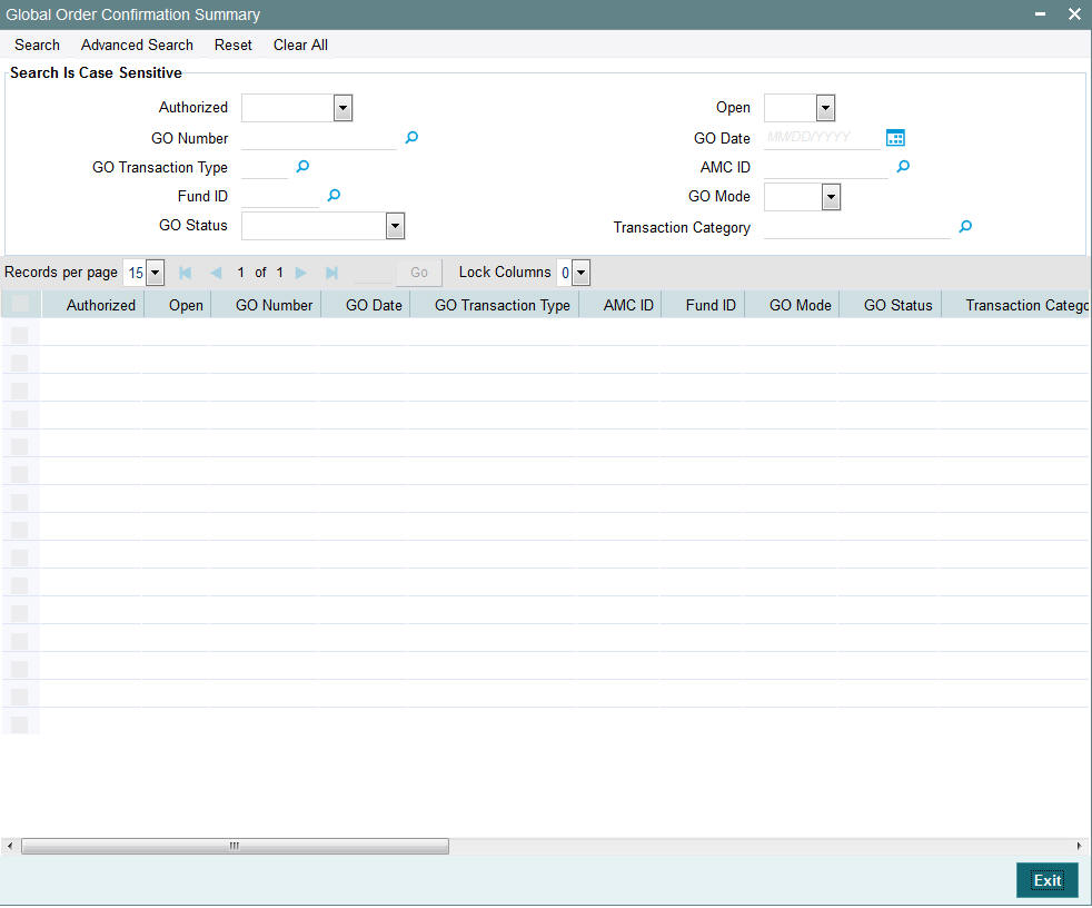

You can view Global Order Confirmation details using ‘GO Confirmation Summary’ screen. To invoke this screen, type ‘UTSGOCNF’ in the field at the top right corner of the Application tool bar and clicking on the adjoining arrow button to perform the following operations:
You can retrieve a previously entered Global Order Confirmation Details as follows:
After retrieving a record, you can perform the following actions from the Global Order Confirmation Detail screen:
To view a record that you have previously entered, you must retrieve the same in the ‘GO Confirmation Summary’ screen, as follows:

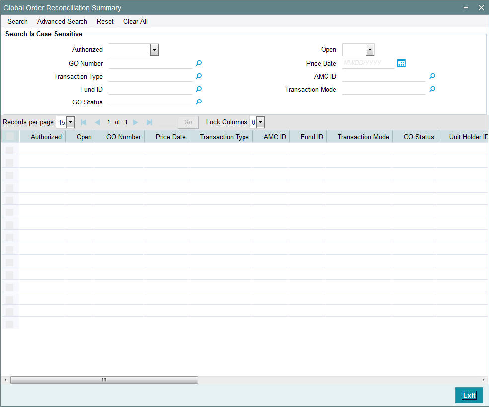

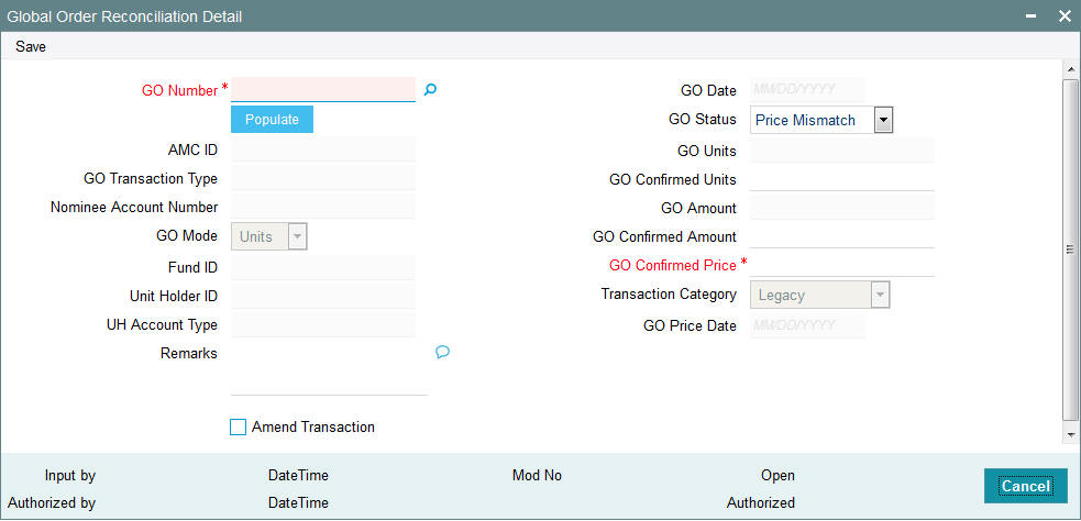

The system will compare the confirmation message received from the fund house with the original message generated. If there is a mismatch in the fund price received from the fund house for this order compared to fund price received for an earlier order having same fund ID/transaction type/ transaction date, then same will get reflect in the ‘GO Reconciliation’ screen. You can manually correct the status message as ‘Confirmed’ or ‘Rejected’ which will be confirmed from the fund house.
If the latest GO price is different from the existing fund price, then you need to confirm the GO price. Update the correct price in the GO, once the price issue is sorted out. On updating the correct price, all the GO will have the same price for the transaction date/fund/transaction type combination.
IF GO price is correct, you can update other GO (for same transaction date/transaction type/fund) and even fund price. On update, all the GO will have same price for the transaction date/fund/transaction type combination. Once the price is amended with the correct price, you can authorize the transaction from ‘GO Reconciliation’ screen.
The mismatch transaction will no longer reflect in the ‘GO Reconciliation’ screen once authorized.
To invoke this screen, type ‘UTDGORCN’ in the field at the top right corner of the Application tool bar and clicking on the adjoining arrow button to perform the following operations:
GO Number
AMC ID
Display
GO Transaction Type
Display
Display
GO Mode
Display
Fund ID
Display
Unit Holder ID
Display
UH Account Type
Display
Remarks
Alphanumeric; 255 Characters; Optional
GO Date
Display
GO Status
Optional
In case, if there is a mismatch in the fund price received from the fund house for this order compared to fund price received for an earlier order having same fund id/transaction type/transaction date, then same will get reflect in the “GO Reconciliation” screen for manual correction with status message as ‘Confirmed Price Mismatched’.
The correct price will be confirmed from the fund house outside the system.
If the latest GO price is different from the existing fund price, you need to confirm GO price.
Once the price issue is sorted out, you should update the correct price in the GO.
IF GO price is correct, then update the fund price. On update, all the GO will have same price for the transaction date/fund/transaction type combination.
Once the price is amended with the correct price, you should authorize the transaction from ‘GO Reconciliation’ screen.
The mismatch transaction will no longer reflect in the GO Reconciliation screen once authorized.
GO Units
Display
The confirmation message received from the fund house will be compared with the original message generated.
For a units based order, in case, if there is a mismatch in the GO Units Value received from the fund house, then same will get reflect in the ‘GO Reconciliation’ screen for manual correction with status message as ‘Confirmed Units Mismatched’
The correct value will be confirmed from the fund house outside the system
Once the units issue is sorted out, you need to update the units with correct units in ‘GO Reconciliation’ screen
Once the units are amended with the correct Units, you should authorize the transaction from GO Reconciliation screen
GO Confirmed Units
Once the GO is confirmed all the underlying transactions will be picked up for allocation by allocation batch. Once the underlying GO trades are allocated during EOD, the system will do a reconciliation of allotted units against confirmed units.
If there is a difference in the allotted units, the same will be reflected in the “GO Reconciliation” screen with a status message “GO Allotted Units Mismatched”. This will be before rounding difference process.
To sort the difference, the system will calculate the threshold units in ‘Fund Rules’ screen. If the difference units are more than the threshold units maintained, you need to manually round off the units.
If the difference units falls under the threshold units maintained, the system will automatically rounded off using a distribution logic with values as “To Highest Transaction Amount” and “Highest Transaction Amount to Lowest”
This distribution logic are applicable to funds, which fall under the AMC for which Distribution logic has been maintained
If user maintained distribution logic as “To Highest Transaction Amount” then the system will adjust the differential units to the transaction which has the highest transaction amount.
If user maintained distribution logic as “Highest Transaction Amount to Lowest” then system will distribute the difference amount from the highest transaction amount to the lowest in step up units.
If the AMC confirmed units are more than the system allotted, then system calculates Negative (-ve) differential units. If the AMC confirmed units are less than the system allotted, then system calculates Positive (+ve) differential units
Once the rounding difference is sorted out, this transaction will no longer reflect in the “GO Reconciliation” screen.
The difference units distributed based on the logic will be tracked separately during allocation
Based on the logic- system will update the allocated units with extra or reduced units
GO Amount
Display
GO Confirmed Amount
For an amount based order In case, if there is a mismatch in the GO Amount Value received from the fund house, then same will get reflect in the ‘GO Reconciliation’ screen for manual correction with status message as “Confirmed Amount Mismatched”
Once the Amount issue is sorted out, you need to update the amount with correct amount in GO Reconciliation screen
Once the amount are amended with the correct amount, you should authorize the transaction from ‘GO Reconciliation’ screen
GO Confirmed Price
Numeric; 22 Characters; Mandatory
Display
GO Price Date
Display
Once the GO is confirmed all the underlying transactions will be picked up for allocation by allocation batch. Once the underlying GO trades are allocated during EOD, system will do a reconciliation of allotted units against confirmed units.
If there is a difference in the allotted units, the same will be reflected in the ‘GO Reconciliation Detail’ screen with the status message as “GO Allotted Units Mismatched”
If the AMC confirmed units are more than the system allotted, then the system will calculate Negative (-ve) differential units.
If the AMC confirmed units are less than the system has allotted, then the system will calculate Positive (+ve) differential units
Once the rounding difference is sorted out, this transaction will no longer reflect in the ‘GO Reconciliation Detail’ screen.
The GO Reconciliation screen will show any unconfirmed global orders and those with a price mismatch or those where the allotted units does not match the confirmed number of units during de-aggregation.
In case the confirmation message is not received on any date, the system will show all the transactions with, confirmation related columns as BLANK and the Confirmation Status field will show the message as “Confirmation message pending”.
You can view Global Order Confirmation details using ‘GO Reconciliation Summary’ screen. To invoke this screen, type ‘UTSGORCN’ in the field at the top right corner of the Application tool bar and clicking on the adjoining arrow button.

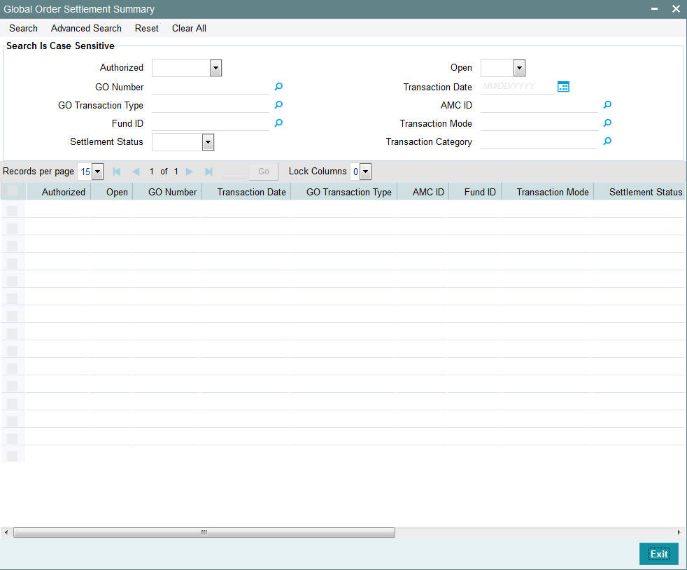

You can view Global Order Settlement details using ‘GO Settlement Summary’ screen. To invoke this screen, type ‘UTSGOSTL’ in the field at the top right corner of the Application tool bar and clicking on the adjoining arrow button..
You can retrieve a previously entered Global Order Settlement Details as follows:
After retrieving a record, you can perform the following actions in the Global Order Settlement Detail screen:
To view a record that you have previously entered, you must retrieve the same in the ‘GO Settlement Summary’ screen, as follows:
You can modify the Global Order Settlement details that you have already entered into the system, provided it has not been subsequently authorized. You can perform this operation as follows:
Note
Apart from the maker, someone else must authorize an unauthorized global order confirmation record deal in the system for it to be processed. To authorize a record:

You can invoke ‘GO Generation’ screen by typing ‘UTDGENGO’ in the field at the top right corner of the Application tool bar and clicking on the adjoining arrow button.
You can specify the following details:
Fund ID
Specify the fund ID. Alternatively, you can select fund ID from the option list. The list displays all valid fund IDs maintained in the system.
ISIN Code
Alphanumeric; 25 Characters; Optional
The system displays the ISIN Code for the selected fund ID. However, you can amend this value.
If you have selected fund ID, then the system displays the ISIN code and vice versa.
AMC ID
Specify the AMC ID. Alternatively, you can select AMC ID from the option list. The list displays all valid AMC IDs maintained in the system.
Trading Agent Code
Specify the trading agent code. Alternatively, you can select trading agent code from the option list. The list displays all valid trading agent codes maintained in the system.
Submit For
Optional
Select the submit option from the drop-down list. The list displays the following values:

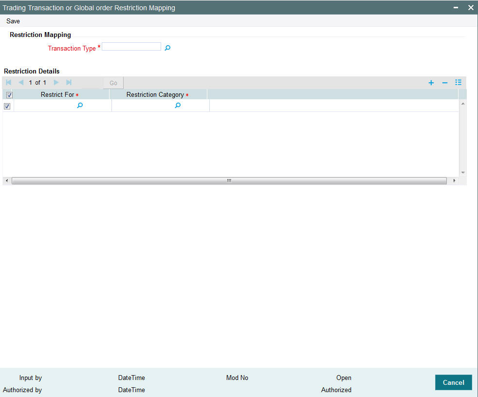

You can maintain Global order restriction for various transaction types using ‘Trading Transaction or Global order Restriction Mapping’ screen. You can invoke this screen by typing ‘UTDTRDRS’ in the field at the top right corner of the Application tool bar and clicking on the adjoining arrow button.
Transaction Type
Specify the type of transaction to be mapped for restriction. Alternatively, you can select transaction type from the option list. The list displays all valid transaction type maintained in the system.
Restrict For
Specify the restricted options. Alternatively, you can select restricted options from the option list. The list displays all valid restricted options maintained in the system.
Restriction Category
Specify the restriction category. Alternatively, you can select restriction category from the option list. The list displays all valid restriction category maintained in the system.

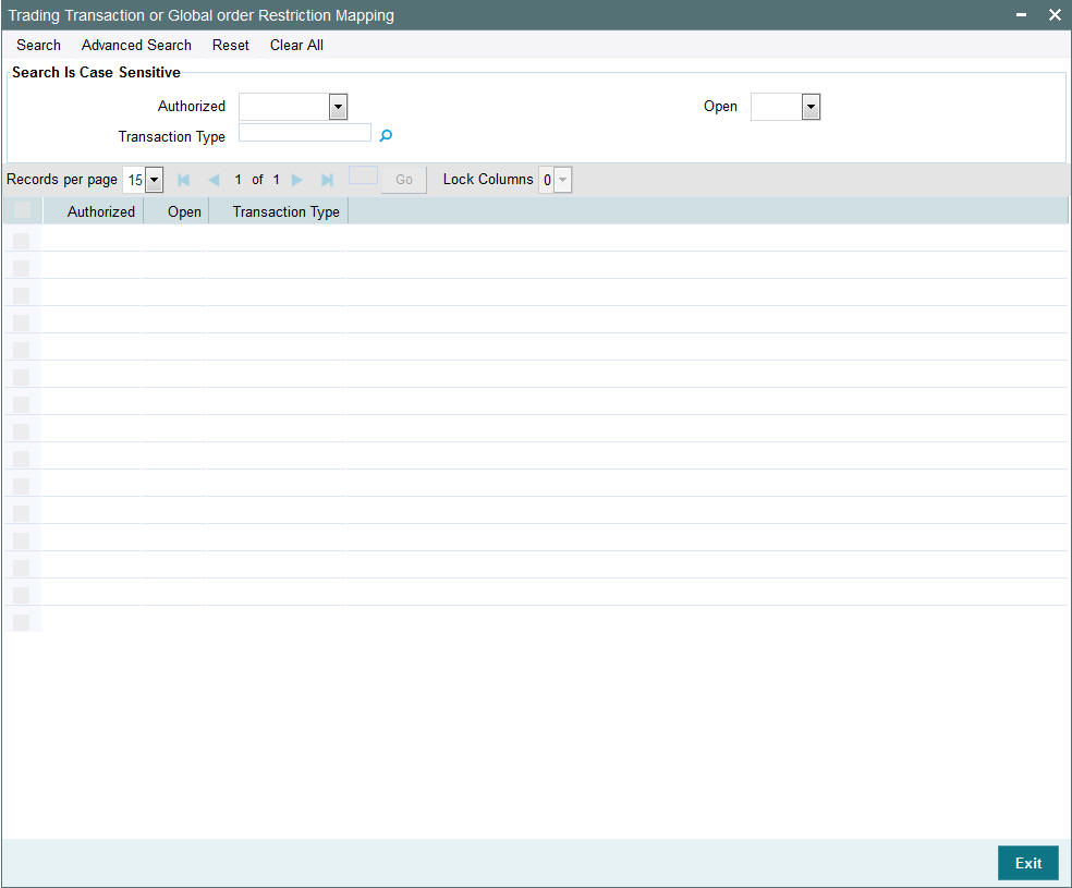

You can invoke ‘Trading Transaction or Global order Restriction Mapping’ screen by typing ‘UTSTRDRS’ in the field at the top right corner of the Application tool bar and clicking on the adjoining arrow button.
Note
You can perform Edit, Delete, Amend, Authorize, operations by selecting the operation from the Action list. You can also search a record by using a combination of % and alphanumeric value.
Note
The status field in the Records pane of the summary screen displays the bulk operation results.
For example:
You can search the record for Transaction Type by using the combination of % and alphanumeric value as follows:-
You can modify the details of Trading Transaction or Global order Restriction Mapping record that you have already entered into the system, provided it has not subsequently authorized. You can perform this operation as follows:
Click Save to save your changes. The Trading Transaction or Global order Restriction Mapping Detail screen is closed and the changes made are reflected in the Trading Transaction or Global order Restriction Mapping Summary screen.
To view a record that you have previously input, you must retrieve the same in the Trading Transaction or Global order Restriction Mapping Summary screen as follows:
After a Trading Transaction or Global order Restriction Mapping record is authorized, it can be modified using the Unlock operation from the Action List. To make changes to a record after authorization:
An amended Trading Transaction or Global order Restriction Mapping record must be authorized for the amendment to be made effective in the system. The authorization of amended records can be done only from Fund Manager Module and Agency Branch module.

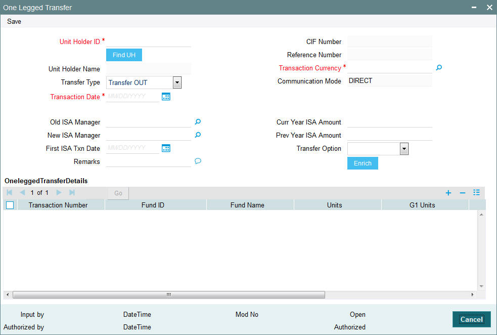

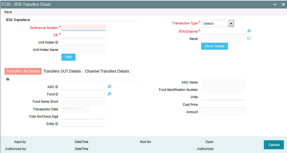

You can maintain ISA transfer details using ‘One Legged Transfer’ screen. This screen supports the following transactions:
Transfer Out
This is a one legged transfer which is used to redeem holdings. On selecting the transfer out option, the system will auto calculate the number of units and will populate the Fund Grid.
Transfer out will be a Redemption transactions and it will go as per aging logic maintained at fund level.
The system will generate the underlying Transactions by units on authorisation of the transaction in the Transaction value field of the detail section. Under this One-legged Transfer, when all transactions are generated successfully, a unique reference number will be generated and this reference will be reference number for underlying transactions.
The system will generate the redemption transactions on authorisation of this one-legged transfer. While generating if one of the transactions fail due to any of the validations, all underlying transactions will be rolled back. For failed transaction, the system will display an error message.
The payment preference maintained at the time of Uh creation will be used as settlement mode. Transfer out can be used for ISA/non ISA accounts
Transfer In
This is a one legged amount based transfer. You can enter the transfer amount and fund details. On authorisation, the system will generate authorised subscription transactions at the fund Level. A new ref type (OI - One Legged Transfer In) will be available for such transfers.The settlement mode for such transactions will be cash.
The Current Year ISA Subscription Amount will be used to update the ISA Limits. The system will validate the ISA amounts against the existing limits if the Unitholder Account already exists.
If the ISA transfer in transaction exceeds the ISA allowance/ limit for the current tax year then on authorization of the transaction the system display an error message as “Exceeds the ISA allowance for the current tax year”.

You can specify ISA transfer details using ‘One Legged Transfer’ screen. You can invoke this screen by typing ‘UTDOLT’ in the field at the top right corner of the Application tool bar and clicking on the adjoining arrow button.
Unit Holder ID
You can also query unit holder ID by clicking ‘Find UH’ button
Unit Holder Name
Display
The system displays the unit holder name for the selected Unit Holder ID while saving.
CIF Number
Display
The system displays the customer ID.
Reference Number
Display
The system displays the reference name.
Transfer Type
Optional
Select the type of transfer from the adjoining drop-down list. Following are the options available:
Transaction Date
Specify the transaction date.
Transaction Currency
Alphanumeric; 3 Characters; Mandatory
Specify the transaction currency.
Communication Mode
Display
The system displays the mode of communication.
Old ISA Manager
Specify old ISA Manager details. This adjoining option list displays all valid old ISA manager details maintained in the system. You can choose the appropriate one.
New ISA Manager
Specify new ISA Manager details. This adjoining option list displays all valid new ISA manager details maintained in the system. You can choose the appropriate one.
First ISA Txn Date
Specify first ISA transaction date.
Remarks
Curr Year ISA Amount
Numeric; 18 Characters; Optional
Specify the current year ISA amount.
Prev Year ISA Amount
Specify the previous year ISA amount.
Transfer Option
Optional
Select the transfer option from the adjoining drop-down list. Following are the options available:
Transaction Number
Display
The system displays the transaction number on authorization.
Fund ID
Specify the fund ID. This adjoining option list displays all valid fund ID maintained in the system. You can choose the appropriate one.
Fund Name
Display
The system displays the name of the fund for the selected fund ID.
Units
Specify the in-specie transfer in units.
This field is enabled only for in-specie transfer in type of transaction.
G1 Units
Specify the in-specie transfer in G1 units.
G2 Units
Specify the in-specie transfer in G2 units.
Amount
Specify the transfer amount.

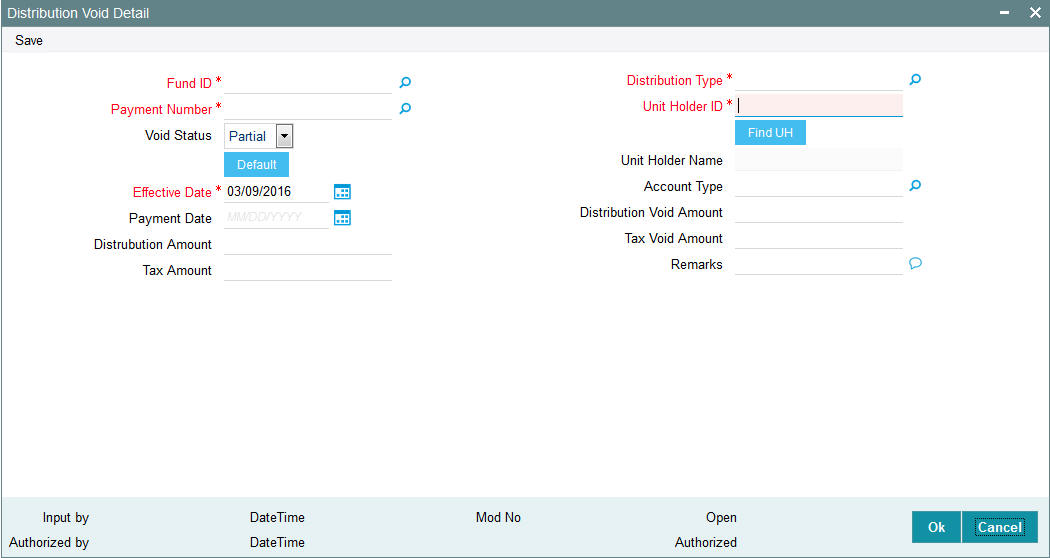

You can do void processing at UH and transaction level. You can specify the unit holder ID or specific transaction number, and then that specific UH/transaction will be void in system with immediate effect (post authorization). You can capture void reason during void save.
The account can be voided for a given date range.
You can specify the void details by using ‘Distribution Void Detail’ screen. To invoke this screen, type ‘UTDDVOID’ in the field at the top right corner of the Application tool bar and clicking on the adjoining arrow button to perform the following operations:
Fund ID
Payment Number
Alphanumeric; 5 Characters; Mandatory
Specify the payment number. This adjoining option list displays all valid payment number maintained in the system. You can choose the appropriate one.
Void Status
Optional
Select the void status from the adjoining drop-down list. Following are the options available:
Distribution Type
Alphanumeric; 1 Character; Mandatory
Select the type of distribution. This adjoining option list displays all valid fund ID maintained in the system. You can choose the appropriate one.
Unit Holder ID
Specify the unit holder ID. You can also click on ‘Fund UH’ button to select the valid unit holder ID.
Unit Holder Name
Display
The system displays the unit holder name for the selected unit holder ID.
Void Status
Optional
Select the void status from the drop-down list. The list displays the following values:
Effective Date
Specify the application date.
Payment Date
Specify payment date.
Distribution Amount
Specify the distribution amount.
Tax Amount
Specify the valid tax amount.
Account Type
Alphanumeric; 2 Characters; Optional
Select the type of account. This adjoining option list displays all valid fund ID maintained in the system. You can choose the appropriate one.
Distribution Void Amount
Specify the distribution void amount.
This field is enabled only if you have selected ‘Void Status’ as ‘Partial’.
Tax Void Amount
Specify the distribution void tax amount.
Remarks
Distribution Void
You can maintain partial Voids and full amount void values at a unit holder distribution level using distribution void feature.
You can mark the distribution record as fully void or partially void by selecting Full/Partial option in ‘Void Status’ field.
If you select ‘Partial void’ option, then you can provide the Void Distribution amount and the void Tax amount. You can also amend this maintenance and change the status to Blank.
You can amend the distribution void amount and distribution void tax amount with effective date being the application date. The system will store the latest effective date record in the system as latest record which will be available for amending the void record.
The distribution void processing is only for reporting purpose and will not have any systemic impact on tax credit.

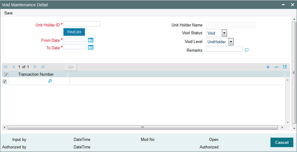

You can perform void processing at UH and transaction level using ‘Void Maintenance Detail’ screen. You can provide unitholder ID or specific transaction number and then specific UH/transaction will be void in system with immediate effect (post authorization). You can capture void reason while saving a void. You can also void and account for a given range.
You can invoke the ‘Void Maintenance Detail’ screen by typing ‘UTDVOID’ in the field at the top right corner of the Application tool bar and clicking on the adjoining arrow button.
Unit Holder ID
Specify the unit holder ID. You can also query for unit holder ID by clicking ‘Find UH’ button.
Unit Holder Name
Display
From Date
Select the date from when the void details needs to be maintained from the adjoining calendar.
To Date
Date Format
Select the date till when the void details needs to be maintained from the adjoining calendar.
Void Status
Optional
Void Level
Optional
Select the void level from the drop-down list. The list displays the following values:
Remarks
Transaction Number
Specify the transaction number, Alternatively, you can select transaction number from the option list. The list displays all valid transaction number maintained in the system.

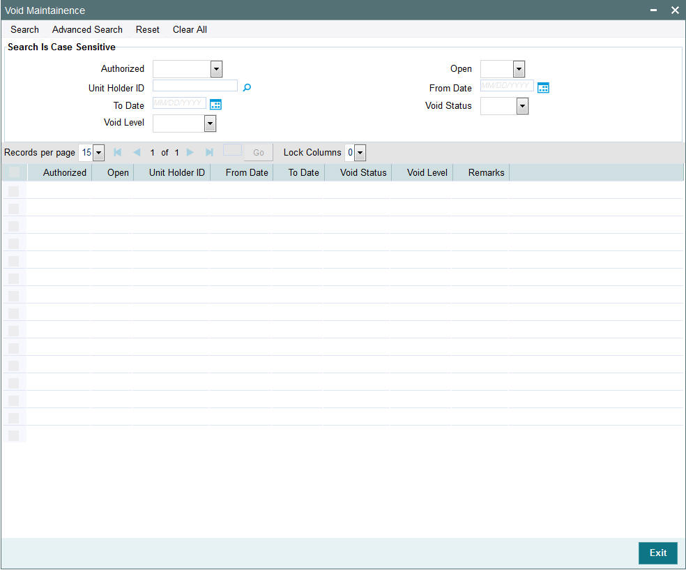

You can view void details using ‘Void Maintenance’ screen. To invoke this screen, type ‘UTSVOID’ in the field at the top right corner of the Application tool bar and clicking on the adjoining arrow button.
You can retrieve a previously entered void Details as follows:
Note
You can perform Edit, Delete, Amend, Authorize, Reverse, Confirm operations by selecting the operation from the Action list. You can also search a record by using a combination of % and alphanumeric value.
You can search the record for Unit Holder ID by using the combination of % and alphanumeric value as follows:
You can modify the Void Maintenance Details that you have already entered into the system, provided it has not been subsequently authorized. You can perform this operation as follows:
To view a record that you have previously input, you must retrieve the same in the ‘Void Maintenance’ Summary screen as follows:
An unauthorized Void Maintenance record must be authorized in the system for it to be processed. To authorize a record:
When a checker authorizes a transaction, details of validation, if any, that were overridden by the maker of the transaction during the Save operation are displayed. If any of these overrides results in an error, the checker must reject the transaction.
After a Void Maintenance record is authorized, it can be modified using the Unlock operation from the Action List. To make changes to a record after authorization:

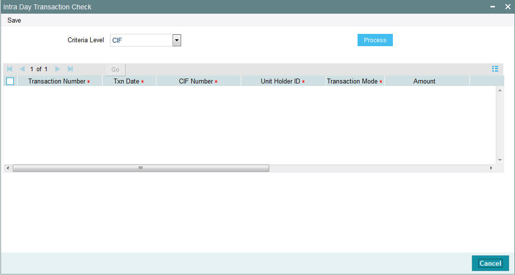

For a fund, limits on transaction volumes (minimum and maximum limits for both amount and units) are defined in the Transaction Processing Rules, for each transaction type. The limits so defined are validated whenever individual transactions are allocated in the system.
You may require the transaction limits for a fund to be checked for and enforced at any of the following levels of aggregation:
To specify the level at which the check must be performed, you can use the Intra-Day Transaction Check screen, which you can invoke from the Fund Manager menu.
To invoke this screen, type UTDIDYCK in the field at the top right corner of the Application tool bar and clicking on the adjoining arrow button.
In this screen, you specify the aggregation level at which the check must be performed, in the Criteria field. Click ‘Process’ button to apply the check. The system aggregates all the unallocated transactions into each fund at the level you have specified, and displays those transactions that violate the limits maintained in the Transaction Processing Rules for the fund.
Criteria Level
Optional
Select the level at which transactions must be aggregated for enforcement of the transaction limit check from the drop-down list. The system aggregates all unallocated transactions into each fund at the level you have specified, and displays those transactions that violate the limits maintained in the Transaction Processing Rules for the fund.
The drop-down list displays the following values:
Clicking ‘Process’ button, the system displays the following values:

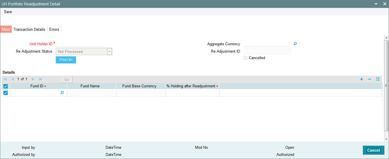

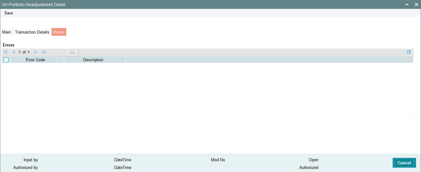

You can define percentage of the readjusted portfolio fund wise for a given Unit Holder using the ‘Readjustment of UH Portfolio’ screen. Based on this percentage defined, the system will readjust portfolio by means of switch/pseudo switch on the given funds of the unit holder. All the switch and pseudo switch transactions are unit based transactions. You can invoke this screen by typing ‘UTDUHPR’ in the field at the top right corner of the Application tool bar and click the adjoining arrow.
Select 'New' from the Actions menu in the Application tool bar or click new icon to enter the details of the ‘Readjustment of UH Portfolio’ screen.
Unit Holder ID
Specify the unit holder ID. You can also click ‘Find UH’ button to find the authorized unit holders. The system displays a list of authorized unit holders maintained in the system.
Aggregate Currency
Alphanumeric; 3 Characters; Optional
In case the readjustments are between the funds of different fund base currency (FBC), then you have to specify the aggregate currency. Specify the aggregate currency. You can also select the aggregate currency from the adjacent option list. The option list consists of all the valid and authorized currency codes maintained in the system. While processing the transaction, the system will convert the currencies of the current holdings of the selected funds into aggregate currency for the purpose of comparing and achieving the required portfolio.
The system triggers an error message if there are funds involving more than one FBC and if the aggregate currency is not specified. However, if all the funds defined in the screen are having same fund base currency, then the system defaults the aggregate currency with the same fund base currency. For instance, if all the funds defined are having FBC as ‘USD’, then on saving the details, the system will default aggregate currency as ‘USD’.
Note
The aggregate currency chosen should be the FBC of at least one of the funds selected.
Readjustment Status
Display
Based on the status of the readjustment, the status is displayed here. The following are the status available:
You can modify the details only if the readjustment status is ‘Not Processed”.
Note
For a given unit holder, there can be only one ‘Not Processed’ readjustment.
Readjustment ID
Display
On saving the details, the readjustment ID is generated. Later, you can use this number to query the details.
Cancelled
Optional
The system will not generate the transactions that are ‘authorized but are yet to be processed’. This option is enabled only during amending operation.
Fund ID
Specify the fund ID. You can also select the fund ID from the option list provided. The option list displays the valid fund IDs maintained in the system. You should at least specify two funds for readjustments and for the given unit holder, at least one of the funds defined should have the settled unit balance.
Fund Name
Display
Based on the fund ID selected, the fund name is displayed.
Fund Base Currency
Display
Based on the fund ID selected, the fund base currency is displayed.
% Holding after Readjustment
Define the percentage of the readjusted portfolio for the unit holder. After readjustment, this is the percentage of the total holdings of the settled units for the selected funds. The total percentage should added up to hundred percent.
Click ‘Transaction Details’ tab to view the generated transaction details.
The following details are displayed:
During transaction generation, if one of the transactions fails, then the system will log an error as 'Transaction Processing Failed'. It will not generate the partial successful transactions. The failed reasons can be viewed under ‘Errors’ tab. Click ‘Errors’ tab to view the error details:
The system displays the following values:
Note
In case of pseudo switch, the transaction currency for the subscription transaction will be the fund base currency of the redemption transaction fund.
As part of EOD process, all the settled units as on date are considered for readjustments. The total current holdings are arrived using the latest NAV of the funds involved. The current holdings of each fund are compared with the required readjusted portfolio (both amounts are in aggregate currency). The transaction type to be used is based on the net inflows and outflows required to achieve the required readjustment. If a switch transaction is required among these funds, the system will generate normal switch or pseudo switch based on the funds involved belong to the same AMC or different AMC respectively. The readjustment request is rejected if there is any amount block on one of the fund where in units has to be switched out.
The portfolio readjustment details must be authorized by another user. You can invoke ‘UH Portfolio Readjustment Summary’ screen by typing ‘x’ in the field at the top right corner of the Application tool bar and click the adjoining arrow.
You can retrieve a previously entered broker deal as follows:
You can perform Edit, Delete, Amend and Authorize operation by selecting from the Action list.

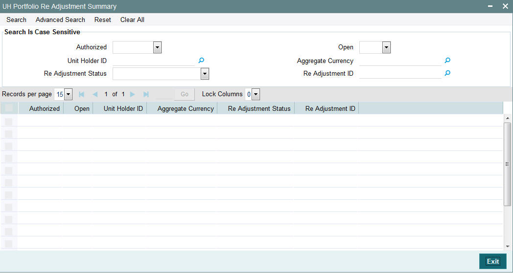

You can modify the details of the readjustment portfolio that you have already entered into the system, provided it has not been subsequently authorized. You can perform this operation as follows:
To view a record that you have previously entered, you must retrieve the same in the ‘UH Portfolio Readjustment Summary’ screen, as follows:
Note
Apart from the maker, someone else must authorize an unauthorized broker deal in the system for it to be processed. To authorize a record:

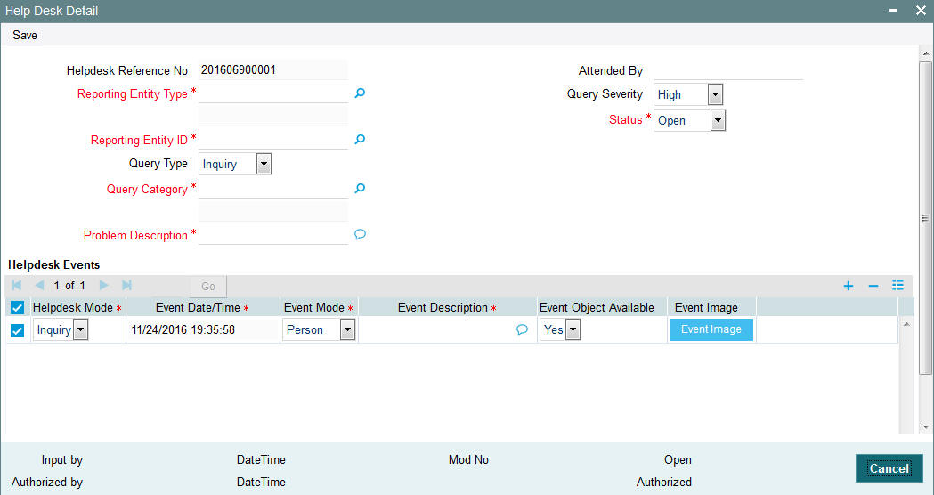

You can use this screen to
To initiate (or process) a query, in the Help Desk (Detail) screen, specify the following in the Help Details section:
Any follow up or processing of the query can likewise be entered in a similar manner, as described above.
To add a new row to the Helpdesk Events grid, choose the Add button.
Helpdesk Reference Number
Display
Every query you initiate in the system is assigned a unique reference number by the system. If you are entering a new query in this screen, this field is empty and locked, and when you specify all the information that is mandatory for initiating a query, the reference number is generated by the system when you Save the information.
If you have retrieved a query for viewing or processing, the reference number of the retrieved query is displayed here and it cannot be altered.
Attended by
Alphanumeric; 15 Characters; Optional
Specify the name of the person who is assigned to attend to the details of the query.
Reporting Entity Type
Specify the type of entity that is initiating the query. Choose from the drop down list.
Query Severity
Optional
Specify the criticality of the query, by selecting it from the drop-down list. The list displats the following values:
Reporting Entity ID
Specify the ID of the entity that is initiating the query.
Status
Mandatory
When you are initiating a new query, this field is locked and has a default value, “Open”, signifying that the query is yet to be processed. Subsequently, when you retrieve the record of a query in this screen, and edit the same, you can update the status of the query by making the appropriate selection in this field. A query can be open, closed or being followed up. Accordingly, choose the desired option from the drop-down list. The list displays the following values:
Query Type
Optional
Specify the type of query that is being initiated, by selecting it from the drop-down list. The list displays the following values:
Query Category
Specify the subject of the query, by selecting it from the drop down list.
Problem Description
Narrate the problem, if any, or the statement of the query, in a few words.
You must specify the details of the modes in which any query is initiated or followed up, in this section.
Helpdesk Mode
Mandatory
For new queries, the mode specified here must be Inquiry. Select the help desk mode from the drop-down list. The list displays the following values:
Event Date/Time
Display
The time at which the query/follow up action was received is displayed here.
Event Mode
Mandatory
Select the mode through which the query / follow up action was received. from the drop-down list. The list displays the following values:
Event Description
Give a brief description, if any, about how the query / follow up action was received.
Event Object Available
Indicate from the drop-down list if the event object is available or not. The list displays the following values:
Event Image
If the details of the query / follow up action is contained in a document, specify the path to the same here. Click ‘Event Image’ button to upload the image.

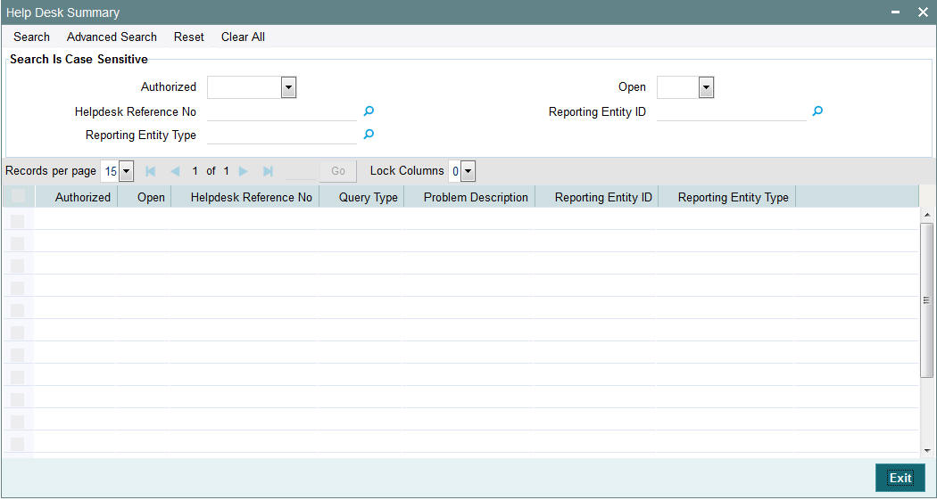

To view or edit a helpdesk query, use the ‘Help Desk Summary’ screen. You can invoke this screen by typing ‘UTSHLPDS’ in the field at the top right corner of the Application tool bar and clicking on the adjoining arrow button.
You can retrieve a previously entered query record in the Help Desk Summary screen, as follows:
After Consolidation Transaction are entered into the system, you can perform any of the following operations:
You can modify the details of a Help Desk record that you have already entered into the system, provided it has not been subsequently authorized. You can perform this operation as follows:
To view a Help Desk record that you have previously entered, you must retrieve the same in the Help Desk Summary screen, as follows:
To retrieve the Help Desk record that is to be viewed, specify any or all of the details of the transaction in the corresponding fields on the screen, and click
All transactions with the specified details are retrieved and displayed in the lower portion of the screen.
Select the Help Desk record that you want to view in the list of displayed transactions, in the lower portion of the screen.
The Help Desk Detail screen is opened by double clicking the selected record, with the selected record displayed in view mode.
You can delete only unauthorized Help Desk record in the system.
To delete a Help Desk record that you have previously entered, you must retrieve the same in the Help Desk Summary screen, as follows:
An unauthorized record must be authorized in the system for it to be processed. To authorize a record:
Authorization of amended transactions can only be done from Fund Manager Module and Agency branch Module.
Select the status of the Help Desk record that you wish to retrieve for amendment. You can only amend records of transactions that are authorized.
Specify any or all of the details of the Help Desk record in the corresponding fields on the screen. All transactions with the specified details are retrieved and displayed in the lower portion of the screen.
Double click the adjustment transaction that you want to amend. The Help Desk. Click the Unlock operation from the Action list to amend the transaction.
Amend the necessary information. Click 'OK' to save your changes. Only escalation details can be changed during an amend operation.
An amended Help Desk record must be authorized for the amendment to be made effective in the system. The authorization of amended records can only be done from Fund Manager Module and Agency branch Module.
The process of authorization is subsequently the same as that for normal transactions.

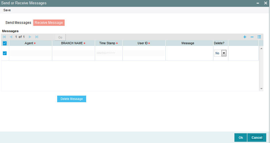

Messages can be relayed to and fro between modules in the system. Use the ‘Send / Receive Messages’ screen to do this. You can invoke this screen by typing ‘UTDSEREM’ in the field at the top right corner of the Application tool bar and clicking on the adjoining arrow button.
Agent Code
Specify the Agent Code of the module to which you are sending the message
Branch Code
Specify the branch Code of the module to which you are sending the message,
Message
Enter the message that has to be sent.
To send a message, specify the Agent and Branch Code of the module to which you are sending the message, and key in the text of the message in the Message field box. Then click the Send button.
To receive a message, specify the Agent and Branch Code of the module from which you are receiving the message, and click the Receive button. The text of the incoming message is displayed in the Message field box.
Agent
Display
This displays the entity from which the message has come. For outgoing messages, it will display the current entity code.
BRANCH NAME
Display
This displays the bank name to which the agent belongs.
Time Stamp
Display
This displays the time when the message had come.
User ID
Display
This displays the User ID of the person from whom the message has come from.
Message
The text of the message that has been received is displayed here.
Delete?
Optional
Click on Delete Message button to delete the message.
Click ‘Delete Message’ to delete the messages.

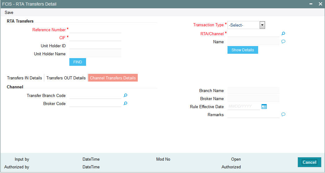

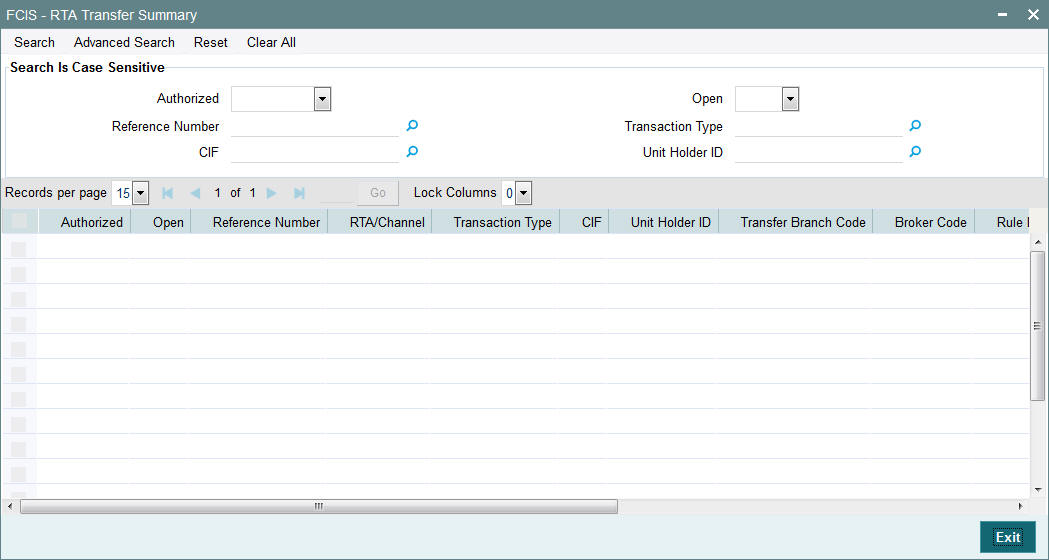

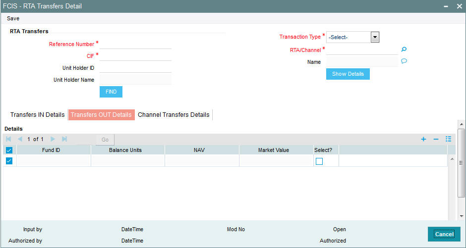

The RTA Transfers Detail In and Out screen captures the details that are present in the RTA incoming interface related data store. In the case of a transfer out transaction, the transaction is generated and needs to be confirmed by the bank. To invoke this screen, click on the main menu item Maintenance and then click on Details under the sub-menu item RTA Transfer Detail.
You can also invoke this screen by typing ‘UTDRTAIO’ in the field at the top right corner of the Application tool bar and clicking on the adjoining arrow button.
The following details can be captured here:
Reference Number
Specify a reference number for the account. This will be deemed as a unique alphanumeric identifier for the account. It could be the serial number that is given on the application form through which the investor has invested in the AMC. It could also be any alphanumeric value given by the investor, to identify the account.
Transaction Type
Mandatory
Specify the type of transfer, the options being
CIF
Specify the CIF number of the customer for whom you are creating a transferring the units.
RTA/Channel
Select the RTA from the drop down list.
Unitholder ID
It may be defaulted based on the selection from Unit holders for CIF; else you need to specify the unit holder ID here.
You can query for unit holder ID by clicking ‘Find’ button.
Unit Holder Name
Display
Name
Alphanumeric; 255Characters; Mandatory
Specify the name of the RTA/Channel here.
AMC ID
Select the code of the AMC in whose funds the investor wishes to invest, from the list provided. You capture this information for the purpose of identifying the AMC to which the unit holder belongs, and in whose database the unit holder account will reside.
AMC Name
Display
The system displays the name of the selected AMC ID.
Fund ID
Select the fund ID into which the unit holder wishes to invest.
Display
Fund Name Short
Display
The system displays the short name of the fund.
Transaction Date
Display
The default date here would be the application date; however you will be able to edit it.
Folio No/Check Digit
Alphanumeric; 20 Characters; Optional
Specify the folio for the AMC if the unit holder does not have prior records of transactions with the AMC specified, else is it defaulted depending on the unit holder ID and the AMC ID.
Entity ID
Specify the entity ID.
Units
Specify the number of units the unit holder wishes to buy.
Cost Price

Click on the Transfer Out tab to invoke the following screen:
Fund ID
Display
The fund in which the transaction was put through is displayed here
Balance Units
Display
The unit balance of your holding is displayed here.
NAV
Display
Display the current NAV of your holdings.
Market Value
Display
This displays the market value of all your holdings which is derived at by multiplying the Balance Units with the current NAV.
Select?
Optional
The box needs to be checked against the fields which are to be processed.
Note
Conditions required to be fulfilled for validations for transfer out transactions
Click on the Channel Transfers Details tab to invoke the following screen:
FCIS provides the facility to transfer an investor along with all the transactions done prior to the transfer to the new channel. The following transfers will be allowed under Channel Transfer:
Channel transfers cannot be triggered from non channel agency branches.
Transfer Branch Code
Specify the branch of the agent to whom the investor is being transferred.
Branch Name
Display
Upon selection of the branch code, the associated branch name gets populated.
Broker Code
Select the code of the broker to whom the investor is being transferred.
Broker Name
Display
Upon selection of the broker code, the associated broker name gets populated.
Rule Effective Date
Specify the date from when the unitholder transfer that is currently being set up should become effective.
Remarks
Descriptive text about the transfer can be entered here.

The RTA transfer details maintained must be authorized by another user. You can use the ‘FCIS - RTA Transfer Summary’ screen to perform the following operations:
You can retrieve a previously entered RTA transfer details as follows:
Invoke the ‘FCIS - RTA Transfer Summary’ screen from the Browser.
Specify any or all of the following details in the screen:
Click ‘Search’ button to view the records. All records with the specified details are retrieved and displayed in the lower portion of the screen.
You can modify the details of the RTA transfer details that you have already entered into the system, provided it has not been subsequently authorized. You can perform this operation as follows:
Double click the record that you want to modify in the list of displayed records. The ‘FCIS RTA Transfer Details’ screen is displayed.
Select Unlock operation from the Action list to modify the record. Modify the necessary information.
Click Save to save your changes. The ‘FCIS - RTA Transfer Details’ screen is closed and the changes made are reflected in the ‘FCIS - RTA Transfer Summary’ screen.

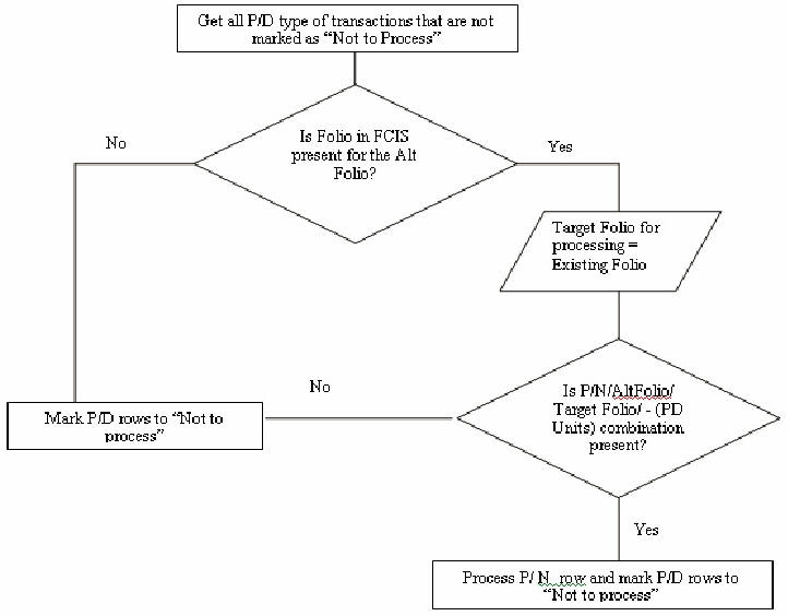

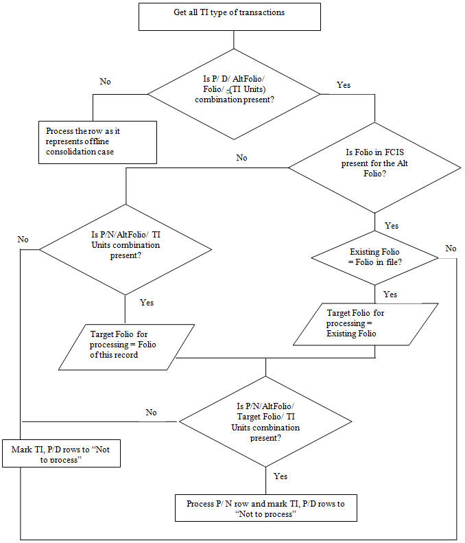

The flow chart below explains how the RTA interface would handle transfer and consolidation of portfolios.
Transfer with Consolidation Logic:
Only Consolidation:
This is a case where the unit holder has invested in an IPO fund of an AMC and later subscribed into another fund of the same AMC. The folio number is allocated to the user after subscription confirmation, the RTA however allocates a new folio for the IPO subscription. In this case a consolidation of folio is required.
Note
No Transfer In type of record would be available in this case as it is just a consolidation of the folio numbers.
The flow chart below illustrates the above logic

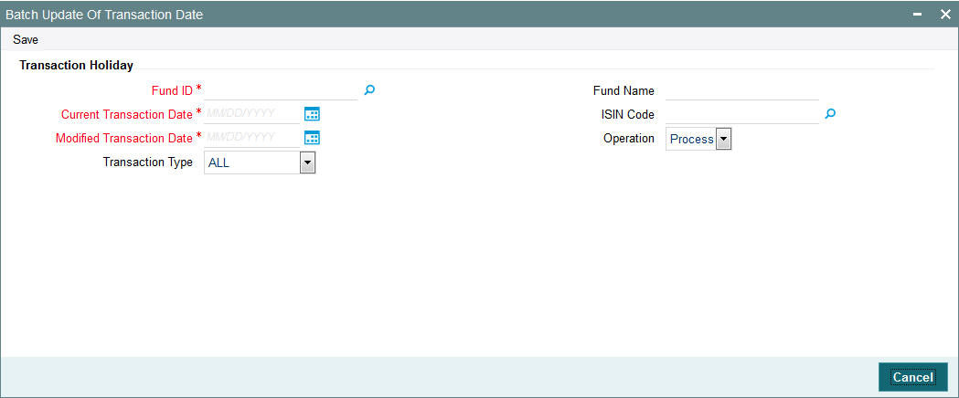

Use the ‘Batch Update Of Transaction Date’ screen to modify the Transaction date for different transactions for the fund.
You can invoke this screen by typing ‘UTDBUTD’ in the field at the top right corner of the Application tool bar and clicking on the adjoining arrow button.
Fund ID
Enter the fund id for which the transaction date needs to be modified.
Fund Name
Display
The system displays the name of the selected fund ID.
Current transaction date
Date, Mandatory
Enter the transaction date that falls on a Holiday
Modified Transaction Date
Date; Mandatory
Enter the new transaction date to which the transactions is to be updated. This transaction date is defaulted to the next working day of the current transaction date. You are allowed to modify this date.
The system will freshly calculate the price date for these transactions in case for specific fund price dates.
Transaction type
Optional
Select the transaction type from the drop-down list for which the modification will be allowed.The list displays the following values:
The default option will be “All”.
ISIN Code
Select the ISIN Code of the fund in which the transaction was put through, from the options provided. If you specify the ISIN Code of a fund, the ID of the fund is displayed in the Fund field.
Operation
Optional
Select the operation for which the update has been enabled from the drop-down list. The list displays the following values:

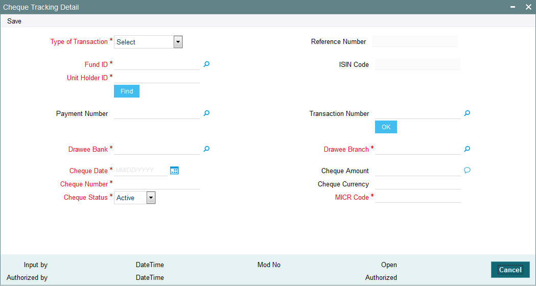

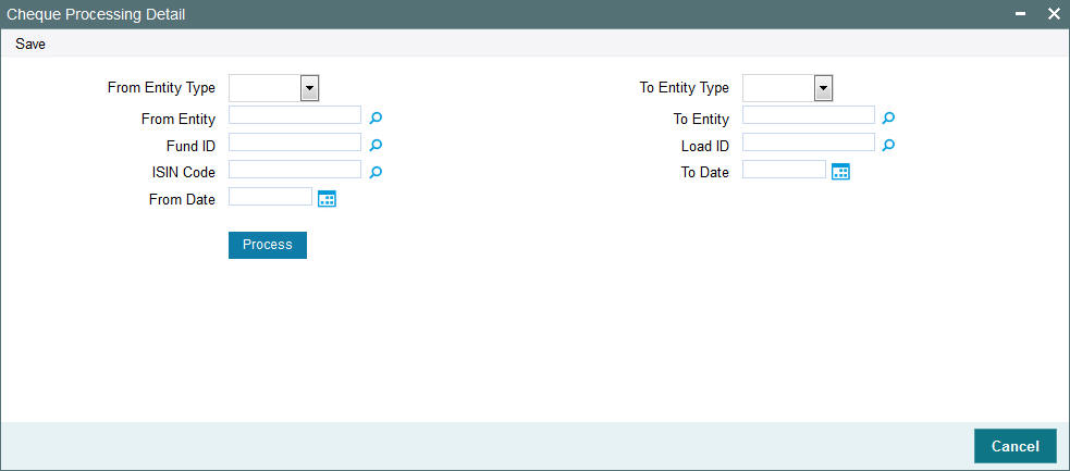

To invoke this screen, type UTDCHQTR in the field at the top right corner of the Application tool bar and clicking on the adjoining arrow button.
Type of Transaction
Mandatory
Reference Number
Display
The system displays the reference number.
Fund ID
ISIN Code
Display
Unit Holder ID
Specify the unit holder ID. You can also query for unit holder ID by clicking ‘Find’ button.
Payment Number
Alphanumeric; 5 Characters; Optional
Specify the payment number. Alternatively, you can select payment number from the option list. The list displays all valid payment number maintained in the system.
Transaction Number
Drawee Bank
Alphanumeric, 12 Characters; Mandatory
Specify the name of the bank where the cheque is drawn.
Drawee Branch
Specify the branch of the selected bank where the cheque is drawn.
Cheque Date
Specify the date on which the cheque is drawn.
Cheque Amount
Specify the amount for which the cheque is drawn.
Cheque Number
Alphanumeric, 16 Characters; Mandatory
Specify the number of the cheque.
Cheque Currency
Alphanumeric, 3 Characters; Optional
Cheque Status
Mandatory
Select the status of the cheque from the drop-down list. the list displays the following values:
MICR Code
Alphanumeric; 50 Characters; Mandatory
Enter the MICR code of the cheque.
The following Unit holder - Fund dividend payment records will be considered for processing reinvestments:
If all the above mentioned conditions are satisfied, system initiates a reinvestment transaction for the unit holder – Fund combination.

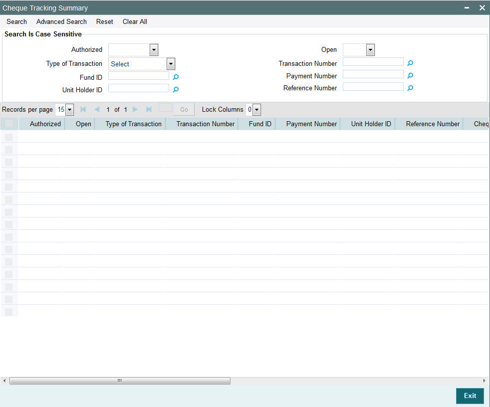

You can track the status of checks issued for dividend payments as well as redemption, incentive payments and entity commission payments in the system.
You can also view details of cheques uploaded into the system for payment tracking purposes. A dividend cheque will be considered as expired if the system date is greater than the cheque date or the sum cheque reissue date and expiry period as specified in PARAMS maintenance. Cheque status tracking is allowed for only those type of transaction maintained in PARAMS maintenance
Use the ‘Cheque Tracking Summary’ screen to do this. You can invoke this screen by typing ‘UTSCHQTR’ in the field at the top right corner of the Application tool bar and clicking on the adjoining arrow button.
Note
Note
For example:
You can search the record for Transaction Number by using the combination of % and alphanumeric value as follows:-

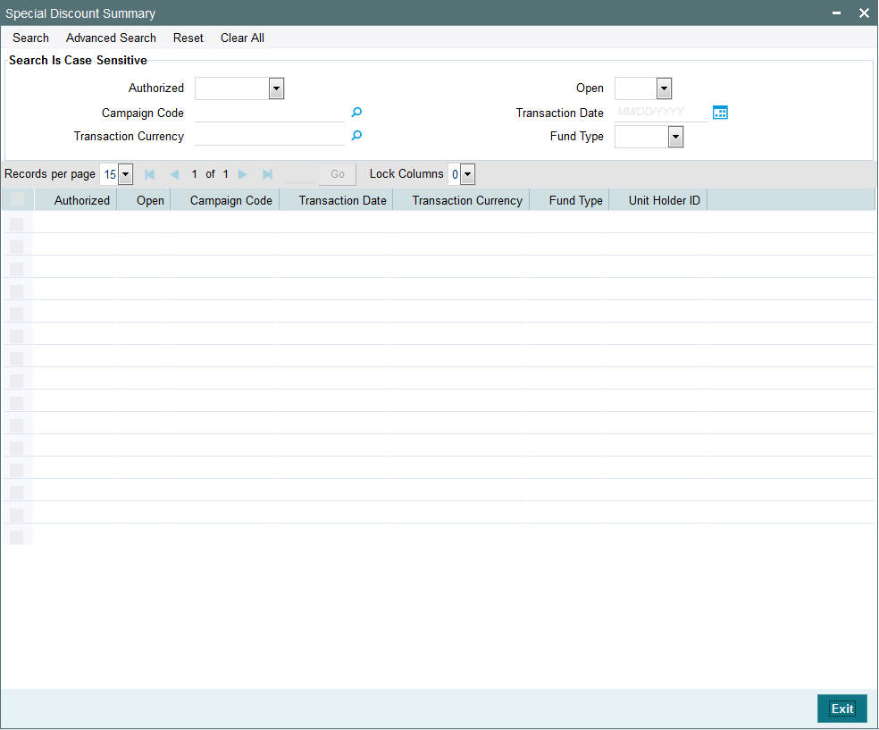

You can track special discount such as Birthday/ Gift Coupons benefits using ‘Special Discount Maintenance’ screen. You can invoke this screen by typing ‘UTDSPMNT’ in the field at the top right corner of the Application tool bar and clicking on the adjoining arrow button.
Fund Type
Optional
Select the type of the fund from the drop-down list. The list displays the following values:
By default, On-Shore Fund option will be selected.
Unit Holder ID
Specify the unit holder ID for whom the gift benefit is to be availed.
Click ‘Find UH’ button to invoke ‘Unitholder Find Options’ screen. You can fetch unit holder ID using this screen.
Transaction Date
Select the transaction date on which special discount is to be availed for the unit holder for all funds from the adjoining calendar.
Specify the transaction currency based on the gift benefit to be processed. Alternatively, you can select transaction currency from the option list. The list displays 2 valid transaction currency code, namely, BC and NBC.
The system will validate the transaction currency in case of Off-Shore fund.
Description
Display
The system displays the description for the selected transaction currency.
Campaign Code
Specify the campaign code of the birthday benefit. Alternatively, you can select campaign code from the option list. The list displays all the valid campaign code maintained in the system through Campaign Code Maintenance Screen (UTDCMPMN) along with ‘ZEROCAMP’ Param value under ‘SPLDISCNTOFFER’ Param code.
By default, ZEROCAMP will be selected.
You can invoke the ‘Special Discount Summary’ screen by typing ‘UTSSPMNT’ in the field at the top right corner of the Application tool bar and clicking on the adjoining arrow button and specify any or all of the following details in the corresponding details.
Note

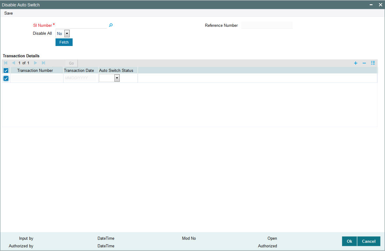

You can view all subscription transactions as part of pseudo switch to target fund for which yield computation will be performed. The system will fetch the data based on the SI number entered.
You can disable a transaction from considering for yield computation. Once disabled, the transaction will not appear in this screen when fetched again. Also you cannot enable a transaction once it is disabled.
You can disable a transaction using ‘Disable Auto Switch’ screen. You can invoke this screen by typing ‘UTDAUSWB’ in the field at the top right corner of the Application tool bar and clicking on the adjoining arrow button.
SI Number
Specify the SI number of the transactions to be disabled. Alternatively, you can select the SI number from the option list. The list displays all valid SI number maintained in the system.
Reference Number
Display
The system displays the reference number to maintain data for disabling transactions.
Disable All
Optional
Select if the transaction has to disable or not from the drop-down list. The list displays the following values:
Click ‘Fetch’ button to view the transaction details.

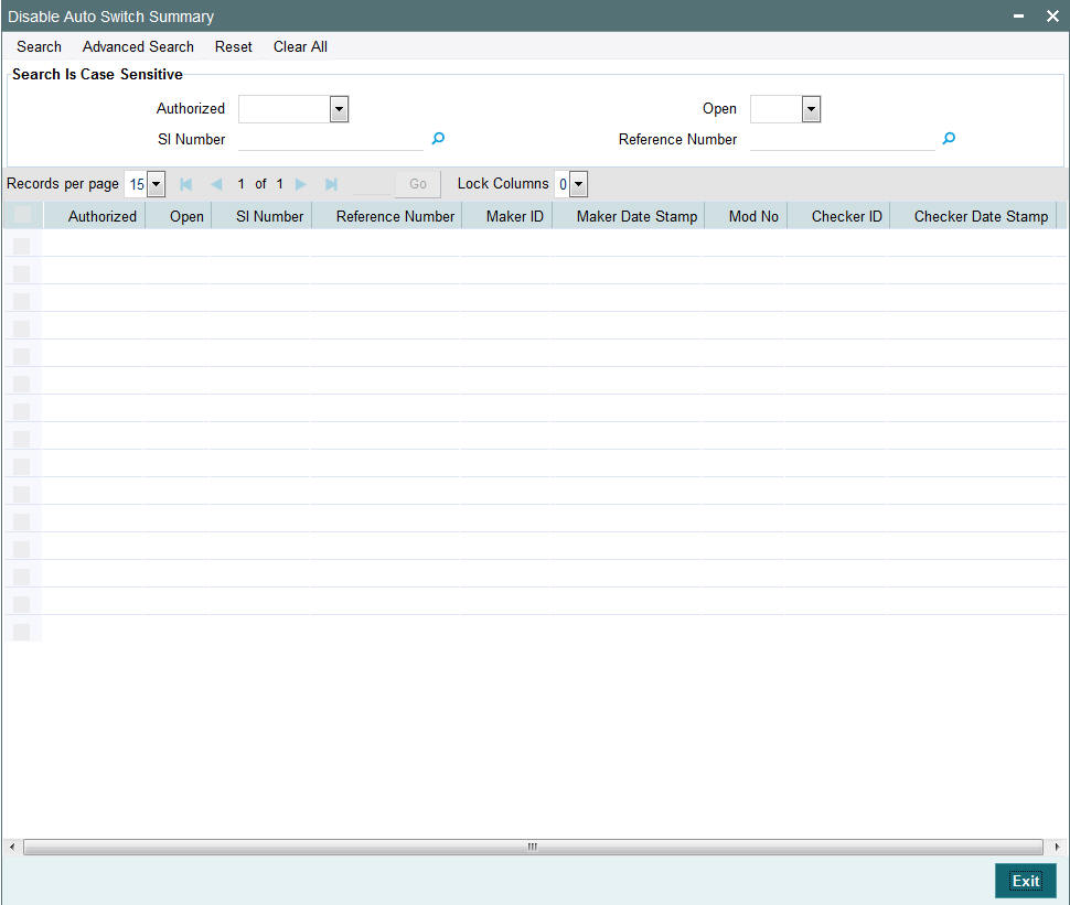

You can invoke the ‘Disable Auto Switch Summary’ screen by typing ‘UTSAUSWB’ in the field at the top right corner of the Application tool bar and clicking on the adjoining arrow button and specify any or all of the following details in the corresponding details.
Note

You can modify the details of disabled Auto Switch record that you have already entered into the system, provided it has not subsequently authorized. You can perform this operation as follows:
Click Save to save your changes. The Disable Auto Switch Detail screen is closed and the changes made are reflected in the Disable Auto Switch Summary screen.
To view a record that you have previously input, you must retrieve the same in the Disable Auto Switch Summary screen as follows:

You can process cheques using ‘Cheque Processing Detail’ screen. You can invoke this screen by typing ‘UTDCHEQP’ in the field at the top right corner of the Application tool bar and clicking on the adjoining arrow button.
From Entity Type
Optional
Select the entity type from which the cheque processing is initiating from the drop-down list. The list displays the following values:
To Entity Type
Optional
Select the entity type to which the cheque amount is being played from the drop-down list. The list displays the following values:
From Entity
Specify the entity from which the cheque processing is initiating. Alternatively, you can select ‘From Entity ID’ from the option list. The list displays valid From Entity ID maintained in the system.
To Entity
Specify the entity to which the cheque amount is being payed. Alternatively, you can select ‘To Entity ID’ from the option list. The list displays valid To Entity ID maintained in the system.
Fund ID
Specify the fund ID. Alternatively, you can select Fund ID from the option list. The list displays valid Fund ID maintained in the system.
ISIN Code
The system displays the ISIN code if you have specified the fund ID. Else, specify the ISIN code. Alternatively, you can select ISIN code from the option list. The list displays valid ISIN code maintained in the system.
The system displays the ISIN code if you have specified the fund ID and vice versa.
Load ID
Numeric; 5 Characters; Optional
Specify the load ID for the cheque processing. Alternatively, you can select Load ID from the option list. The list displays valid Load ID maintained in the system.
From Date
Select the date from which the cheques are to be processed from the adjoining calendar.
To Date
Select the date to which the cheques are to be processed from the adjoining calendar.
You can initiate the cheque processing activity by clicking ‘Process’ button.

You can invoke ‘Authorization Screen’ by typing ‘UTDTXNAU’ in the field at the top right corner of the Application tool bar and clicking on the adjoining arrow button.
Click ‘New’ and specify unauthorized transaction number. The system displays the transaction details which can be authorized.
Transaction Number
Specify the transaction number to be queried and worked upon.
Payment Mode
Optional
Select the mode of payment from the drop-down list. The list displays the following values:
Units
Specify the units applied.
Percent
Numeric; 9 Characters; Optional
Amount
Click ‘Authorize’ button to authorize the transaction. The system displays the following values:
