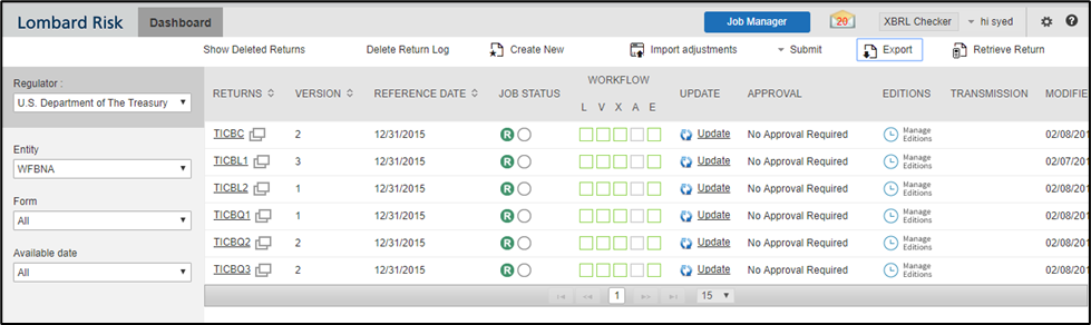

Prerequisites
It is assumed that you can log in and see the following menus and respective reports in AgileREPORTER.
Figure 106: AgileREPORTER
This means configurations activities for the AgileREPORTER and OFSAA are completed. Set up activities for Entity is done and reports templates, as shown above, are available for viewing. Report Names shown in the figure are for illustration purposes and the actual name depends on the integration pack licensed.

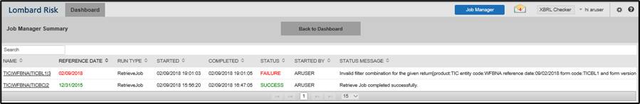

Invalid Filter Combination for the Given Return
If you are unable to generate reports and if you get the “Invalid filter combination for the given return” error, then there can be two possibilities for this failure:
1.     Data in the RUNEXESUMM view in the Atomic Schema is not matching with the Lombard retrieval that includes Date, Run, Entity, or Entity’s Consolidation Type.
 Figure 107: Data in RUNEXESUMM View
Data in RUNEXESUMM view in the Atomic Schema is not matching with the Lombard retrieval that includes Date, Run, Entity or Entity’s Consolidation Type.

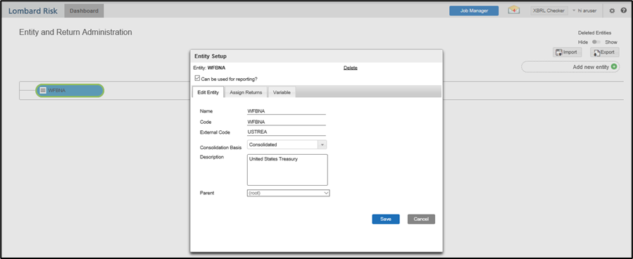

2.     External Code is not matching with the Code for Entity as per OFSAA.
Figure 108: Code for Entity

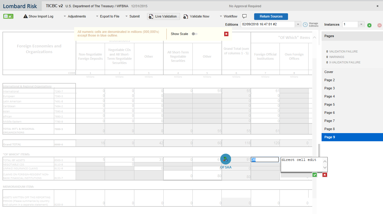

This use case is where you can reference data for a required cell of a schedule in AgileREPORTER; however, the value shown differs from the expected value.

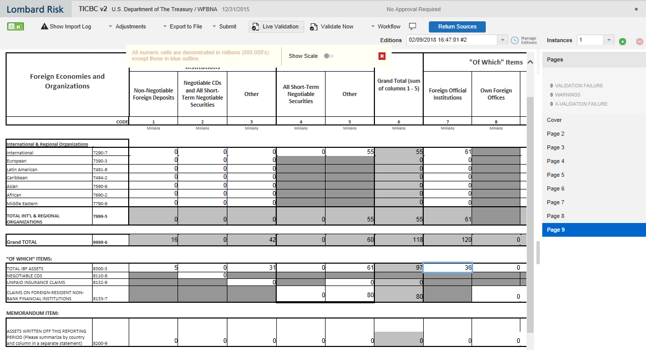

Let us take the following example to illustrate the steps to be followed. This refers to Report BC. A particular cell referred to here is L83003C07 of
·        TOTAL IBF ASSETS under
·        OF WHICH ITEMS of
·        Foreign Official Institutions
Figure 110: TICBC V2 Report
TICBC V2 Report
You can Drill down for each cell to check the details of data as to what is included in the aggregation. To Drill down, click the value of a particular cell, and it is shown as highlighted. It shows the OFSAA data lineage icon on clicking as shown in Figure 111.

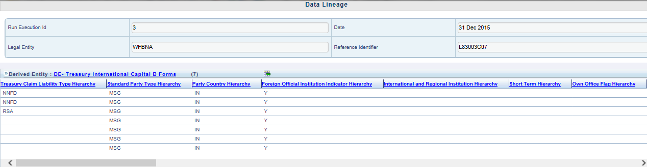

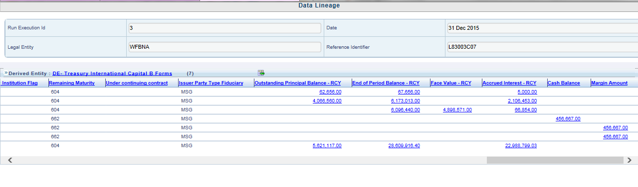

Figure 112:  AgileREPORTER Drill Down
This view helps to connect the AgileREPORTER aggregated data to OFSAA references.
The top pane of this screen shows the following information which helps to connect the AgileREPORTER aggregated data to OFSAA references.
1.     Run Execution ID: This refers to the OFSAA Execution ID chosen for a given report.
2.     Calendar Date: This refers to AS OF DATE selected for a given report.
3.     Legal Entity: This refers to the OFSAA Legal Entity for which the report is generated.
4.     Reference Identifier: This is the cell reference for which data Drill down or lineage is being checked.
The second block displays all hierarchies with values used in a given Derived Entity and measures aggregated for a given combination of hierarchy values.
To refer to the measure values, scroll rightwards using the horizontal scroll bar at bottom of the second block. On the extreme right, measures are displayed as shown in Figure 113:
Figure 113: Measure Values
The measure values window shows the hyperlinks to the data which can be further driled down
Only measure values are hyperlinked indicating that they can be drilled down further. On clicking the amount, second-level Drill down shows the lowest granularity data available for a given cell reference.

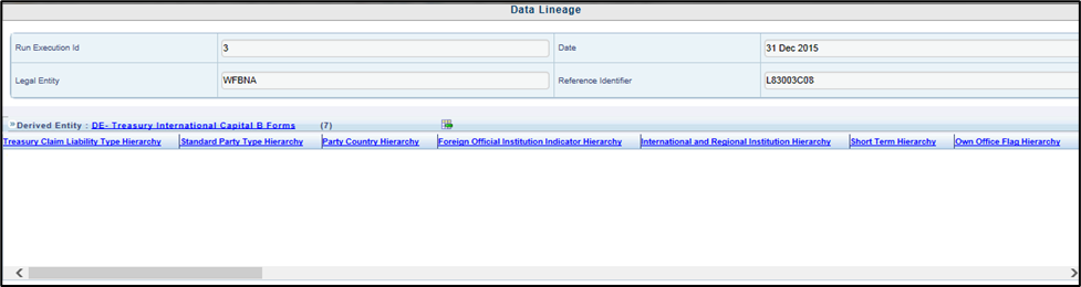

Drill Down View is Unavailable
If the second block does not show any data, then data analysts or you are advised to see the Dataset worksheet of Business Metadata.
Figure 114: Drill Down Data Unavailable
There can be a few reasons why the Drill down screen does not show the data:
1.     Internet connection is timed out or broken down - in this case clicking Data Lineage on AgileREPORTER results in a Drill down the page. To rectify this, re-login to OFSAA infrastructure and AgileREPORTER.
2.     Drill down data view works after Metadata is published using OFSAA Infrastructure to validate if Metadata is properly published or not.
3.     If Metadata is published and the Drill down screen still does not show the data, then start with the Derived Entity code shown at the beginning of the Drill down screen. This Derived Entity code is available even if data is unavailable.

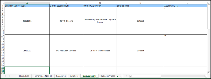

4.     Using this Derived Entity code, data analysts are advised to see the OFSAA Business Metadata document with the worksheet name as Derived Entity. Sample Business Metadata excel is shown in the following Figure 115:
Figure 115: Business Metadata-1
Using this Derived Entity code, data analysts are advised to see the OFSAA Business Metadata document with the worksheet name as Derived Entity. Sample Business Metadata excel.

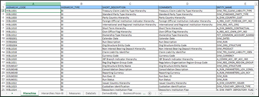

5.     By referring to the Business Metadata document, you can get complete information on Derived Entity such as dataset, Fact tables, measures, hierarchies defined under particular Derived Entity.
Figure 116: Business Metadata-2
The Dataset ANSI Joins provides valuable information on how various entities are joined or linked together. By executing these Joins, you can confirm if data is available for given filters and conditions. If data is fetched using Dataset Joins and Data Lineage does not show data, you must log a Bug or Service Request with My Oracle Support.
