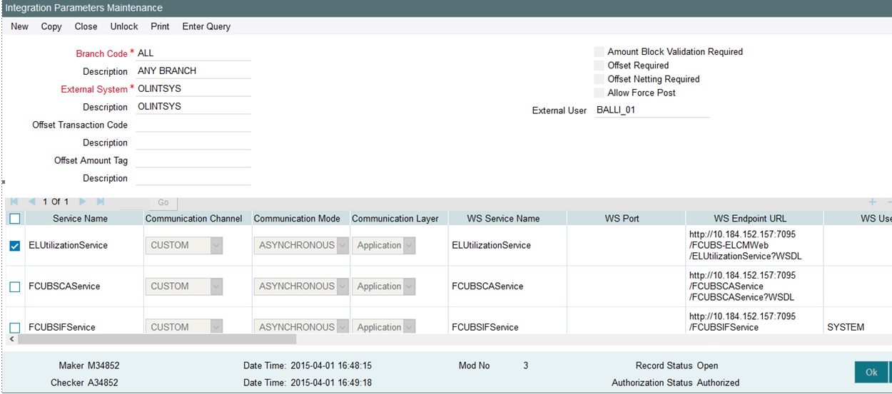

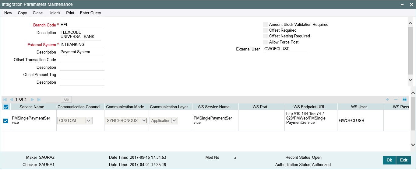

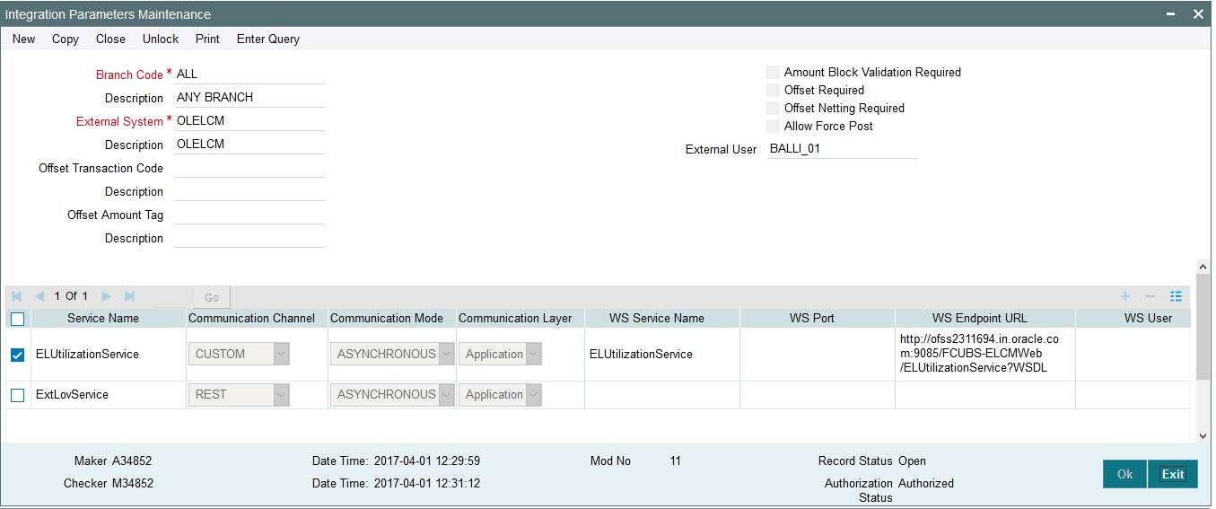

To invoke this screen, type ‘IFDINPRM’ in the field at the top right corner
of the application toolbar and click the adjoining arrow button.
Example of Integration Parameter Maintenance screen for Payments
Example
of Integration Parameter Maintenance screen for ELCM
Parameter Maintenance screen for OBCL
You can specify
the following fields in this screen:
Branch Code
Select the branch code for which the parameters are to be maintained
from the adjoining option list.
Description
A brief description of the branch code is displayed.
External System
Select the external system for which the parameters are to be maintained,
Description
A brief description of the external system is displayed.
Offset Transaction Code
Select a transaction code for the offset entry from the adjoining
option list. The adjoining option list displays all valid transaction
codes available in the system. You can select the appropriate one
Offset Amount Tag
Select an amount tag for the offset entry from the adjoining option
list. The adjoining option list displays all valid amount tag available
Amount Block Validation
Select this check box to validate the amount block. If the amount
block reference number is sent with the transaction details then the
accounting will be invoked after the release of amount block.
Offset Required
Select this check box if an offset entry is required. If this check
box is selected, then ISB GL will be resolved based on branch, currency,
function id and external system. If the check box is not selected, then
it is expected that external system sends the balanced entry
Offset Netting Required
Select this check box if offset netting entry is required. If this
check box is selected, then the consolidated entries will be built. Offset
amount tag is picked from the maintenances. If this check box is not
selected, then individual entries are built.
Allow Force Post
Select this check box to suppress all the overrides after posting
transactions.

- External System - External system name is specified here. For example,
OLELCM, INTBANKING for Payments, and OLINTSYS for OBCL.
- Service Name – The service name for which the maintenance is
done. For example, ELUtilizationService for ELCM, ExtLovService for External
LovExtLovService, and PMSinglePaymentService for Payments, and FCUBSCAService
for OBCL.
- Communication Channel – The communication channel like REST,
CUSTOM, WEB SERVICE, and so on are specified here.
- Communication Mode – The communication mode can be SYNC/ASYNC.
Note
Rest Service need not be maintained for OBCL.
- Rest Service IP – You have to maintain the IP address. For
example, ELCM IP, Payment IP.
- Rest Service Port – You have to maintain port details. For
example, ELCM Port, Payment Port.
- Rest Service Pattern - You have to maintain rest service pattern.
For example, LovService
- Rest Service Context – You have to maintain rest service context.
For example, FCJNeoWeb
- External User - ELCM/Payment/OBCL user should have access to all
branches and autoauth
ELCM Utilization/Payment/OBCL
OLELCM.
LovExtLovService and PMSinglePaymentService for Payments.
- WS Service Name – The service name needs to be maintained here.
For example, ELUtilizationService, PMSinglePaymentService, and FCUBSCAService.
- WS Endpoint URL – The WSDL of the services are maintained here.
For example, ELCM utilization/Payment/CA service WSDL link
- WS User – ELCM/Payment user should have access to all branches
and autoauth.
branches and autoauth.

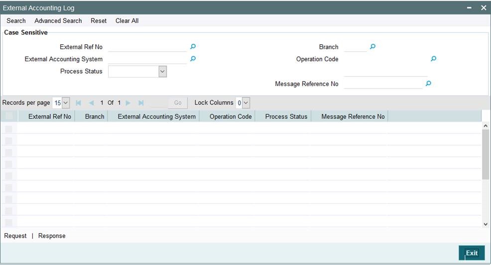

2.3.2 Viewing External Accounting Log
'External Accounting Log' screen contains OL/LS transaction details
with External Accounting System linkage.
To invoke this screen, type ‘OLSEACLG’ in the field at the top right corner
In this screen, you can view the request sent from OL and LS module
and view the response (received for the request sent) from the External
Accounting System.
You can search records
based on the following parameters:
- External Reference Number
- Branch
- External Accounting System
- Operation Code
- Process Status
- Message Reference Number
Click ‘Search’ button with or without entering any of
the above search parameters. All records matching the search criteria
are displayed. To view a particular record double-click on the desired
record displayed in the list of records. The details pertaining to each
record is displayed.

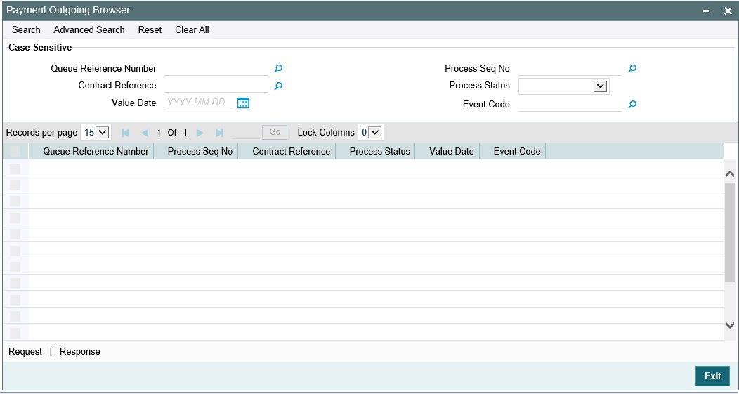

2.4.3.2 Viewing Payment Integration Request/Response Messages
You can view Oracle Lending and Loan Syndication contracts with payment
integration in ‘Payment Outgoing Browser’ screen.
To invoke this screen, type ‘OLSPMTBR’ in the field at the top right corner
In this screen, you can view the request sent from Oracle Lending/Loan
Syndication module and view the response (received for the request sent)
from the Payments module.
- Queue Reference Number
- Sequence Number
- Contract Reference
- Process Status
- Value Date
- Event Code
Note
To search outgoing payment details, for LB side use
DD Contract Reference Number and for LP side use Contract Reference Number

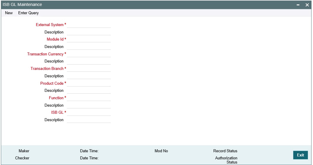

2.4.3.3 Maintaining ISB GL
You can invoke the ‘ISB GL Maintenance’ screen by typing
‘OLDISBGL’ in the field at the top right corner
of the application tool bar and by clicking the adjoining arrow button.
You can specify the
following field information in this screen. A brief description of each
value updated in the fields appearing in this screen, is displayed by
the system.
External System
Select the external system from the adjoining option list.
Module ID
Select a valid module code from the adjoining option list.
Transaction Currency
Select a valid currency code from the adjoining option list.
Transaction Branch
Select a valid transaction branch code from the adjoining option list
Product Code
Select a valid product code from the adjoining option list.
Function ID
Select a valid function ID from the adjoining option list.
ISB GL
Select a leaf General Ledger from the adjoining option list.

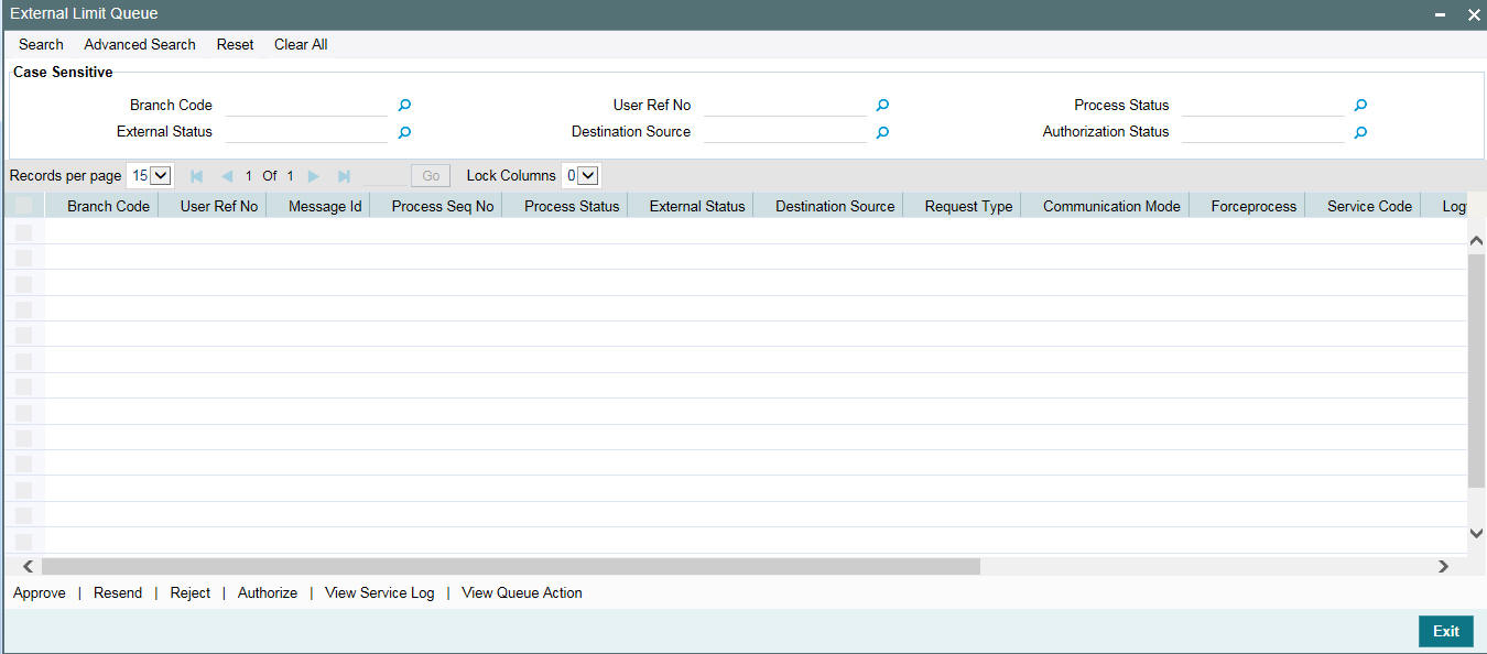

2.5.3.1 Viewing External Limit Summary
Details
External Limit Summary screen contains details of the Oracle Lending
and Loan Syndication transactions with ELCM linkage.
You can approve, resend, reject, and authorize the Oracle Lending
and Loan Syndication transactions using this screen.
To invoke this screen, type OLSEXLMT’ in the field at the top right corner
- Branch Code
- User Reference Number
- Message ID
- Process Sequence Number
- Process Status
- External Status
- Destination Source
- Request Type
- Forceprocess
- Service Code
- Logtime
- Authorization Status
- Maker ID
- Maker Date Stamp
- Checker ID
- Checker Date Stamp

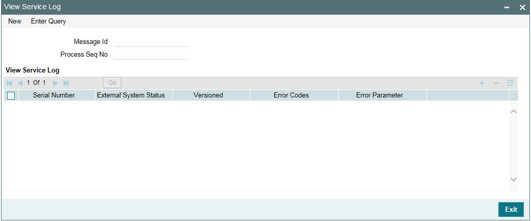

2.5.4 Viewing Service Log Details
You can view service log using ‘View Service Log’ screen.
To invoke this screen, type ‘OLDSRLOG’ in the field at the top right corner
