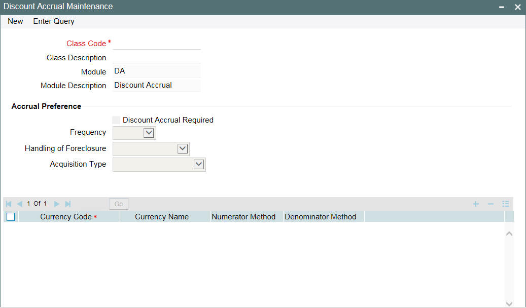

7.2 Defining a Discount Accrual Fee class
A discount accrual fee class specifies the accrual parameters for interest, charges and fees.
You can define the attributes of a discount accrual fee class in the ‘Discount Accrual Preference Class Maintenance’ screen.
You can invoke the ‘Discount Accrual Maintenance’ screen by typing ‘OLDACRCL’ in the field at the top right corner of the Application tool bar and clicking the adjoining arrow button.
Before defining the attributes of a discount accrual fee class, you should assign the class a unique identifier, called the Class Code and briefly describe the class. A description would help you easily identify the class.
When building a discount accrual fee class, you define certain attributes such as:
7.2.1 Associating Discount Accrual Components to Products
After building discount accrual fee classes you can associate the class with loans or bills products. Click the ’Discount Accrual’ in the ‘Product Definition’ screen. The ‘Discount Accrual Preference Association’ screen is invoked.
To associate discount accrual fee class with a product, click ‘Default From Class’ in the ‘Discount Accrual Preference Association’ screen. Select the appropriate discount accrual fee class from the list of classes.
The attributes defined for the discount accrual fee class defaults to the product. You have the option to modify the attributes defined for the class, to suit the requirement of the product you are creating.
Alternatively, you can choose to define the discount accrual details for the product.
