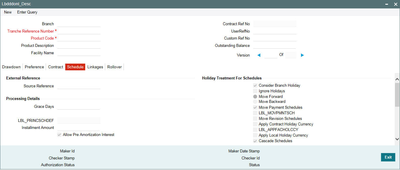

You can capture Drawdown contract details in the in the ‘DRAWDOWN’ tab of the ‘Drawdown Contract Online’ screen.
You can invoke the ‘Drawdown Contract Online’ screen by typing ‘LBDDDONL’ in the field at the top right corner of the Application tool bar and clicking the adjoining arrow button.

Schedule dates for a drawdown could fall on holidays defined for your branch or on holidays defined for the drawdown currency. In addition, schedules may also fall due on the other currencies, as per your specification in the ‘SCHEDULE’ tab of the ‘Drawdown Contract Online’ screen.
In the Product Preferences for the borrower facility product, you can specify whether the system should check for schedule dates falling on holidays, and how such schedule dates must be handled. These specifications would default to any borrower facility using the product. It will also default to underlying borrower tranches or drawdowns that are opened under the facility if you specify the ‘Holiday Default Basis’ as ‘Facility’ when maintaining a Borrower/Tranche product (in the ‘Additional Preferences for Loans Syndication’ screen).
You can specify that any of the following:
You can specify the holiday treatment type for schedules falling due on holidays in the ‘Holiday Treatment for Schedule’ section of the ‘SCHEDULE’ tab of the ‘Drawdown Contract Online’ screen. The Holiday Treatment Type is the parameter that defines how the system checks for schedule dates falling on holidays. You can specify one of the following options:
Ignore Holidays
You have to check this option to instruct the system to ignore the holiday. Payment schedules are processed as per the due date even if the schedule falls due on a holiday.
Include Branch Holiday
Select this option to indicate that you want the system to check whether a schedule date falls on a local holiday defined for the branch.
The system checks the holiday table for your branch. If it encounters a contract entered in your branch, with a schedule date falling on a branch holiday, the holiday is handled according to the holiday-handling preferences you specify.
Holiday Currency
You can also select a currency for the holiday check. The system checks the holiday calendar maintained for the selected currency before arriving at the schedule due date.
The system checks the holiday table for the currencies you have specified. If it encounters a contract using any of the specified currencies, with a schedule date falling on a holiday for any of the currencies, the holiday is handled according to the holiday-handling preferences you specify.
Move Backward or Forward
You can indicate whether the schedule date falling on a holiday must be moved forward to the next working day, or backward to the previous working day.
Move Across Months
If you have indicated either ‘Forward’ or ‘Backward’ movement of a schedule date falling due on a holiday, and the moved schedule date crosses over into a different month, you can indicate whether such movement is allowable; it is allowable only if you check this option.
Cascade Schedules
If one schedule has been moved backward or forward in view of a holiday, cascading schedules would mean that the other schedules are accordingly shifted. If you do not want to cascade schedules, then only the schedule falling on a holiday is shifted, as specified. The other schedules remain unaltered.
Move Payment Schedules
You may check this option to indicate that the holiday processing rule should be applied on repayment schedules as well. This is applicable only to drawdown products.
Move Revision Schedules
You may check this option to indicate that the holiday processing rule should be applied to interest rate revision schedules as well.
Use Tranche Currency
If you choose this option, the system checks whether the schedule date falls on a holiday defined for the currency of the tranche (borrower), if this currency is different from the holiday currency you have indicated.
Use Contract Currency
If you choose this option, the system checks whether the schedule date falls on a holiday defined for the currency of the drawdown contract, if this currency is different from both the holiday currency and the facility currency (if any) you have indicated.
Use Local Currency
If you choose this option, the system checks whether the schedule date falls on a holiday defined for the local currency, if this currency is different from the holiday currency, facility currency and contract currency you have indicated.

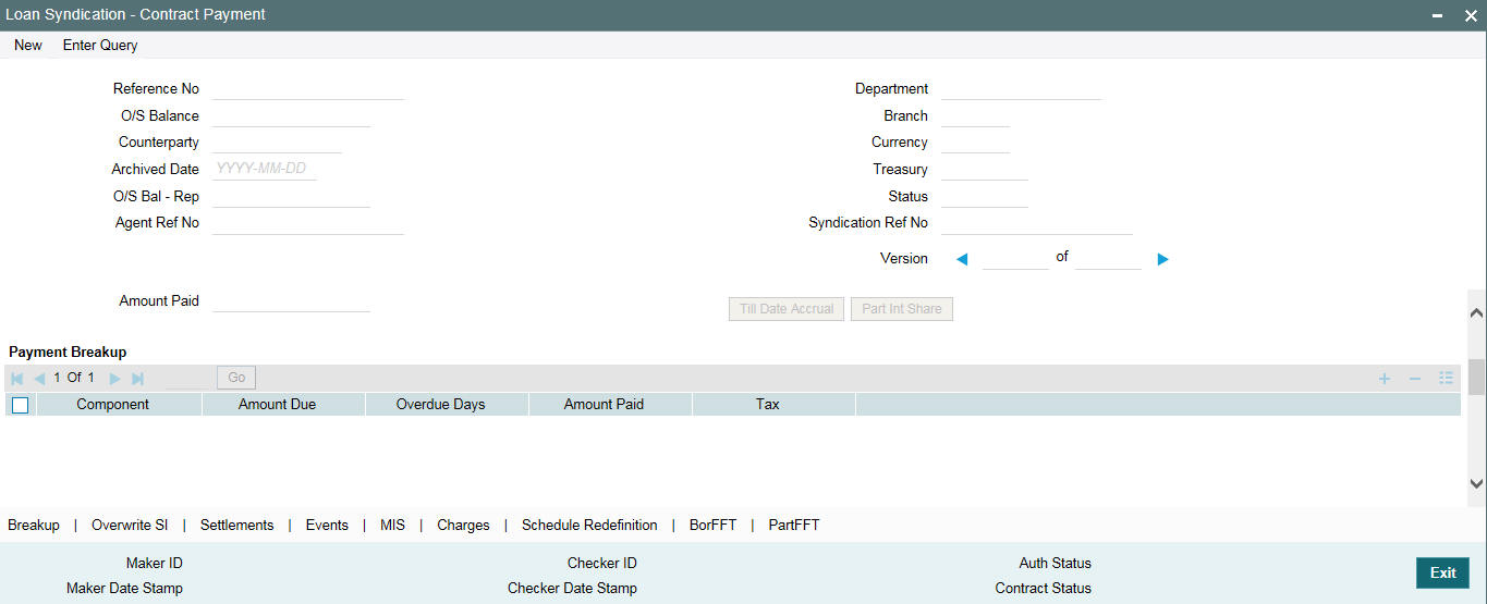

You process payments through the ‘Contract Payment’ screen.
You can invoke the ‘Loan Syndication - Contract Payment’ screen by typing ‘LBDPYMNT’ in the field at the top right corner of the Application tool bar and clicking the adjoining arrow button.
The manner in which you perform manual liquidation for a drawdown in the ‘Contract Payment’ screen is the same as for a normal loan contract.

From Loan Syndication Contract -Payment screen (LBDPYMNT), click ‘Part Int Share’ button to invoke the screen, ‘Payment Breakup for Participants’ with details of all the participants under the drawdown and outstanding interest (Cash Interest) for each participant under the field ‘Amount Due’.
Amount Paid
Specify the individual participant share amount for the interest being paid.
While saving the record and on click of ‘ok’ button in the Payment Breakup for Participants’ screen, the system validates if the total sum of the entire participant interest share amount entered in ‘Amount Paid’ matches with the borrower ‘Amount Paid’.
Amount Paid entered by user for each participant level is used for :
Note
Cash interest paid cannot be greater than amount due for borrower; the same validation is applicable for participants as well.

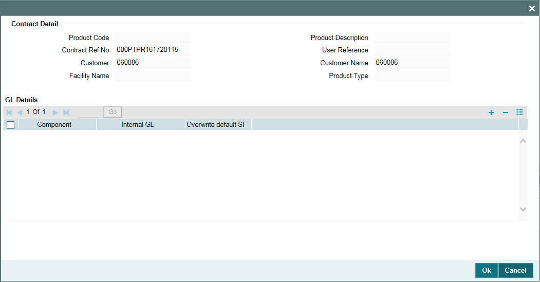

You can maintain settlement instructions for various components such
as fees, charges, tax, principal, interest, and so on, using the ‘Overwrite
Settlement Instruction Details’ screen. Using this screen, you
can post liquidation entries into an Internal GL account instead of the
customer account at the time of rollover. Click ‘Overwrite SI’ in the ‘Loan Syndication - Contract
Payment’ screen to invoke the following:
Component
This screen displays the all the components displayed in the Settlement Message Details screen that is, fees, charges, principal, interest, and so on.
Internal GL
Specify the Internal GL accounts into which you want to post the liquidation entries for the components.
Overwrite Default Settlement Instruction
Select the ‘Overwrite default settlement instruction’ box to confirm that the liquidation entries should be posted into the Internal GL account. System posts the entries to the Internal GLs only if you check this box. Otherwise, the system posts the entries as per the settlement instructions specified for the component of the contract.
Note
You can maintain the Internal GL account anytime during the life cycle of the contract.

Click ‘Ok’ button to return to the ‘Contract Payment’ screen. In this screen, you have to specify the ‘Amount Paid’ which is distributed amongst the selected participants as per the relative distribution ratio.
When you save a non-pro rata payment for a drawdown under a pro-rata type of tranche (the ‘Cascade Participation’ box is selected in the ‘LS Tranche Contract Online’ screen), the system converts the tranche into a non-pro rata type (the ‘Cascade Participation’ option is unchecked). The system also recalculates the asset ration for the drawdown.
For information on non-prorata rollover, refer the section titled ‘Processing Non-Prorata Rollovers’ in the ‘Rolling over a drawdown’ chapter of this User Manual.
