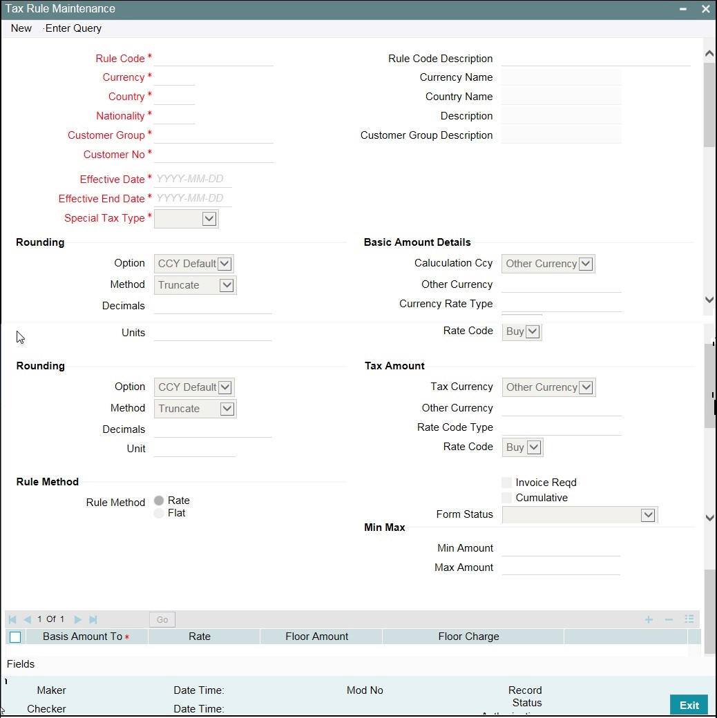

2.3 Defining Tax Rules
A tax rule identifies the method in which a tax component (a Stock Exchange tax, a Local tax, and so on.) is calculated. You can build tax rules in the Tax Rule Maintenance screen, invoked from the Application Browser.
You can invoke the ‘Tax Rule Maintenance’ screen by typing ‘TXDRULES’ in the field at the top right corner of the Application tool bar and clicking the adjoining arrow button.
Specifying TAX Rule related parameters
In ‘Tax Rule Maintenance’ screen, assign a unique ‘Rule Code’ and a brief Rule Code Description’ to the rule being built. The tax rule is maintained for a combination of Rule Code + Currency + Country +Nationality + Customer Group + Customer Number + Effective Date.
The currency selected indicates the transaction currency. You also have the option to select ‘ALL’ to indicate that the rule is applicable to transactions in any currency. It is mandatory to specify the currency to save the Tax Rule.
Then define the attributes of the rule, such as the Effective Date, the Tax Currency and the application method.

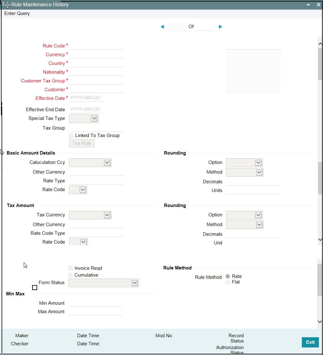

2.3.4 Viewing the Tax Rule History Details
You can view the history of tax rule in the ‘Tax Rule Maintenance History’ screen.
You can invoke the ‘Tax Rule Maintenance History’ screen by typing ‘TXDRLHIS’ in the field at the top right corner of the Application tool bar and clicking the adjoining arrow button.

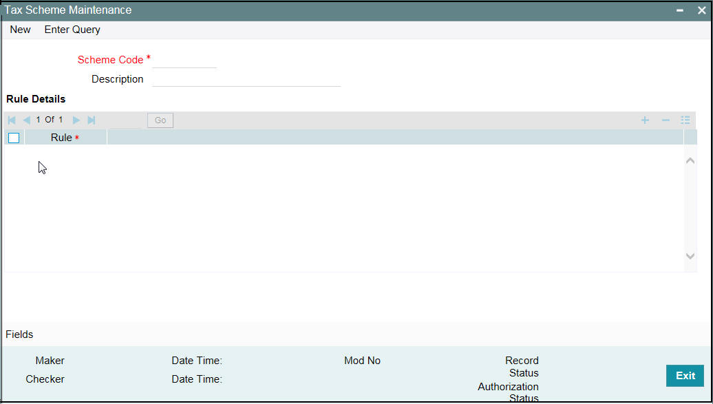

2.4 Maintaining a Tax Scheme
You can invoke the ‘Tax Scheme Maintenance’ screen by typing ‘TXDSCMNT’ in the field at the top right corner of the Application tool bar and clicking the adjoining arrow button.

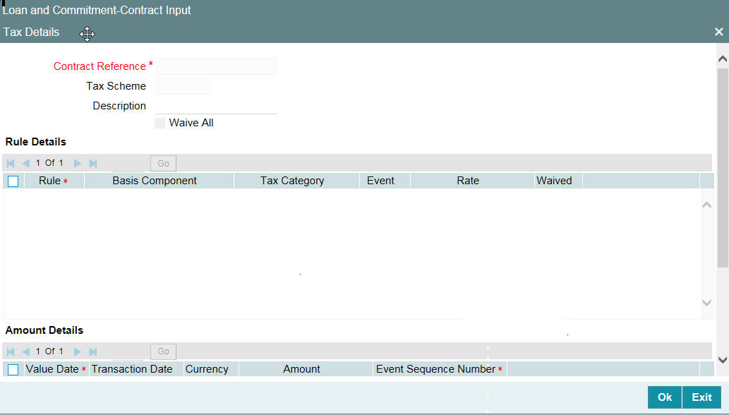

2.6 Processing Tax on a Contract
The taxes that apply on a contract can be of two types: ‘Expense’ and ‘Withholding’. The tax that is borne by your bank is referred to as an ‘Expense’ type of tax. This tax is booked to a ‘Tax Expense’ account. The tax that is borne by counter party of a contract is referred to as a withholding tax, whereby you debit the counter party’s account, and credit the tax component into a Tax Payable account (to be paid to the government on the counter party’s behalf).
Example
A tax on a Letter of Credit (LC) can be levied either on the:
In both cases, it is the bank that bears the tax - this is an Expense type of tax. The tax expense account should be debited and the tax payable account should be credited. From this liability account, the tax should be later on, paid to the government.
You can invoke the ‘Tax Details’ sub-screen from the ‘Loan and Commitment-Contract Input’ screen (OLDTRONL) while you are processing a contract.
You have a choice of waiving tax due to all the Tax Rule(s) linked to the Tax Scheme applicable to the product (and hence the contract) or that which is only due to specific Tax Rule(s).

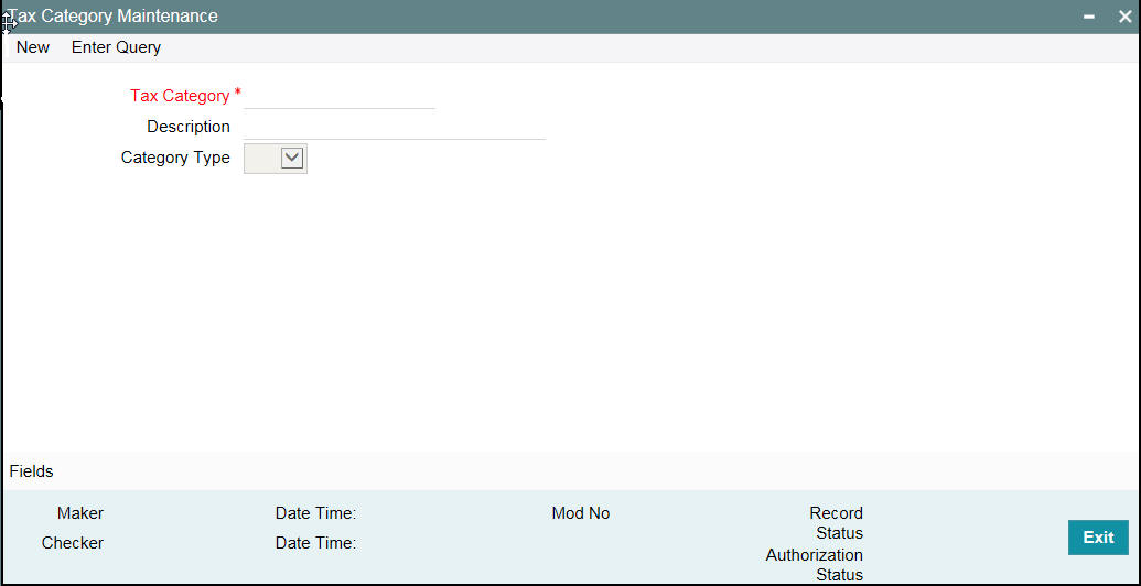

2.7 Maintaining Tax Categories for contracts
While maintaining Customer Information details you need to capture waiver information for tax computation. All the tax categories you maintain here will be displayed at the product level, allowing you to link the tax category to the product.
Tax categories, along with a brief description of the category can be maintained through the ‘Tax Category Maintenance’ screen.
You can invoke the ‘Tax Category Maintenance’ screen by typing ‘TXDCATMT’ in the field at the top right corner of the Application tool bar and clicking the adjoining arrow button.
Specifying the Tax category
You can capture a unique code to identify the tax category.
Note
While maintaining product details and associating a tax category, a list of all the valid tax categories you have maintained in this screen are available in the option list for the Tax category field. You can select the appropriate code.
Assigning a brief description with the tax category
You can also associate a brief description with the tax category. This description is for information purposes only and not be printed on any customer correspondence.
Category Type
Here you can classify each tax category under Tax or IC. If the tax category is maintained under Tax, the categories are available at the product level for selection. However, the tax category maintained under IC are available only at the IC rule definition level. You need to calculate the tax on customer account balances.
