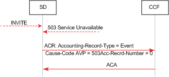

This example call flow shows how a 5xx server failure results in the sending of an Event ACR.
Call Flow Example Showing Event ACR Generation Due to 5xx Server Failure
The following call flow example shows two session agents. The first session agent replies with 503, which results in an Event ACR with cause code 503. The second session agent replies with 200OK that causes the sending of a Start ACR. The generate-start parameter is OK.

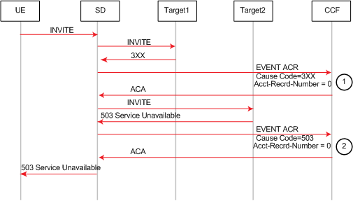

Call Flow Example Showing Generation of Event ACRs Due to 5xx Server Failures

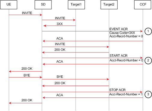

This example call flow shows an Event ACR that is created due to the reception of a 3xx SIP message. In this example the call fails after being redirected.
Event ACR Created Upon Reception of a 3xx Message Followed by Call Failure After Redirect
This example call flow shows an Event ACR that is created due to the reception of a 3xx SIP message. Then it shows a Start ACR upon reception of a 200OK. In this example the call succeeds after being redirected. The generate-start is OK.
Event ACR Created Upon Reception of a 3xx Message Followed by Call Success After Redirect
This example call flow shows a Start ACR being sent when an Invite is received and an Interim ACR that is created due to the reception of a 3xx SIP message. In this example the call succeeds after being redirected. The generate-start is Invite.
