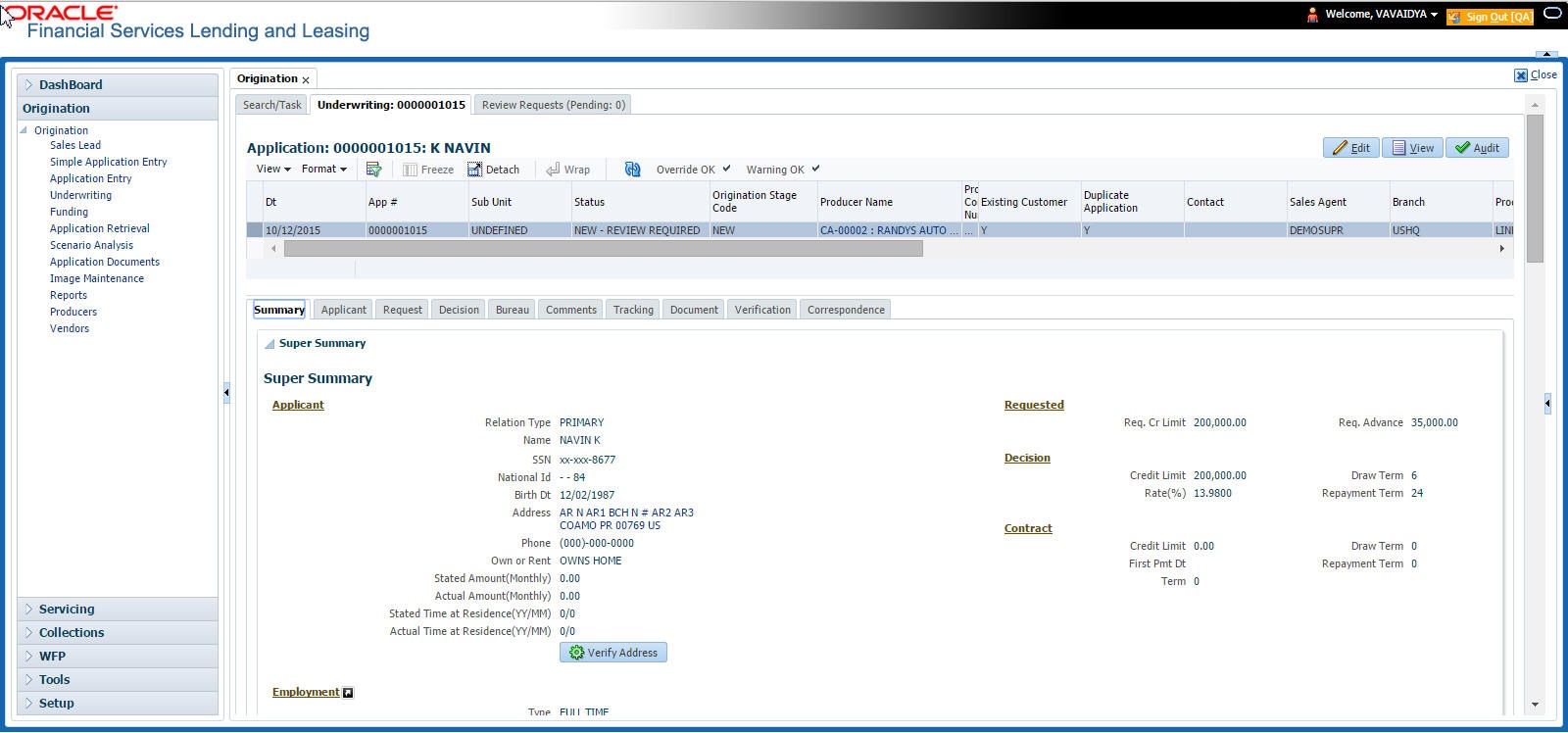

7.4 Summary Tab
The summary screen provides a unified view of the application details without navigating to the respective screens/ sub-tabs.
Using this screen, you can view the following details in their respective sections:
To view the Super Summary
  1. Open the Underwriting screen and load the application you want to work with.
  2. Click Summary tab. By default the system opens the summary tab. Expand the Super Summary section.
The Super Summary tab provides a snapshot of all relevant details in a single screen and contains details of Applicant, Employment, Ratios, Bureau, Requested financials, Decision updates, Contract updates and Primary Collateral details. You need not have to navigate to each of these tabs for specific information on the application. Also clicking on the hyperlinks of Address, Employment, Ratios, and Trade-In helps you to directly navigate to respective tab(s),
During the Underwriting and Funding stages, 'verified' button is displayed just below the address and employment details for each of the applicants. This would be enabled only when the Verified by and Verified Dt in the respective tabs are blank. You can verify the details from the Super Summary tab. Clicking on Verified will do the following:
  1. System will copy the stated values to Actual values.
  2. System will stamp the “Verified By” as 'User Name' and 'Verified Date' as 'Current GL Date' for the respective applicant.
  3. If 'Verified Details' are already updated in tab or if the details are stamped, this button will be disabled.
  4. 'Verified' button will be available when 'Actual Amount' equal to ZERO or 'Verified By' or 'Verified Date' is NULL.
You need not navigate to Address and Employment tab for verifying applicant details.
Decision details will be displayed when application has Origination Stage as “Review, Decisioned, Contract or Funded”. In case an application is Rehashed, only Decision information will be displayed and Contract information will not be displayed. Contract details will be displayed when application has Origination Stage as “Contract or Funded”.
The system displays the collateral details maintained in the collateral tab on click of navigation button under the headings Primary Collateral and Secondary Collateral. Collateral details for Unsecured loan also will be displayed if they are maintained.
All the trade-in details, if any, maintained in the application would be displayed on click of Navigation button.

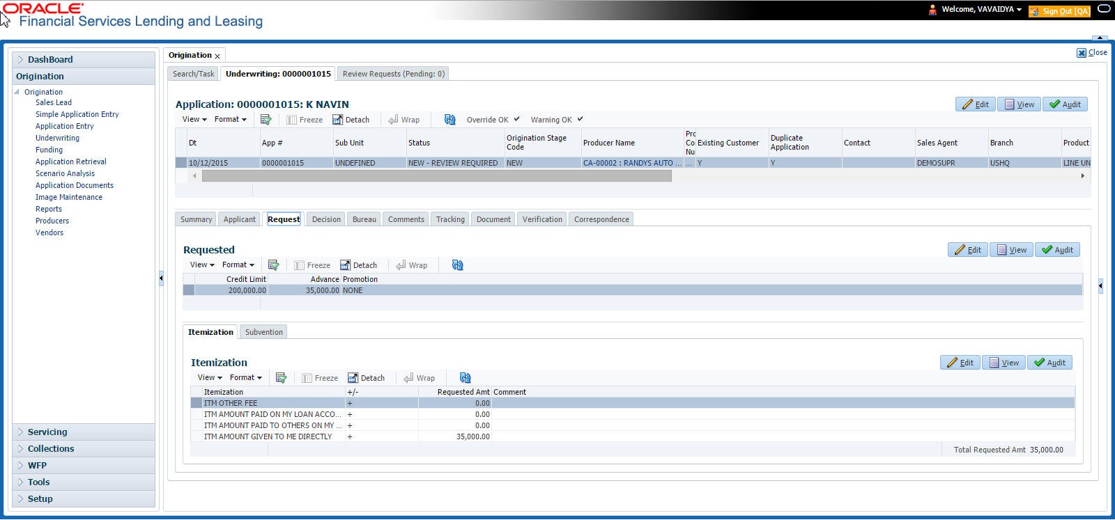

7.7 Request Tab
You can calculate Payment, Interest Rate, Term and Line of credit Amount using Request tab’s Calculate button. By default, system calculates for monthly repayment term basis. The payment frequency can be changed only in the Underwriting tab during decisioning.
To complete Request section:
  1. On the Application Entry tab, click Request tab.
  2. Perform any of the Basic Operations mentioned in Navigation chapter.
A brief description of the fields are given below:
Field
Do this
Credit Limit
Specify the value of the credit limit.
Advance
Specify the value of advance amount paid.
Promotion
Select the promotion type from the drop-down list.
  1. Perform any of the Basic Actions mentioned in Navigation chapter.
If you want system to calculate,
  1. Select the record you want to work with and from the drop-down option, select the option you want system to calculate:
  1. Click Calculate. The system displays the requested calculation in the respective field.
7.7.1 Itemization Sub Tab
The Itemizations sub tab enables you to add or verify any itemized amounts associated with the application. The list of itemizations is determined by the product you select in the master screen during the application entry process. The Itemizations sub screen displays an itemization record of the amount financed, such as the cash price, cash down payment, trade-in, unpaid cash price balance and so on. Information that was entered on the Itemization sub screen during the application entry process will appear in the Requested Amt column. Information that you enter as an underwriter in the Approved Amt column will appear in the Itemizations sub tab on the Underwriting screen.
Application request details need to be essentially entered in the itemization sub tab for pre-screening to be successful. Else, the system displays error and application would not proceed to the next level in work flow. The details of down payment, trade-in, insurance, fees etc. and the total sale price are recorded under itemization.
To add or view itemizations
  1. Open the Underwriting screen and load the underwriting application you want to work with.
  2. Click Request > Itemizations sub tab.
  3. Perform any of the Basic Operations mentioned in Navigation chapter.
A brief description of the fields is given below:
Field:
Do this:
Itemization
View the itemization.
View whether the itemized amount is added or subtracted from the Line of credit amount.
Requested Amt
Specify the requested amount.
Comment
Specify a comment.

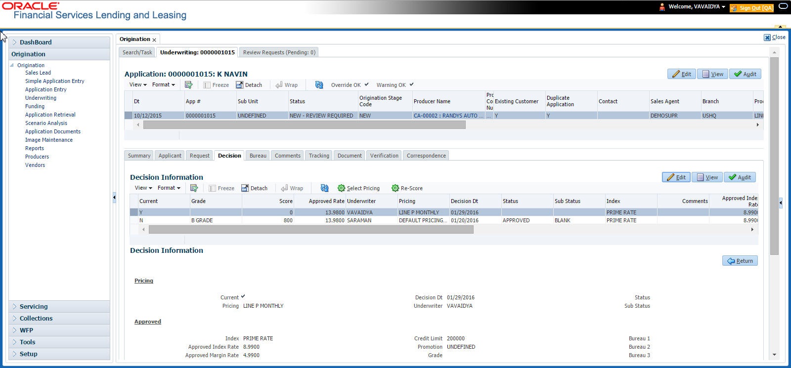

7.8 Decision Tab
If the application was initially approved automatically, the system displays its recommendations on the Decision tab’s Approved section.
If the application was initially rejected automatically, the system displays its reasons on the Decision link’s Stipulation sub tab.
If you choose to approve or reject the Line of credit manually, you must manually select the pricing (rule) set by the portfolio company for a specific product. The system validates this pricing against the information in the System Recommendation sections. The information in the Requested section comes from the application entry process and can be edited.
On clicking Calculate, you can calculate the Line amount, rate, term, and payment. You can use the calculator available in Tools section for completing this step. For detailed information on using the Calculator tools, refer “Tools” chapter in the document.
To verify the application decision data
  2. Click Decision tab.
    • A brief description of the fields is given below:
      Field:
      Do this:
      Pricing section
      Current
      Check this box to indicate that this is the current deci­sion.
      Pricing
      View the pricing.
      Decision Dt
      View the decision date.
      Underwriter
      View the underwriter id.
      Status
      View the application status.
      Sub Status
      View the application sub-status.
      Approved section
      Index
      Specify the index type.
      Approved Index Rate
      Specify the approved index rate.
      Approved Margin Rate
      Specify the approved margin rate.
      Approved Rate
      Specify the approved rate.
      Maturity Index
      Select the approved maturity index.
      Maturity Margin Rt
      Specify the maturity margin rate.
      Credit Limit
      Specify the credit limit.
      Promotion
      Select the promotion.
      Grade
      Select the credit grade.
      Score
      Specify the credit score.
      Draw Term
      Specify the draw term.
      Repmt Term
      Specify the repayment term.
      Bureau 1
      Specify the Bureau 1.
      Bureau 2
      Specify the Bureau 2.
      Bureau 3
      Specify the Bureau 3.
      Comments
      Specify comments, if any.
  2. Click Select Pricing.
The system determines the best pricing match of all enabled Line of credit pricing strings in the Setup menu and displays the results in the Pricing and Approved sections.
  1. Re-Score
A 'Re-Score' button is available next to 'Calculate'. Whenever any sensitive Financial or Collateral information is amended in the Application, OFSLL displays a warning message 'Scoring sensitive information is changed. Re-score the application'. You need to click on Re-Score to re-validate the grade and pricing accordingly.
The display of the warning message to Re-score the application can be controlled using the respective System parameter. If the defined System Parameter is flagged 'Y', only then the message is displayed.
If you are underwriting a Line of credit, record the following information on the Decision tab:
  1. If you are approving the application, complete the Approved section with the values you want to approve as an underwriter. You can update the default values that appeared when you selected the pricing string in step 3. (The system calculator may be of use when completing this section. For more information, refer the Tools chapter.)

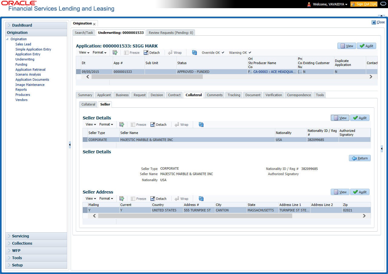

7.11.3 Seller Tab
The Collateral link’s Seller Details tab enables you to enter the seller details of the collateral of the Line of credit.
To enter the Seller details
  1. Click the Seller Details tab.
Field:
Do this
Seller Information section
Seller Type
Select the seller type.
Seller Name
Specify the seller name
Nationality
Select the seller’s nationality.
National ID/Reg #
Specify the national identification number or registration number.
Authorized Signatory
Specify the authorized signatory of the seller.
Seller Address section
Mailing
Select if this is the mailing address. Only one address entry can be marked as the mailing address.
Current
Select if this is a current address. The mailing address must be marked as current.
Country
Select the country code.
Address #
Specify the address number.
Address Line 1
Specify the first address line.
Address Line 2
Specify the second address line.
State
Select the state.
Zip
Select the zip code.
For non US country, you have to enter zip code.
Zip Extn
Select the zip extension.
City
Specify the city.
Phone
Specify the telephone number.
Extn
Select the telephone extension.
