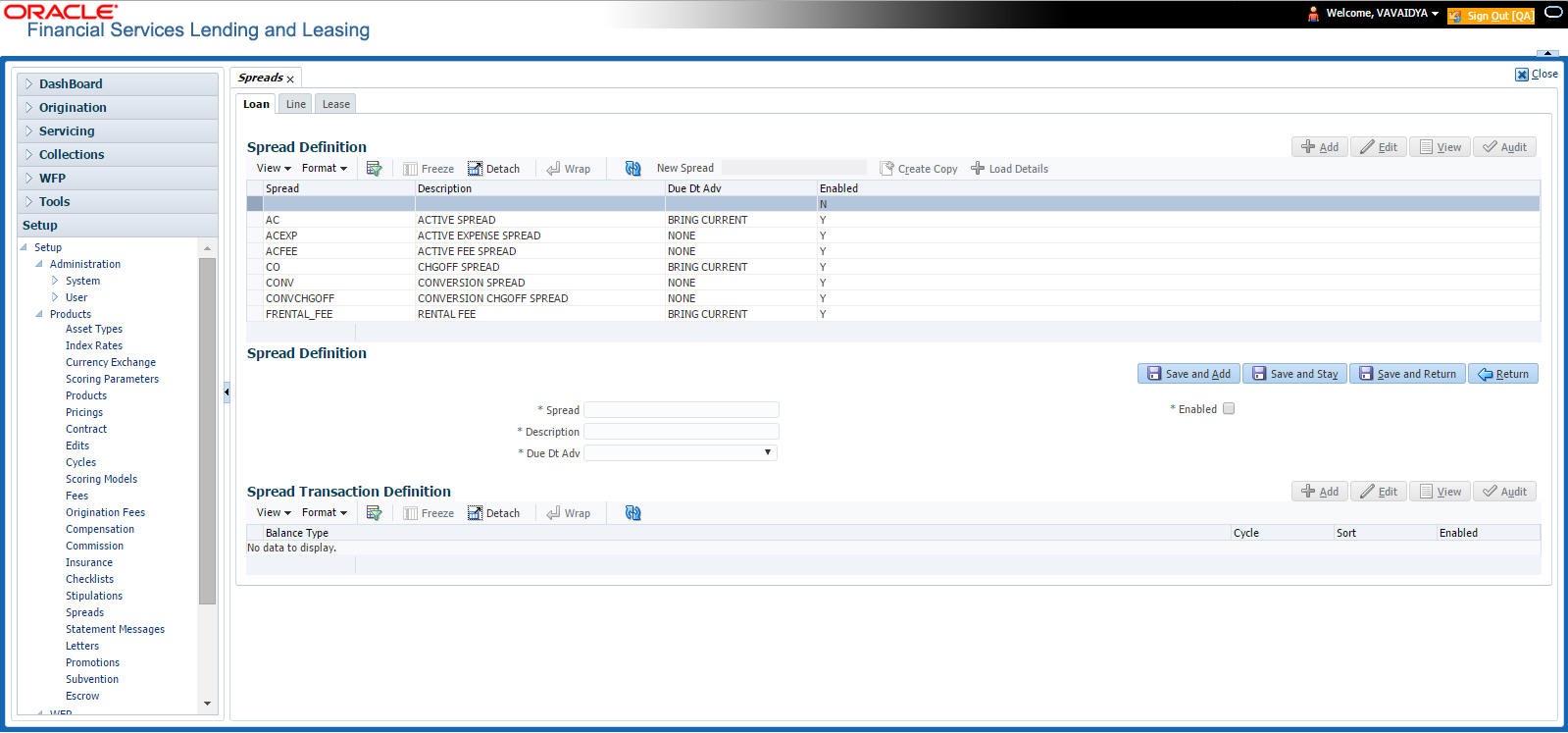

4.11.1 Spread Definition
The Spread Definition section is used to define individual spreads. Many common spreads have already been defined. With each spread, you can define the due date advancement method to use, bring current, future, or None.
The Spreads screen records the order in which balances are satisfied when a payment is applied to an account. (Unless someone indicates otherwise, payments will be applied against each balance type, in sort order, until either there is no remaining balance, or the payment has been completely allocated.)
To set up the Spreads
You can either define new Spread Definition details or specify a new name in the New Spread field and click Create Copy to create a copy of selected spread definition with details.
  1. On the Oracle Financial Services Lending and Leasing home screen, click Setup > Setup > Products > Spreads > Loan > Spread Definition.
In the Spread Definition section, perform any of the Basic Operations mentioned in Navigation chapter.
A brief description of the fields is given below:
Field:
Do this:
Spread
Specify the code identifying the spread.
Description
Specify the description for the spread. (This usually reflects when this spread is used.).
Due Dt Adv
Select the due date advancement code that determines how payments applied using this spread will affect due amounts, from the drop-down list. The system uses the following prede­fined Due Dt Adv Codes:
NONE – Payments applied using this spread will not affect the due amounts of the account in any way
BRING CURRENT – The payment allocations for transac­tions against an account’s outstanding balances that make up the billed balances. This will be applied against billed due amounts
FUTURE – The payment allocations for transactions against an accounts outstanding balances that make up the billed balances. This will be applied against billed due amounts. Any remaining amount allocated against billed balances will be accumulated and applied against future due amounts.
FUTURE WITH PRINCIPAL, INTEREST THEN ESCROW
FUTURE WITH ESCROW, THEN PRINCIPAL AND INTER­EST
Enabled
Check this box to enable the spread.
  1. Perform any of the Basic Actions mentioned in Navigation chapter.
  2. In the Spread Transaction Definition section, perform any of the Basic Operations mentioned in Navigation chapter.
Field:
Do this:
Balance Type
Select the balance type to allocate a portion of the received payment, from the drop-down list.
Note: Oracle Financial Services Software recommends that you always setup an ADVANCE/PRINCIPAL balance type for each spread.
Cycle
Specify the balance cycle during which to apply payments. This collects payment on bad (unpaid) cycles. You can go back by only five cycles. Cycle will have a value of 0 for loans.
Sort
Specify the sort order in which the balance type has payments allocated against it.
Enabled
Check this box for the system to consider this spread transaction when allocating payments.
To Load Details
  1. Create a record in Spread Definition section, with Enabled check box unchecked.
  2. Click Load Details button, the system will load the spread transaction definition details.

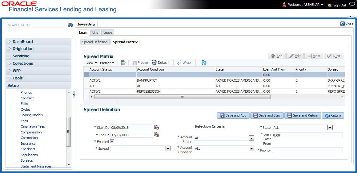

4.11.2 Spread Matrix
The Spread Matrix tab in Spreads screens allows you to define and maintain different combinations of spreads depending on a particular account status, Conditions, Primary Customer State, Amount Financed and Priority.
When there are multiple spreads defined for an account with different conditions, you can set the priority for the system to sequence the same.
The details maintained here are used to default the ‘Spread’ when a particular account is selected in the Payment Entry or Payment Maintenance screen.
To set up the Spread Matrix Details
  1. On the Oracle Financial Services Lending and Leasing home screen, click Setup > Setup > Products > Spreads > Loan > Spread Matrix.
  2. In the Spread Matrix section, perform any of the Basic Operations mentioned in Navigation chapter.
Field:
Do this:
Start Dt
Select the start date for the spread from the adjoining calen­dar.
End Dt
Select the end date for the spread from the adjoining calen­dar.
Enabled
This check box is selected by default indicating that the spread is enabled.
Spread
Select the required product active spread from the drop-down list.
Selection Criteria
Account Sta­tus
Select the account status for the spread from the drop-down list.
Account Condition
Select the account condition for the spread from the drop-down list.
Note: You can define multiple conditions for the same account.
State
Select the state of the primary applicant from the drop-down list.
Loan Amt From
Specify the value of Loan amount from where the system should consider the current spread.
Priority
Specify the priority when there are multiple conditions posted on the same account. System considers the least numbered priority as first in the sequence.
