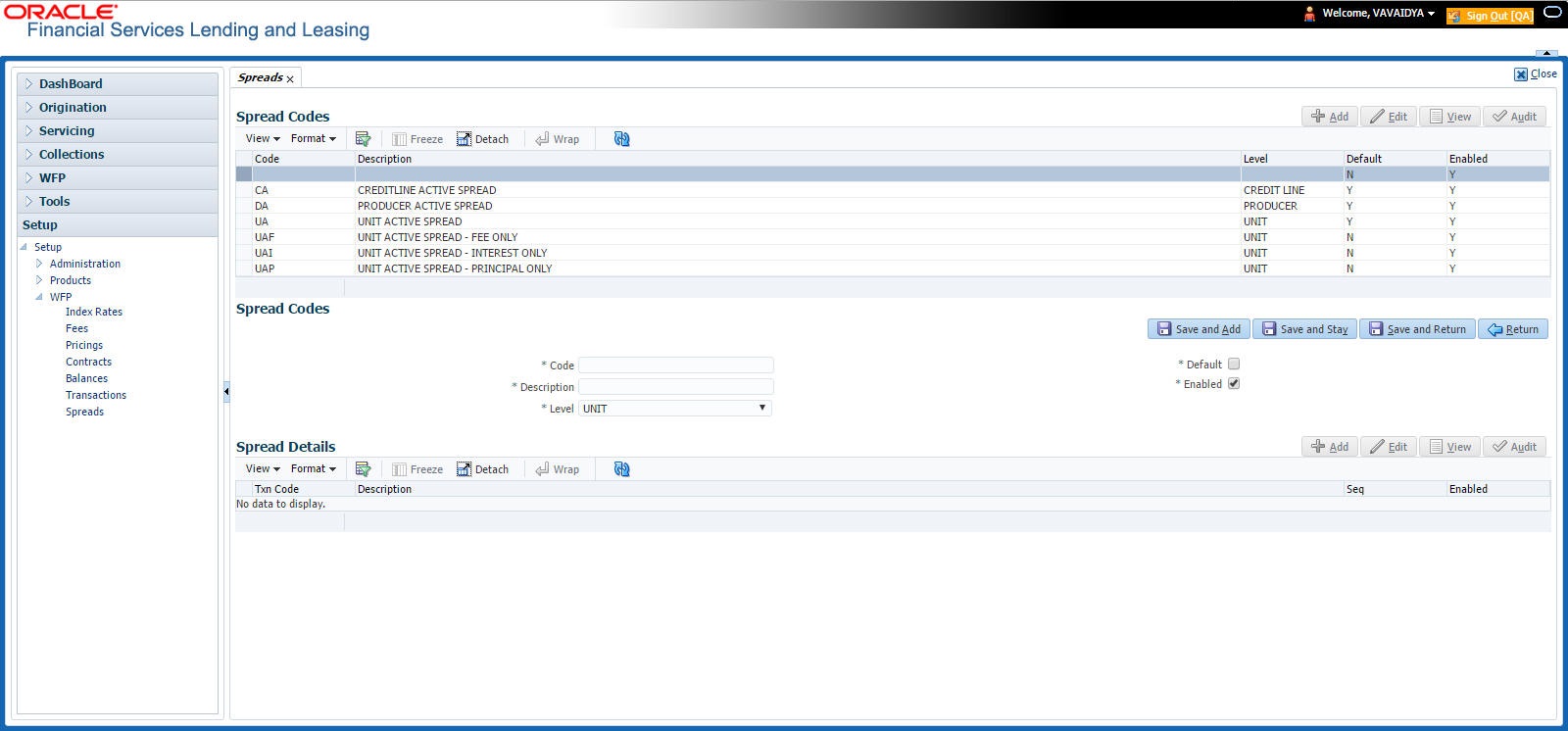

On the Oracle Financial Services Lending and Leasing home screen, click Setup > Setup > WFP > Spreads.
  1. In the Spread Codes section, select the record you want to work with.
  1. In the Spread Codes section, enter, view, or edit the following information:

    Code
    Enter an unique code for the spread (required).
    Description
    Enter a description for the spread code (required).
    Level
    Select the indicator to define the level at which the fee is applicable.
    Note: While making changes on the Spreads screen, make sure that there is one and only one enabled spread code for each level (required).
    Default
    Select to indicate this a default spread code.
    Enabled
    Select to enable this spread code.
The Spread Details section records the details of the transaction codes to which Oracle Financial Services Lending and Leasing applies the spread, as well as the priority for applying the spread over multiple transactions. At least one enabled transaction code should be available for each spread.
  1. In the Spread Details section, select the record you want to work with.
  1. In the Spread Details section, enter, view, or edit the following information:
    In this field:
    Do this:
    Txn Code
    Select the transaction code (required).
    Description
    View the transaction code description as set up on the Setup master tab’s Transaction Code screen (display only).
    Seq
    Enter the sequence in which the spread would be applied to various Txn codes (required).
    Enabled
    Select to enable the this spread detail.
  2. Click Save on the Spread Codes section.
