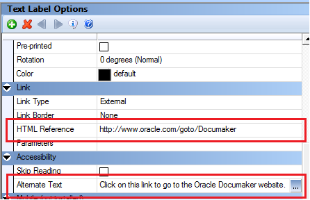

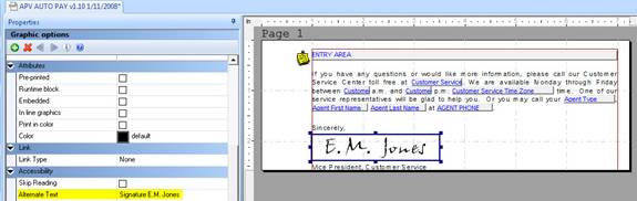

Screen readers may read alternative text, if present, to provide information about non-text content such as graphics. Documaker Studio enables users to specify alternate text on objects such as graphics, charts and hyperlinks.This alternate text is then embedded in the PDF output when the accessibility option is enabled.
To include text equivalent on objects, you may also use the Alternate Text field on the individual object. In Figure 1, alternate text has been supplied for the graphic object.
Figure 1: Option Showing Alternative Text for Images in Documaker Studio.

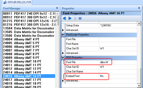

Embedded Fonts
Consider the fonts used to generate the output. Select clear, readable fonts in an appropriate size for readability.
When a font has high readability, embedding fonts ensures that all recipients will be able to display the PDF as intended. Avoid embedding fonts with poor readability.
When embedding fonts, you must have either PostScript Type 1 or TrueType fonts. In addition, you must set the DownloadFonts to Yes as shown below:
< PrtType:PDF >
DownloadFonts = Yes, Enabled
The Font Name field under the PostScript Properties contains the file name of the PostScript or TrueType font you want to embed. This file should exist in the directory specified by the FontLib setting in your master resource library.
Figure 3: Embeded Font.

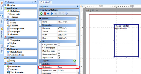

Hyphenation
When hyphenation causes a word to be split across two lines of a paragraph, screen readers split up hyphenated words instead of speaking them properly as single words. Hyphenation can make reading very confusing for screen reader users.
To eliminate potential hyphenation issues, set hyphenation to None.
Figure 4: Using the Hyphenation setting in Text Area Options for a text area object in the Section Manager in Documaker Studio.
Tip:
You can set hyphenation to 'None' at the text area and Multiline Text field level.

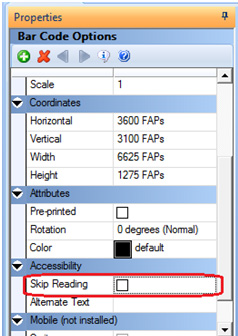

Skip Reading
The Skip Reading attribute indicates whether the object should be included or excluded from being read by assistive technology. This setting could also be used on items that only need to be read once such as page numbers, headers and footers which are repeated on each page of a document. Enabling Skip Reading allows the assistive technology to by-pass the content within the PDF document.
Figure 5: The Skip Reading Option in Documaker Studio.
Applying this attribute on content will cause the Skip Reading element to be enabled in the mobile output when using the default snippets or the keyword “documaker.skipread” within your implementation specific snippet files.

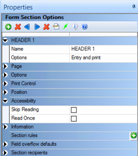

Studio Forms Manager: Read Once, Skip Reading
The Skip Reading attribute indicates whether the section should be included or excluded from being read by assistive technology.
The Read Once attribute indicates whether all of the objects in the section marked Read Once are excluded from being read by Assistive Technology whenever the section is copied on overflow to a subsequent page. The section is read by assistive technology on the initial page (i.e. Read Once). The section is excluded from being read on subsequent pages. This can be useful for header or footer sections that you wish to be read on the first page but would be considered repetitive when they are copied to subsequent pages (Copy on Overflow).
Figure 6: The Form Section Options in Documaker Studio.
The Read Once option displays when copy on overflow is enabled:
Figure 7: The Form Section Options (enabling Read Once option) in Documaker Studio.

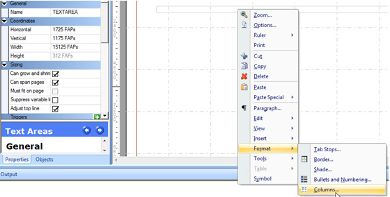

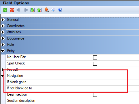

Tab Order
Maintain a logical tab order for visually impaired users as they cannot see the field groupings. For instance, field tab order should generally be from left to right and top to bottom.
Use the column feature included in Oracle Documaker Studio. Columns are defined in text area where you can add more columns, rather than adding text labels or areas arranged in columnar format. Columns can also be defined in a multi-line text field or a text area marked for interactive editing in data entry. This allows the assistive technology to recognize the columns and mark the proper reading order.
Use a table rather than text labels or areas. Assistive technology typically traverse any table from left to right and from top to bottom in an accessible PDF file.
Figure 8: Using the column feature in Documaker Studio.
Figure 9: Using Tab Order via Navigation settings for Fields  in Documaker Studio.
