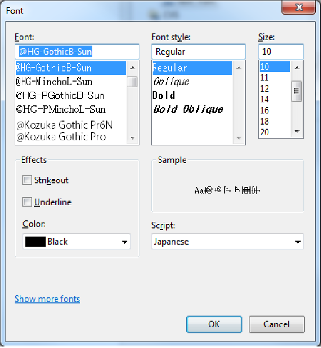

    1. Open IBM Data Studio and set font in editor for properly displaying Japanese (HG-GothicB-Sun)
      Image represents font style dialog.
      Figure 2.3.1 - Font Style Dialog

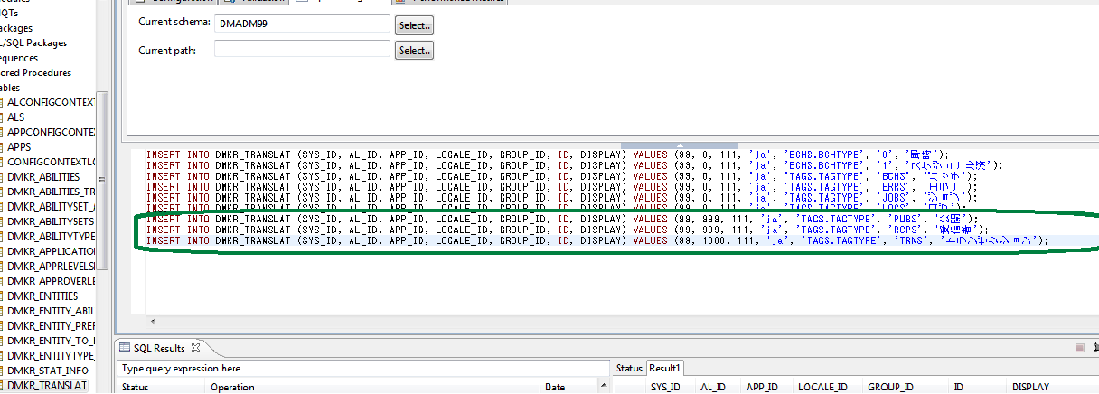

      From IBM Data Studio:
      Image represents IBM data studio screen.
      Figure 2.3.2 - IBM Data Studio
    4. Process the DML statements, inserts, to the correct dmkr_admin schema.
    5. Validate that the content appear correctly in table by selecting the rows for review.
    6. Repeat with the dmkr_asline_xx.sql targeting the dmrk_asline schema for inserts.

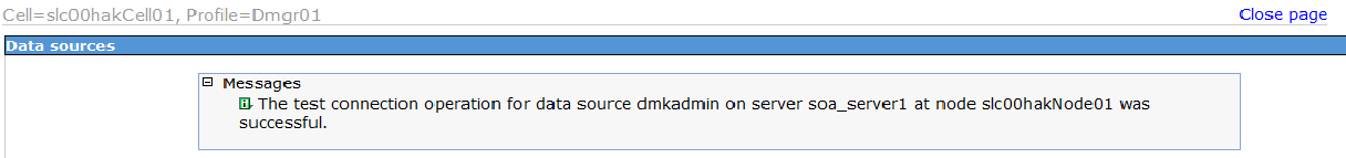

    Note: Test your connection to the ODBC database to ensure correct configuration by running the c:\windows\syswow64\odbcad32.exe program and then following the prompts.Make sure connection is successful.

    5. View the Configure JDBC Data Sources options (do not change these values), then click Next.
      The connection to the database is tested. When the test finishes, view the results, then click Next.
    6. Copy the sqljdbc4.jar file under wl_server\server\lib, idocumaker_domain\lib if JDBC Component Schema fails to make connection. This is applicable only for MS SQL Server.
    7. Update the Configure JDBC Component Schema window. This will configure the connections your SOA repository. Click Next.
    8. The connection to the database is tested. When the test finishes, view the results, then click Next.
      Image represents data sources dialog message.
      Figure 2.3.3 - Data Sources Dialog Message
