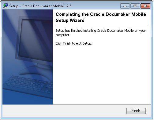

  4. Click Finish to complete the installation.
    Image represents completing the setup wizard.
    Figure 1.1.2 - Finishing wizard
