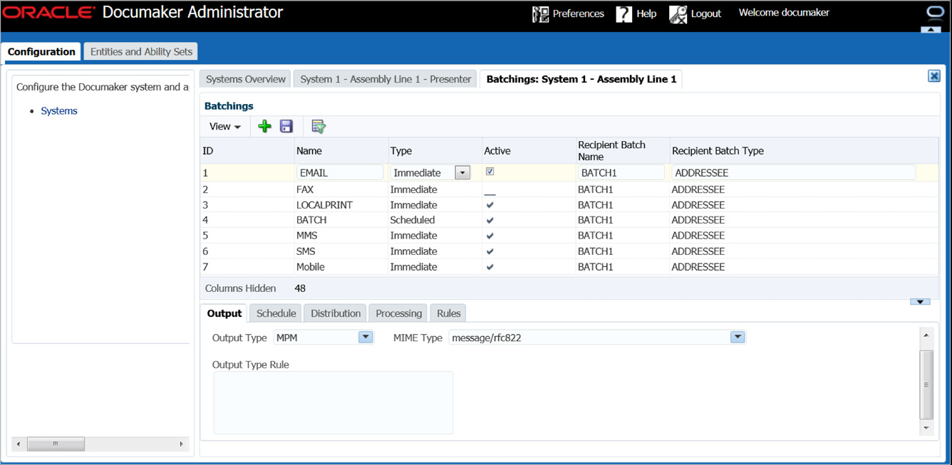

  1. Login to Documaker Administrator and enable the Mobile Batchings. To know more about the Mobile Batchings see the ‘Understand Batches’ section in ODEE Admin Guide.
    Image represents enabling mobile batchings in ODEE.
    Figure 4.4.1 - Enabling mobile batching in ODEE
  2. In Mobile Batchings, activate the Archive Distribution and activate the Notifications property.
