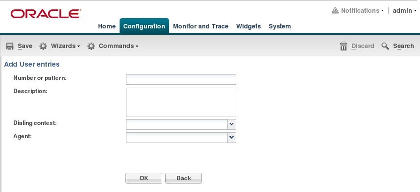

The following illustration shows a typical configuration page and the controls that the system provides.
The following table explains the functionality of each control displayed on a configuration page.
| Control | Effect |
| Notifications | Displays alerts about the state of the configuration, for example when you need to save changes or activate the configuration. |
| Admin | Displays links to screen help, help topics, about the Oracle Enterprise Communications Broker, and logout. |
| Save | Initiates Save and Activate process on your system. This process includes a configuration verification. The system displays any configuration errors list in a panel at the bottom of the page. |
| Wizards | Displays a menu of wizards for configuring global settings. The menu includes setting boot parameters, entitlements, initial configuration, license, login banner, time zone, and upgrade software. |
| Commands | Displays a list of commands to show the state of the configuration. The menu includes links to the editing configuration, the running configuration, and the configuration version. |
| Discard | Discards all changes to all dialogs made prior to performing Save and Activate. The control becomes active when you click OK to accept configuration changes in a dialog. |
| Search | Displays the Search dialog where you can search the configuration by object name, attribute, or value. |
| OK | Accepts all changes made in the dialog, transfers the changes to the system, and returns to the previous screen. |
| Back | Returns the previous page. If you have made changes to any fields in the dialog, the GUI displays a confirmation dialog where you can save or discard changes to the current dialog. |

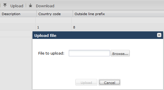

Uploading and Downloading Key Files
The Oracle Enterprise Communications Broker allows you to upload and download files containing key elements of your configuration that are more easily managed separately from the overall system configuration. Such information includes:
- Dial Plans
- Dial Patterns
- User Database Entries
- Route Database Entries
- Header Manipulation Rules
You upload and download the files described here separately from the files managed from the System tab.The configuration dialogs for the preceding list include controls from which you invoke uploads and downloads.
When you click the Upload button the system displays the Upload file dialog, which includes a Browse button. When you click Browse, the system opens a browse dialog, from which you can select the file perform the upload. Download behavior is similar. The system performs the file transfers to the correct system directories in the correct format without requiring any intervention.

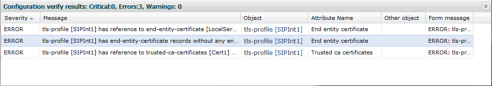

The GUI also checks your configuration for errors every time you click the Save button, the system displays the following dialog if any errors occur.
The system displays any configuration errors in a list at the bottom of the GUI. You can navigate to each object in the list by clicking the item in the Object column. The following screen capture shows an example of the errors list.
