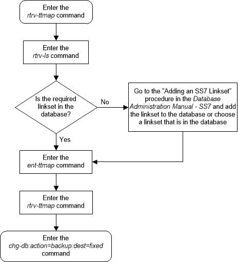

This procedure is used to add a mapped SS7 message
translation type to the database. The mapped translation type is added to the
database using the
ent-ttmap command and is assigned to an
ANSI SS7 linkset.
The
ent-ttmap command uses these
parameters.
:lsn – the name of the
linkset.
:io – is translation type
mapping to be performed on SS7 messages received in the linkset (incoming
linkset) or on SS7 messages sent on the linkset (outgoing linkset).
:ett – the translation
type contained in the SS7 message before that translation type is mapped.
:mtt – the translation
type that the value of the
ett parameter is mapped to.
The examples in this procedure are used to map the SS7
message translation type
250 to the translation type
001 for any incoming messages on
linkset
lsn01.

Figure 2-41 Add a Mapped SS7 Message Translation Type
