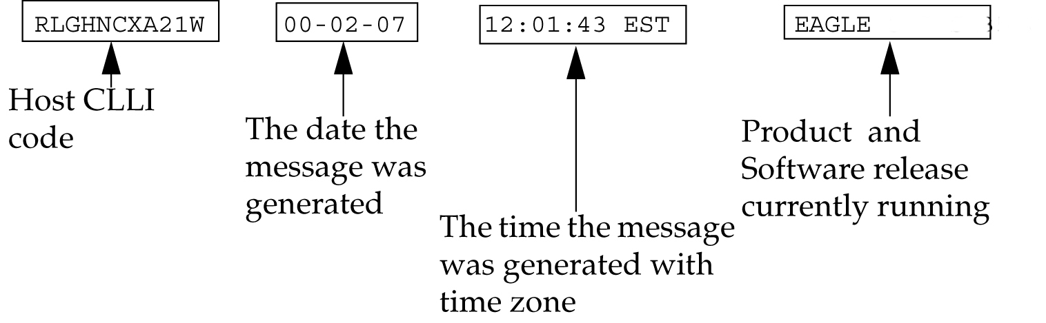

The system header information is shown in the example outputs and includes the following information:
Figure 3-1 System Header Information
img/c_uam_and_uim_troubleshooting_procedures_maintmanual-fig1.jpg
Legend
ASSY SN
Assembly Serial Number
SLC
Signaling Link Code
FECLLI
Far End CLLI - the CLLI designation, i.e., name, of the machine interacting with this machine.
ILSN
Incoming Linkset Name
