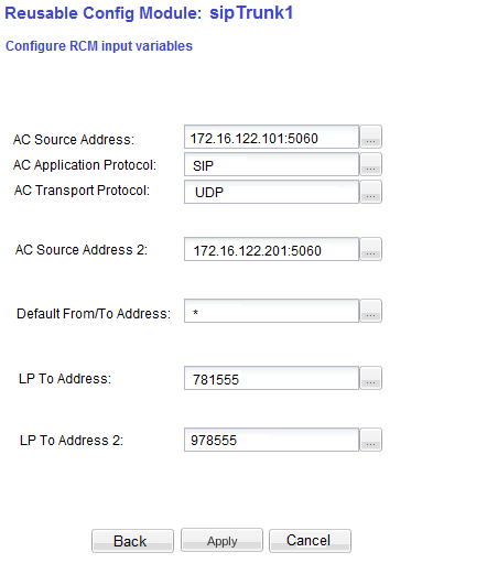

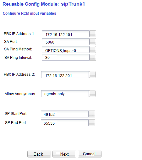

Reusable Configuration Module Input Wizard Configuration: Example
The following example shows how input values are entered in the RCM Input wizard screen for an SIP Trunk service RCM.
