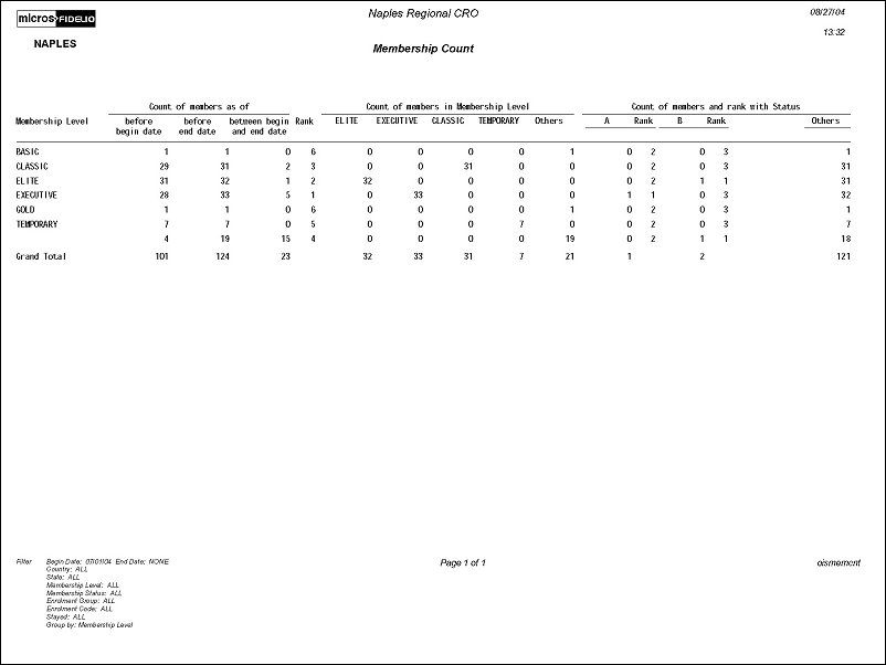

Membership Count (oismemcnt with ORSMEM1.FMX)
The Membership Count report displays the number of members having Primary Memberships who joined, or were already members, within a date range. You can also view members who stayed within a date range. This report can be used to determine how many members have joined and taken advantage of their membership.
There are several sections in the report containing the Count of Members as of�.

Country. The report will be grouped according to the country you selected on the Country drop down list.
Enrollment Code. The report will be grouped according to the enrollment code you selected on the Enrollment code drop down list.
Membership Level. The report will be grouped according to the Membership Level you selected on the Membership Level drop down list.
