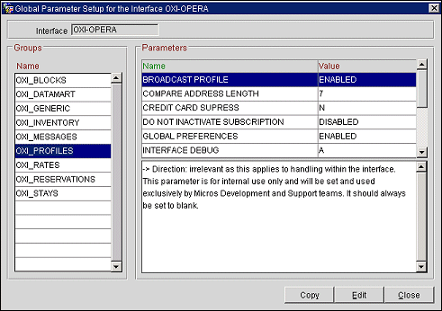

OXI_PROFILE Parameters in OXI_HUB
In OXI_HUB > Interface Configuration > Interface Parameters > OXI_PROFILE.
Important! For non-MICROS interfaces, profiles will only come as part of a reservation message. Prior to this change, when a reservation message was processed, the profile data in the message was processed using OXI related profile code, not an OXIHUB profile related code. With this change, the profile data in a reservation message will be processed using only an OXIHUB profile code.
OXI_PROFILE. Parameters are an integral part of the ORS Match & Merge functionality. They provide the conditions for initial matches that need to be passed by all incoming profiles before the interface rules and merge rules are validated. The interface checks for a primary match based on a few hard-coded and otherwise definable columns in the profile name table and its child tables. These entry criteria are the base for the following weighing point-based merge rules. If the entry criteria match fails, no further weighing point match & merge is attempted and the profile is either created newly or rejected entirely.
Note: All parameters are set at the global level.
Broadcast Profile. Values are Enabled or Disabled. When Enabled, a profile sent from a property is broadcasted to all subscribed properties including the property that has originally sent the profile to ORS. Depending on the interface rules, the information incoming from the property might not be the same as the information that is sent back to this property when the profile is broadcasted. If e.g., the interface rule for Addresses is set to N and the incoming address is different from the address in ORS, the broadcasted profile will have the ORS address, thus overwriting the address that was sent by the property. When set to Disabled, the profile will not be broadcasted to any property.
Compare Address Length. Number of contiguous characters that need to match in an address: If the first address line and the city are the same between profiles, and if this number of contiguous characters match, then the existing address will be overwritten instead of inserted newly.
Do Not Inactivate Subscription. Valid values are Enabled and Disabled. The recommended setting is the default which is Disabled. However this can be enabled if a client wants to maintain ONE Corporate Profile Centrally linked to multiple ones at the PMS. The same address, phone info must be maintained on all accounts at PMS however with different contact and/or AR number information as these values can be set to never transfer the interface via the interface rules.
Global Preferences. Valid values are Enabled and Disabled. Enabled means all preferences sent by the external system, which are designated as global in ORS, will not be inserted, updated, or deleted in ORS for profiles with a primary membership attached. Disabled means that all preferences sent by the external system will be inserted and updated, but not deleted for all profiles. Default setting is Disabled.
Interface Debug. This parameter is for internal use only and will be set and used exclusively by Oracle Support teams. It should always be set to blank.

Example: OXI_PROFILES for Global setup.
Parameter Name
Parameter Values
Direction of transmission where parameter applies. Parameter Description
Recommended Setting
BROADCAST PROFILE
ENABLED/ DISABLED
-> Direction: Data from external system to OPERA.
Values are ENABLED or DISABLED. When ENABLED, a profile sent from a property is broadcasted to all subscribed properties including the property that has originally sent the profile to ORS. Depending on the interface rules, the information incoming from the property might not be the same as the information that is sent back to this property when the profile is broadcasted. If e.g., the interface rule for ADDRESSES is set to 'N' and the incoming address is different from the address in ORS, the broadcasted profile will have the ORS address, thus overwriting the address that was sent by the property. When set to DISABLED, the profile will not be broadcasted to any property.
Set to ENABLED
