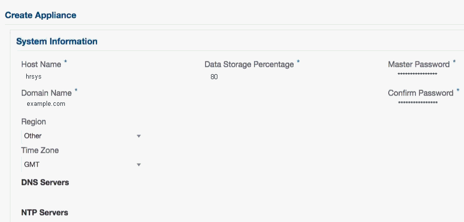

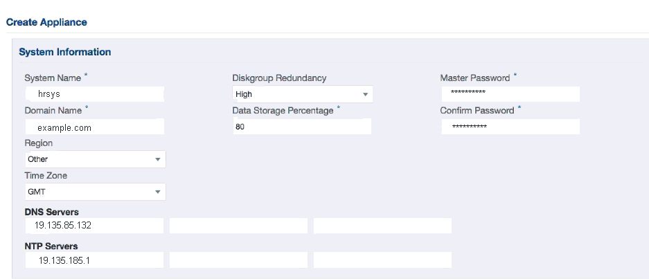

  3. Enter the following information to configure the system information:
    1. Host Name: Enter the host name.
      The host name can contain alphanumeric characters and dashes (-), but cannot start with a number or dash (-) or end with dash (-). Do not exceed 30 characters.
    2. Domain Name: Enter the domain name.
      For example, example.com.
    3. (Optional) Region: Select the region of the world where the Oracle Database Appliance is located.
    4. (Optional) Time Zone: Select the time zone where the Oracle Database Appliance is located.
    5. Data Storage Percentage: Enter a whole number between 10 and 90 to define the percentage of storage reserved for DATA, the remainder is reserved for RECO. For example, if you enter 80, then 80% of the storage is for DATA and 20% is for RECO.
    6. Diskgroup Redundancy: This field appears when the Web Console detects that the system has at least five (5) NVMe storage devices. Select Normal or High.
      If the system has less than five (5) NVMe storage devices, redundancy is automatically set to Normal and this field does not appear.
    7. Master Password and Confirm Password: Enter the master password in both fields.
      The master password is the password set for UNIX users, root, SYS, SYSTEM, and PDBADMIN. The password must begin with an alpha character and cannot contain quotation marks. Do not exceed 30 characters.
    8. (Optional) DNS Servers: Enter addresses for one or more DNS servers.
    9. (Optional) NTP Servers: Enter addresses for one or more NTP servers.

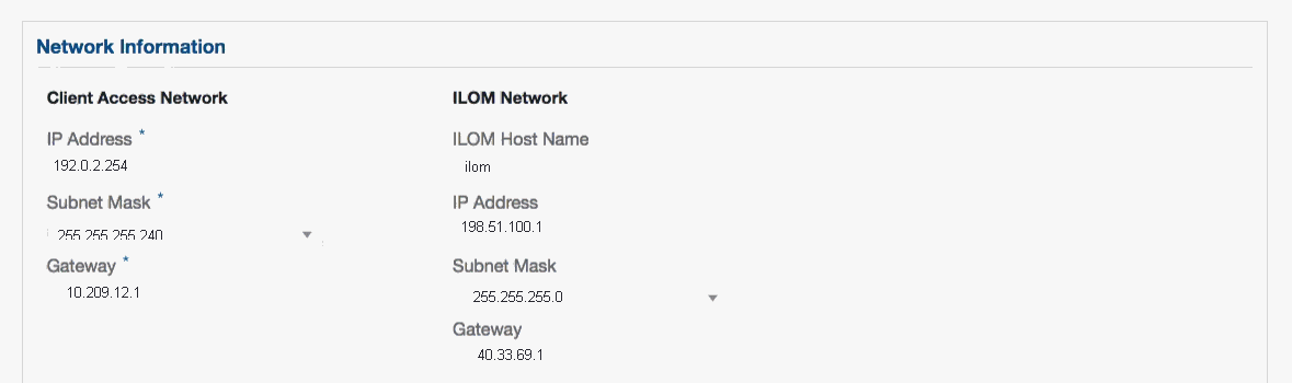

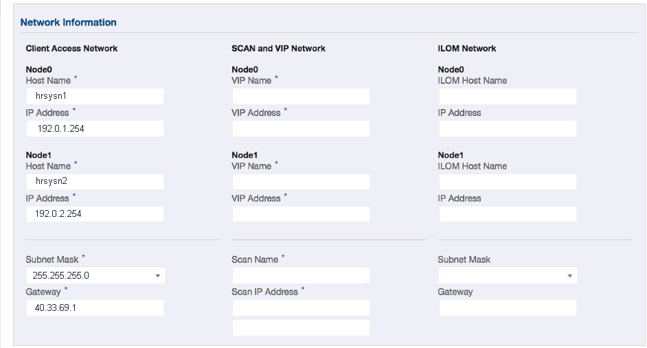

  4. Enter the following information to configure the network information:
    The Network Information page enables you to configure the primary client access network and an Oracle Integrated Lights Out Manager (ILOM) network. You are only required to configure the client access network. The ILOM configuration is optional if you already configured the ILOM for the appliance and you do not need to make changes.
    1. Client Access Network IP Address: Enter the IP address for the primary client access network.
    2. Client Access Network Subnet Mask: Enter the subnet mask address for the primary client access network.
    3. Client Access Network Gateway: Enter the gateway address for the primary client access network.
    4. (Optional) ILOM Host Name: Enter the name of the Oracle ILOM host.
    5. (Optional) ILOM Network IP Address: Enter the IP address for the ILOM.
    6. (Optional) ILOM Network Subnet Mask: Enter the subnet mask address for the ILOM.
    7. (Optional) ILOM Network Gateway: Enter the gateway address for the ILOM.

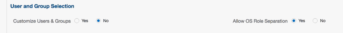

  5. Determine how you want to configure your users and groups and whether or not you want to allow operating system role separation:
    • Two users with six groups: Customize Users and Groups, select No. Allow OS Role Separation, select Yes. This is the default configuration.
    • Two customized users with six customized groups: Customize Users and Groups, select Yes. Allow OS Role Separation, select Yes.
    • Single user with two groups: Customize Users and Groups, select No. Allow OS Role Separation, select No
    • Single user with six groups: Customize Users and Groups, select Yes. Allow OS Role Separation, select No. SAP deployments use this configuration.

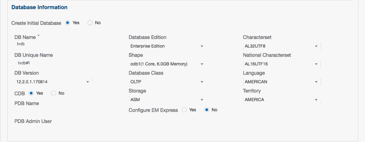

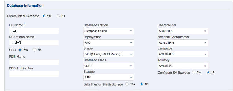

  6. Do you want to create an initial database? Select Yes and go to Step 8 or select No and go to Step 9.
  7. Enter the following information to configure the database:
    1. DB Name: Enter a name for the database.
      The name must contain alphanumeric characters and cannot exceed 8 characters. Enter a name, do not use the default database name db1.
    2. (Optional) DB Unique Name: Enter a globally unique name for the database.
      Databases with the same DB Name within the same domain (for example, copies of a database created for reporting or a physical standby) must have a different DB Unique Name that is unique within the enterprise. The name can contain alphanumeric, underscore (_), dollar ($), and pound (#) characters, but must begin with an alphabetic character. No other special characters are permitted in a database name. The unique name cannot exceed 30 characters.
    3. DB Version: Select a database bundle patch number.
    4. CDB: Select Yes or No to specify whether or not you want a Container Database (CDB). This field is only visible for Oracle Database 12.2.x.
    5. (Optional) PDB Name: Enter a name for the pluggable database (PDB).
      The name must begin with an alphanumeric character. The following characters are valid: alphanumeric characters, and underscore (_).
    6. (Optional) PDB Admin User: Enter an Admin user name for the pluggable database (PDB).
    7. Database Edition: Select the Oracle Database edition, either Standard Edition and Enterprise Edition. Your license determines which database edition you are eligible to create in the appliance.
    8. (Optional) Shape: Select a database shape from the list.
    9. (Optional) Database Class: Select a database class from the list.
      The database version and edition determine the classes that are available. The Enterprise Edition supports OLTP, DSS, or IMDB, the Standard Edition only supports OLTP.
    10. (Optional) Storage: Select ACFS or ASM.
      The default is ASM.
    11. (Optional) Configure EM Express: Select Yes to configure the Oracle Enterprise Manager Database Express (EM Express) console.
    12. (Optional) Characterset: Select a characterset.
    13. (Optional) National Characterset: Select a national characterset.
    14. (Optional) Language: Select the database language.

  4. Enter the following system information to configure the system:
    3. Region: Select the region of the world where the Oracle Database Appliance is located.
    4. Time Zone: Select the time zone where the Oracle Database Appliance is located.
    5. (Optional) DNS Servers: Enter addresses for one or more DNS servers.
    6. (Optional) NTP Servers: Enter addresses for one or more NTP servers.
    7. Diskgroup Redundancy: This field appears when the Web Console detects that the system has at least five (5) NVMe storage devices. Select Normal or High.
      The redundancy level is for DATA, RECO, and FLASH. If you select High redundancy, then DATA, RECO, and FLASH are all High redundancy.
    8. Data Storage Percentage: Enter a whole number between 10 and 90 to define the percentage of storage reserved for DATA, the remainder is reserved for RECO. For example, if you enter 80, then 80% of the storage for DATA and 20% for RECO.
    9. Master Password and Confirm Password: Enter the master password in both fields.
  5. Enter the following information to configure the network:
    This page enables you to configure the primary client access network, virtual networks, and an Oracle Integrated Lights Out Manager (ILOM) network. You are only required to configure the client access network. The ILOM configuration is optional if you already configured the ILOM for the appliance and you do not need to make changes.
    1. Client Access Network Host Name: For Node0, enter the host name for the primary client access network.
    2. Client Access Network IP Address: For Node0, enter the IP address for the primary client access network.
    3. Client Access Network Subnet Mask: Enter the subnet mask address for the primary client access network.
    4. Client Access Network Gateway: Enter the gateway address for the primary client access network.
    5. Client Access Network Interface: Enter the interface for the primary client access network.
    6. VIP Name for Node0: Enter the name of the virtual IP network for Node0.
    7. VIP IP Address for Node0: Enter the virtual IP address that resides on Node0 and is shared between the nodes.
    8. VIP Name for Node1: Enter the name of the virtual IP network for Node0.
    9. VIP IP Address for Node1: Enter the virtual IP address that resides on Node1 and is shared between the nodes.
    10. (Optional) ILOM Host Name: Enter the name of the Oracle ILOM host.
    11. (Optional) ILOM Network IP Address: Enter the IP address for the ILOM.
    12. (Optional) ILOM Network Subnet Mask: Enter the subnet mask address for the ILOM.
    13. (Optional) ILOM Network Gateway: Enter the gateway address for the ILOM.
  6. Determine how you want to configure your users and groups and whether or not you want to allow operating system role separation:
  7. Do you want to create an initial database? Select Yes and go to Step 8 or select No and go to Step 9.
  8. Enter the following information to configure an initial database:
      Databases with the same DB Name within the same domain (for example, copies of a database created for reporting or a physical standby) must have a different DB Unique Name that is unique within the enterprise. The name must contain alphanumeric, underscore (_), dollar ($), and pound (#) characters, but must begin with an alphabetic character. No other special characters are permitted in a database name. The unique name cannot exceed 30 characters.
    5. PDB Name: Enter a name for the pluggable database (PDB).
    6. PDB Admin User: Enter an Admin user name for the pluggable database (PDB).
    8. Deployment: Select a deployment type from the list. The options are RAC, RAC-One, or SI (single instance database). If you select a single instance database, then select the node for the SI database deployment.
      If you select a single instance database, then you have the option to create the database on either Node0 or Node1. The default is Node0.
    9. Shape: Select a database shape from the list.
    10. Database Class: Select a database class from the list. The options are OLTP, DSS, or IMDB.
    11. Storage: Select ACFS or ASM.
      ASM is the default.
    12. Date Files on Flash Storage: Select Yes or No.
      This option is only available if the HA system has HDD storage drives.
    13. Configure EM Express: Select Yes to configure the Oracle Enterprise Manager Database Express (EM Express) console.
    14. Characterset: Select a characterset.
    15. National Characterset: Select a national characterset.
    16. Language: Select the database language.
    17. Territory: Select a territory or location from the list.

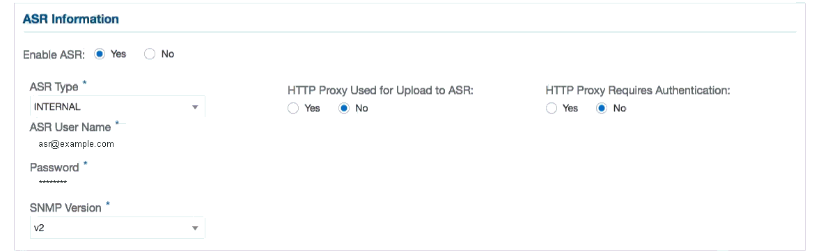

  9. (Optional) Configure and enable Oracle ASR on the ASR page.
    You can configure and enable Oracle Auto Service Request (Oracle ASR) now or later:
    • To not enable Oracle ASR during deployment, select No and click Submit. After deployment, you can configure an internal Oracle ASR or register with an external Oracle ASR Manager from either the Web Console or command-line interface.
      • Internal Oracle ASR: choose to configure Oracle ASR Manager on Oracle Database Appliance or use Oracle ASR Manager configured on another server in the same network as your appliance.
      • External Oracle ASR: If you already have Oracle ASR Manager configured elsewhere, you can register Oracle Database Appliance with your existing Oracle ASR Manager.
    • To enable Oracle ASR, select Yes and complete the fields:
    1. ASR User Name: Enter the e-mail address associated with the My Oracle Support account under which the server is registered.
    2. Password: Enter the password associated with the My Oracle Support account under which the server is registered.
    3. SNMP Version: Select V2 or V3. V2 is the default and recommended version.
    4. HTTP Proxy used for Upload to ASR: Select Yes or No.
    5. Proxy User Name: If you are using a proxy for upload, enter the proxy user name.
    6. Proxy Port: If you are using a proxy for upload, enter the proxy port.
    7. (Optional) HTTP Proxy Requires Authentication: If you are using a proxy for upload, select Yes if you require authentication. If you do not require authentication, select No.
    8. (Optional) Proxy Password: If you are using a proxy for upload and require authentication, enter the proxy password.
  10. Click Submit. When prompted, click Yes to confirm that you want to start the job to deploy the appliance.
The job to create the appliance takes time to complete. To monitor the job progress, click the Activity tab . Click the job number to view the tasks.
After deployment, the root and database users SYS, SYSTEM, and PDBADMIN are set to the master password. The oracle and grid passwords are set to the default password. Change these passwords to comply with your user security protocols.
