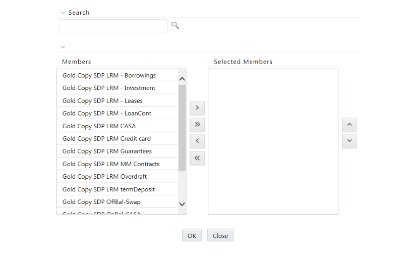

To select the process for the Contractual Cash Flow Process, follow these steps.
1. In the Application Preferences window, under Contractual
Cash Flow Process Selection, click
to
select the process. The browser is displayed.
Figure 6 Contractual Cash Flow Process Selection
2. Select one or multiple contractual cash flow processes, the outputs of which will be used by LRS.
3. Click
to
move the selected items to Selected Members
section or click
to
select all members.
4. Using
up
or down arrows, you can sequence the contractual cash flow processes.
5. Click OK. The process IDs are stored in appropriate tables. The application selects all the cash flows associated with the ALM cash flow engine’s process IDs. It then picks up these ID. After it is stored, it picks up the relevant cash flows against the process IDs.

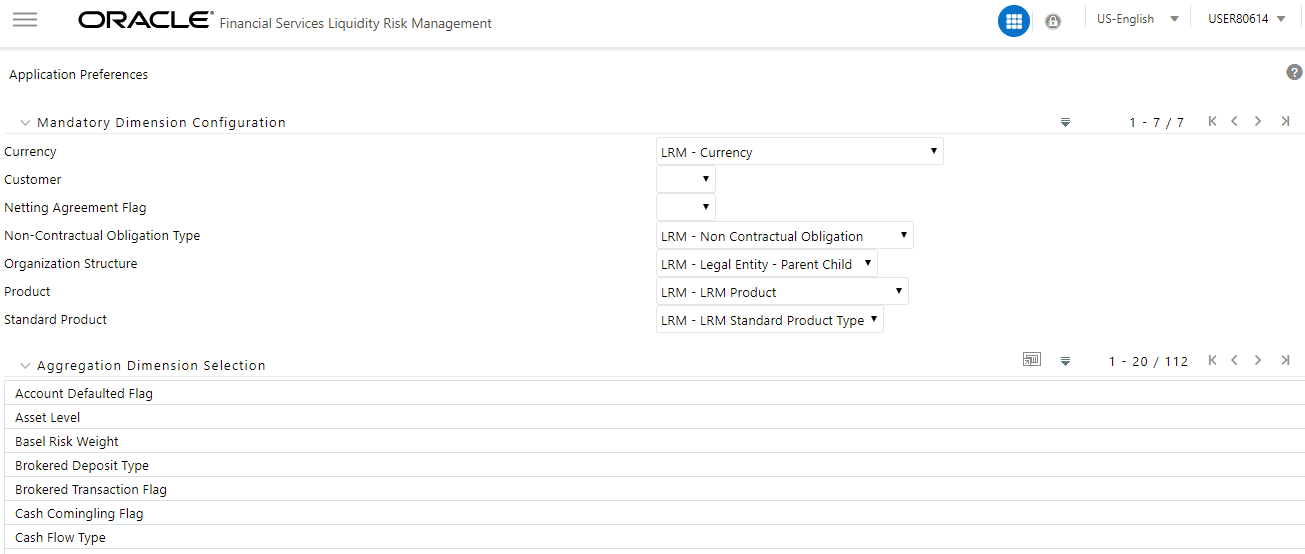

The application requires some dimensions to be selected mandatorily for downstream calculations. These include currency, organization structure, and standard product. The parameters selected as part of this field are displayed in the BAU window under the Dimension browser.
The Mandatory Dimension Configuration section has the following fields:
Figure 7 Mandatory Dimension Configuration
· Currency
For Currency, only one hierarchy is present. LRM - Currency is automatically selected in the Currency field.
· Customer
To identify the intercompany cash flows, customer dimension is mandatory. However, there is no hierarchy selection required.
· Organization Structure
For Organization Structure, there are multiple selections available. Select from the available options:
§ LRM - Legal Entity: This is a BI Hierarchy where all the legal entities appear in a single level.
§ LRM - Legal Entity - Parent Child: This is a parent-child hierarchy where the legal entities are displayed in ascending/descending order of their parentage. The root being Business Holding Unit (BHU).
§ LRM - Org Structure Country Flag: This is a Non-BI Hierarchy used in 4G reporting line reclassification. Ignore this hierarchy in this selection.
For example, if the LRM - Legal Entity is selected for Organization Structure, in the Application Preferences,
the selected Organization Structure (LRM - Legal Entity) along with the aggregation dimension members appear under the Dimension Selection section in the BAU window.
Figure 8 Dimension Selection
· Netting Agreement Flag
This dimension identifies whether the derivative contract is part of the netting agreement. Based on this flag, the net derivative cash inflow or outflows are determined. Hierarchy selection is not required for this dimension.
· Non-Contractual Obligation Type
This dimension identifies the non-contractual obligations part of the LRM Instrument table.
· Product
For Product, there following two hierarchies are present as ready-to-use:
§ LRM - Product: This is a single level hierarchy that lists all the products at the lowest level. This is the default selection.
§ LRM - Product Balance Sheet Category: This is a five-level hierarchy describing the higher levels of the products.
· Standard Product
For Standard Product, only one hierarchy is present. LRM - Standard Product Type is automatically selected in the Standard Product field.
The mandatory dimensions selected as part of this section appear in the dimension browser to support liquidity risk calculations.

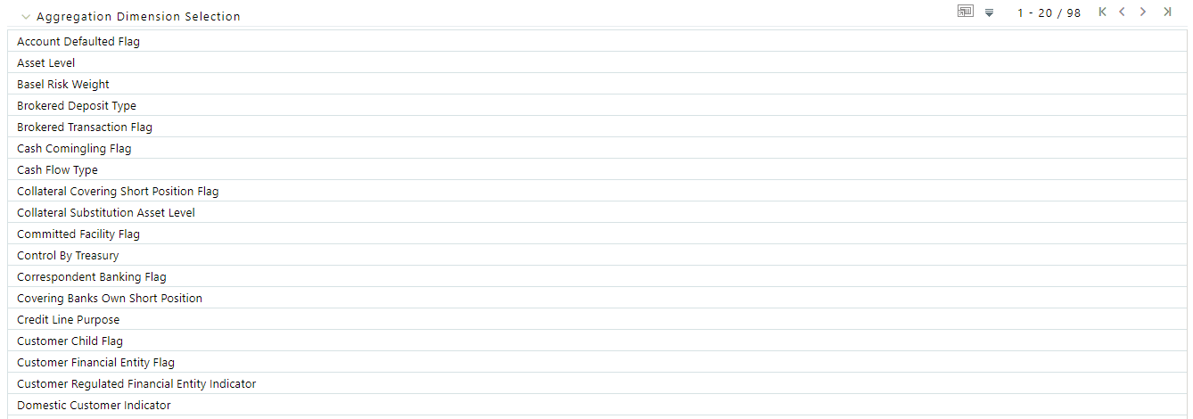

The aggregation dimension selection is done to aggregate the cash flows for business assumption application. All cash flows are aggregated based on Aggregation Dimension Selection. For example, if you require cash flows to be aggregated at a very high level, you can select a lesser number of dimensions. If you require cash flows to be aggregated at a very granular level, then all dimensions are selected. Further, the business assumption works on the dimensions selected and is restricted to the dimensions selected in this particular selection.
The application preferences made in this field are displayed in the BAU window under the Dimension browser. You are allowed to select the required dimension. For a detailed list of dimensions refer to Annexure: Functional Details, LRS Data Flow and Dimensions.
Figure 9 Aggregation Dimension Selection

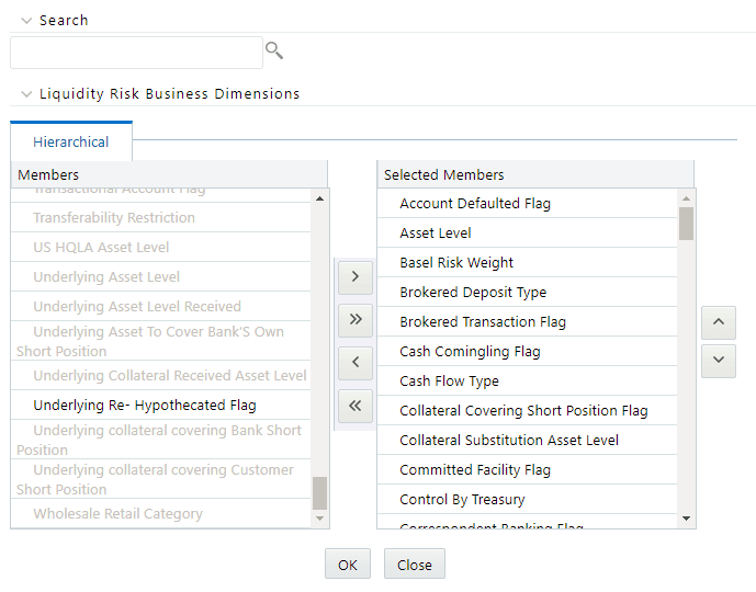

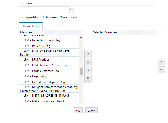

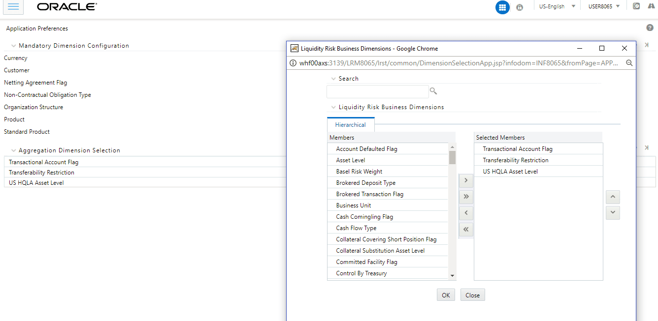

To select the required dimensions, follow these steps:
Preferences window, under Aggregation Dimension
Selection, click
to select the members.
Figure 10: Application Preferences - Hierarchy Browser
2. Select the required members.
3. Click
to move the selected items to Selected
Members section or click
to
select all members.
4. Using
up
or down arrows, you can sequence the dimensions.
5. Click OK to complete the selection.
6. To save the selection, click Save and use it for liquidity risk calculations.
Only the selected dimensions appear under the Dimension browser in the BAU window.

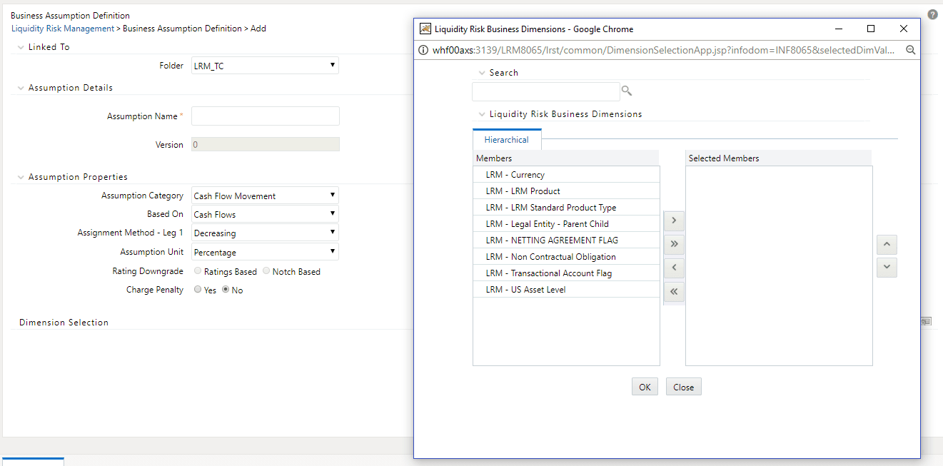

For example, in the following window, only three members are selected in the application preferences dimension browser.
Figure 11: Application Preferences Dimension Browser
Only the selected aggregation dimensions and the mandatory dimensions appear under the Dimension Selection section in the Business Assumption window as shown in the following figure:
Figure 12: Selected Aggregation Dimensions and Mandatory Dimensions Appear Under The Dimension Selection
