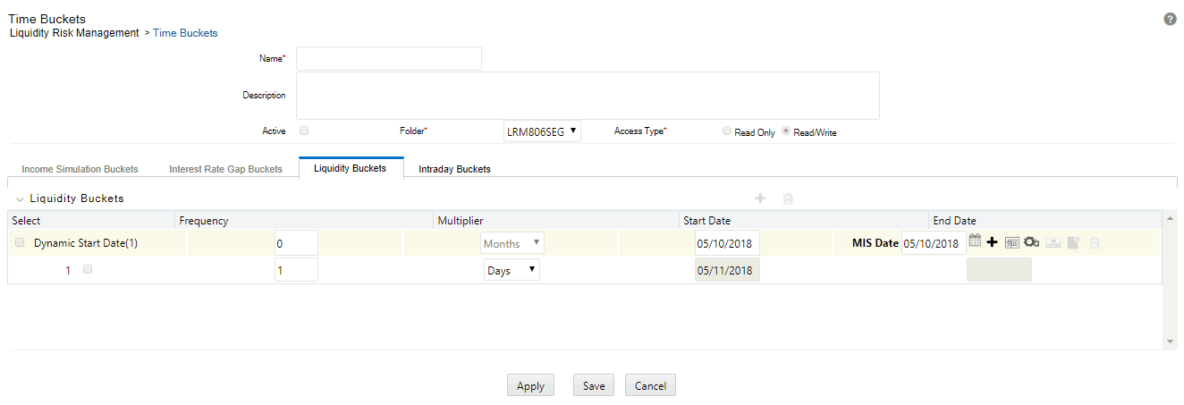

Defining a New Time Bucket
1.     In the Oracle Financial Services Analytical Applications Infrastructure home screen, select Financial Services Liquidity Risk Management.
2.     To open the Time Buckets window, select Liquidity Risk Management, then select Time Buckets on the Left-Hand Side (LHS) menu.
3.     Click Add icon. The Time Bucket Details - New window is displayed.
Figure 15 Time Bucket
Description of the Time Bucket Details - New window follows This illustration shows the Time Bucket Details - New window. You can define a new Liquidity Bucket using this window.
4.     Enter the time bucket definition Name.
5.     Enter the time bucket Description.
NOTE:
Active option and dynamic start date selection are disabled for LRM users.
6.     Select the Folder from the drop-down list.
7.     Define the Frequency (number of days) and Multiplier (Dates/Months/Years).
NOTE:
The time buckets tab name must be Liquidity Buckets for the purpose of defining time buckets used in LRM.
8.     Click Calendar Calendar icon to select the Start Date from the MIS Date format.
9.     You are allowed to add the bucket rows in the following ways:
a.     a.       Click Add Add icon to add individual bucket rows and specify the frequency and multiplier.
Or,
Add multiple bucket rows by clicking Add multiple Rows  Add multiple Rows icon, which displays Add Multiple Rows Add Multiple Rows icon to  select 3, 5, or 10 pre-specified bucket rows to be added or add a custom number of rows by specifying the number and clickArrow icon. In this case, frequency and multiplier must be specified by the user individually for each bucket row added.
Or,
b.     Specify multiple time buckets of varying lengths by clicking Add Multiple Buckets Add Multiple Buckets icon. It opens up a window that allows you to specify multiple time buckets in a single instance as a combination of the number of buckets, frequency, and multiplier as illustrated below.
Figure 16 Time Bucket Liquidity Buckets
Description of the Time Bucket Liquidity Buckets window follows This illustration shows the Time Bucket Liquidity Buckets window. You can add a new Liquidity Bucket using this section.
10.  Click Add Add icon to add new rows. Each row allows you to specify the number of buckets of a particular size to be generated. In the previous example, you can define 10 one day buckets by specifying the number of buckets as 10, the bucket size frequency as 2, and bucket size multiplier as days. The application automatically generates 10 rows of time buckets, each with a bucket size of 2 days as part of the level 0 bucket definition.
11.  Click OK. The application saves the bucket definition and the defined time bucket appears in the Time Bucket Summary window.

Defining an Intraday Bucket
1.     In the Oracle Financial Services Analytical Applications Infrastructure home screen, select Financial Services Liquidity Risk Management. To open the Time Buckets window, select Liquidity Risk Management, then select Time Buckets on the Left-Hand Side (LHS) menu.
2.     In the Time Bucket summary window, click Add Add icon to add an intraday bucket.
The Time Bucket Details window is displayed.
Figure 20 Time Bucket
Description of the Time Bucket Details - New window follows This illustration shows the Time Bucket Details - New window. You can define a new Intraday Bucket using this window.
3.     Select the Intraday Buckets tab in the Time Buckets window.
NOTE:
By default, the Liquidity Buckets tab is selected.
NOTE:
Active option is checked by default for LRM users.
7.     Define the Start Time and End Time based on the Bucket Definition provided.
8.     Define the Frequency (a whole number greater than zero) and Multiplier (Seconds/Minutes/Hours).
Once you define Level 0 time buckets, you are allowed to create multiple levels for this definition up to a maximum of 5 levels inclusive of level 0 buckets. Creating higher levels is optional.
9.     Once you have defined the multi-level time buckets, click Apply and Save the definition. The hierarchy for the specified time bucket definition is now created and can be used for further computations.
10.  The application saves the bucket definition and the defined intraday bucket appears in the Time Bucket Summary window.
NOTE:
·        The application supports up to five levels.
·        A multi-level time bucket definition is optional. You can save the time bucket with level less than or equal to five.
·        You cannot modify an intraday bucket to a liquidity bucket or vice-versa. You can only define one bucket at a time.
