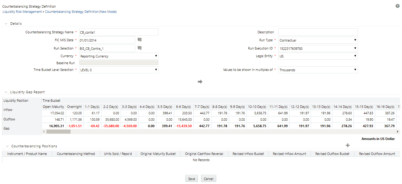

Details
The following details must be specified for the counterbalancing strategy:
·        Counterbalancing Strategy Name: Enter Counterbalancing Strategy Name.
·        Description: Enter the description of the counterbalancing strategy.
The following details of a particular execution of the underlying Run to which the counterbalancing strategy is to be applied are selected.
·        FIC MIS Date: Select the as of date of the Run to which the counterbalancing strategy is to be applied.
·        Run Type: Select the type of Run on which you want to apply the counterbalancing strategy. Options available in the drop-down are Contractual, BAU and Stress.
·        Run Selection: Select the Run to which the Counterbalancing Strategy must be executed.
·        Run Execution ID: Select the Run execution ID of the selected Run to which a counterbalancing strategy must be executed.
·        Currency: Select the reporting currency or local currency as an option. This will be executed on the selected currency type over the selected Run.
·        Legal Entity: Select the legal entity to which the counterbalancing strategy must be executed.
NOTE:
Data at the selected LE level only is displayed. This applies to LEs which have child entities as well.
·        Baseline Run: Select the baseline Run to which the counterbalancing strategy needs to be executed. When you click the selection button, Run Selection Browser appears which will allow you to select the Run.
·        Time Bucket Level Selection: Select the time bucket level selection to which the counterbalancing strategy must be executed.
·        Values to be shown in multiples of: Click this drop-down list to select to display the values in multiples of thousands, millions, and billions.

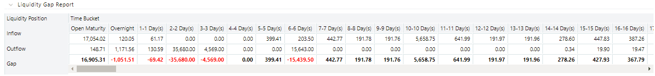

Liquidity Gap Report
This section displays Liquidity gaps calculated as part of the selected execution and Run selected at the time bucket levels which are in terms of multiples selected as part of the Details section.
It will be at the selected level and value. It will either be in millions or billions or thousands based on your selection. The Liquidity Gap report is generated once you click Grid Right icon button.

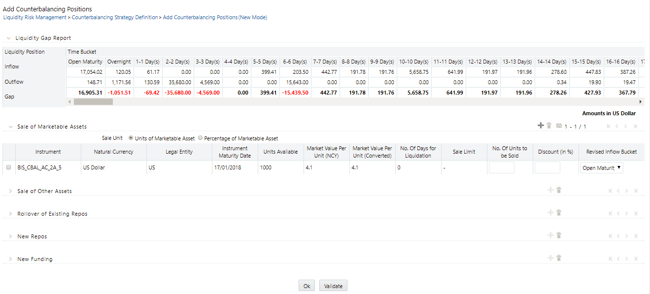

Counterbalancing Positions
This section allows you to add one or multiple counterbalancing positions, which together constitute a counterbalancing strategy. When you click the Add Add icon icon, the Counterbalancing Strategy Definition window is displayed where you can specify the counterbalancing positions to be applied.
The Counterbalancing Strategy Definition window supports the following types of counterbalancing positions in the application.
·        Sale of Marketable Assets
·        Sale of Other Assets
·        Rollover of Existing Repos
·        New Repos
·        New Funding

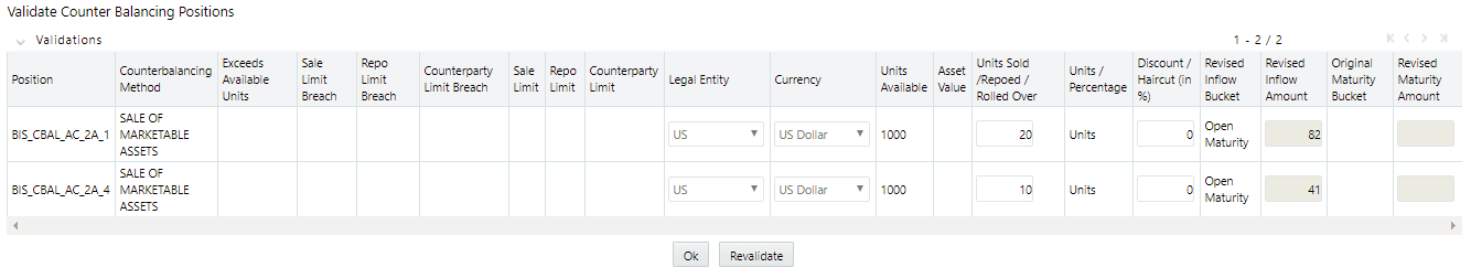

This counterbalancing position type allows you to sell a marketable instrument before its maturity. Sale of marketable assets generates new cash inflow in the sale bucket and reverses all original cash flows occurring between the sale bucket and maturity. Only unencumbered marketable assets (identified through encumbrance status and marketable asset indicator) are available for selection as a part of this counterbalancing strategy.
As part of this counterbalancing position, you are required to select a marketable instrument and provide the following sale parameters:
·        No. of Units / Percentage to be Sold: This is the number of units or percentage of the instrument that is to be sold. This value has to be within the sale limit, if any, specified for the asset.
·        Discount (in %): This is the discount applied to the asset value to determine the inflows on sale.
·        Revised Inflow Bucket: This is the sale bucket, or bucket where the cash inflows are generated due to the sale.

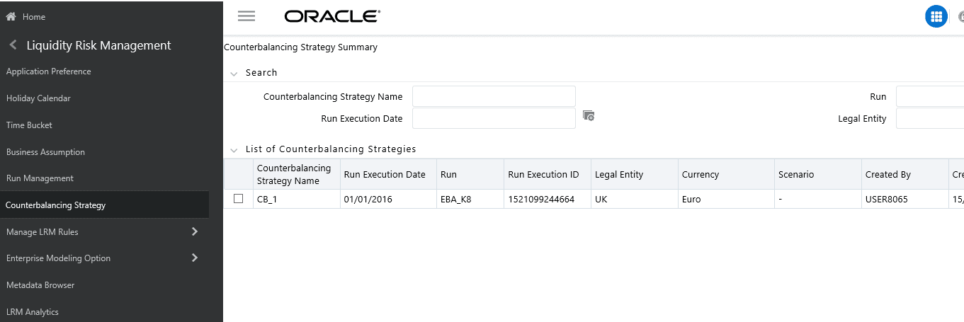

Understanding Counterbalancing Strategy Summary
In the Oracle Financial Services Analytical Applications Infrastructure home screen select Financial Services Liquidity Risk Management.
To open the Counter Balancing Strategy window, choose Liquidity Risk Management > Counter Balancing Strategy on the Left-Hand Side (LHS) menu.
Figure 63 Counterbalancing Strategies Summary
Description of the Counterbalancing Strategy Summary page follows This illustration shows the Counterbalancing Strategy Summary page.
The Counterbalancing Strategies Summary window of the application allows you to define and execute a Counterbalancing Strategy in the application.
The search section contains multiple parameters. You can specify one or more search criteria in this section. When you click the Search icon, depending upon the search criteria, this filters and displays the relevant search combination parameters under the list of Counterbalancing Strategies.
Counterbalancing Strategy - Fields and Descriptions
Search Field or Icon
Description
SearchSearch icon
This icon allows you to search the counterbalancing strategy based on the search criteria specified. Search criteria include a combination of Name, Run Name, Execution Date, or Legal Entity. The counterbalancing strategies displayed in the Counterbalancing Strategy summary table are filtered based on the search criteria specified on the clicking of this icon.
Reset Refresh icon
This icon allows you to reset the search section to its default state that is, without any selections. Resetting the search section displays all the existing counterbalancing strategies in the Counterbalancing Strategies Summary table.
This section allows you to search the pre-defined Counterbalancing Strategy based on the Counterbalancing Strategy name. Specify the Counterbalancing Strategy Name to search for the pre-defined Counterbalancing Strategy.
Run
This section allows you to search the pre-defined Counterbalancing Strategy based on the Run Name. Specify the Run Name here to search for the pre-defined Counterbalancing Strategy.
Run Execution Date
This section allows you to search the pre-defined Counterbalancing Strategy based on Execution Date. Specify the Execution Date here to search for the pre-defined Counterbalancing Strategy.
Legal Entity
This section allows you to search the pre-defined Counterbalancing Strategy based on Legal Entity. Specify the Legal entity to search for the predefined Counterbalancing Strategy.
 Counterbalancing Strategy Summary - Icons
Runs Icon Name
Icon
Description
Add
Add icon
This icon allows you to define a new Counterbalancing Strategy.
View
View icon
This icon allows you to view the selected Counterbalancing Strategy.
Edit
Edit icon
This icon allows you to edit the selected Counterbalancing Strategy.
Delete
Delete icon
This icon allows you to delete the selected Counterbalancing Strategy.

1.     Click Add icon Add icon in the counterbalancing strategy summary window. The Counterbalancing Strategy Definition window appears to define the counterbalancing strategy.
Figure 64 Counterbalancing Strategy Definition
 Description of the Counterbalancing Strategy Definition page follows This illustration shows the Counterbalancing Strategy Definition page.
2.     Enter the name of the counterbalancing strategy in the field Counterbalancing Strategy Name.
3.     Enter the Description of the Counterbalancing Strategy.
4.     Click Copy Attribute icon Copy Attribute iconto select the As of Date field.
NOTE:
 Depending on the As of Date selected, the other fields are filtered and then values are displayed.
5.     Select the type of Run (Contractual or Business-As-Usual) under field Run Type.
6.     Click Copy Attribute icon Copy Attribute iconto select the Run Name in the Run Selection field.
7.     Select the Run Execution ID from the dropdown.
8.     Select the Currency for which the Counterbalancing Strategy is to be executed.
9.     Select the Legal Entity for which the Counterbalancing Strategy is to be executed.
10.  Select the level at which the Time Buckets are to be displayed.
11.  Select the Values to be shown in multiples of Thousands, Million, or Billion, shown in the preceding figure:
12.  Click Grid Right icon Grid Right icon to display the Liquidity Gap Report, shown in the following figure. If there are any negative gaps, they are highlighted in red.
Figure 65 Liquidity Gap Report
Description of the Liquidity Gap report Section follows This illustration shows the Liquidity Gap report Section.
13.  Click Add icon Add icon in the Counterbalancing Positions section to add the counterbalancing strategies. The Add Counterbalancing Position window appears.
Figure 66 Add Counterbalancing Positions
Description of the Counterbalancing Positions - Add page follows This illustration shows the Counterbalancing Positions - Add page.
a.     In the Add Counterbalancing Position window, follow these steps:
i.         In this window, you can define five different types of counterbalancing strategies. See the Adding Counterbalancing Positions section.
ii.     Each counterbalancing strategy has its edit option (Add icon Add icon) which will allow you to select the instrument from the Instrument Selection browser window and apply the counterbalancing strategy to the identified Liquidity Gap. A detailed explanation about the inputs required for each counterbalancing strategy is provided in the Counterbalancing Positions section.
iii.   If an additional instrument is to be added, then click Add icon Add icon  and repeat the procedure.

v.     Click Validate to validate the entries updated by you.
The Validate Counterbalancing Positions window appears which indicates the positions which have breached limits specified as well as exceed available units.
Figure 67 Validate Counterbalancing Positions
 Description of the Validate Counterbalancing Positions section follows This illustration shows the Validate Counterbalancing Positions section.
vi.   The Validations section displays the following:
    Positions: The selected positions in which breach occurs is displayed.
    Counterbalancing Method: The counterbalancing method of the position is displayed.
    Exceeds Available Units: The positions which exceed available units are marked in red. These are treated as errors and must be changed to save the strategy. If any position has this error, the strategy cannot be saved.
    Sale Limit Breach: The positions which breach the sale limit specified are marked in yellow. These are warning messages which are displayed when you continue to save. You are allowed to save the strategy without changing these positions.
    Repo Limit Breach: The positions which breach repo limit specified are marked in yellow. These are warning messages which are displayed when you continue to save. You are allowed to save the strategy without changing these positions.
    Counterparty Limit Breach: The positions which breach counterparty limit specified are marked in yellow. These are warning messages which are displayed when you continue to save.
vii.  You are allowed to change the discounts and continue with the definition.
viii.           To revalidate, click Revalidate button. The same window appears with all positions which are rectified and no longer exceed units available or breach limits are marked in green.
ix.   On the Validate Counterbalancing Positions window, click OK to return to the Add Counterbalancing Positions window.
x.     On the Add Counterbalancing Positions window, click OK to return to the Counterbalancing Strategy Definition window.
To add Sale of Marketable Assets Counterbalancing Strategy, follow these steps:
1.     To select individual marketable instruments that are to be sold, click Add Add icon Add icon in the Sale of Marketable Assets section. The Instrument Selection window is displayed.
2.     Select the Instrument to which Sale of Marketable Asset Counterbalancing Strategy is to be applied and click.
3.     The list of instruments displayed in the Instrument Selection window is taken from the table FSI LRM Instrument table where Marketability Indicator is set to Y.
4.     You can alternatively search for the instrument by selecting the various filter options in the Advanced Filter field.
5.     The selected information is auto-populated from the FSI LRM INSTRUMENT table when you select the instrument in the Instrument Selection window.
6.     The following details of each selected instrument are displayed:
§       Instrument
§       Natural Currency
§       Legal Entity
§       Instrument Maturity Date
§       Units Available
§       Market Value Per Unit (NCY)
§       Market Value Per Unit (Converted)
§       No. of Days for Liquidation
§       Sale Limit
§       No. of Units / Percentage to be Sold
§       Discount (in %)
§       Revised Inflow Bucket
7.     You must specify the following sale parameters:
§       No. of Units / Percentage to be Sold: Enter the number of units or percentage of the instrument to be sold based on the Sale Limit parameter selected.
§       Discount (in %): Provide information on the discount on the price of the instrument. The discount should be entered in Percentage.
§       Revised Inflow Bucket: Select the inflow bucket where the stated cash inflow will occur.
For a detailed explanation of Sale of Marketable Assets, see the Sale of Marketable Assets section.
