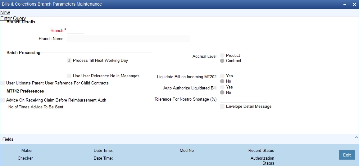

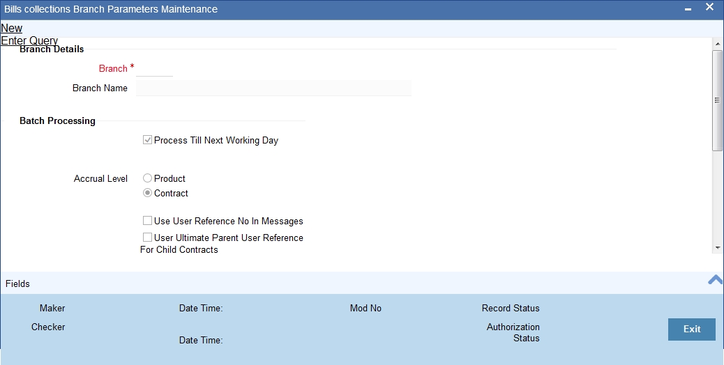

A set of rules that governs the processing of bills in a particular branch of your bank is defined in the ‘Bills & Collections Branch Parameter Maintenance’ screen.
You can invoke the ‘Bills & Collections Branch Parameter Maintenance’ screen by typing ‘BCDBRPRM’ in the field at the top right corner of the Application tool bar and clicking on the adjoining arrow button.
9.2.1.1 Specifying the Branch Details
Branch
Select the branch code from the option list provided. You can maintain branch parameters only from the respective branches. At the head office level you can alter branch parameters of other branches also.
Description
When you select branch code from the option list, the description of the same is defaulted here.
9.2.1.2 Specifying Batch Processing Preferences
The events, for which you had indicated automatic processing, are triggered off during the Batch Process. You can specify preferences for the automatic events that fall on a holiday in the Branch Parameters screen.
You can capture the following preferences here.
Process Till Next Working Day
If you indicate that the processing has to be done upto the next working day - 1, all the automatic events falling due on the holiday will be processed by the batch process as part of the EOD.
The batch process should process automatic events falling due on a holiday, on either of the following dates:
If you indicate that processing has to be done only upto the System Date by unchecking ‘Process Till Next Working Day’, then only the events scheduled for today (the last working day before the holiday) will be processed. The events of the holiday are processed by the batch process as part of the BOD process on the next working day.
For example, the current branch date is 20, October 1999. On 21, October 1999, which is a holiday, the following automatic events fall due:
Next working day - 1
If you specify that the processing should be done on the last working day - 1, the above events will be processed on 20 October as part of the batch process run at EOD.
System date
If you specify that the processing should be done only upto the system date by unchecking ‘Process Till Next Working Day, then the events scheduled for 21 October1999, will be processed as part of the Batch Process run as part of Beginning of Day on 22 October 1999.
Use User Reference No in Messages
If you wish to display the user reference number in the advices that are generated for a contract, select this option. All the advices generated at your branch will display the appropriate user reference number.
Note
You can specify a format for the generation of the User Reference Number in the ‘Se­quence Generation’ screen available in the Application Browser. Refer to the Core Servic­es User Manual for details on maintaining a sequence format.
Use Ultimate Parent User Reference for Child Contracts
If you wish to display the user reference number of the ultimate parent in the advices generated for child contracts, select this option. If this box is unchecked, the user reference number of the child is displayed for the child contracts.

As part of STP for MT202, if you check ‘Liquidate Bill on Incoming MT202’ option in the ‘Bills and Collections Branch Parameter Maintenance’ screen, system will do a validation to check if any Export Bill Contract exists for the reference number in the field 21 in 202. System checks the value in field 21 against the Contract Reference Number first. In case the Contract Reference Number does not exist, system will check the User Reference Number.
If a contract exists, which is already liquidated, the ‘Status’ & the ‘Process Status’ will be updated with ‘Repair’. If a contract exists and not liquidated and if the Bill amount matches with the amount in the message, system will try to liquidate the Bill Contract. In case of failure, system displays an appropriate error message and the ‘Status’ will be updated to ‘L’ (Pending Liquidation) while the ‘Process Status’ will be updated as ‘R’ (Repair). If the Bill is liquidated successfully, then system updates the ‘Status’ and the ‘Process Status’ as ‘P’. The Generated Ref No is updated with the Bill Contract Ref No. You can view the status and the generated reference number in ‘Incoming Message Browser’ screen for the respective DCN.
For further information on ‘Incoming Message Browser’ screen, refer ‘Manual Processing of Incoming Messages’ section in the ‘Processing Incoming Messages‘ chapter in the ‘Messaging System’ User Manual.
Once the Bill is liquidated successfully and the status of the message is marked as ‘P’, any change in the contract like deletion or cancellation will not impact the message that triggered the Liquidation.
System checks the following mismatch between the Bill amount and the amount in the message:
If the Bill is liquidated successfully, if the flag ‘Auto Authorize liquidated bill’ in the ‘Bills and Collections Branch Parameter Maintenance’ screen is ‘Yes’, then the liquidation will be authorized automatically otherwise, post liquidation, the contract will be in Unauthorized status.
For further information on ‘Bills and Collections Branch Parameter Maintenance’ screen, refer ‘Maintaining Branch Parameters for Bills and Collections’ section in the ‘Maintenance‘ chapter in the ‘Bills and Collections’ User Manual.
If the Bill liquidation process is failed and if the status is ‘L’, then you will have to liquidate the Bill manually by suppressing the message. As part of Bill liquidation, the Value date (32A) will be considered for the Credit Value date & Debit Value date of the contract.
System picks up the records with ‘R’ (Repair) in ‘Process Status’ and tries reprocessing the same. In case of Trade Related MT202 message (where the ‘Status’ is ‘L’), then system will not check again if it is a Trade Related MTM202. System will directly try liquidating the underlying Bill contract.
