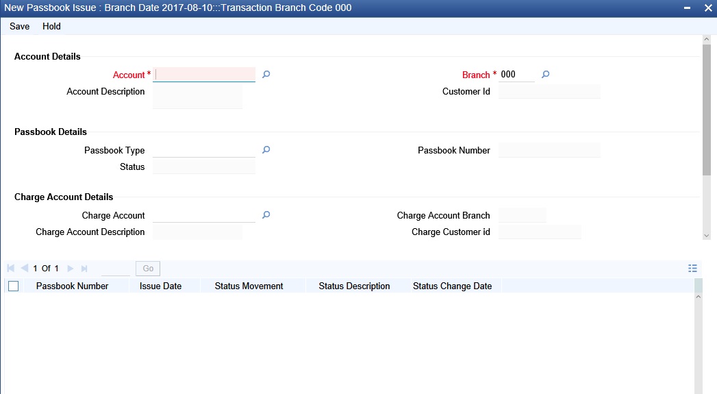

8.1 New Passbook Issue Details
8.1.1 Invoking New Passbook Issue Screen
You can invoke the ‘New Passbook Issue’ web branch screen by typing ‘7030’ in the field at the top right corner of the Application tool bar and clicking on the adjoining arrow button.
Account Details
Account
Specify account details. Alternatively, you can select account number from the option list. The list displays all valid account number maintained in the system.
To view the joint holder’s details of an account and the mode of operation maintained at the account level, place the cursor on the Account Number field and press Ctrl+J. The system displays the ‘Joint Holder’ screen.
For more information on the ‘Joint Holder’ screen refer to the section ‘Joint Holder Maintenance’ in this User Manual.
Account Description
The system displays the description for the selected account.
Branch
Specify the branch code. Alternatively, you can select branch code from the option list. The list displays all valid branch code maintained in the system.
Customer ID
The system displays the customer ID for the selected account number.
Passbook Details
Passbook Type
If inventory tracking is allowed at bank level then you will be asked to enter the passbook type. The list of values for passbook type selection will be the list of valid stock catalog codes with instrument type as ‘Passbooks’.
Passbook Number
If inventory tracking is allowed at bank level then system will retrieve the next available instrument number based on the passbook type. The retrieved passbook number will be displayed to the user only after the passbook issue is saved.
Note
Passbook issuance is allowed despite the value selected for inventory tracking in bank pa­rameter level.
Status
The system displays the status as ‘active’ or ‘Reissue & Active’.
Charge Account Details
Charge Account
The system will default the account number from the ‘Account Number’ field. You can amend this value.Specify the charge account, Alternatively, you can select charge account number from the option list. The list displays all the valid charge account number maintained in the system.
On selecting different account values, the system will default Charge Account Branch, Charge Account Description, Charge Customer ID automatically.
The system displays the description for the selected charge account number.
The system displays the branch code.
Charge Customer ID
The system displays the charge customer ID for the selected charge account number.
Additional Details
Remarks
Enter a short remark about the passbook issue.
External Reference Number
The system generates and displays the reference number.
Click ‘Populate’ button to view charge and history details of the passbook
The system displays the details of all the passbooks issued for the selected account. The following details are displayed:
Passbook details are displayed in descending order based on the date of pass book issuance.

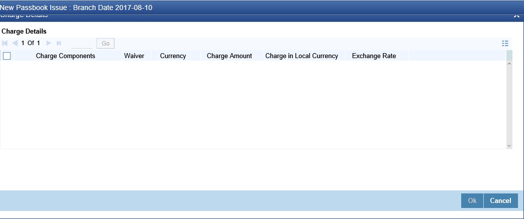

8.1.2 Charge Button
Clicking ‘Charge’ button, the following window is displayed. In ‘Charge Details’ window, you can capture details of charges associated with the issuance of a new passbook.
Charge Component
The system displays a short charge description.
Waiver
Check this box if you want to waive charges associated with issuance of new passbook.
Charge Amount
The system computes and displays the charge amount associated with the issuance of passbook. However you can edit it.
Currency
The system displays the currency used. It need not be same as account currency.
Charge in Local Currency
The system displays the charge amount in local currency on successful Issuance of passbook. You cannot modify it.
Exchange Rate
The system displays the applicable exchange rate if the currency used is different from the local currency during SAVE operation. Based on the exchange rate maintained for the cross currency, charge will be calculated and deducted from the customer account. You cannot modify the value..
Account Entries
On saving the operation, the charge amount is liquidated. The below given table indicates the accounting entries for the same.
Dr/Cr Indicator
Accounting Role
Amount Tag
DR
Customer account
CHG_AMT
CR
Charge GL mapped
CHG_AMT

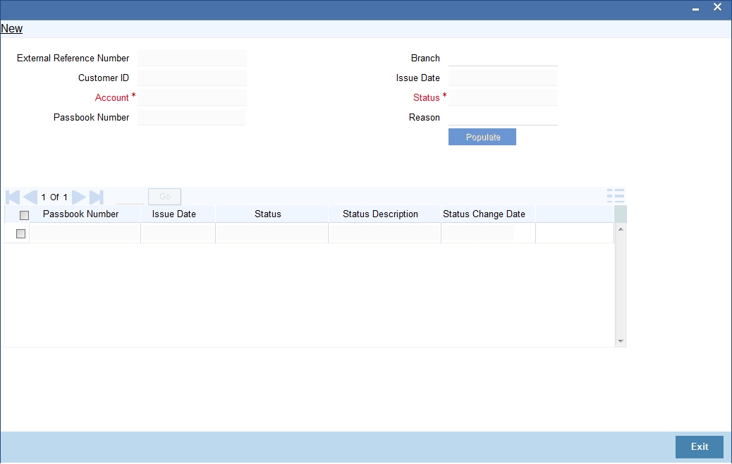

8.2 Passbook Status Change
This section contains the following topic:
8.2.1 Invoking Passbook Status Change Screen
You can invoke the ‘Passbook Status Change’ screen by typing ‘7031’ in the field at the top right corner of the Application tool bar and clicking on the adjoining arrow button.
System generates and displays the reference number.
Customer ID
The system displays the Customer ID based on the selected account.
Account Number
Select the account number for which the status has to be modified.
Passbook Number
The system displays the latest passbook number issued for the selected account.
Branch Code
The system displays the branch code based on the account selected.
Issue Date
The system displays the date of issue of the passbook.
Status
You can select the status from the adjoining option list. The system defaults the current status of the passbook from account number
Reason
Enter the reason for applying a new passbook.
The History tab gets populated on clicking Populate button.
Refer the section ‘Maintaining Passbook Details’ in the chapter titled ‘Maintaining Passbook’ in this User Manual for details about the ‘Passbook Status Change Screen
Note
On closing the account, the passbook status is automatically changed as Account Closed and no further status changes can be made on the same account.
Modifying the status of the passbook will not impact the Account status of the correspond­ing account.
Printing is allowed only for the open accounts and at least once authorised accounts with passbook facility.

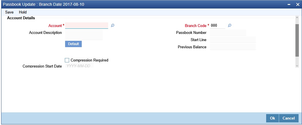

8.3 Passbook Update
8.3.1 Invoking Passbook Update Screen
You can invoke ‘Passbook Update’ screen by typing ‘7010’ in the field at the top right corner of the Application tool bar and clicking on the adjoining arrow button.
You can specify the following details:
Account Details
Account
Specify the account number. Alternatively, you can select account number from the option list. The list displays all valid account number maintained in the system.
Account Description
The system displays the description for the selected account number.
Branch Code
Passbook Number
The system displays the passbook number.
Start Line
Specify the start line of the passbook to enter the transaction details.
Previous Balance
The system displays the previous balance in the passbook.
Compression Required
Check this box to modify the defaulted values related to transaction compression.
If this field is checked in ‘Preferences’ button of ‘Account Class Maintenance’ screen, and if the count of unprinted transactions is more than the value maintained in field ‘Limit for Unprinted Transactions’ at Account Class level, then the transaction compression is applicable for the passbook printing and system will auto default values in following fields of passbook update screen :
Compression Start Date
The system displays the compression start date.
Compression End Date
Select the compression end date from the adjoining calendar.
If ‘Compression Required’ field is checked and compression period is specified, the system will aggregate the debit and credit amount separately for the transactions during the compression period and print a single line on passbook along with the closing balance as of the compression end date.
After printing, all the transactions are either printed individually or consolidated will be marked as ‘Printed’ in system. The date printed on the passbook for the compressed entry will be the end date of compression period.
Transaction code maintained for transaction compression at account class level will be printed for compressed entry. All transactions which are printed as part of compressed entry will be tracked under the same line number. For instance, if compressed entry is printed on line number 8 on passbook and there are total 10 transactions which are compressed, system will track all 10 transactions under line number 8.
If Passbook Compression Preferences are not maintained and you try to compress the transaction, the system will display an appropriate error message.
Each time, when transaction compression is done while printing of passbook, the system will generate a unique Compression Reference Number as per the following logic:
Clicking ‘Default’ button, the system will populate the values in Start Line, Previous Balance, Compression Required, Compression Start Date and Compression End Date.

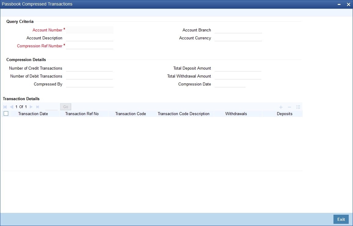

8.5 Passbook Compressed Transactions
8.5.1 Invoking Passbook Compressed Transactions Screen
You can view the details of transactions which are compressed/consolidated as part of compressed entry using ‘Passbook Compressed Transactions’ screen. You can invoke this screen by typing ‘ACDCMPTR’ in the field at the top right corner of the Application tool bar and clicking on the adjoining arrow button.
Query Criteria
Account Number
Specify the CASA Account number for which compressed entry to be enquired. Alternatively, you can select the account number from the option list. The list displays all valid account numbers maintained in the system.
Account Description
The system displays the description for the selected account number,
Compression Ref Number
Specify compression reference number which is to be enquired.
Account Branch
The system displays the branch code for the selected account number.
Account Currency
The system displays the currency details for the selected account number,
Clicking ‘Execute Query’ button after entering the necessary values, the system displays the following details:
Compression Details
Transaction Details

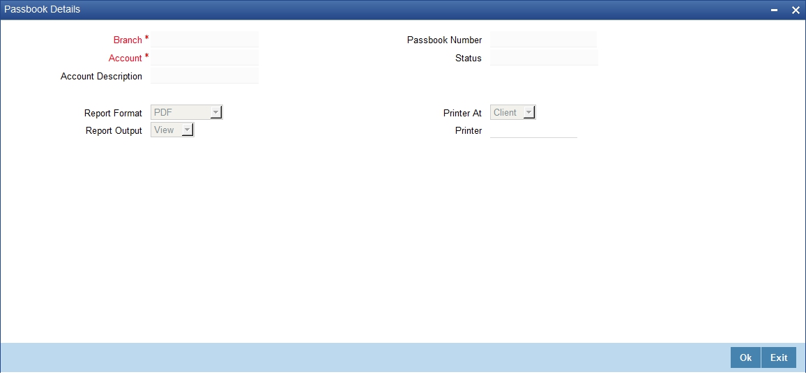

8.6 Passbook Reports
8.6.1 Invoking Passbook Reports
You can invoke the ‘Passbook details’ screen by typing ‘CARPASBK’ in the field at the top right corner of the Application tool bar and clicking on the adjoining arrow button.
Branch Code
Account
Click Ok to generate the passbook report based on the given parameters.
