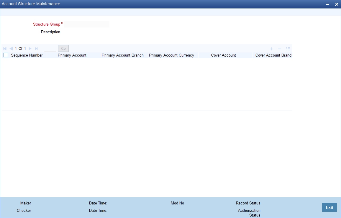

10.3 Maintaining Account Structure
You can specify the account structure in the ‘Sweep Structure Maintenance’ screen. You can invoke the screen by clicking ‘Sweep In Setup‘ in the ‘Customer Accounts Maintenance’ Screen.
For Further details on maintaining the details for Cover Account, refer ‘Maintaining Sweep Structure’ in Maintaining Customer Accounts’ chapter of this module.

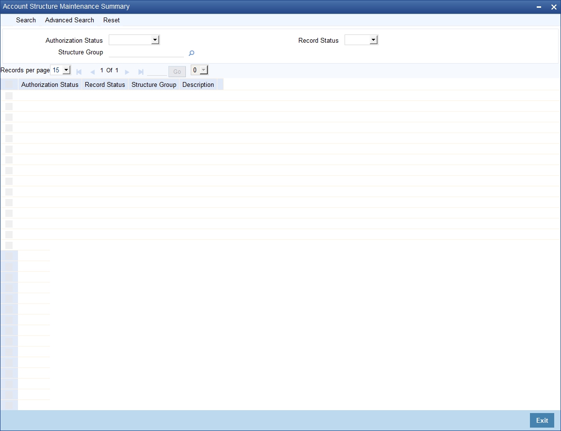

10.4 Viewing Account Structure Maintenance Summary
You can view the summary details of the account structure in the ‘Account Structure Maintenance Summary’ screen.
To invoke this screen, type ‘CASSTRUC’ in the field at the top right corner of the Application tool bar and click the adjoining arrow button.
You can query on records based on any or all of the following criteria:
Click ‘Search’ button. The system identifies all records satisfying the specified criteria and displays the following details for each one of them:
