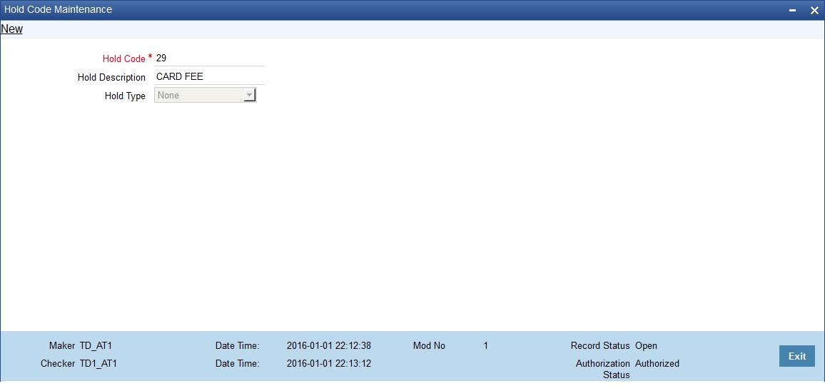

12.1 Hold Code Maintenance
12.1.1 Maintaining Hold Codes
Whenever you impose an amount block (hold) on customer accounts, a valid reason can be assigned for having effected the hold. You can define these reasons using the ‘Hold Maintenance’ screen.
You can invoke this screen by typing ‘CODHOLDT’ in the field at the top right corner of the Application tool bar and clicking on the adjoining arrow button.
You can capture the following details here:
Hold Code
Specify a code for the amount block reason you are maintaining in the system.
Note
The Hold Code can be a maximum of 15 characters (alphanumeric type) in length.
Hold Description
Provide a brief description of the hold code.
Hold Type
In case you are defining amount hold reasons for automated system hold, select the hold type from the adjoining drop-down list. The available options are:
Note
Except ‘None’, for all other Hold Types mentioned above, only one Hold Code each can be maintained in the system.

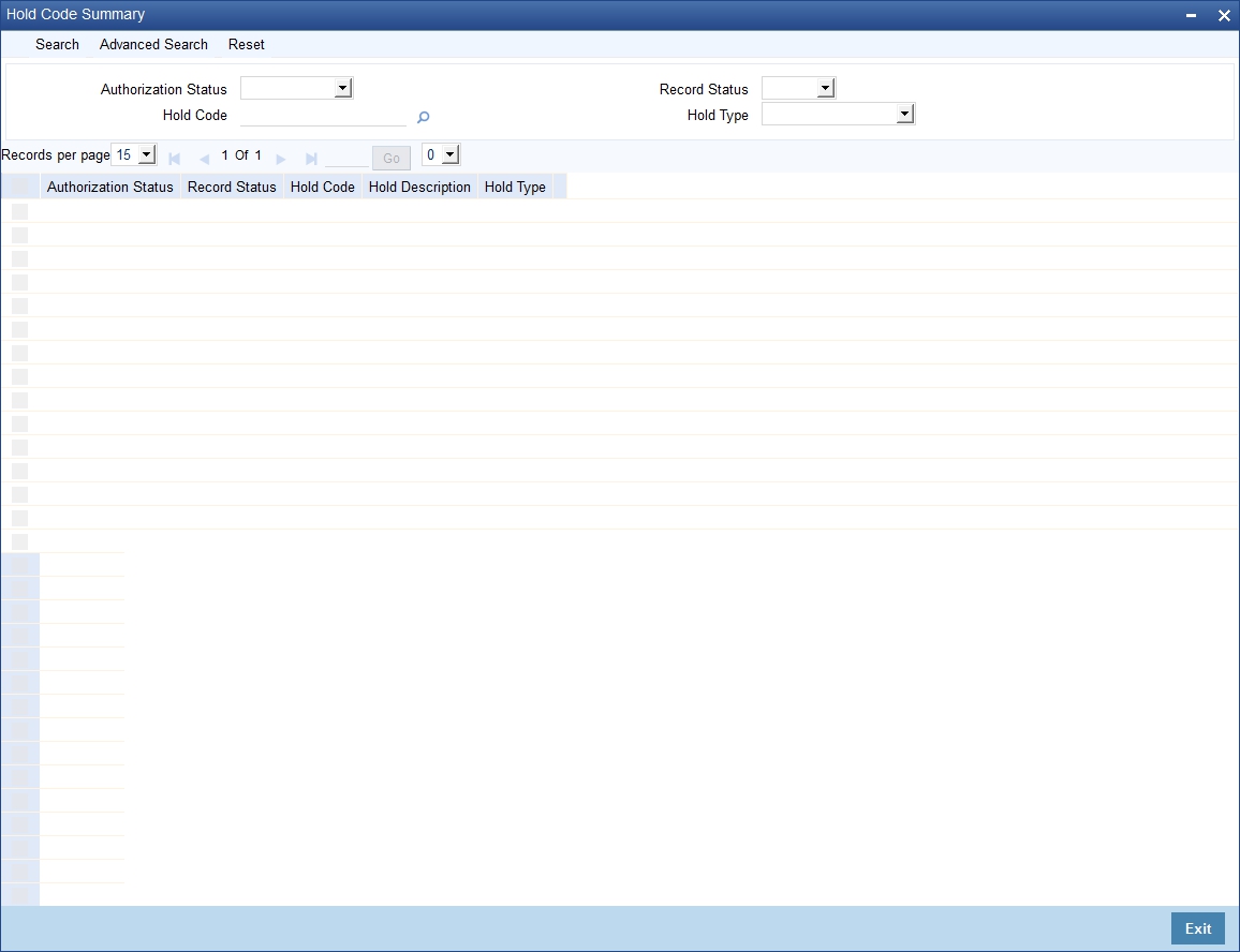

12.1.2 Viewing Hold Codes
You can view a summary of Hold Codes maintained in the system using the ‘Hold Summary’ screen. You can invoke this screen by typing ‘COSHOLDT’ in the field at the top right corner of the Application tool bar and clicking the adjoining arrow button.
You can query on records based on any or all of the following criteria:
Click ‘Search’ button. The system identifies all records satisfying the specified criteria and displays the following details for each one of them:

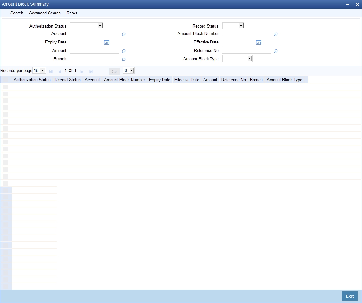

12.2.2 Viewing Amount Block
You can view a summary of Amount Blocks maintained at the ‘Amount Block Input’ level using ‘Amount Block Summary’ screen.
You can invoke the ‘Amount Block Summary’ screen by typing ‘CASAMBLK’ in the field at the top right corner of the Application tool bar and clicking the adjoining arrow button.
You can view records based on any or all of the following criteria:
Note
The system generated original transaction Reference No of Escrow amount blocks will also be displayed.

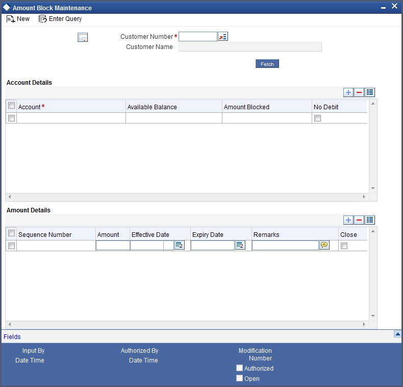

12.2.3 Maintaining Consolidated Amount Block Details
You can invoke the ‘Consolidated Amount Block Input’ screen by typing ‘CADCAMBL’ in the field at the top right corner of the Application tool bar and clicking on the adjoining arrow button.
In this table, you maintain all amount block details enforced for a customer account. Any number of amount blocks can be enforced for an account.
The following information will be available in this screen:
If you are maintaining consolidated amount blocks for the first time for a customer account, you need to select the name of the customer from the option-list provided. On selection of the customer, all accounts maintained for the customer that are available in the current branch will be displayed in the middle section of the screen along with existing amount block details, if any. Select an account to view all the individual amount blocks for the selected account in the lower half of the screen.
To create a new amount block, click add icon. The sequence number for each amount block will be automatically created by the system.
Maintain the following parameters for the amount block:
Amount
Specify the amount that you would like to block in the account. When an amount block is set for an account, the balance available for transaction would be the current balance of the account minus the blocked amount.
Whenever a customer account is debited of an amount that exceeds the available balance in the account, the system asks for an ‘override’. Note that the available funds in a blocked account will always be shown to be the current balance less the amount block.
The ‘Blocked Amount’ field in the middle section of the screen will display the sum of all the amount blocks placed on the account.
You can raise the blocked amount for an account. On authorization, the ‘Customer Accounts’ table will be updated with the modified blocked amount.
Effective Date
When defining amount blocks for an account, specify the date on which the amount block comes into effect. A future-dated amount block comes into effect when the Beginning of Day process is executed for the day (on which the amount block becomes effective).
Expiry Date
This is the day on which the amount block expires. An amount block is effective till the EOD is run on the expiry date. On expiry of an amount block, the block amount status in the ‘Customer Accounts Maintenance’ table gets updated (if no other amount block is enforced on this account). The balance available for transaction is also updated.
Remarks
Here you can enter any remark specific to this amount block. For example, you can capture the purpose for which a block has been affected.
No Debit
When defining amount blocks, you can choose to completely block the account from any kind of debits made to the account. To do this, select the option ‘No Debit’. At a later point, you can UN Cheque this option to release the full block and define partial blocks if required.
Close
As stated earlier, the amount block will remain active from the effective date till the expiry date. However, you can release a block before the expiry date. Select the ‘Close’ option to affect a forceful closure of the amount block. If you do not select this option, the amount block will be released as part of the EOD batch process executed on the expiry date.
