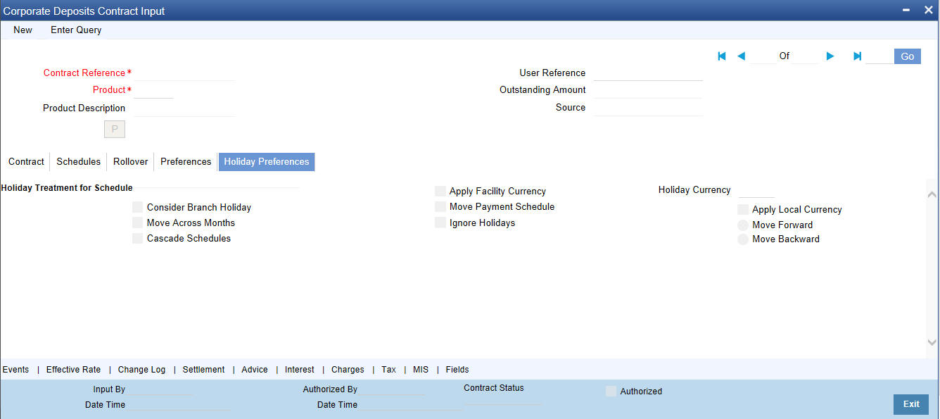

In such a situation, a repayment falling on a holiday would be processed according to you specification for holiday handling (in the Deposits Branch Parameters screen). It would be as follows:

Move Payment Schedule
If the holiday calendar change affects any of the payment schedules, the system will re-compute the payment schedule dates.
Move Revision Schedule
If the holiday calendar change affects any of the revision schedules, the revision schedule dates are recomputed.
For payment schedules, outstanding schedules are re-computed (schedules, due spot days after the current application date) whenever there is a change in the Currency Holiday Calendar for the currency of the contract. For other schedules, any schedule after the current system date would be considered for revision.
The re-computation is done for all types (Payment, Revision) of schedules. The rescheduling preferences defined for a product are defaulted to any contract using the product; they can be modified when a contract is entered. After authorization of the contract, they cannot be altered.

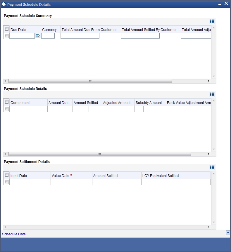

For a deposit, you can define repayment schedules that:
Now, if you want to define schedules that fall due at regular intervals, all you have to do is, for a component specify the start date, the frequency, the unit and the principal amount. Since you would have already registered the Maturity Date of the deposit (for a fixed maturity type), in the Contract Details screen, the schedules would automatically be spread out into equal intervals.
Based on this information, the system calculates the dates on which the repayments or interest revisions fall due.
Repayments that are scheduled for a date later than today can be redefined. This redefinition can be done even after the deposit has come into effect and a few schedules have been liquidated.
However, schedules with a date earlier than today’s date that are yet to be liquidated cannot be rescheduled. You have to liquidate them through the Manual Liquidation function. Aging analysis and penalty processing will be done on such overdue schedules.
The redefinition of schedules will be done automatically on the following occasions:
There may be some situations wherein you would want to redefine the schedules, i.e., you may want to change the payment dates or amounts. In such cases, click ‘Default’ button in the Contract On-line Schedule Definition screen. All the schedules defined at the product level is displayed.
To redefine a schedule for only one component, highlight the schedule make the changes and select ‘Add’ in the Application tool bar or click add icon.

Move Across Months
If you have chosen to move a schedule falling due on a holiday to the next working day, or to the previous working day, and it crosses over into another month, the schedule date will be moved only if you so indicate. If not, the schedule date will be kept in the same month.
For example,
You have defined a repayment schedule that falls due on April 30, 1998. This happens to be a holiday. You indicated that in case of a holiday, the schedule date is to be moved forward to the next working day.
If you also indicated that the schedule can be moved across the month, then the schedule will be automatically moved to May 1, 1998 (the next working day). If you disallowed movement across the month, but indicated forward movement for the schedule, the schedule date will be automatically moved (backward in this case) to the last working day of the same month, that is, to April 29, 1998 (despite your having indicated a forward movement into the next working day).
Scenario 2:
You have defined a repayment schedule that falls due on May 1, 1998. This happens to be a holiday. You indicated that in case of a holiday, the schedule date is to be moved backward to the previous working day.
If you also indicated that the schedule can be moved across the month, then the schedule will be automatically moved to 30 April 1998, the previous working day.
If you disallowed movement across the month, but indicated backward movement for this schedule, the schedule date will be automatically moved (forward in this case) to the next working day of the same month, that is, to 2 May 1998 (despite your having indicated a backward movement into the previous working day). The idea being that the schedule is not moved across months.
Cascade Schedules
The question of cascading schedules arises only if:
If you have indicated that schedules should be cascaded, the schedule date for the next payable schedule will depend on how the schedule date was moved for a holiday. The following example illustrates how this concept of cascading schedules functions.
For example,
A monthly schedule has been defined with backward movement and a schedule date falling due on April 30, 1998 was moved to April 29, 1998, April 30, 1998 being a holiday.
The schedule date for May depends on whether you have chosen to cascade schedules. If you have, the schedule date for May will be set as May 29, 1998, as the frequency has been specified as monthly. For subsequent schedules also, May 29, 1998 will be considered the last schedule date. That is, the next schedule will be June 29, the following one July 29, and so on, until another holiday is encountered.
If you have not specified that schedules have to be cascaded, the date originally specified, will be the date for drawing up the schedules. Even if the April month end schedule has been moved to April 29, 1998, the next schedule will remain May 30, 1998. The following one will be June 30, and so on.
Even if another holiday is encountered, and the schedule date for that particular schedule is moved suitably, 30 will remain the date for the following schedule, whenever it falls.
When you cascade schedules, the last schedule (at maturity), however, will be liquidated on the original maturity date and will not be changed like the interim schedules. Hence, for this particular schedule, the interest calculation days may vary from those of previous schedules, as the case may be.
You have specified that repayment schedules should be generated automatically once you indicate the frequency, number and the date of first repayment. When the system computes the repayment dates based on these values, there is a chance that one or more schedules fall due on a holiday. In such a case, you have two choices:
A schedule date falls on a holiday and you have not specified that holidays are to be ignored at the time of schedule definition. In this case, you should indicate the movement of the schedule date:
Since the schedule date itself is moved to a working day, the payment will be processed on the day it falls due, as of that day.
If you specify that holidays are to be ignored, the schedule dates will be fixed without taking the holidays into account.

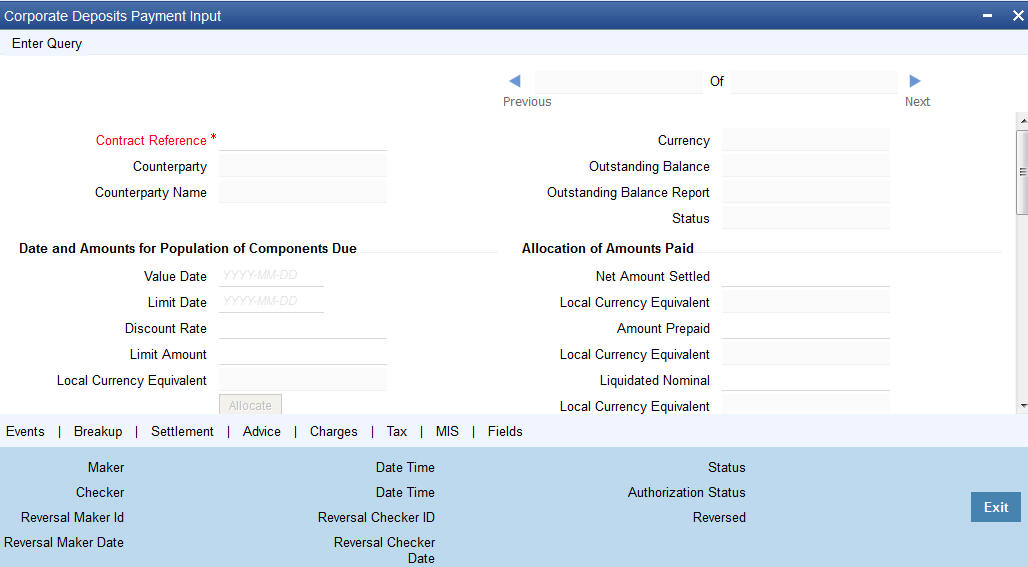

You can invoke ‘Corporate Deposits Payment Input’ screen by typing ‘CDDPMNT’ in the field at the top right corner of the Application tool bar and clicking the adjoining arrow button.
The following operations can be performed on a payment through the Contract Schedule Payments screen:
The manual payments made through this function can be:
The value date you have entered will be used for all the entries generated by the system.
External Charge
During CD payment input for a contract for which ‘External Charges’ is enabled at product level, external charges is fetched from external pricing and billing engine.
Once you enter the deposit reference number in the Contract Schedule Payments you will see the following details displayed on the screen:
The Value Date here, is the date on which the liquidation entries will be passed. When you enter a Value Date in this screen, if there are any payments due on that date, they will be displayed and you can liquidate them.
If there are no schedules due on that date, the schedule becomes a prepayment. But this is only if the Value Date is not a back valued date. You can have a back valued date but it cannot be earlier than the last schedule that was due. (You can also liquidate back valued schedules by entering a Limit amount)
If the Value Date is today or a date in the future, the prepayment is processed.
The Payment Limit Date or Amount of the payment should be given at the time of payment. If you have given a payment limit date, the system shows all the components which are due till the limit date. If you have given the amount limit in the Amount field, it shows all the schedules for the limit amount.
For example,
Say for a particular contract, there are two interest schedules to be paid on Ms Yvonne Cousteau’s Domestic term Deposit — one on 1 October 1997 and the other on 15 October 1997. The third schedule is due on 30 October 1997.
If you give the Limit date as 25 October, (today’s date) the system will show you the amounts due for the interest component on the schedule dates of 1 October, and 15 October.
If you give the limit date as 1 November 1997, the system will show you the schedules falling on 1 October, 15 October and 30 October, and you can liquidate them accordingly.
Since today’s date is October 25, if you pay the schedule due on 30 October, it amounts to a pre-payment. You can charge a prepayment penalty rate or an amount which you enter in this screen.
Note
While the Prepayment Limit Date is used to pick up the schedules pending as of that date, the Value Date is taken into account by the system for passing accounting entries.
Alternatively, the system picks up a schedule according to the amount being paid. You will see the next schedule, which is due, within the limit of this amount. If the amount being paid is more than the total amount payable for the next schedule, the next schedule will be considered. The total amount due for these schedules is displayed.

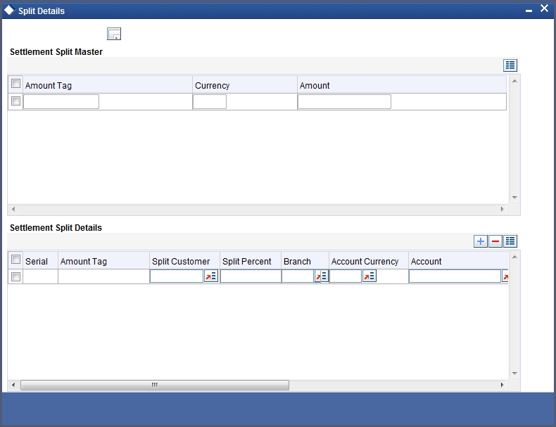

You can specify the details of the split settlement for the each loan contract through the ‘Split Details’ screen. Click ‘Split Settlements’ in the ‘Corporate Deposits Payment Input’ screen to invoke this screen.
In this screen, the following details are displayed:
Note
The amount tags are displayed only if they are defined for the event that is being processed. Further, the interest tag is populated only if it is defined as a main component.
If there are no settlement tags for the event being processed, the system displays the message as ‘There are no Settlement tags to be split for the Current Event’.
You can specify the split details for each of the amount tags in the Settlement Split Details section of the screen. Click the ‘Add’ button to maintain the split details. The sequence number and the split amount tags are automatically generated by the system. For example, if the Basis amount tag is PRINCIPAL, then the system creates the split amount tag as PRINCIPAL_S01, where S01 is the split sequence number. Each subsequent split amount tag is suffixed by S02, S03 and so on.
For each spilt amount tag, specify the following details:
Amount
Specify the amount for the split amount tag. This amount should not be greater than the amount of the corresponding basis amount tag. The split amount is in the currency of the basis amount tag.
Branch
Specify the settlement branch for the split amount tag. This adjoining option list displays all valid branches maintained in the system. You can choose the appropriate one.
Account Currency
Specify the currency of the account that should be used to do the settlement.
Account
Specify the settlement account for the split amount tag. This account should be valid account of the branch selected earlier.
Exchange Rate
If the basis amount currency is different from the account currency, then specify the exchange rate that should be used for the currency conversion.

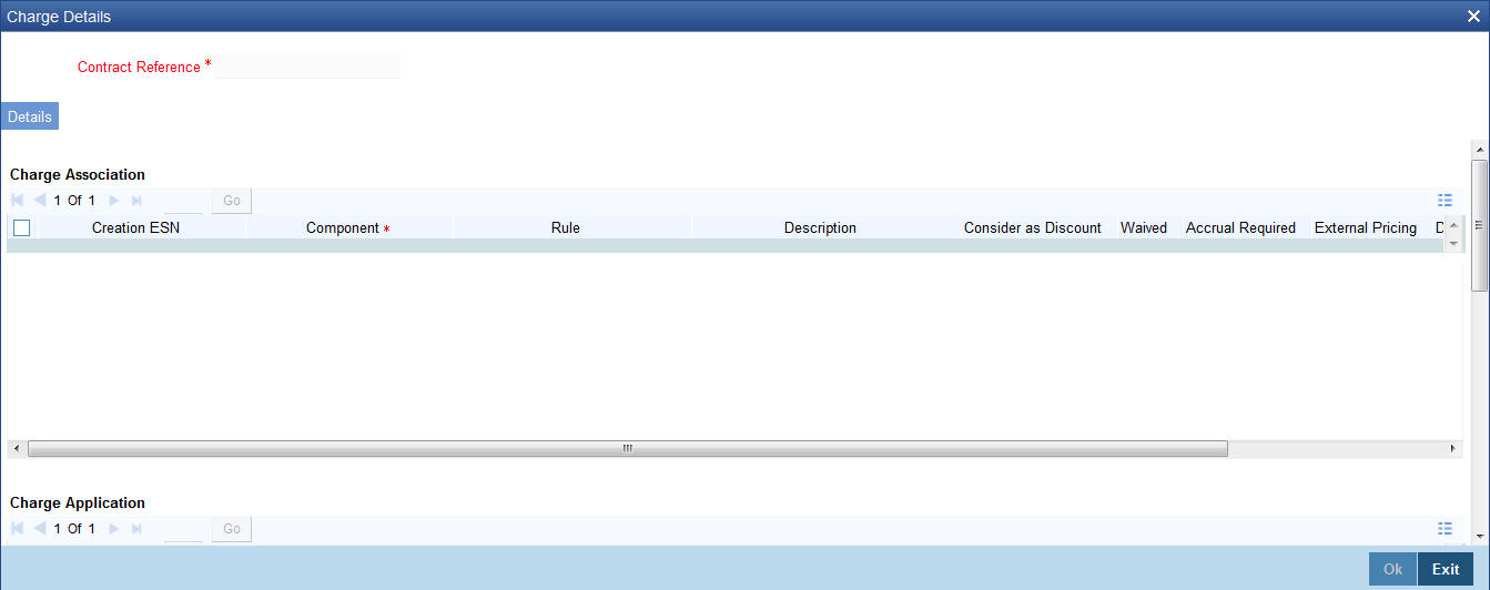

Click ‘Charges’ button from ‘Corporate Deposit Payment Input’ screen to view charge details.
Refer the Charges and Fees User Manual under Modularity for further details about this screen.

In the Schedules tab, you can view the Schedule Breakup details.
You will see the following in this screen:
Component
In this screen you can see the schedules being paid on account of this particular payment for which you are doing manual liquidation. The component getting paid is displayed.
Due Date
The due date of the component being liquidated is displayed.
This field displays the amount which is due for payment for a particular component.
Amount Paid
This is the amount being paid for a particular component. This amount must be less than or equal to the total amount due for the component.

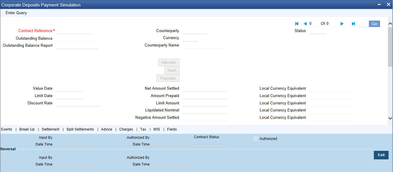

Payments for corporate deposits can be simulated using the 'Corporate Deposits Payments Simulation' screen. In addition to this, you can save simulated Payments like a normal Payment with the payment status as ‘Simulated’. You can invoke this screen by typing ‘CDDSIMPT’ in the field at the top right corner of the Application tool bar and clicking the adjoining arrow button.
Note
The ‘Corporate Deposits Payment Simulation’ screen is similar to ‘Corporate Deposits Payment Input’ screen.
For further details on ‘Corporate Deposits Payment Simulation’ screen, refer ‘Making Manual Payments’ section in this User Manual.
Click 'Simulate' button to invoke the ‘Corporate Deposit Contract Input’ screen with the affected schedules having impact of the simulated payment.
For further details on ‘Corporate Deposits Contract Input’ screen, refer ‘Specifying Deposit Details’ section in the ‘Capturing Details of Deposit’ chapter of this User Manual.
You can query the simulated Payment in the 'Loans & Deposit Payment Input' Screen. You can invoke this screen by typing ‘CDDPMNT’ in the field at the top right corner of the Application tool bar and clicking the adjoining arrow button.
The simulated payment can be saved as a normal Payment with the payment status as ‘Paid’. Every simulated Payment gets deleted as a part of the EOD batch.

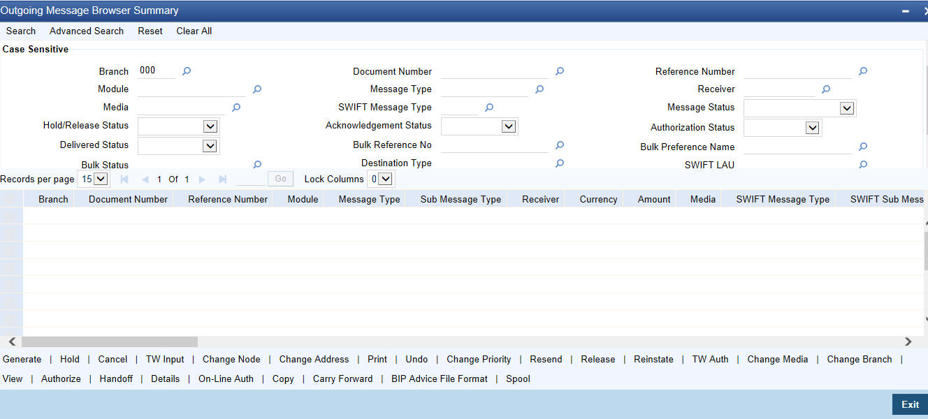

You can generate advice for every Payment Simulation, by invoking the ‘Outgoing Message Browser’ screen. This advice is addressed to the Customer, which gives the complete payment details related to the Deposit Account before and after Payment Simulation. You can invoke this screen by typing ‘MSSOUTBRS’ in the field at the top right corner of the Application tool bar and clicking the adjoining arrow button.

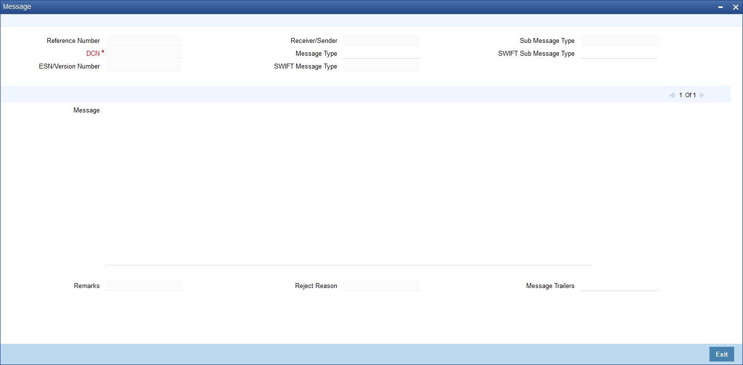

You can view the generated advice in the ‘Message Details’ screen. Click ‘View’ button in the ‘Outgoing Message Browser’ screen to invoke this screen.
For further details on ‘Outgoing Message Browser’ screen, refer ‘Manual Generation of Outgoing Messages’ section in the ‘Processing Outgoing Messages’ chapter of the ‘Messaging System’ User Manual.
