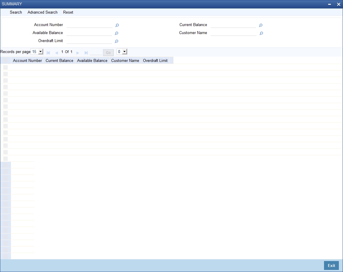

You can invoke this screen by typing ‘STSREFEQ’in the field at the top right corner of the Application tool bar and clicking the adjoining arrow button.
In this screen the following details of the account are displayed:
Note
A charge, fee or interest debited to the customer account will not be referred to the Referral Queue

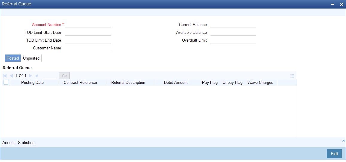

Using the Referral Queue, you can view details of all transactions processed during the day due to which the account has moved into overdraft. For example, Silas Marner’s savings account has a balance of 1000 Euro (with no O/D facility). There are five checks of 300 Euro each drawn on the account on the same day. On double clicking on Silas Marner’s account number in the Referral Queue, the details of all five checks will be displayed for your perusal in the Referral screen.
You can invoke this screen by typing ‘’STDREFEQ’ in the field at the top right corner of the Application tool bar and clicking the adjoining arrow button.
You will be able to view the following details about the entries which have been posted and those that are not to post:
The default option is to approve (Pay) the check/DD amount. On occasion you may want to ‘unpay’ or reject a check/DD. You will be allowed to levy charges both for approving as well as recalling/rejecting checks. There are no limits on the charges for recalling a check but you can levy approval charges for a maximum of three transactions only. The charges for each accept/reject are computed on the basis of the IC Charge Rule linked to the customer account.
Note
You will not be allowed to recall or unpay future dated transactions (typically future dated fund transfers or standing orders). The transaction will be initiated and entries posted passed only if the referral decision is to pay.
Each time you choose to reject a transaction you will have to indicate the reason for rejecting the transaction. A list of Reason Codes is available in the option list. You can select the appropriate.
A transaction is considered for charging only if the Waive Charge option has not been enabled for a particular Reject Code. You can enable the option if the charge is to be waived.

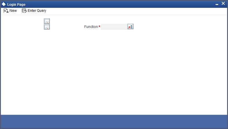

You can get accounting entries reversed or confirm for the overdrawn account using the ‘Intra Day Batch Start’ screen. You can invoke this screen by typing ‘BADIDBAT’ in the field at the top right corner of the Application tool bar and clicking the adjoining arrow button.
Specify the following information.
Function
Specify ‘CSREFQPR’ or choose this value from the adjoining option list.
Click ‘OK’ button to run the batch.
