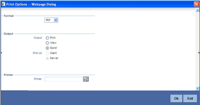

You can indicate preferences to print a report, while generating a report; however, the preferences are general.
The following are the common preferences you can maintain to print a report:
Format
Select the format in which you want the report to be generated from the options provided in the drop-down list. The following options are available:
Output
Select the output for the report from the options provided. The following options are available:
Printer At
Select location where you wish to print the report from the adjoining drop-down list. This list displays the following values:
Printer
Specify the name of the printer or select it from the option list provided. All the configured printers are displayed in the list.
This is applicable only if you have specified the output as ‘Print’.

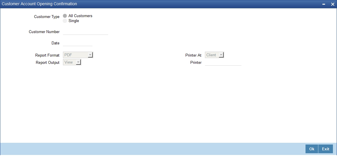

You can generate a report for the customer, confirming that his / her account with the bank has been successfully opened. This report contains the following details:
You can generate the Customer Account Opening Confirmation report for one customer or all the customers at once, as of a specific date. To generate the report, invoke ‘Customer Account Opening Confirmation’ screen.
You can invoke this screen by typing ‘CSRPACCO’ in the field at the top right corner of the Application tool bar and click on the adjoining arrow button.
The screen is as shown below:
Customer Report
You can generate customer account opening confirmation report for one or all the customers. Indicate your choice here. If you select ‘Single Customer’, you have to specify the customer number in the space provided.
Customer Number
If you wish to generate a report specific to one customer, specify the customer number. The option list displays all valid customer numbers maintained in the system. Select the appropriate one.
Date
Specify the date as of which you want to generate the report.
Once you have set the preferences, click ‘OK’ button. The system displays the print option screen, where you can set your preferences as to viewing and printing the report.

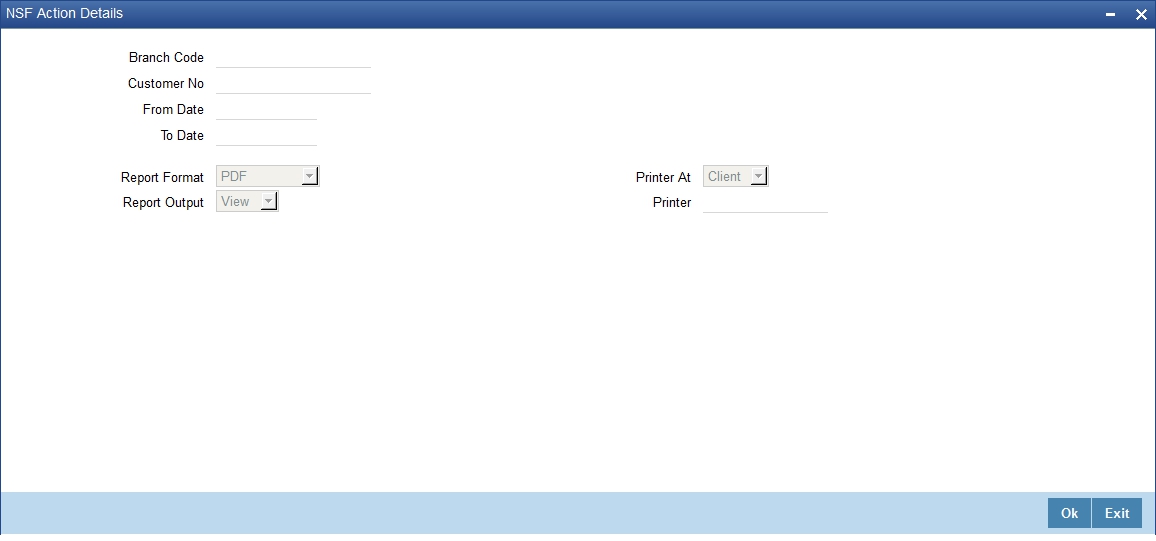

You can generate NSF report to list the returned cheque details. You can invoke ‘Cheque return Data Over Counter’ screen by typing ‘STRNSFC’ in the field at the top right corner of the Application tool bar and clicking on the adjoining arrow button.
Specify the following here:
Branch Code
Select the transaction branch of the float extension from the adjoining option list.
From Date
Indicate the date from which transactions are extended. The system defaults current date. From Date should be lesser than or equal to ‘To Date’.
To Date
Indicate the date to which the transactions are extended. The system defaults current date. To Date should be lesser than or greater to ‘From Date’

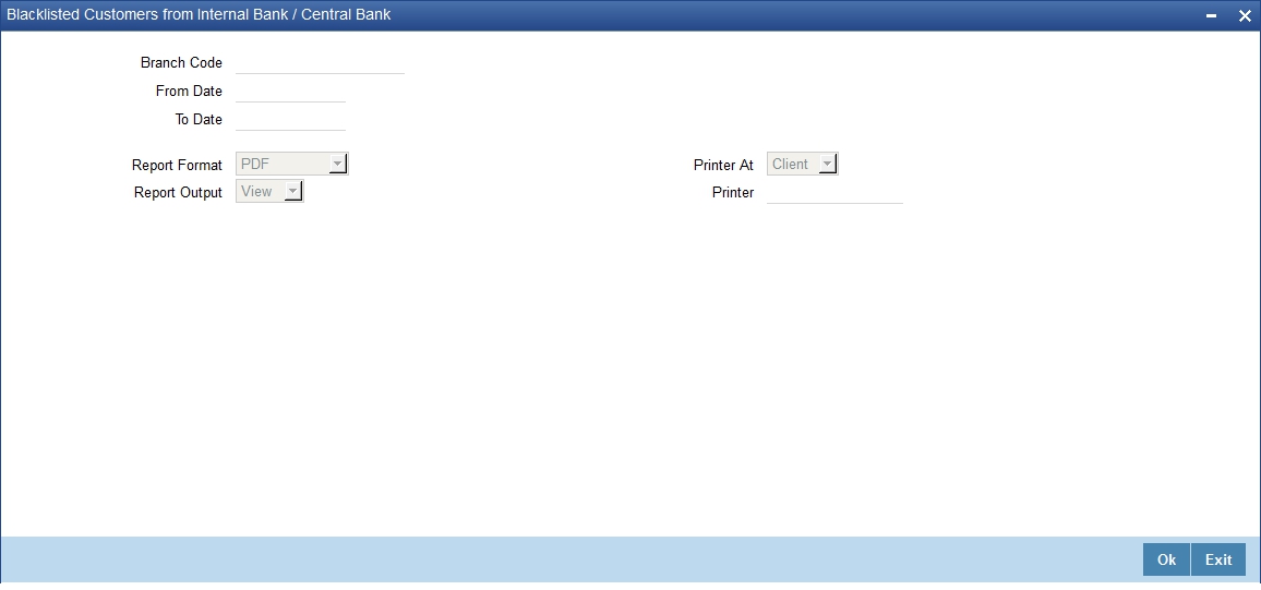

You can generate a report for blacklisted customers from internal banks and agencies. To invoke ‘Blacklisted Customers from Internal Bank’ screen, type ‘STRNSFBC’ in the field at the top right corner of the Application tool bar and click the adjoining arrow button.
Branch Code
From Date
To Date
Report Format
Select the format in which you need to generate the report from the adjoining drop-down list. This list displays the following values:
Report Output
Select the report output in which you need to generate the report from the adjoining drop-down list. This list displays the following values:
PrinterAt
Printer
Select printer using which you wish to print the report from the adjoining option list.
The contents of the report are discussed under the following heads:
Header
The header carries the Branch Code, Blacklisted Type, Application Date.
Body of the Report
Field Name |
Description |
Cust No |
Indicates the customer identification number of the customer who is marked as blacklisted customer in central bank / internal bank |
A/c No |
Indicates the primary account no of the customer who is marked as blacklisted customer |
Brn Code |
Indicates the branch of the customer account |
NSF Level |
Indicates the current NSF level for the customer |
Description |
Indicates the NSF level description |
IB Status |
Indicates the Internal blacklist status, |
IB Status Desc |
Indicates the description for the internal blacklist |
IB Eff Date |
Indicates the effective date from which the customer is marked as internally blacklisted customer |
IB ExpDate |
Indicates the effective date till which the customer is marked as internally blacklisted customer |
CB Status |
Indicates the central bank blacklist status of the customer |
CB Status Desc |
Indicates the description for the central bank blacklist status |
CB Eff Date |
Indicates the effective date from which the customer is marked as central bank blacklist status |
CB Exp Date |
Indicates the effective date till which the customer is marked as central bank blacklist status |
You can generate a report for blacklisted customers from central bank or agencies. You can invoke ‘Blacklisted Customers from Central Bank’ screen by typing ‘STRNSFCB’ in the field at the top right corner of the Application tool bar and clicking on the adjoining arrow button.
Branch Code
From Date
To Date
Indicate the date to which the transactions are extended. The system defaults current date. To Date should be lesser than or greater to ‘From Date’.
Report Format
Report Output
PrinterAt
Printer
Header
Field Name |
Description |
Customer No |
Indicates the customer identification number of the customer who is marked as blacklisted customer in central bank |
Branch Code |
Account No |
Indicates the customer account number |
NSF Level |
NSF Level Description |
Account No |
IB Status |
IB Status Description |

You can generate a report to list the actions which are triggered during the NSF status change. You can invoke ‘NSF Action Details’ screen by typing ‘STRNSACT’ in the field at the top right corner of the Application tool bar and clicking on the adjoining arrow button.
Branch Code
Customer No
Specify a valid customer number for which you want to generate the report from the adjoining option list.
From Date
Indicate the date from which transactions are extended. The system defaults current date. From Date should be lesser than or equal to 'To Date'.
To Date
Indicate the date to which the transactions are extended. The system defaults current date. To Date should be lesser than or greater to 'From Date'
Report Format
Report Output
PrinterAt
Printer

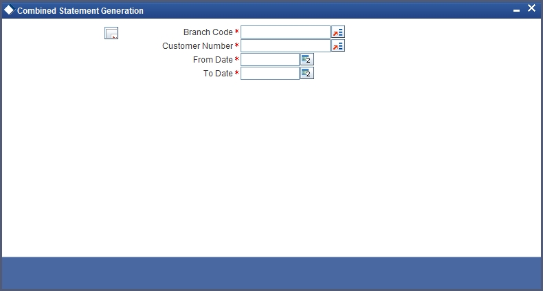

This report is an ad-hoc combined statement of accounts for a customer, generated for a particular period. This report is grouped account class wise. This report helps in providing a single statement to the customers who own multiple accounts.
You can invoke ‘Statement of Combined Generation’ screen by typing ‘CSRCSTAD’ in the field at the top right corner of the Application tool bar and clicking on the adjoining arrow button.
Specify the following details here:
Branch Code
Select the branch code from the adjoining option-list. The list displays all valid branch codes.
Customer No
Select the customer number from the adjoining option-list. This list displays all valid customers maintained in the system.
From Date
Select the From date for statement generation. By default the current application date is displayed here.
To Date
Select the To date for statement generation. By default the current application date is displayed here.
Click ‘OK’ button to generate the report. Click ‘Exit’ to return to the Reports Browser.

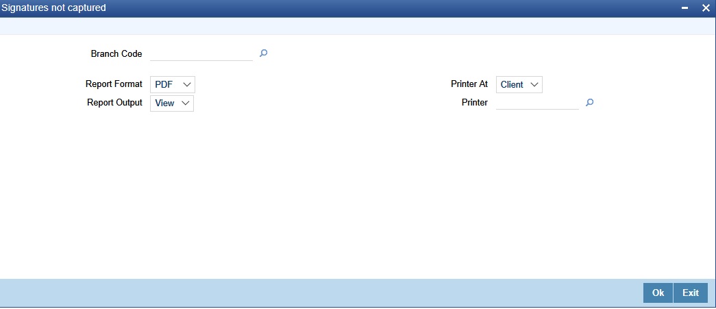

This is an exception report listing all the customers, of a specified branch, whose signatures have not yet been captured in the system.
While opening accounts, customer's signature/photographs/thumb impression are captured and linked to the account. This facilitates the signature verification in the system at the time of making payment. Branches can generate this ad-hoc report, and capture the missing signature in the system.
You can invoke ‘Signatures not Captured’ screen by typing ‘CSRSNREP’ in the field at the top right corner of the Application tool bar and clicking on the adjoining arrow button.
Branch Code

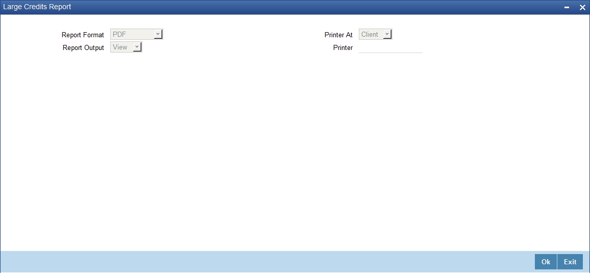

You can invoke 'Large Credits Report' screen by typing 'CSRCRDR' in the field at the top right corner of the Application tool bar and clicking on the adjoining arrow button.

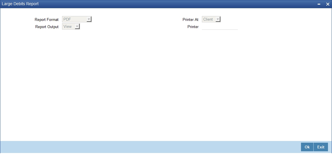

You can invoke 'Large Debits Report' screen by typing 'CSRDEBR' in the field at the top right corner of the Application tool bar and clicking on the adjoining arrow button.

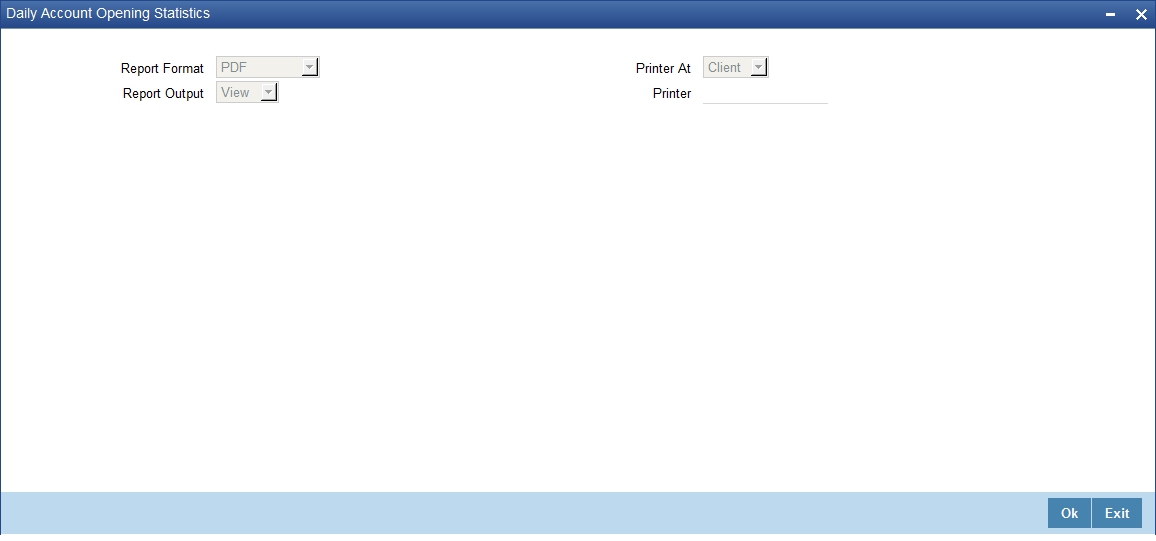

You can invoke 'Daily Account Opening Statistics Report' screen by typing 'CSRDLACC' in the field at the top right corner of the Application tool bar and clicking on the adjoining arrow button.

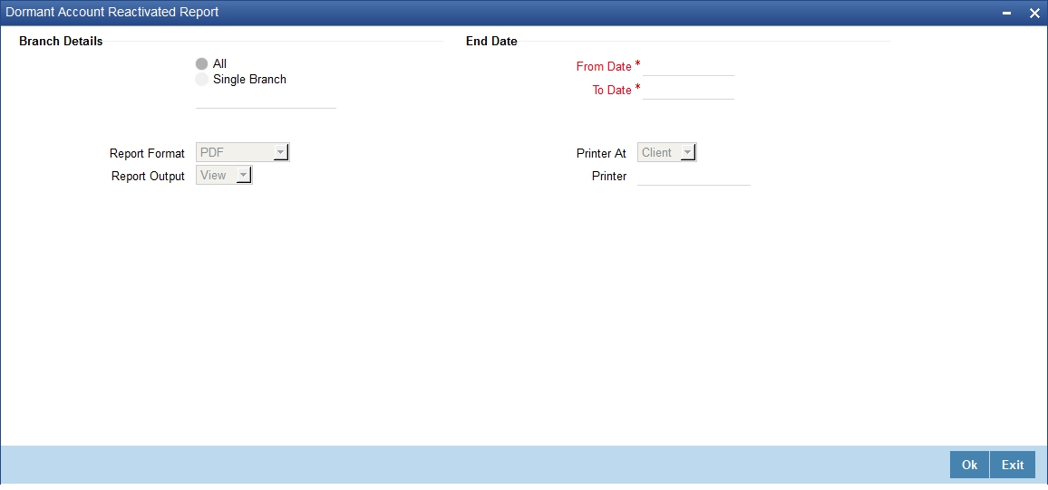

You can invoke 'Dormant Account Reactivated Report' screen by typing 'CSRDRMAC' in the field at the top right corner of the Application tool bar and clicking on the adjoining arrow button.
Branch Code
You can generate this report for all the branches or a single branch alone. You can indicate the branch for which the report is being generated using the following options:
From Date
Specify a valid date from when you wish to generate the report from the adjoining calendar.
To Date
Specify a valid date till when you wish to generate the report from the adjoining calendar.
The parameters specified while generating the report are printed at the beginning of the report. Other content displayed in the report is as follows:

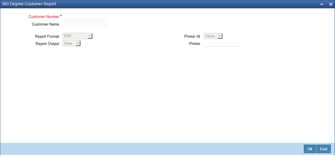

The 360 Degree Customer report provides 360 Degree Customer details. You can invoke the screen by typing 'STRCUSRP' in the field at the top right corner of the Application tool bar and click on the adjoining arrow button.
You can specify the following parameters:
Customer Number
Customer Name
System defaults the customer name of the selected customer number.

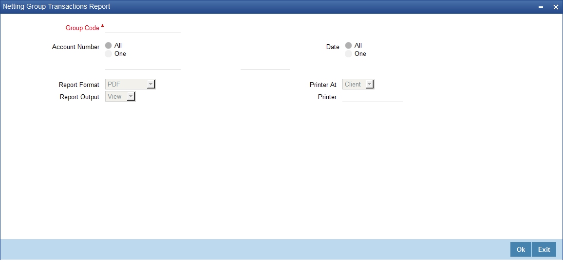

The Netting Group Transaction report provides netting group transaction details. You can invoke the screen by typing 'STRGRNET' in the field at the top right corner of the Application tool bar and click on the adjoining arrow button.
Group Code
Specify a valid group code for which you want to generate the report from the adjoining option list.
Account Number
You can generate the report based on the following account number criteria. The following options are available for section:
Specify a valid account number for which you want to generate the report from the adjoining option list, if you have selected 'One'.
Date
You can generate the report based on the following date criteria. The following options are available for section:
Specify a valid date for which you want to generate the report from the adjoining option list, if you have selected 'One'.

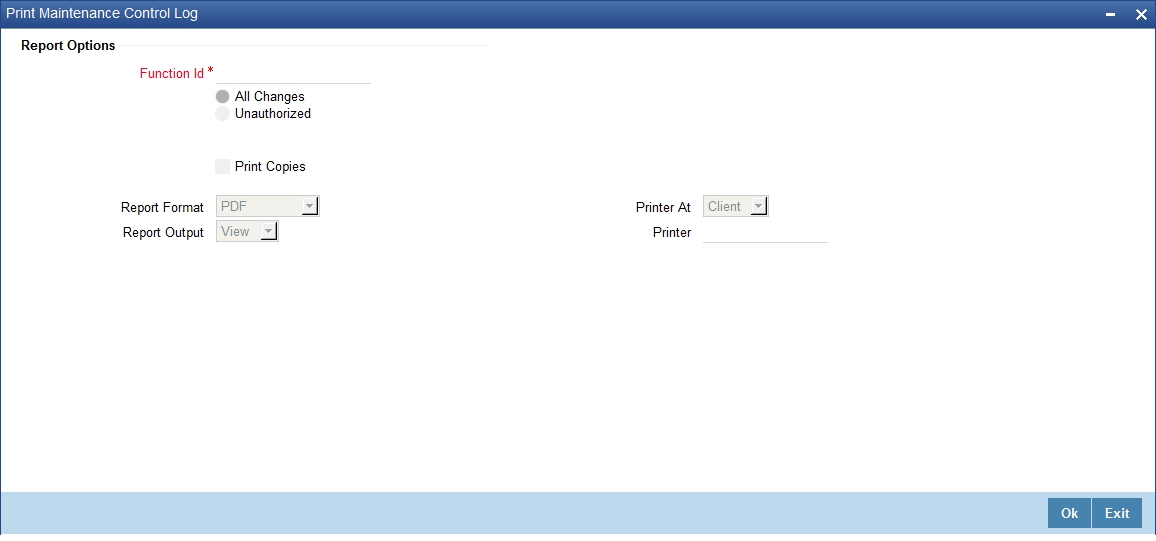

The Print Maintenance Control Log report provides print maintenance control log details. You can invoke the screen by typing 'STRMSMLG' in the field at the top right corner of the Application tool bar and click on the adjoining arrow button.
Report Options
Function ID
Specify a valid Function ID for which you want to generate the report from the adjoining option list.
You can generate the report based on the following change criteria. The following options are available for section:
Print Copies
Check this box if you wish to print copies of the report.
