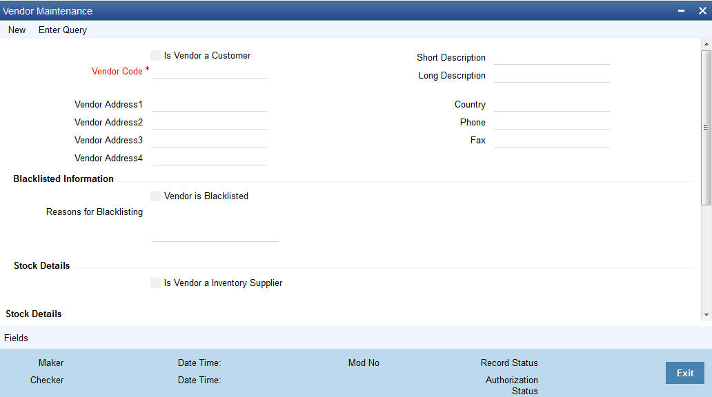

You can maintain the details of all the vendors with whom you deal in the ‘Vendor Maintenance’ screen. You can invoke this screen by typing ‘’XPDVNDMT’ in the field at the top right corner of the Application tool bar and clicking the adjoining arrow button.
In addition to other details, you can capture the following details for a vendor:
Vendor Code
If the vendor is a customer then you can select the vendor code by clicking on the option list. For vendors who are customers of the bank the option list will display the list of CIF values. For vendors who are not customers of the bank you can enter the vendor code in this field.
Credit Account
Select the credit account or GL for the payments to be made by clicking on the option list. This list will display the list of account and GLs. For vendors who are not customers of the bank, any account or GL can be chosen. There will be no validation done against this selection.
Branch Code
The branch, in which the chosen account resides, is displayed here.
Payment Mode
Select the mode of payment from the drop-down list. The options for selection are:
Note
By default, the value will be ‘None’.
For details about the other fields in this screen, refer the section ‘Maintaining Vendor’ in the chapter ‘Maintaining Documents and Vendors’ in the Expense Processing User Manual.

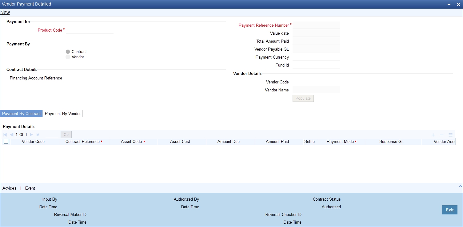

Vendor payment for an account can be made before initiation. You can do this in Oracle FLEXCUBE through the ‘Vendor Payment Detailed’ screen. You can invoke this screen by typing ‘VPDPYMNT’ in the field at the top right corner of the Application tool bar and clicking the adjoining arrow button.
You can specify the following details:
Product Code
You can select the product code of the payment from the option list. All the contracts displayed under the ‘Payment Details’ will be of same product code.
Payment By
Indicate whether the payment should be made for a single vendor across multiple contracts or for multiple vendors linked to a single contract by choosing the appropriate option:
Payment Reference Number
Here the payment reference number automatically gets defaulted for the current payment.
Fund Identification
You can select the fund id of the payment from the option list. All the contracts displayed in the ‘Payment Details’ will be of Fund Id. If the fund Id is not associated with the payment then fund Id should not be entered.
Payment Currency
You can select the currency of the payment from the option list. All the contracts displayed under the ‘Payment Details’ will be of same currency.
Value Date
The system displays the value date of the payment.
Account Number
If you have indicated that payment should be made for a single contract, you will have to specify the account number of the contract for which vendor payment has to be made. The adjoining option list displays all valid Islamic Financing accounts maintained in the system for the given product code and currency combination. You can select the appropriate one.
Vendor Payable GL
The system displays the vendor payable GL.
Click ‘Populate’ button to query records based on the ‘Payment By’ criterion. If you have opted for making a payment to a single vendor linked to multiple contracts, the system will fetch all contracts along with the asset details for the given ‘Vendor Id’, ‘Product Code’ and ‘Payment Currency’ combination. It will display the result in the ‘Payment Details’ section.
If you have opted for making a payment for a single contract having multiple vendors linked to it, the system will fetch all vendor details along with the asset details for the given ‘Account Number’, ‘Product Code’ and ‘Payment Currency’. It will display the result in the ‘Payment Details’ section.
Total Amount Paid
The total amount paid to the vendor will get defaulted here only after saving the record.
Financing Account Reference
Specify the financing account reference number. Alternatively, you can select financing account reference number from the option list. The list displays all valid financing account reference number maintained in the system.
Specify the following details if you have opted to make payment for a single vendor across multiple contracts.
Vendor Code
Specify the vendor Id for the payment. The adjoining option list displays all valid vendor IDs maintained in the system. You can select the appropriate one.
Vendor Name
Once you specify the Vendor Code, the corresponding vendor name is displayed here.
Click ‘Payment by Contract’ tab in ‘Vendor Payment Detailed’ screen..
The following details are captured:
Settle
Check this box to make the payment to one vendor at a time.
Payment Mode
Select mode of payment from the drop-down list. The list displays the following values:
Suspense GL
Specify the suspense GL. Alternatively, you can select suspense GL from the option list. The list displays all valid suspense GL maintained in the system.
Vendor Account
Specify the vendor account number. Alternatively, you can select vendor account number from the option list. The list displays all valid vendor account number maintained in the system.
Account Branch
The system displays the branch code.
Account Description
The system displays the account description.
Account Currency
The system displays the currency code.
Transaction Code
Specify the transaction code to be used for making the payment. Alternatively, you can select transaction code from the option list. The list displays all transaction code maintained in the system.
Instrument Type
Select the type of instrument from the drop-down list. The list displays the following values:
Payable Bank
Specify the payable bank code. Alternatively, you can select payable bank code from the option list. The list displays values from the ‘Bankers Cheque or Demand Draft Issuer Bank Details’ (DEDDRISB) screen.
Payable Branch
Specify the payable branch code. Alternatively, you can select payable branch code from the option list. The list displays the values from the Bankers Cheque or Demand Draft Issuer Bank Details’ (DEDDRISB) screen.
Instrument Number
The system displays the instrument number.
The Instrument number will be displayed only after Authorization of vendor payment.
Instrument Transaction Reference
The system displays instrument transaction reference number.
The Instrument Transaction Reference will be displayed only after Authorization of vendor payment.
When the settlement is done through Vendor option, if there are multiple contracts, the system will make the payment through a single instrument. If you want to have multiple instruments for multiple contracts, then the system will book different Vendor Payment contracts.

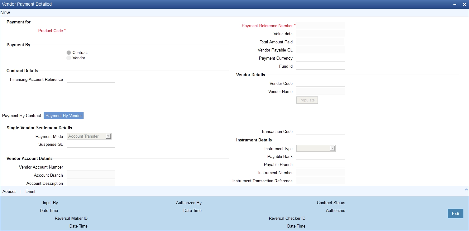

Click ’Payment by Vendor’ tab in ‘Vendor Payment Detailed’ screen to specify the vendor details.
Payment Mode
Select mode of payment for vendor from the drop-down list. The list displays the following values:
If you have selected ‘Payment Mode’ field as ‘Instrument’, then ‘Instrument Type’ field is mandatory.
If you have selected ‘Payment Mode’ field as ‘Account Transfer’, then the fields under Vendor Account Details section will be mandatory and the fields under Instrument Details section will not be applicable.
If you have selected ‘Payment Mode’ field as ‘Onward Remittance’, then only ‘Suspense GL’ field is applicable. The fields under Vendor Account Details and Instrument Details section will not be applicable.
Suspense GL
Specify the suspense GL for vendor. Alternatively, you can select suspense GL from the option list. The list displays all valid suspense GL maintained in the system.
Vendor Account Number
Specify the vendor account number. Alternatively, you can select vendor account number from the option list. The list displays all valid account number maintained in the system.
Account Branch
Account Description
Account Currency
Instrument Type
If you have selected ‘Instrument Type’ field as ‘Demand Draft’, then ‘Payable Bank’ and ‘Payable Branch’ fields will be mandatory.
Payable Bank
Specify the payable bank code, Alternatively, you can select payable bank code from the option list. The list displays .values from the ‘Bankers Cheque or Demand Draft Issuer Bank Details’ (DEDDRISB) screen.
Payable Branch
Instrument Number
The system displays the instrument number allocated at the time of vendor payment authorization
Vendor Code
The system displays the vendor code.
Contract Reference
The system displays the contract reference number.
Asset Code
The system displays the asset code.
Amount Due
The system displays the amount due.
Amount Paid
Specify the amount paid.
Settle
If you have selected ‘Payment Mode’ as ‘Instrument’, then you need to specify ‘Instrument Type’, ‘Instrument Number’, ‘Payable Bank’, ‘Payable Branch’ fields.
While saving the Vendor payment transaction with payment mode as instrument, the system will generate the following Accounting entries for the VPAY event for payment mode Instrument:
Dr/Cr |
Accounting GL |

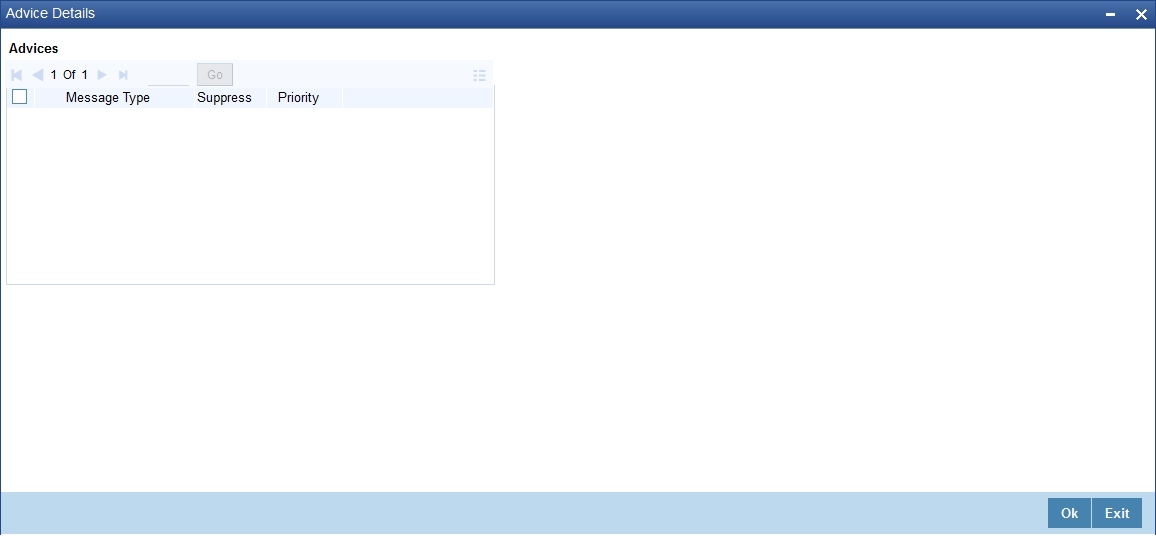

Click on Advices’ button to invoke ‘Advice Details’ screen.
The system displays the following details:

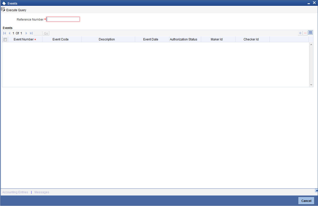

You can view the event details by clicking ‘Event’ button in the ’Vendor Payment detailed’ screen. The event VPAY is triggered for vendor payment and in case of vendor payment reversal the event VPRV is triggered. By clicking ’Advices’ button Vendor payment credit advice gets attached and the advice will be generated as part of the VPAY event.
Reference Number
Specify the reference number.
The system displays the following events:

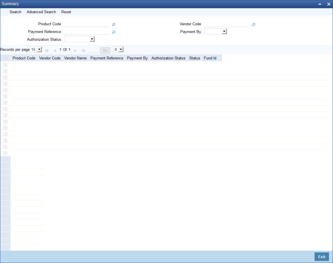

You can view vendor payment details using ‘Vendor Payment Summary’ screen. You can invoke the ‘Account Summary’ screen by typing ‘VPSPYMNT’ in the field at the top right corner of the Application tool bar and clicking the adjoining arrow button.
You can query a record using the following options:
Click ‘Search’ button. The system identifies all records satisfying the specified criteria and displays the following details for each one of them:
