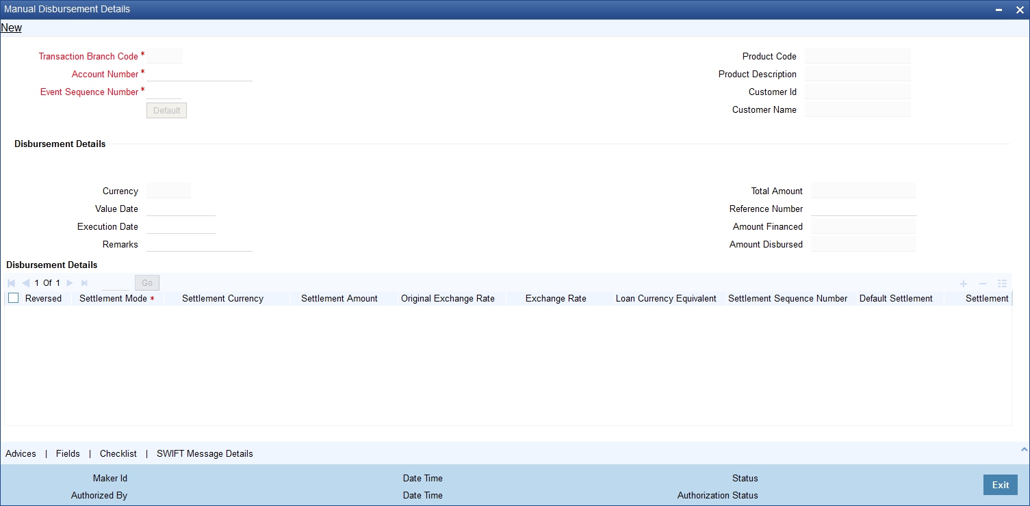

You can initiate a manual disbursement through the ‘Manual disbursement’ screen You can invoke this screen by typing ‘CLDMNDSB’ in the field at the top right corner of the Application tool bar and clicking on the adjoining arrow button.
To begin the disbursement, click on the New icon in the toolbar of the screen. Enter the account number and click the ‘Default’ button. The system defaults the details based on product definition and the account maintained by the bank for the account. You can modify the relevant details.
Transaction Branch Code
The code of the login/sign-on branch is displayed here. However, you can select a different branch from the option list provided. It is the branch where the loan account of the customer resides.
Account Number
Select the Loan Account of the customer to which the disbursement is made. All valid accounts are available in the option list. Select the appropriate one from this list.
Event Sequence Number
The system displays the event sequence number of the current disbursement transaction..
Product Code
The system displays product code associated with the specified account number.
Product Description
The system displays description of the displayed product code.
Customer ID
The system displays ID of the customer holding the specified account number.
Customer Name
The system displays name of the displayed customer ID.
The following disbursement details have to be captured in the ‘Disbursement Details’ section of the screen:
Currency
The system displays the disbursement currency
Value Date
This is the date when the credit entry (for the disbursement amount) is posted to the Cr Settlement Bridge. The current system date is displayed here.
Execution Date
This is the date on which the disbursement is booked in the system. The current system date is displayed here. You may change the date to a date in the future before the maturity date of the loan.
Remarks
Capture any additional information about the disbursements, if required.
Total Amount
This displays the sum total of the amount disbursed across the various settlement modes. It gets incremented by the amount settled.

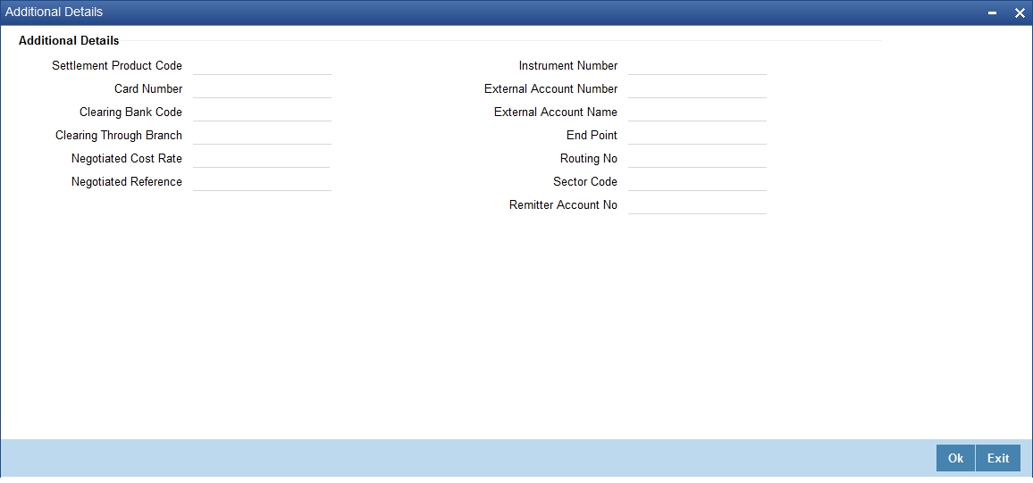

You can capture the additional settlement details by clicking the ‘Additional Settlement Details’ button under disbursement details.

You can capture the additional settlement details by clicking the ‘Additional Settlement Details’ button under charge details..

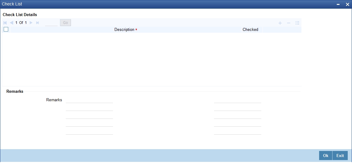

To every online event, you can associate check list items through the ‘Event Checklist’ screen. To view the check list items associated with the ‘Disbursement’ event (DSBR), click on the ‘Checklist’ button.
This screen displays the check list items for DSBR. All check list items have to be verified for successful disbursal of the loan. To do this, check the ‘Verified’ box against each check list item.
You may also capture any additional information/remarks, if required.
Click ‘OK’ button to Save and return to the ‘Manual disbursement’ screen.

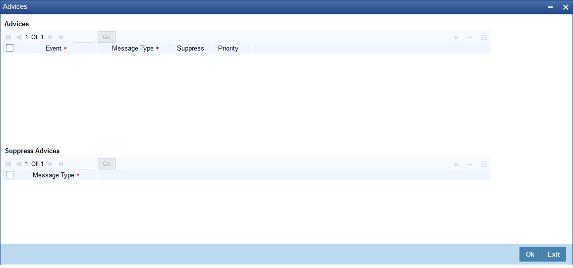

You can view the advices defaulted which also includes the Payment Message in the ‘Advices’ screen. To invoke this screen, click ‘Advices’ button on the ‘Manual Disbursement’ screen.
You can opt to suppress the Payment Message defaulted in case you do not need a credit through swift message.
The defaulted details can be overridden at this stage and if the settlement mode is changed to anything other than CASA, the swift message is automatically suppressed.
System automatically suppresses the payment message under the following conditions:

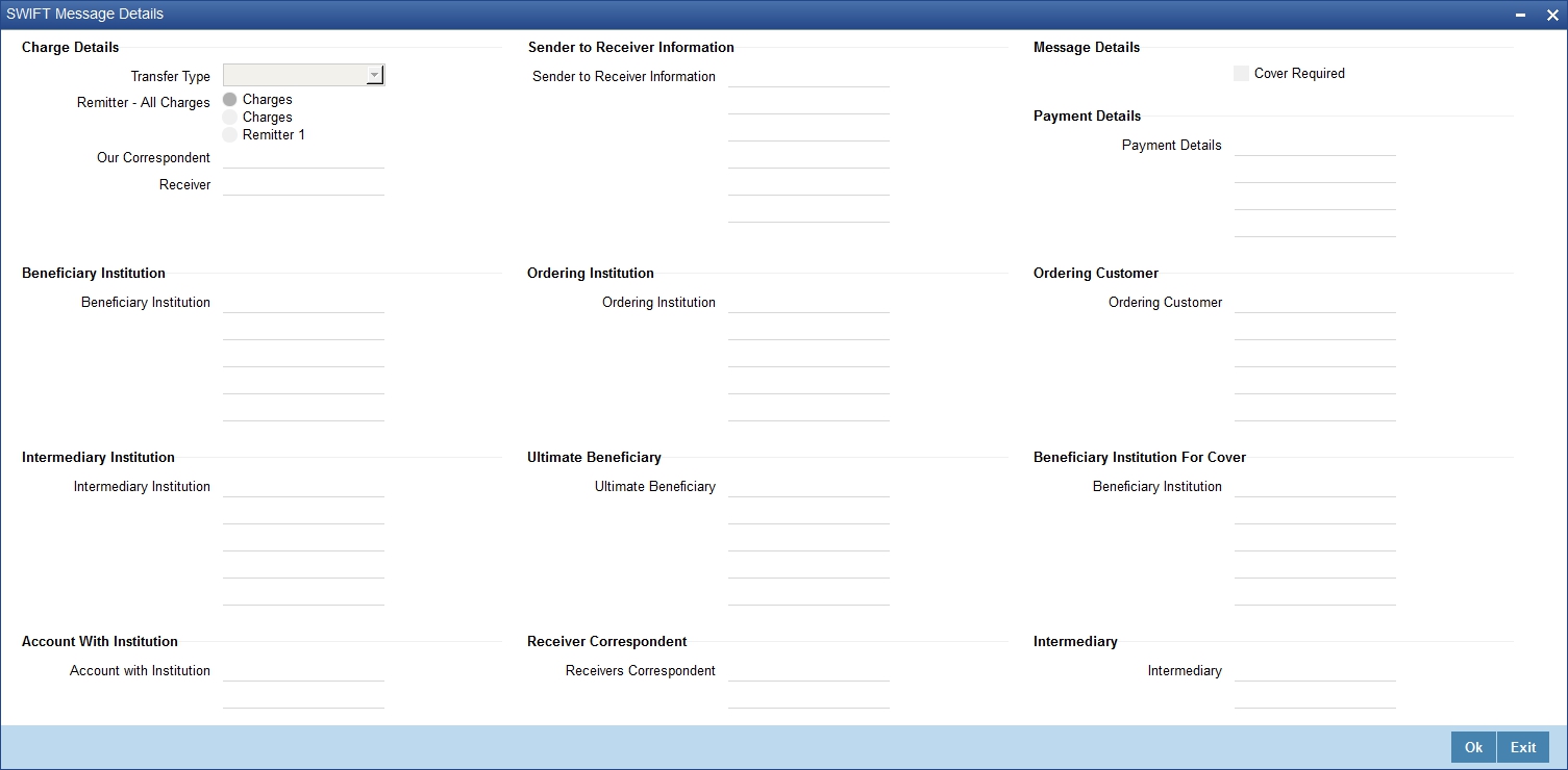

If the Transfer Type is chosen as blank i.e, neither Customer Transfer nor Bank Transfer and if the Receiver is a bank and the credit settlement account is a current account then the PAYMENT_MESSAGE becomes CREDIT_ADVICE by Swift(MT910).
The swift message details are picked up from the Settlement Instructions maintenance and are displayed in the ‘Swift’ screen. To invoke this screen, click ‘Swift Message Details’ button on the ‘Manual Disbursement’ screen.
For more details on Swift message related details refer section ‘Capturing Swift Message Details’ in the chapter ‘Capturing Additional Details for a Loan’ in this User Manual.

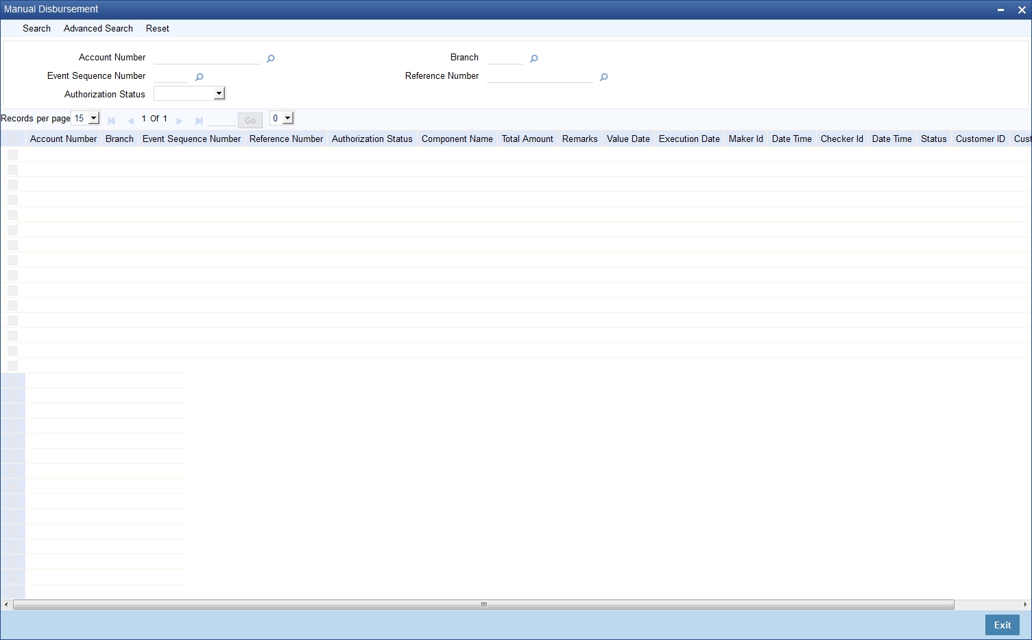

You can view the LC contract using ‘Manual disbursement’ screen. To invoke this screen, type ‘CLSMNDSB’ in the field at the top right corner of the Application tool bar and click the adjoining arrow button.
You can click ‘Search’ button to view all the pending functions. However, you can to filter your search based on any of the following criteria:
Account Number
Select the account number from the option list.
Select the event sequence number from the option list.
Authorized
Select the authorization status of the contract from the drop-down list.
Branch
Select the branch code for which you want to check the contract from the option list.
Reference Number
Select the reference number from the option list.
When you click ‘Search’ button the records matching the specified search criteria are displayed. For each record fetched by the system based on your query criteria, the following details are displayed:
Click ‘Advanced Search’ to display the screen below:
You can query a contract based on any of the following details:

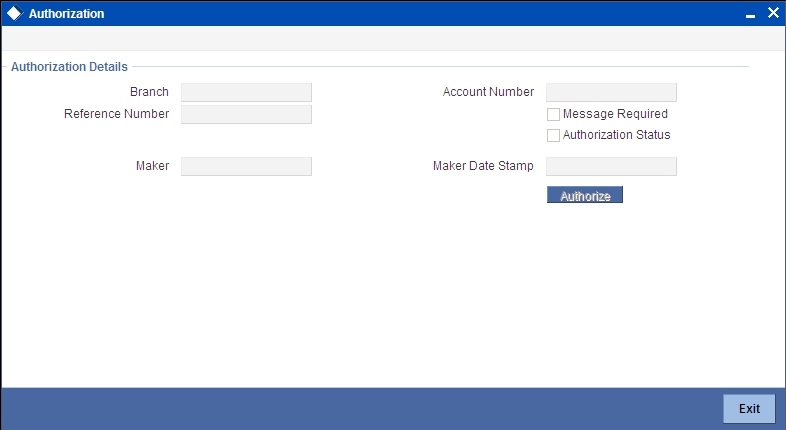

To authorize the manual disbursement, click Authorize icon on the Application toolbar. The account authorization screen is displayed.
The Branch and Account number is defaulted and the Xref number is generated by the system. The following detail needs to be selected as required:
Message Generation
Check this box if you want swift messages to be generatedt either for the customer transfer or the bank transfer along with a cover. The generated message can be biewed in the messages browser. Even if the box is left unchecked you can go to messages browser at a later point of time and generate the message.
If the message generation fails for some reason, the account is authorized and you have to go to the browser to manually generate the swift message.
All other advices related to DSBR event are not generated at this point and you need to go to the message browser to do the same.
After the swift message has been generated, if the loan account or the manual disbursement is reversed, no message is sent from CL.
