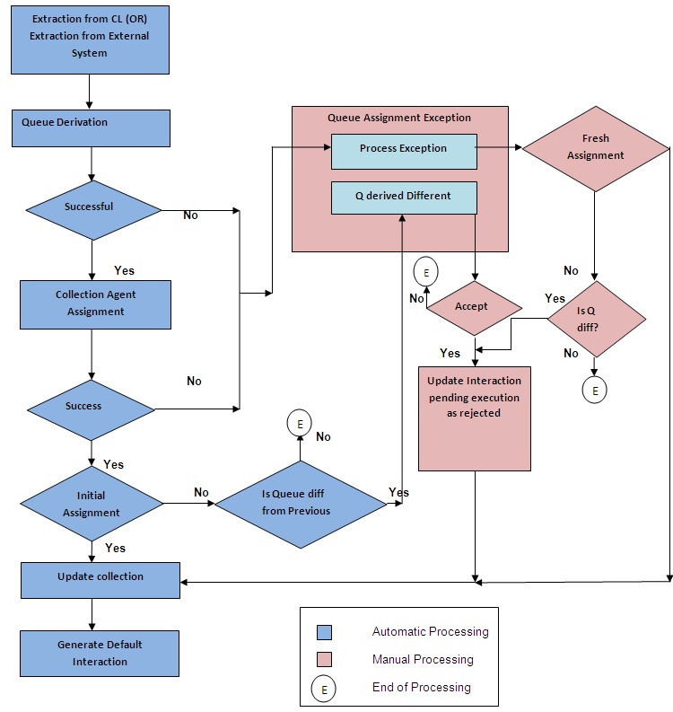

The tasks which will be carried out by the Batch in connection with the Collection Process is explained in the flowchart below.
Loan accounts with amount dues are extracted to CN (Collection) module. While processing the data the details required for the SDE’s mentioned under the Queue derivation logic are extracted and made available for further processing.
