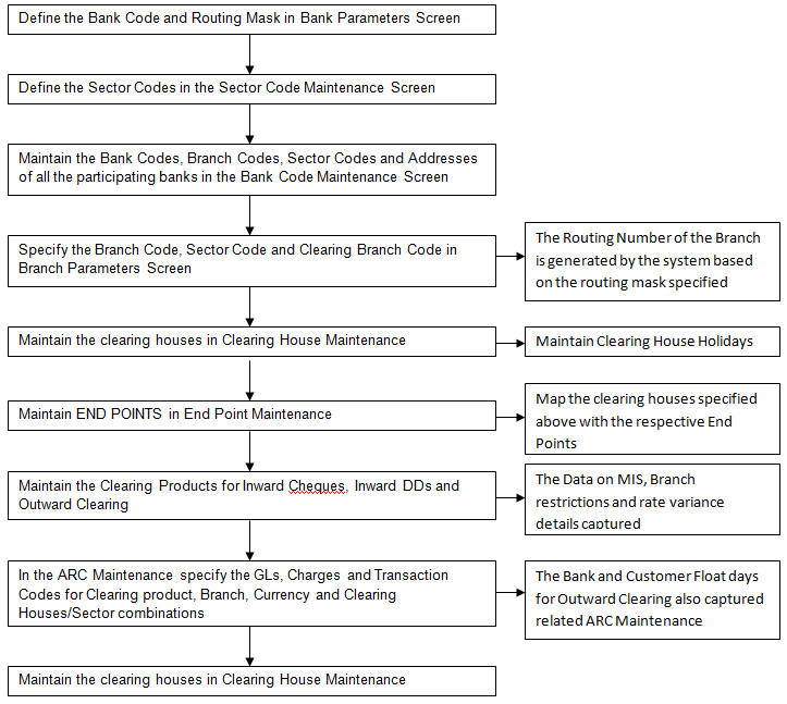

In order to process clearing transactions automatically, you need to maintain some information in Oracle FLEXCUBE:
Once you set up this information, the appropriate customer and clearing accounts maintained in your bank will automatically be credited or debited, depending on the nature of the transaction.
The sequence is represented diagrammatically as follows:

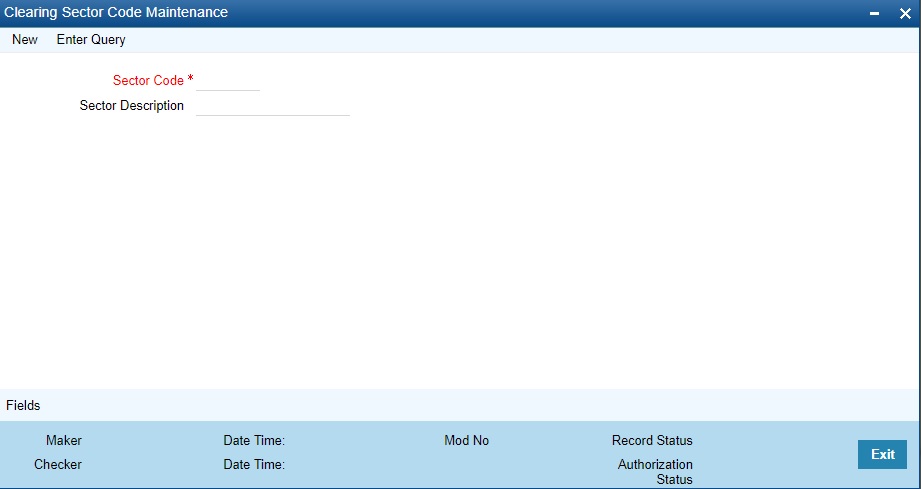

In Oracle FLEXCUBE, you can identify specific geographical areas as ‘sectors’. A sector encompasses the branches of the various banks in the geographical area.
As part of the maintenance required to process clearing transactions in Oracle FLEXCUBE, you need to identify various sectors. You can do this in the ‘Clearing Sector Code Maintenance’ screen. You can invoke this screen by typing ‘STDSECMN’ in the field at the top right corner of the Application tool bar and clicking on the adjoining arrow button.
Identify a sector with a unique code. In the Description field, briefly describe the sector that you are maintaining. With the sector code and description that you enter, you should be able to identify the sector.
Note
The sectors are typically maintained at the Head Office.

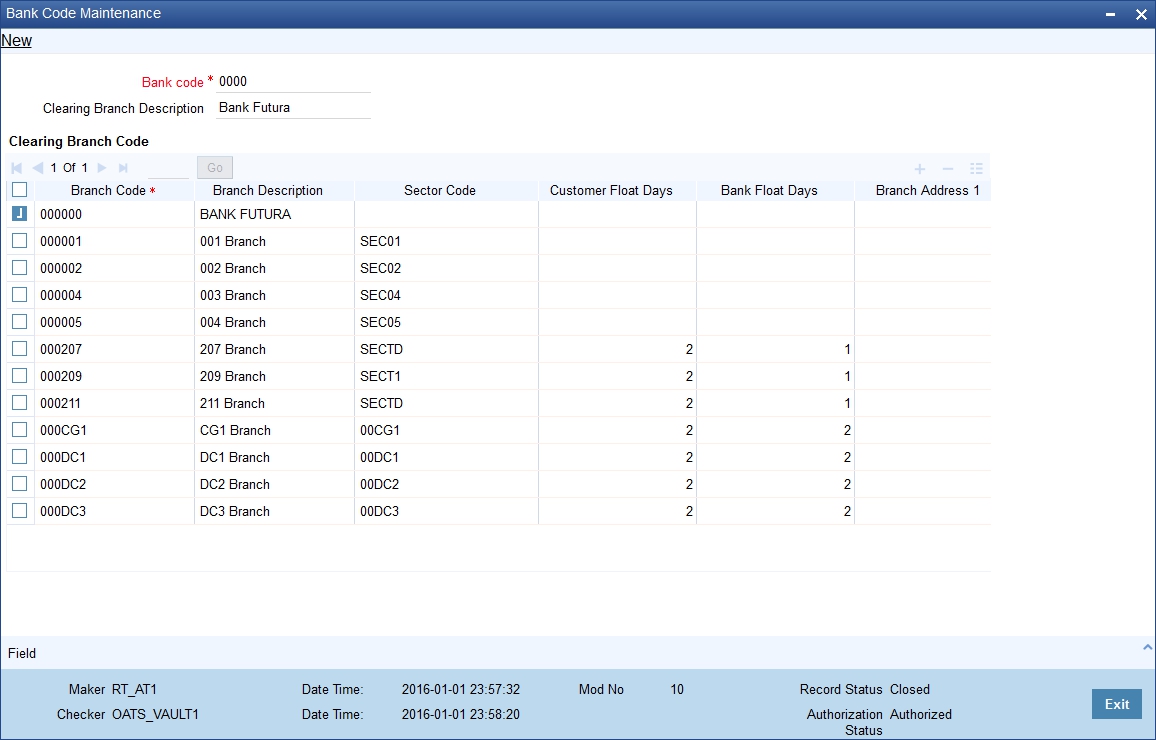

You have to capture clearing details of every bank participating in the Clearing Network in the ‘Clearing Bank Codes Maintenance’ screen. You can invoke this screen by typing ‘DEDBNKCD’ in the field at the top right corner of the Application tool bar and clicking on the adjoining arrow button.
The information you capture in this screen is required to route outward clearing transactions to the appropriate clearing house.
In-house cheque deposit having exceptions or having float days maintained for high value can be initiated using the outward clearing transaction screens.
Every bank participating in the Clearing network is identified with a unique code. In this screen, capture the code of the participating bank, and enter a brief description that will help you easily identify the bank. You also have to capture the following information for every branch of a participating bank:
Country
Specify the country of the bank code. This adjoining option list displays all valid country codes maintained in the system. You can choose the appropriate one.
Note
The country information is captured to enable Mantas to analyze the transactions for possible money laundering activities.
For more details on Mantas, refer 'Mantas' interface document.
You can maintain different Float days for each bank and sector code combination. Subsequently, you can also maintain float days for customers of each bank and sector combination. The float days you define here will be defaulted in the Customer Float Days maintenances screen.
Refer to the Core Entities user manual under section Maintaining Float Days for Outward Clearing Customer Transactions for further details.
The system calculates the value date for the clearing transaction in the following manner:
After you maintain the above details for a branch, click ‘Add’ button to capture the details of the next branch.

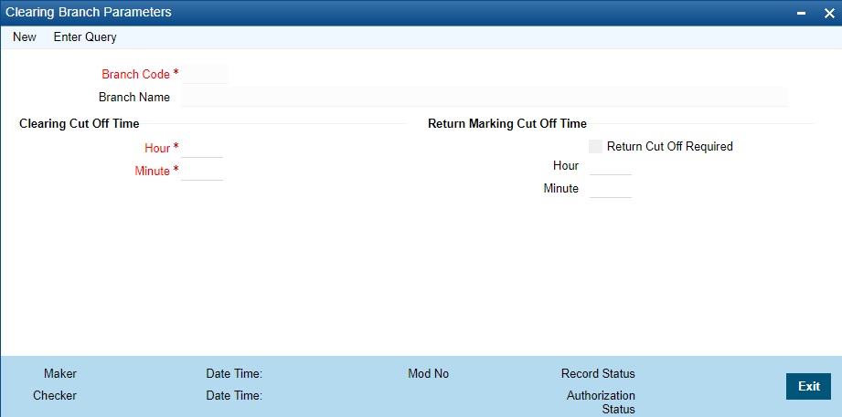

You can maintain the clearing cut-off time for the branch using the ‘Clearing Branch Parameters Maintenance’ screen. You can invoke this screen by typing ‘CGDBRNPM’ in the field at the top right corner of the application tool bar and clicking on the adjoining arrow button.
Branch Code
System displays the current branch code here; however, you can select the branch code from the adjoining option list.
Branch Name
System displays the selected branch name here.
Hour
Specify the clearing hour for the cut-off time in 24 hours clock.
Return Marking Cut-Off time hour is captured in 24 hour format.
Min
Specify the clearing minutes for the cut-off time.
Note
Time specified here will be the daily cut off time for the clearing transactions in the branch.
Transactions input after the specified time, will not be processed on the same day and will take one additional day to arrive at the credit value date; however, you can manually reverse the transaction to process it on the same day.
Hour
Specify hours for the cut-off time of return marking of outward cheque in 24 hours clock.
Minute
Specify minutes for the cut-off time of return marking of outward cheque.
Note
Return marking is allowed in non-clearing branches until the return marking cut-off time before the value date of the outward clearing transaction.

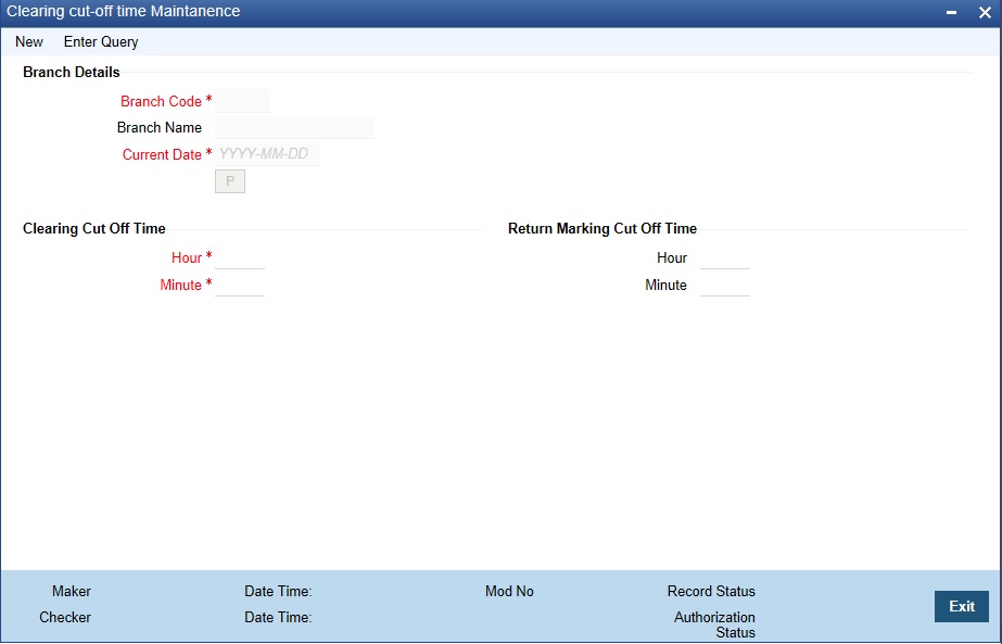

You can maintain the clearing cut-off time for the current day of the branch using the ‘Clearing cut-off time Maintenance’ screen. You can invoke this screen by typing ‘CGDLTCLG’ in the field at the top right corner of the application tool bar and clicking on the adjoining arrow button.
Branch Code
System displays the current branch code here. You can select the branch code from the adjoining option list.
Branch Name
Current Date
System displays the current date here.
Click ‘P’ button to populates the clearing cut off time maintained in the ‘Clearing Branch Parameter’ screen.
Hour
Min
Note
Time specified here will be applicable only for the current day cut off time for the clearing transactions in the branch.
Click ‘P’ button to populate current date, clearing cut-off hour, and Minute maintained in the ‘Clearing Branch Parameters’ screen. If the cut off time has been advanced or extended for the specific day, system will take the cut off time maintained here. If the cut off time is not maintained here, then system considers the cut off time maintained at the branch level.

In non clearing branches return marking is allowed, until the return marking cut-off time and before the value date of the outward clearing transaction.
The outward clearing transactions posted before and on the original cut-off time for the day are processed as normal clearing transactions, while those posted after the original cut-off time for the day would be processed as late clearing transactions.
Value Date of the Clearing Transactions Posted before the Original Cut-Off Time
The customer value date = Current date + customer float days arrived
The bank value date = current date + bank float days arrived
Value Date of the Clearing Transactions Posted after the Original Cut-Off Time
current date + customer float days arrived + bank float days arrived+ additional float day
However; if the cut-off time of any outward clearing transaction is extended or changed, you can execute the clearing cut-off time revision batch, CGBCTREV, which is maintained as Intraday Batch to process the reversal of cut-off time on existing transactions.
Note
The system will not prompt you to execute the batch
When the cut-off time for the day is changed at ‘Cut-off Time Maintenance’ level, the system logs and stores the cut-off time change. CGBCTREV batch is run after the revision of the cut-off time for the day.
Note
Clearing cut-off time revision batch should be run before the new cut-off time. If the cut-off revision batch is run after the new cut-off time, System would not reverse the cut-off for the transactions.
In the CGBCTREV batch, the system will pick up all the late clearing transactions which are processed between original cut-off time and the current cut-off time and reverse the cut-off time for the clearing transaction.
The system will reverse the accounting entries for the original value date and book new accounting entries with new value date.
Note
Cut-off time revision batch would not reverse cut-off time on the transactions which are posted with late clearing product. i.e., with the clearing product with ‘late clearing’ option set. Cut-off time can only be extended and it cannot be set to expired time.
The accounting entries for the original entry with the original value date would be reversed. There would be a new accounting entry with the new value date.

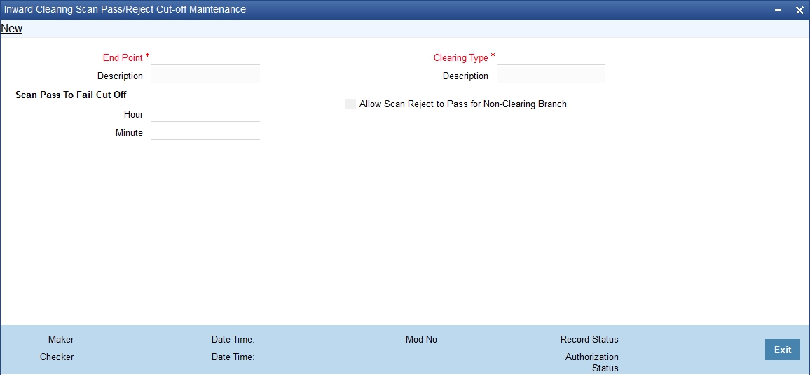

The cut off time for inward clearing can be maintained in the Inward Clearing Scan Pass/Reject cut-off Maintenance screen. You can invoke the ‘Inward Clearing Scan Pass/Reject Cut-off’ screen by typing ‘CGDINWCT’ in the field at the top right corner of the Application tool bar and clicking the adjoining arrow button.
Specify the following here:
End Point
Select the end points from the adjoining option list.
Description
The system defaults the description of the end point chosen.
Clearing Type
Select the inward clearing product type from the adjoining option list.
Description
The system displays the clearing product description.
Hour
Specify the hours of the cutoff time for the scan pass to reject.
Minutes
Specify the minutes of the cutoff time for the scan pass to reject.
Allow Scan reject to pass for Non-Clearing Branch
Check ‘Allow Scan Reject to Pass for Non-Clearing Branch’ to enable the scan reject to pass option (Error/override to success) for non-clearing branches.
Note

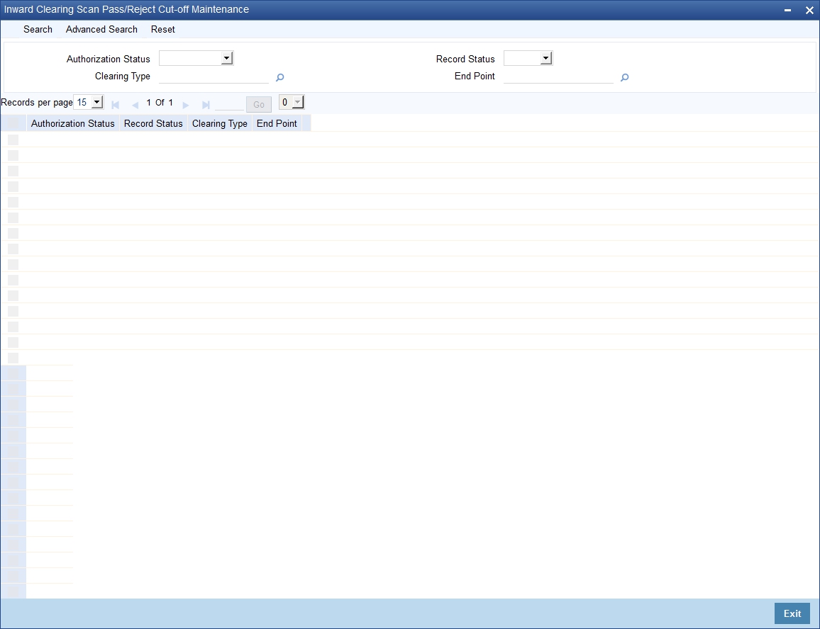

You can view the clearing cutoff scan pass /reject cut off time details in the Inward clearing Scan Pass/Reject cutoff Summary screen. You can invoke this screen by typing ‘CGSINWCT’ in the field at the top right corner of the Application tool bar and clicking the adjoining arrow button.
In the above screen, you can base your queries on any or all of the following parameters and fetch records:
Select any or all of the above parameters for a query and click ‘Search’ button. The records meeting the selected criteria are displayed.
The system displays the following details pertaining to the fetched records:

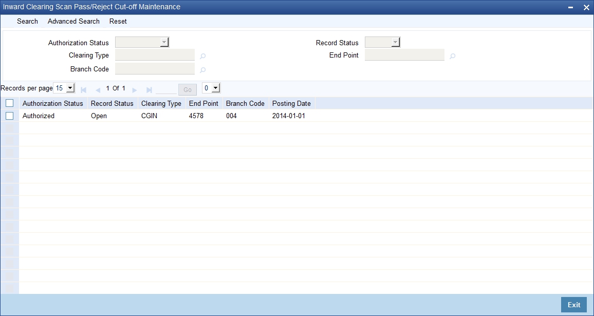

You can view the branch cut-off for inward clearing scan pass /reject in the Inward Clearing Scan Pass/Reject Branch cut-off Summary screen. You can invoke this screen by typing ‘CGSBRNCT’ in the field at the top right corner of the Application tool bar and clicking the adjoining arrow button.
Note

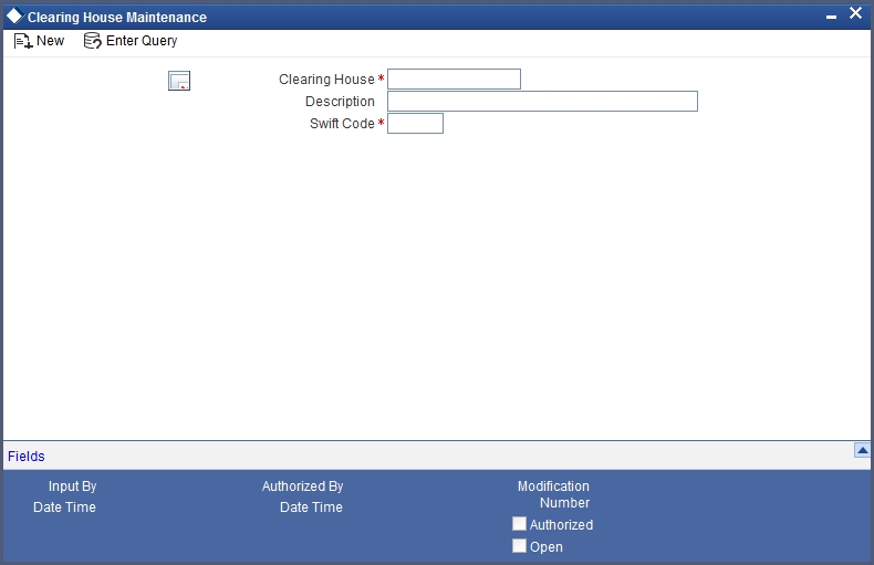

In the ‘Clearing House Maintenance’ screen, invoked from the Application Browser, you have to maintain the clearing houses your bank participates in. You can invoke this screen by typing ‘STDCLDMT’ in the field at the top right corner of the Application tool bar and clicking on the adjoining arrow button.
Identify every Clearing House you participate in with a unique code. In the Description field, briefly capture the details of the Clearing House. The Clearing House Code and Description you enter should help you easily identify a clearing house. Additionally, specify a SWIFT code for the clearing house. In order to process MT306, MT340, MT 360 and MT361 you need to maintain the following codes as SWIFT Codes for the field 29H, 29E and 22B:

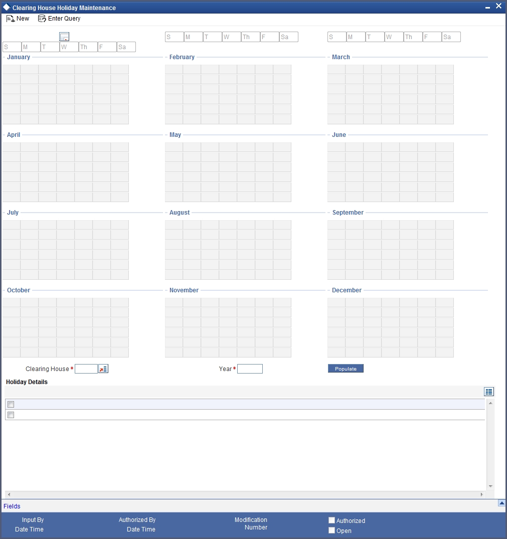

In the Clearing House Holidays Calendar Maintenance screen, invoked from the Application Browser, you can identify the holidays for the various clearing houses maintained at your bank. You can invoke this screen by typing ‘STDCLHOL’ in the field at the top right corner of the Application tool bar and clicking on the adjoining arrow button.
In the Clearing House field, specify the clearing house for which you are maintaining holiday details.
The dates on the calendar are marked in black and red. The dates you mark in black are “working days” and dates you mark in red are “holidays”. Click on a date to change its color.
Note
Clearing Houses and Clearing House Holidays are typically maintained at the Head Office.
Refer the chapter ‘Maintaining Clearing Holidays ‘ in the Core Services User Manual for details about this screen.

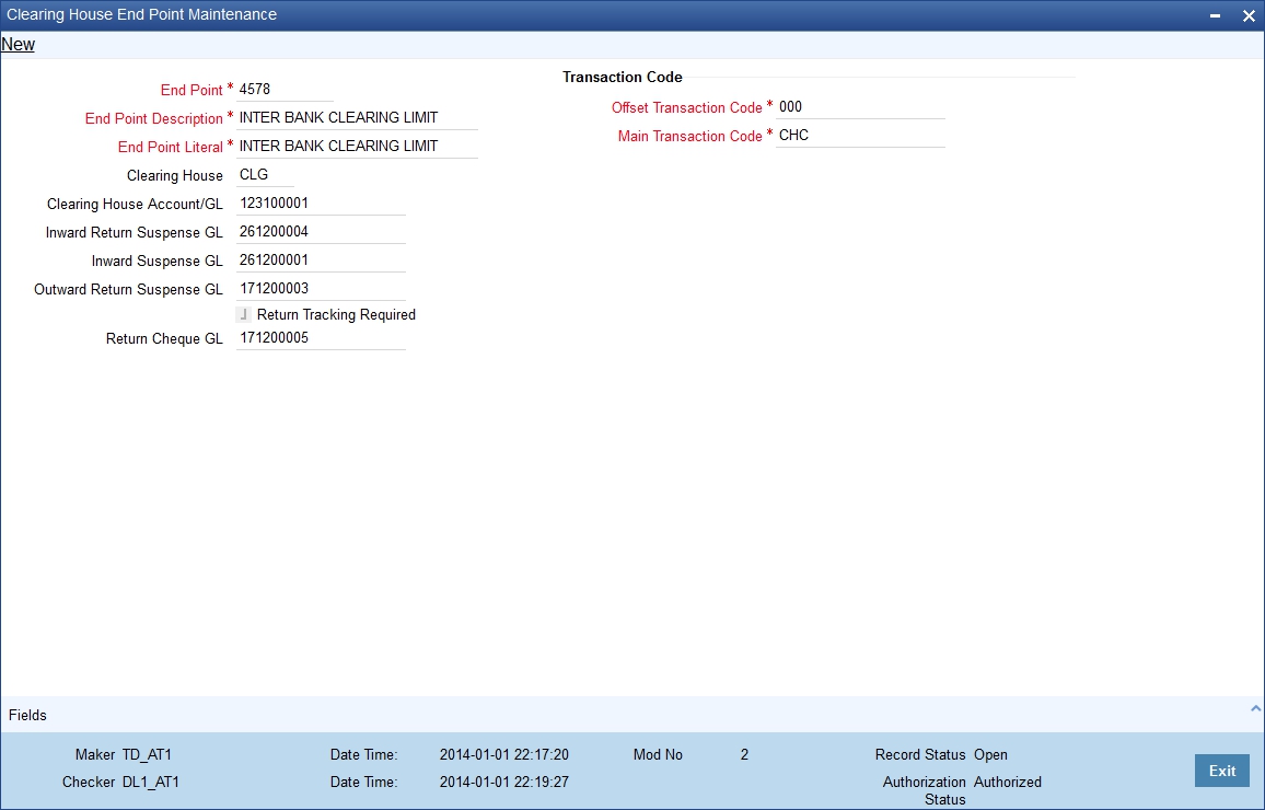

In Oracle FLEXCUBE, clearing houses are also referred to as end points. To facilitate error-free processing of clearing transactions, you need to maintain end point details and map an end point to a clearing house. Invoke the End Point Details screen from the Application Browser to maintain end point details.
You can invoke this screen by typing ‘STDENDMT’ in the field at the top right corner of the Application tool bar and clicking on the adjoining arrow button.
You can specify the following details:
End Point
Specify the end point.
End Point Description
Specify the description for the end point.
End Point Literal
Specify the end point literal.
Clearing House
Specify the clearing house ID. Alternatively, you can select the clearing house ID from the option list. The list displays all valid clearing house ID maintained in the system.
Clearing House Account/GL
Specify the clearing house account number. Alternatively you can select the clearing house account number from the option list. The list displays all valid clearing house account number maintained in the system.
Inward Return Suspense GL
Specify Inward Return Suspense GL number. Alternatively you can select the inward return suspense GL from the option list. The list displays all valid inward return suspense GL number maintained in the system.
Credit entries are recorded in this GL when outward clearing cheque gets rejected. The balance in this GL represents the amount returned to the clearing house due to outward clearing returned.
Inward Suspense GL
Specify Inward Suspense GL number. Alternatively you can select the inward suspense GL from the option list. The list displays all valid inward suspense GL number maintained in the system.
Credit entries are passed in this GL during inward clearing. The balance in this GL represents the amount owed by the bank to the clearing house due to inward clearing instruments.
Outward Return Suspense GL
Specify Outward Return Suspense GL number. Alternatively you can select the outward return suspense GL from the option list. The list displays all valid outward return suspense GL number maintained in the system.
Debit entries are recorded in this GL when inward clearing cheque gets rejected. The balance in this GL represents the amount owed by the bank to the clearing house due to inward clearing return instruments.
Return Tracking Required
Check this box if return tracking is required at the account branch/clearing branch when Account found/not found respectively
Return Cheque GL
Specify return cheque GL. Alternatively, you can select return cheque GL from the option list. The list displays all valid return cheque GL maintained in the system.
Note
You can track a returned or rejected cheque in the account branch or the Clearing Branch level. The rejected cheque is reversed and the cheque status is marked as rejected in the Cheque Return screen (6560).
If the above details are maintained in case of returns from inward clearing, the system will define a predefined logic for all Inward clearing screens to trigger the corresponding accounting entries. This is applicable for all the inward clearing transactions booked from one of the following screens:
The same process is followed in handling the returns from Inward clearing (Outward Returns) . In case of Outward returns handling, Outward Return suspense GL and return cheque GL will be used and existing REVR event will be triggered to post the following accounting entries.
Offset Transaction Code
Specify the offset transaction code. Alternatively, you can select offset transaction code from the option list. The list displays all valid offset transaction code maintained in the system.
Main Transaction Code
Specify the main transaction code. Alternatively, you can select main transaction code from the option list. The list displays all valid main transaction code maintained in the system.
Note
In Oracle FLEXCUBE, a nine-digit number identifies end points and a three-digit number identifies clearing houses. By mapping an end point to a clearing house, you identify the end point captured at the branch as a valid clearing house maintained in Oracle FLEXCUBE.
Inward Return Suspense GL is maintained at endpoint level to trigger accounting entries in case of Outward returns. The system will use RETN event to handle the inward returns processing. This event is triggered in case of returns from ‘6560’ screen or during the upload of the inward return transactions in the ‘CGDCLGDT’ screen, when the CGREJECT batch is run. The system will maintain the corresponding accounting entries for this event using ‘Our_Charge’ amount tag and ‘Inward Return Susp GL’ accounting role.
