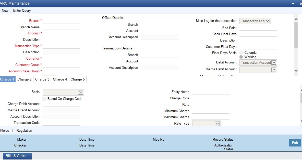

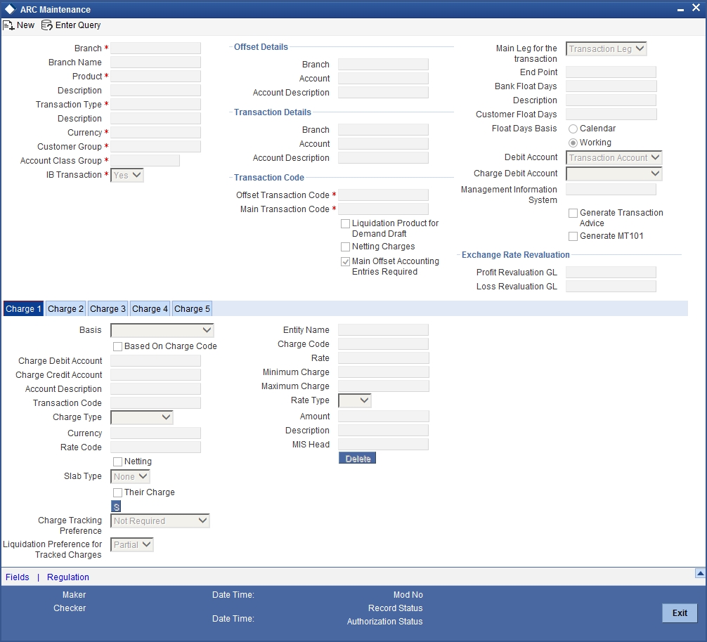

5.1 ARC Maintenance Screen
5.1.1 Invoking ARC Maintenance Screen
The ARC Maintenance screen can be accessed from the Application Browser. You can invoke this screen by typing ‘IFDATMMN’ in the field at the top right corner of the Application tool bar and clicking on the adjoining arrow button.
In the ARC Maintenance screen, you primarily define parameters for processing clearing transactions involving a specific product, currency, and branch combination, and involving a specific Clearing House (in case of an inward clearing transaction) or a Sector (in case of an outward transaction). Towards this, you must specify the following details:
If you are maintaining ARC details for a product and a specific clearing house/sector, the details maintained in this screen will be used for posting entries generated by clearing transactions involving the product, clearing house/sector, branch and currency code combination.
Note
You must maintain ARC details for all possible combinations of products, currencies, branches, and clearing houses/sectors.

5.1.2 Defining Charge Details
You can define a maximum of five charges. A charge can be computed based either on the transaction amount or on an earlier charge amount
As part of defining the Charge details for each charge, you need to capture the following details:

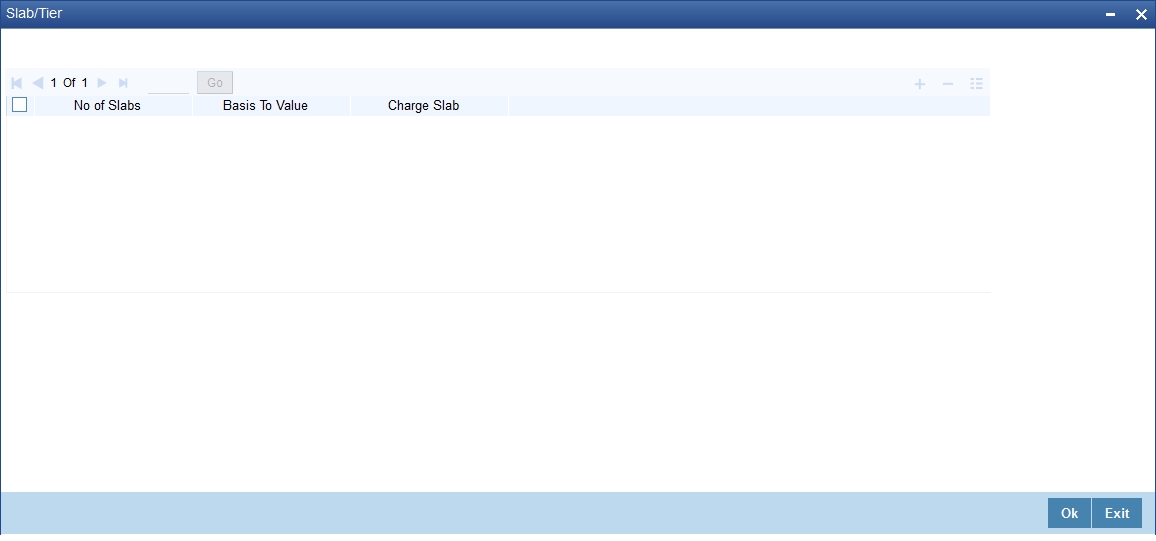

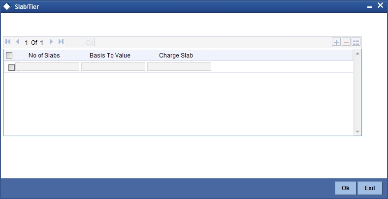

Slab Type
Whether the Charge computation has to be over different Amount Slabs or Tiers (0-100 @ 10, 101-500 @ 15 etc.).

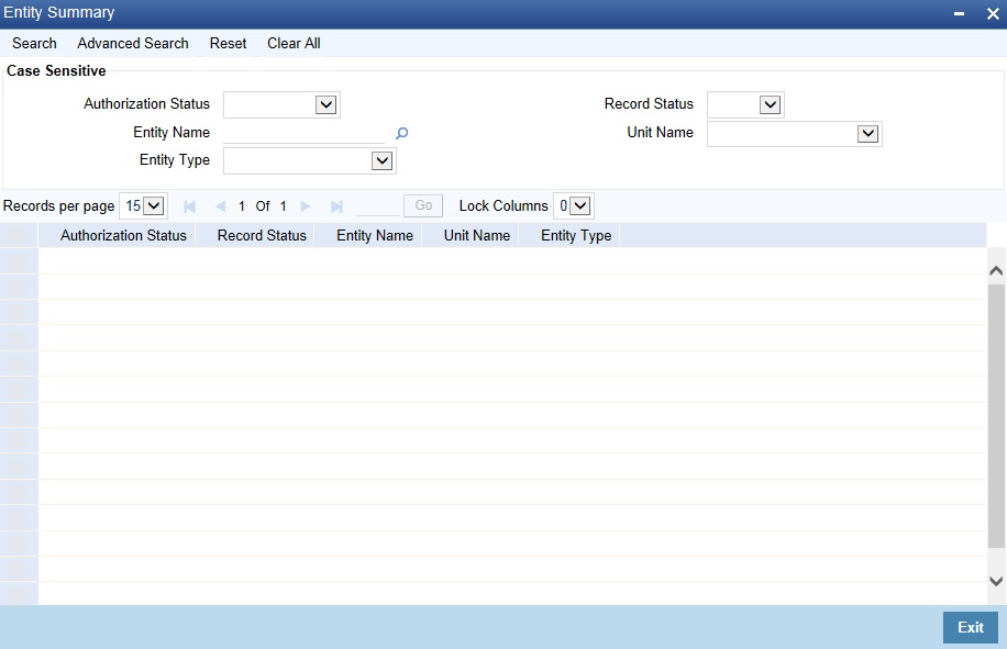

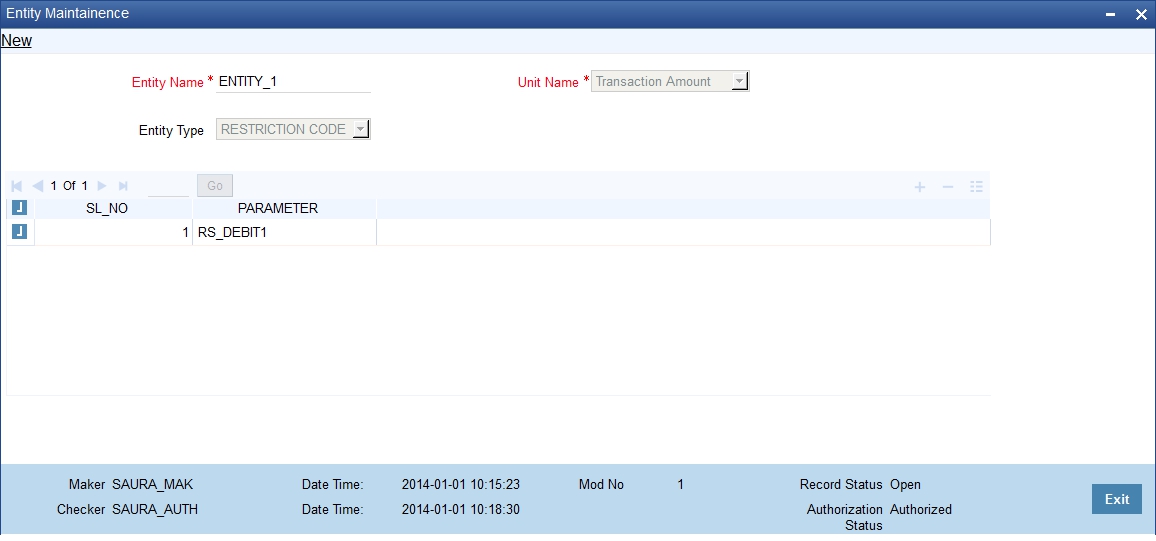

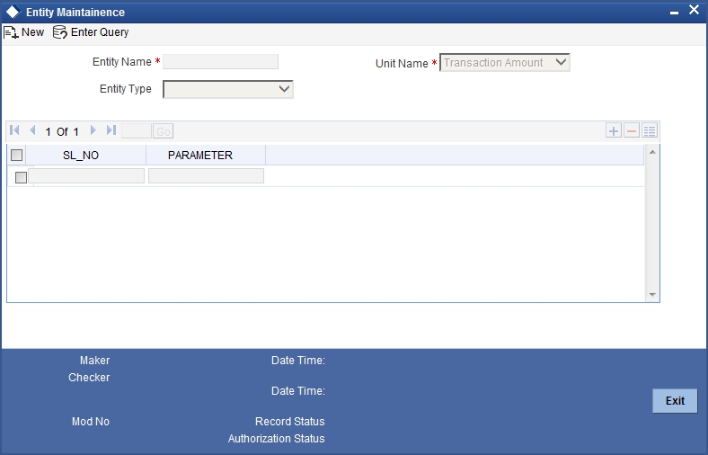

Entity Name
The field is enabled if ‘System Entity’ is selected in the ‘Basis’ field. Select the Entity Name, from the adjoining option list. The list of values are populated from the ‘Entity Maintenance’ screen (STDENMNT). Further details on the ‘Entity Maintenance’ screen is provided in subsequent sections of this chapter.

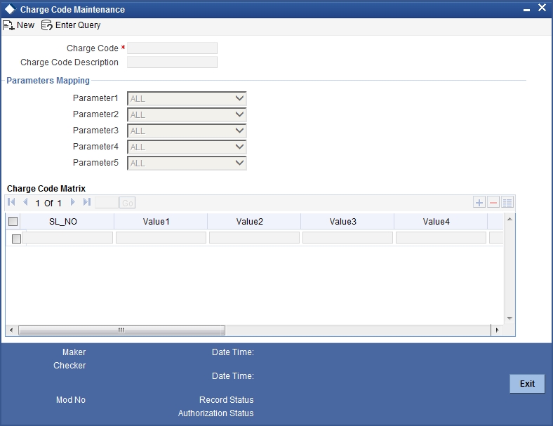

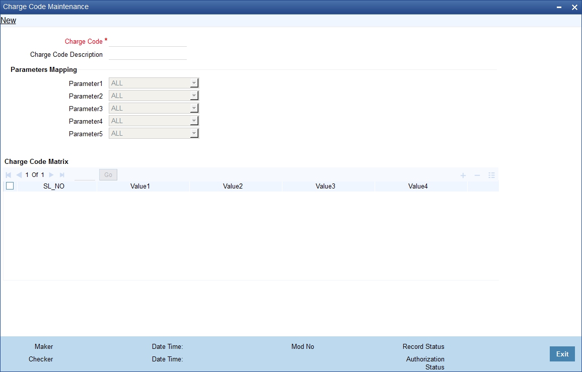

Based on Charge Code
Check this box to indicate whether the charge is based on the charges maintained in the charge code maintenance. If this field is checked, then the system checks the parameters applicable to the said charge code from the Charge Code Maintenance (which is detailed in the subsequent section) and passes the relevant parameter value(s). The system also passes the “Basis” amount to the charge code as the basis is captured at ARC charge level.
If the system is unable to pass a parameter value to a charge code because of unavailability of data, the same parameter is treated as *.*.
Subsequently, charges are calculated based on the charge calculating preferences for the said record. Charge Code
This field is enabled if ‘Based on Charge Code’ field is checked. Select the charge code from the adjoining option list. All charge codes as maintained in the charge code maintenance screen is listed in this field.

If the charge percentage involving a particular transaction is less than the minimum charge, the system will, by default, debit the customer account with the minimum charge amount. If the charge percentage exceeds the maximum amount, the system will debit the customer account with the maximum charge amount.
Note
The charge amount will be deducted in the currency that you specified in the Charge Cur­rency field.
MIS Head
Specify the MIS Head that is applicable for the charge-related accounting entry.
Description
You can indicate a short description for the charge.If you have provided a charge, it is mandatory to enter the description.
Charge Tracking Preference
Select charge tracking preference from the adjoining drop-down list. The options available are:
Note
Note
Liquidation Preference for Tracked Charges
Note
The system displays override messages when:
The non sufficient funds tracked transactions can be reversed on the same day only, next day reversal is not allowed.
If netting is disabled for credit transactions, the charges will be deducted from the account. Hence, NSF charge tracking preference will be applicable if system is unable to collect the charge amount.
For further details refer ‘Maintaining Accounting Details’ chapter of Retail Teller user manual.
5.2 Charge Code Maintenance
This section contains the following topic:
5.2.1 Invoking Charge Code Maintenance Screen
In the ‘Charge Code Maintenance’ screen, charges based on some additional parameters which are not part of ‘ARC maintenance’ can be maintained. The charge matrix in this screen can be attached to the ARC maintenance screen for arriving at charges based on additional parameters.
You can invoke this screen by typing ‘STDCHGCD’ in the field at the top right corner of the Application tool bar and clicking the adjoining arrow button.
Specify the following details in this screen:
Charge Code
Specify a unique identifier to identify a charge code.
Charge Code Description
The description of the charge code will be defaulted here.
Parameters Mapping
In this section, actual parameter(s) based on which charges are differentiated is mapped to fixed parameter IDs. There are 5 parameter IDs provided in this section. At least one parameter should be mandatorily defined. Select the appropriate value from the adjoining option list. This list contains the following values:
The list of factory shipped parameters which is made available in this screen are as follows:
Parameter Specific To
Differentiating Parameter
Description
Applicable to transaction
Customer
CUSTOMER_CATEGORY
Customer category speci­fied at customer CIF level
ALL
GROUP_CODE
Group code specified at customer CIF >Addi­tional tab level
ALL
CLEARING_GROUP
Clearing group specified at customer CIF >Addi­tional tab level
ALL
TAX_GROUP
Tax group specified at customer CIF >Addi­tional tab level
ALL
CUSTOMER_CLASSIFICA­TION
Customer Classification specified at customer CIF >Additional tab level
ALL
NATIONALITY
Nationality specified at customer CIF level> per­sonal/corporate tab
ALL
Transac­tion
TRANSACTION_BRANCH
Branch code at which transaction is being done
ALL
TRANSAC­TION_BRANCH_GROUP
Branch group to which transaction branch belongs to
ALL
ACCOUNT_BRANCH
Branch code of the trans­action account
ALL
ACCOUNT_BRANCH_GROUP
Branch group to which account branch belongs to
ALL
PAYABLE_BANK_CODE
Payable bank code for BC/DD/TT
BC/DD/TT
PAYABLE_BRANCH_CODE
Payable Branch for BC/DD/TT
BC/DD/TT
TO_ACCOUNT_BRANCH
Branch code of the Credit account
LOCH and Account to Account transfer
TO_AC­COUNT_BRANCH_GROUP
Branch group to which credit account branch belongs to
Charge Matrix
Values 1 to 5
Values 1 to 5 correspond to the respective parameter values in the Parameter Mapping section. For example Value 1 corresponds to Parameter Value 1 and so on and so forth. Select the specific values from the adjoining option list.
Charge Type
Select the charge type from the drop down list. The charge type can be flat or percentage.
Amount
Specify the charge amount in this field.
Rate
Specify the rate in this field.
Minimum Charge
Specify the minimum charge in this field.
Maximum Charge
Specify the maximum charge in this field.
Slab Type
Select the Slab Type as Slab or Tier from the drop down list. If Slab Type is Slab or Tier, then provide the slab or tier details in the slab or tier sub-screen by clicking ‘S’ button.
In this screen, you need to specify the number of slabs, the basis to value, and charge slab details.

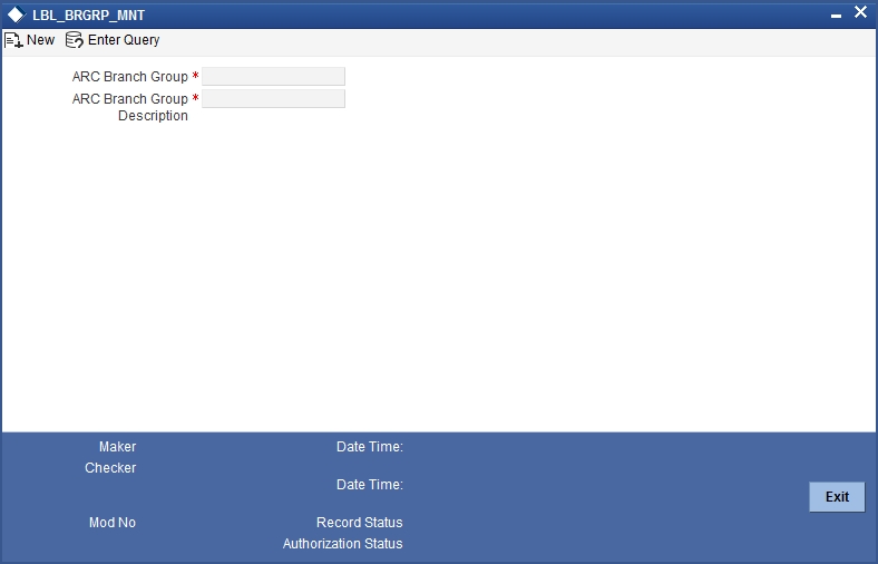

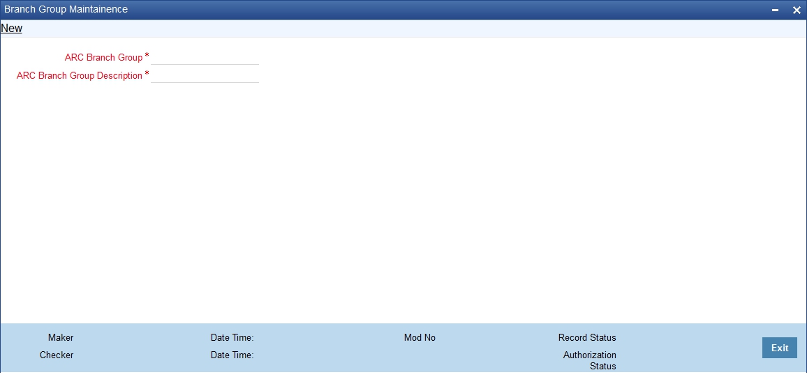

5.3 ARC Branch Group Maintenance
5.3.1 Invoking ARC Branch Group Maintenance
To define branch groups which are equivalent to cities or regions that the bank operates in, invoke the ‘ARC Branch Group Maintenance’ screen by typing ‘STDBRGMT’ in the field at the top right corner of the application tool bar and clicking the adjoining arrow button.
ARC Branch Group
Specify a group code to identify a group of branches.
ARC Branch Group Description
Specify a description for the branch group.
After specifying details in the ‘ARC Branch Group Maintenance’ screen, all the ARC branch groups are displayed in the ‘Branch Parameter Maintenance’ screen (STDBRANC). Select the branch group from the ‘ARC Branch Group’ field.
For more information on the Branch Parameters Maintenance screen, refer section 5 ‘Branch Parameters’ in the Core Service module.
5.4 Entity Maintenance
5.4.1 Invoking Entity Maintenance Screen
In the ARC Maintenance screen, fees or charges as a percentage of the transaction amount can be calculated for transactions exceeding the restriction amount. To calculate this fee or charge, you need to select ‘System Entity’ in the ‘Basis Field’ in the ARC Maintenance screen. Thereafter, the ‘Entity Name’ field is enabled which displays values obtained from the ‘Entity Maintenance’ screen. You can invoke this screen by typing ‘STDENMNT’ in the field at the top right corner of the application tool bar and clicking the adjoining arrow button.
Specify the following in this screen:
Entity Name
Specify the entity name to be considered for Fee Maintenance.
Unit Name
Select a value for charge consideration from the drop down list. The value provided in the drop down list are as follows:
During ARC Maintenance, the following scenarios are considered if exceeded amount is selected:
During ARC Maintenance, the following scenarios are considered if transaction amount is selected
Entity Type
Select the Entity Type from the drop down list. The values provided in the drop down list are as follows:
Parameter
Select the Parameter if ‘Restriction Code’ is selected in the Entity Type field, from the adjoining option list. All active restriction codes as maintained in the system are displayed in this field. For more information on restriction code maintenance, refer to the section ‘Restriction Amount Maintenance’ in the Core Services Module.

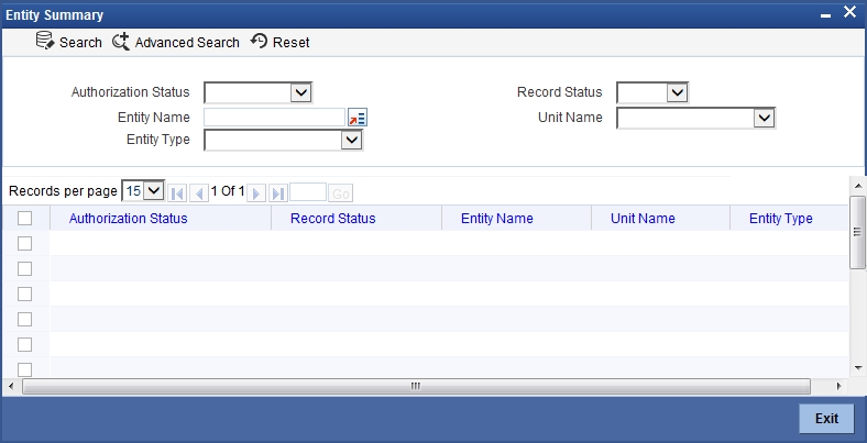

5.4.1.1 Viewing Entity Types
You can view the entity types in the ‘Entity Summary’ screen. You can invoke this screen by typing ‘STSENMNT’ in the field at the top right corner of the application tool bar and clicking the adjoining arrow button.
You can search for entity types by specifying values in the following fields:
On updating these details and clicking the ‘Search’ button, the following columns are populated:

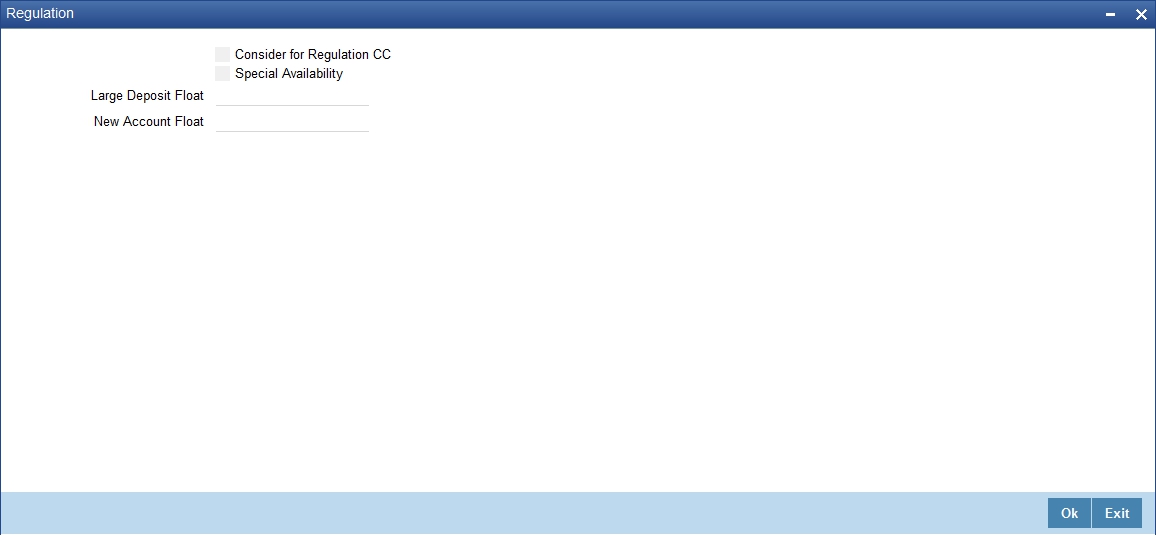

5.4.1.2 Specifying Regulation CC Availability for Clearing Products
In addition to the accounting entry and charge definition you will also have to maintain the following ARC details to incorporate the Regulation CC requirements:
Note
Availability depends upon the specifications in the Clearing House Holiday Maintenance and the Branch Holiday Maintenance. The value date is first arrived at using the clearing house calendar, and if it happens to be a branch holiday, it is moved to the next working day.
During transaction processing the value date for Reg CC availability for the check deposit gets defaulted based on the Credit Account and the ARC Maintenance for the Clearing Product.
To specify the Reg CC details, click ‘Regulation’ button in the ARC Maintenance screen. The Reg Details screen is opened, where you can specify the details.
The schedule for the availability of funds for check deposits under Reg CC will be calculated in the following manner:
