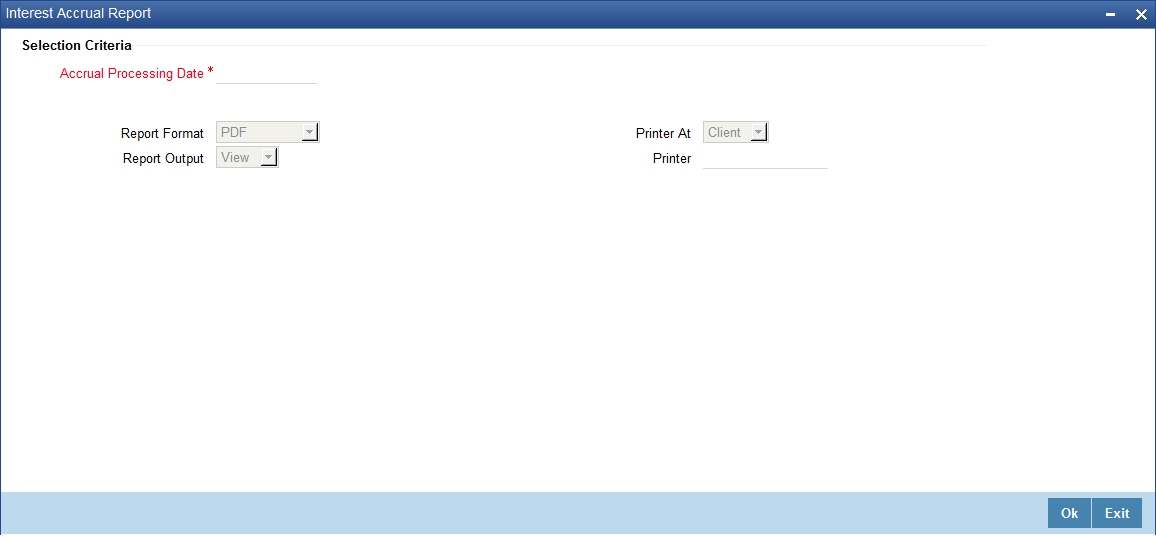

8.2 Interest Accrual Report
8.2.1 Generating Interest Accrual Report
The interest accrual report gives details of accruals done on hedge type of derivative contracts.
You can invoke the screen by typing the code ‘DVRPACCR’ in the field at the top right corner of the Application tool bar and click on the adjoining arrow button.
Selection Criteria
Accrual Processing Date
Specify the accrual processing date on which you want to generate the interest accrual details report.

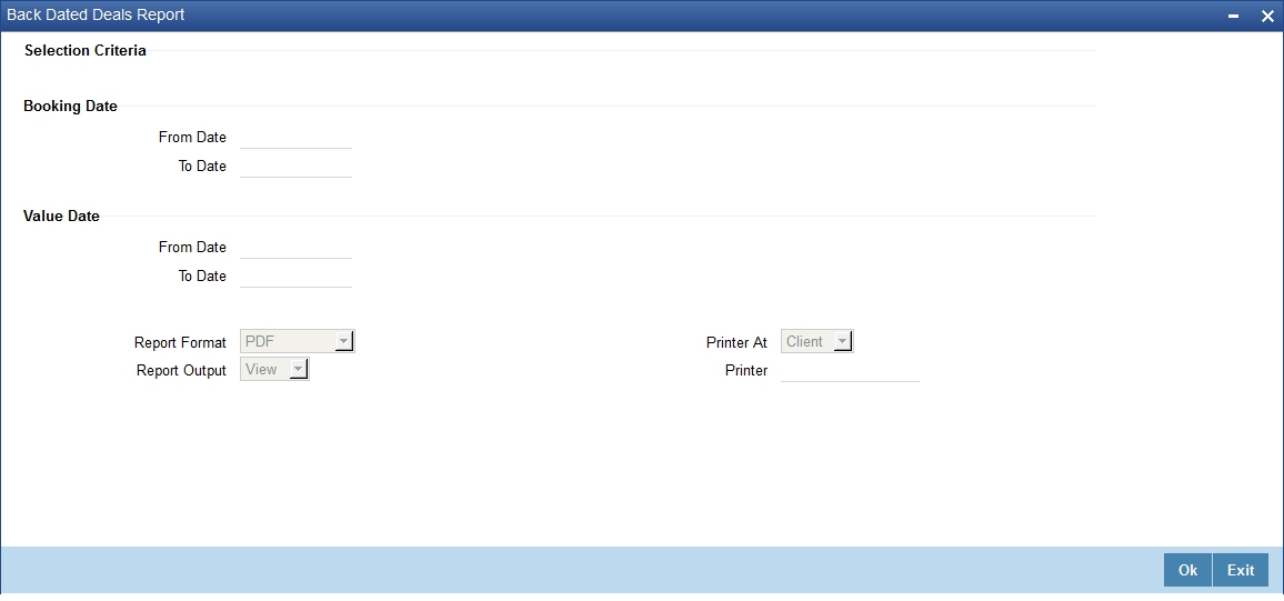

8.3 Back Dated Deals Report
8.3.1 Generating Back Dated Deals Report
The Back Dated Deals report gives details of those deals which were inserted into the system with the value date earlier than that of Booking Date.
You can invoke the screen by typing the code ‘DVRPBKDT’ in the field at the top right corner of the Application tool bar and click on the adjoining arrow button.
Selection Criteria
Booking Date
From Date
Specify the date from when the contract was booked.
To Date
Specify the date till when the contract was booked.
Value Date
From Date
Specify the value date from when, you want to generate the report with data of back valued deals.
To Date
Specify the value date till when, you want to generate the report with data of back valued deals.

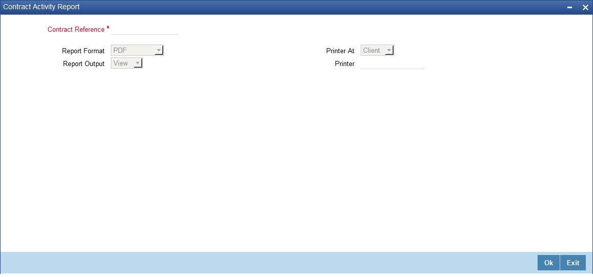

8.4 Contract Activity Report
8.4.1 Generating Contract Activity Report
The Contract Activity report gives details of all the activities that were performed on the contract in a chronological order. This is from the date on which the contract was booked in the system upto today’s date.
You can invoke the screen by typing the code ‘DVRPCACT’ in the field at the top right corner of the Application tool bar and click on the adjoining arrow button.
Contract Reference
You have to specify the reference number of the contract for which the report is to be generated.

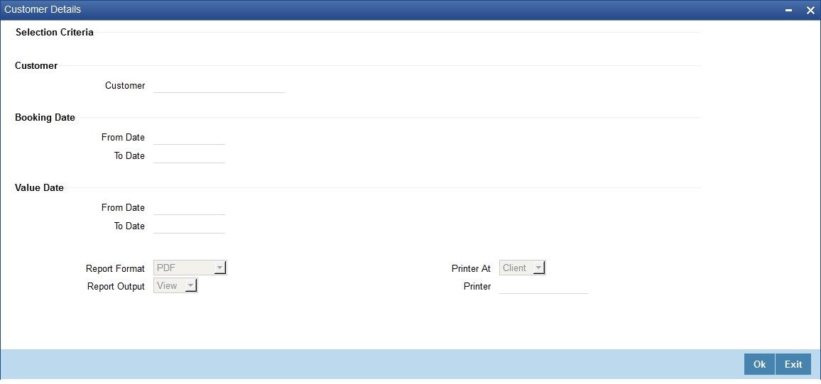

8.5 Customer-Wise Contract Details Report
8.5.1 Generating Customer-wise Contract Details Report
The Customer-wise Details report gives you details of all contracts where the counter-party involved is a specific customer of your bank.
You can invoke the screen by typing the code ‘DVRPCSDT’ in the field at the top right corner of the Application tool bar and click on the adjoining arrow button.
Selection Criteria
Once you indicate the ID of the customer for whom the report should be generated you have to specify the Booking date range within which the contracts generated for the specific customer should fall. You can do this by way of specifying the From and To booking dates.
In addition to the booking date range you can also specify that the report should be generated for contracts, which have value dates falling within a specified date range.
The generated report will contain details of the various activities carried out on all the contracts that were processed between the specified date range (both for the Booking Date and the Value Date) for the particular customer.

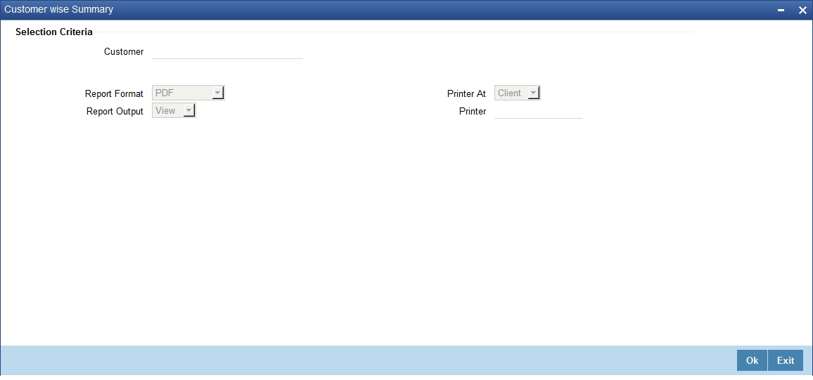

8.6 Customer-Wise Contract Summary Report
8.6.1 Generating Customer-wise Contract Summary Report
The Customer-wise summary report summarizes the details of all contracts where the counter-party involved in the contract is the specified customer.
After you indicate the name of the customer, the details of all those contracts where the specified customer is the counter-party involved will be summarized in the report.
You can invoke the screen by typing the code ‘DVRPCSSM in the field at the top right corner of the Application tool bar and clicking on the adjoining arrow button.
Selection Criteria
Customer
Select the customer ID on which you want to generate the customer-wise summary report.

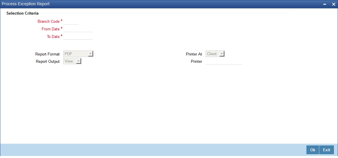

8.7 Process Exception Report
8.7.1 Generating Process Exception Report
When the complete details required for processing a contract are not available the system will stop processing those contracts. This report provides a list of all the exceptions that were encountered when the contracts stored in the specified branch were being processed.
You can invoke the screen by typing the code ‘DVRPEXCP’ in the field at the top right corner of the Application tool bar and click on the adjoining arrow button.
Selection Criteria
Branch Code
Specify a valid branch code to generate the report either for all the branches of your bank or only for a particular branch.
From Date
Specify a valid date from when you wish to generate the report from the adjoining calendar.
To Date
Specify a valid date till when you wish to generate the report from the adjoining calendar.

The report options that you selected while generating the report are printed at the beginning of the report.
The contents of the report are discussed under the following heads:
Header
The Header carries the title of the Report, information on the branch code, the branch date, the user id, the module name, the date and time at which the report was generated and the page number of the report.
Body of the report
The report contains information on:
Transaction Date
This is the date on which the contract was first processed in the system.
Transaction Ref No
This is the transaction reference number.
Branch Code
This is the code of the branch where the contract was processed.
Process Name
The name of the process during which the exception was encountered is reported here.
Contract Reference Number
This is the reference number of the contract for which the process exception details are being reported.
Error Code
The code assigned to the error for which the process exception was raised is reported here.
Error Message
The error message specific to the particular contract will be reported in this field.

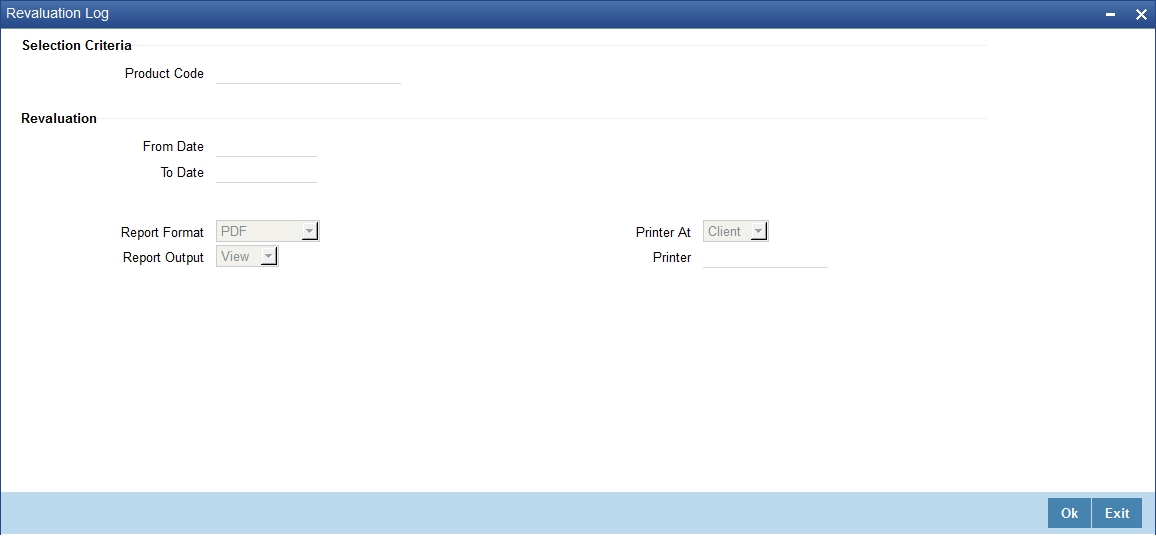

8.8.1 Generating Revaluation Log Report
Through the Revaluation Log report you can get product-wise details of all contracts which were revalued within a specific period. Thus at the product level you can guage the gains and losses due to changes in the market interest rates or the exchange rates.
You can invoke the screen by typing the code ‘DVRPRVAL’ in the field at the top right corner of the Application tool bar and click on the adjoining arrow button.
Selection Criteria
Product Code
Select the product code for which the report has to be generated.
is to be revalued you have to indicate the period for which revaluation should be carried out.
Revaluation
From Date
Specify the date from when the contract is to be revalued.
To Date
Specify the date till when the contract is to be revalued.
Note
You can choose to generate the revaluation log report either for one particular product or for all the products.

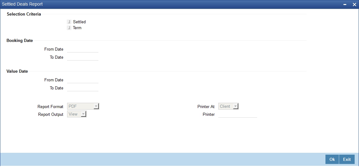

8.9 Settled Deals Report
8.9.1 Generating Settled Deals Report
Through the Settled Deals report options screen you can generate a detailed report on all contracts which were settled as well as on those contracts which were terminated.
You can invoke the screen by typing the code ‘DVRPSTLD’ in the field at the top right corner of the Application tool bar and click on the adjoining arrow button.
Selection Criteria
Firstly you have to indicate whether the report should be generated for settled deals or whether the report should contain details of contracts which were terminated.
After you indicate this specification you have to specify the date range within which the settled/terminated contracts were booked. Similarly you can specify that the report should contain deals bearing a value date falling within a specific date range.
The generated report will contain details of contracts satisfying the above criteria.
