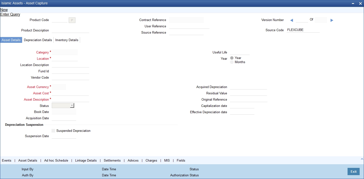

You can capture the various details of the Islamic fixed asset such as asset code, asset cost, date of acquisition, date of capitalization, location, asset category code etc.
Through this screen you can associate the Islamic fixed asset to an Islamic product code and all the restrictions maintained at the product level will be enforced while you record the new asset.
You are not allowed to change the product associated with the asset during the life cycle of the asset once you have associated the product to the asset.
You can invoke ‘Islamic Assets – Asset Capture’ screen by typing ‘FIDTRONL’ in the field at the top right corner of the Application tool bar and clicking the adjoining arrow button.
Identifying a Product Code
Choose a product code from the option list. This option list provides all the valid products maintained through the ‘Islamic Fixed Assets Product’ screen. All the preferences defined at the product level will be defaulted. Once you specify the product code, the system will create the reference number in the next field for the asset.
Displaying the Contract Reference Number
The system automatically creates the reference number for the asset.
The reference number generated is a combination of branch code, product code, the Julian date of transaction input and a running serial number.
Description of the Product
Once you have selected the product code, the product description is displayed.
Displaying the User Reference number
You can enter any reference number for a Islamic Fixed Asset contract that you process. The contract will be identified through this number in addition to the contract reference number generated by the system. Two contracts cannot have the same user reference number. By default, the contract reference number generated by the system will be taken as the user reference number. You can use this number, to retrieve information relating to a contract.
Displaying Loan Account Number
The system displays the reference number of the financed finance account. You can not modify this field.
Identifying the Category of the Asset
You can link the asset to an existing Islamic fixed asset category that is not restricted for the branch. Choose the category of the asset from the option list.
Indicating Fund Id
The fund Id will be visible only if the current branch is a fund branch. Select the Fund Id of the asset from the option list. By default, the value of ‘Default Mudarabah Fund’ is displayed as the Fund Id.
The settlements processing is enabled only if ‘Allow Corporate Access’ is checked in the ‘Branch Parameters – Detail View’ screen.
Indicating the Vendor Code of the Asset
Specify the vendor code of the asset from the option list. The list displays all the customer codes maintained in the system.
Indicating the Location of the Asset
Identify the location at which the asset is currently stationed. The adjoining option list provides all the valid locations maintained through the ‘Islamic Fixed Assets Location Restrictions’ screen for Islamic fixed assets.
Describing the Asset
In this field, you can enter the description of the asset stating whether the asset is an office building or computers etc.
Specifying the Cost of the Asset
Enter the value of the asset in this field.
Identifying the Currency
This is the local currency of the branch. You will not be allowed to modify this data.
Describing the Status of the Asset
Here you have to mention the status of the asset your branch is holding. The available options are:
Specifying the Booking Date for the Asset
The system date is defaulted as the booking date of the asset. You will not be allowed to modify this date.
Specifying the Acquisition Date of the Asset
Mention the date on which the asset is acquired in the date/month/year format.
Specifying the Acquired Depreciation
You can specify the acquired depreciation in case of the asset being transferred from a previous branch. The system arrives at the accumulated depreciation based on the acquired depreciation that you specify as well as the depreciation calculated. The acquired depreciation is considered to track depreciation on books and not for tax purposes.
You will not be allowed to specify the acquired depreciation once you save and authorize a contract.
Residual Value
The Residual Value is taken into account for the purpose of computing the depreciation of the asset. However, you must ensure to enable the ‘Asset Cost – Residual Value’ option in the Asset Category screen.
Note
The total depreciation for the asset will not exceed the residual value.
Specifying the Capitalization Date
If you have selected the status of the asset as ‘Capitalized’ then you have to specify the date on which the asset was capitalized.
Indicating the Effective Depreciation Date
In this field, you have to mention the date from which the depreciation should be charged for the asset. The capitalization date will be taken as the default date if you do not mention the date. You can choose to change this but this date cannot be less than the capitalization date. Also this date cannot be a future date.
Indicating the Original Reference Number
This field is updated only during Islamic Fixed Asset Transfers. Transferred asset is automatically created in the branch/location on Save of transfer. This field displays the original reference number of the asset in the old branch/location. You cannot modify this number.
All other details of the transferred asset will remain the same as before except for a few conditions.
Please refer the section Asset Transfer Process for more details.
Indicating the Useful Life of the Asset
This is the unit to measure the useful life of asset (months/years). The data is defaulted from asset category maintenance. You can choose to change this unit.
Indicating the Duration of the Useful Life
This is the useful life of the asset. The data is defaulted from asset category maintenance however you can choose to change this.
Indicating Suspend Depreciation
By choosing this preference you can stop the depreciation calculation for an asset. If there is a negotiation for sale or change in RV for the asset, then choose this option to suspend the depreciation. Otherwise you can leave it unchecked.
Specifying the Depreciation Suspension Date
If you choose to suspend the depreciation then the system takes the application date as the suspension date. You will not be allowed to modify this date.
Note
Ijarah fixed asset product with preference ‘Financed by Loan’ is not allowed.

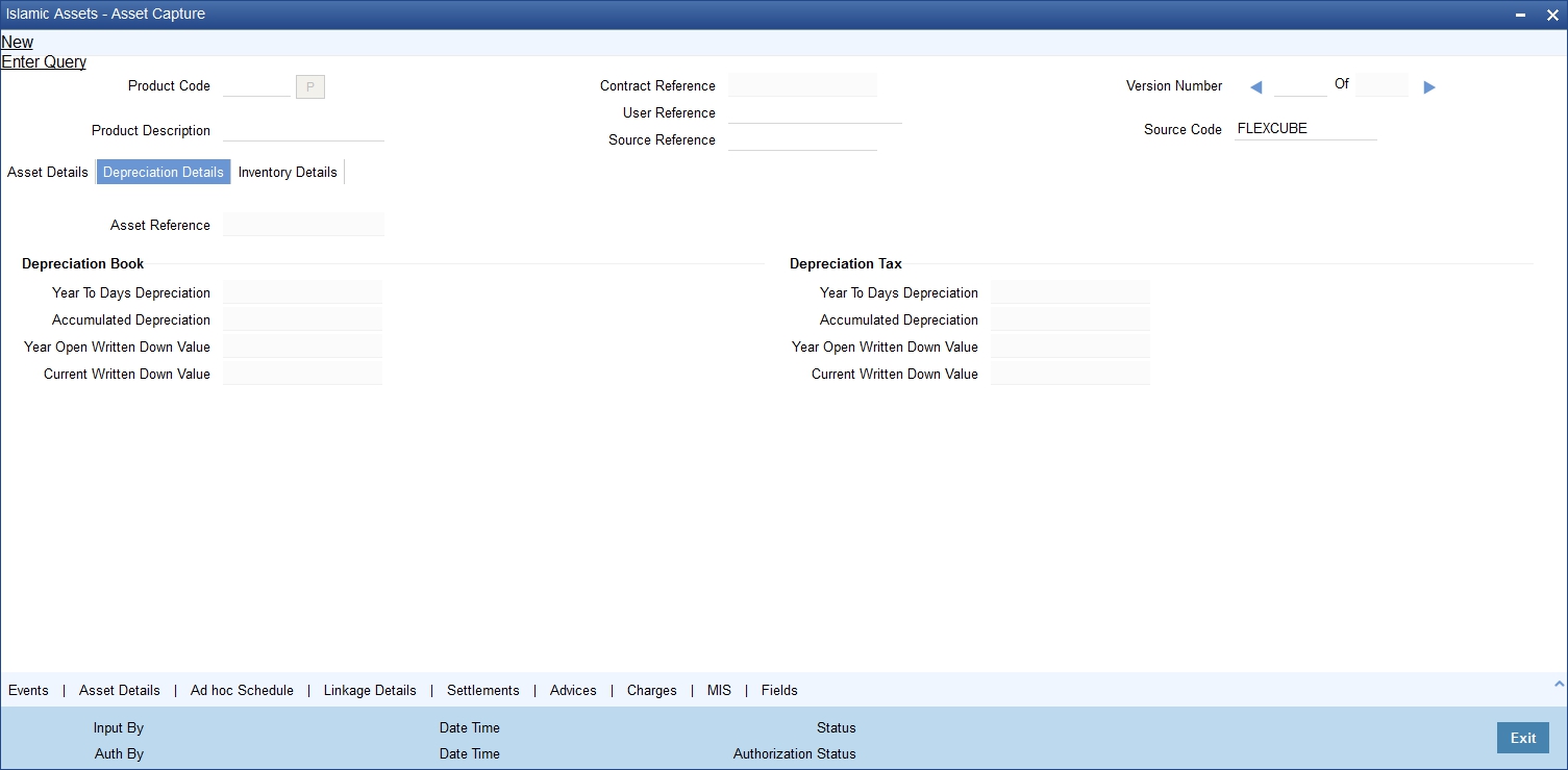

You can view the depreciation charged for the asset from this screen. Depreciation view screen displays the depreciation details of the asset recorded for book and tax purposes.
YTD Depreciation
This field displays the depreciation charged on an asset from the start of the current financial year till the last depreciation date. This data is recorded for book and tax purpose.
No modification is allowed in this field.
Accumulated Depreciation
This field displays the depreciation charged on an asset for account book and tax purpose. The depreciation is calculated from the effective date of depreciation till the system date.
Year Open WDV
The field displays the value of the asset that was written down at the beginning of the financial year for book and tax purpose.
Current WDV
This field displays the value of the asset that was written down on the system date for book and tax purpose.

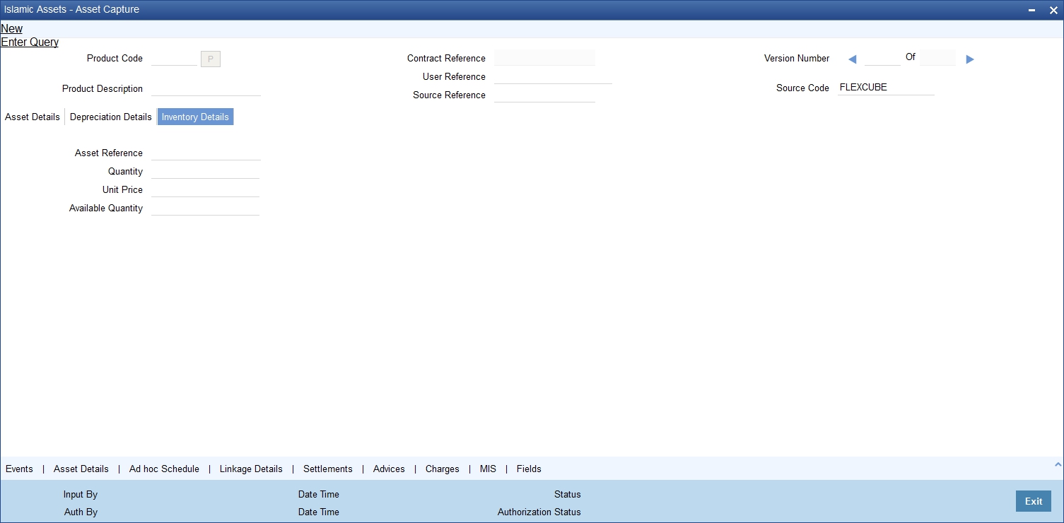

You can view the inventory details for the asset from this screen. Click ‘Inventory Details’ tab in the ‘Islamic Assets- Asset Capture’ screen.
In this screen you can capture the following details:
Asset Reference Number
The system displays the asset reference number.
Quantity
Specify the number of quantities.
Procurement Unit Price
Specify the price for procurement unit.
Available Quantity
The system displays the available quantity based on the quantity available for the contract. Initially the system will default it with Value of Quantity.

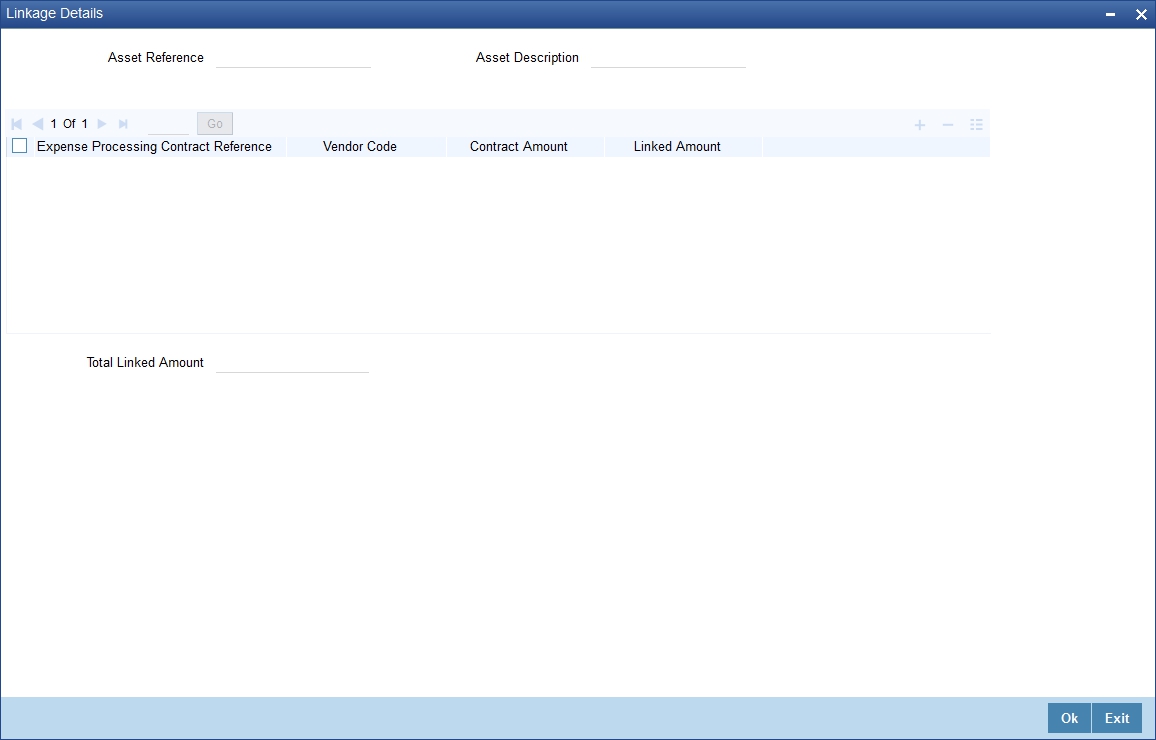

When an asset is purchased against a purchase order, you can link the asset to the contracts in Expense Processing contract.
To access this screen, click ’Linkage Details’ button in the ‘Islamic Assets – Asset Capture’ screen.
This screen enables you to add or delete a record.
Indicating the Reference Number for the Asset
The reference number of the asset is defaulted from the ‘Islamic Assets – Asset Capture’ screen. You will not be able to change this number.
Specifying the Reference Number for the XP Contract
Here you have to mention the reference number of the contract in the XP. You can pick the reference number from the option list available or you can mention the number which will be validated against the XP contract.
Displaying the Code for the Vendor
Once you choose the XP contract, the code for the vendor will be defaulted automatically.
Indicating the Contract Amount
Once you choose the XP contract, the contract amount will be defaulted automatically in this field.
Note
The XP contract amount is displayed in asset currency.
Specifying the Linked Amount
You have to specify the amount of the XP contract that has been used for the purchase of the asset.
Note
Make sure that the sum of the linked amounts for all the linked contracts is less than or equal to the actual cost of the asset.

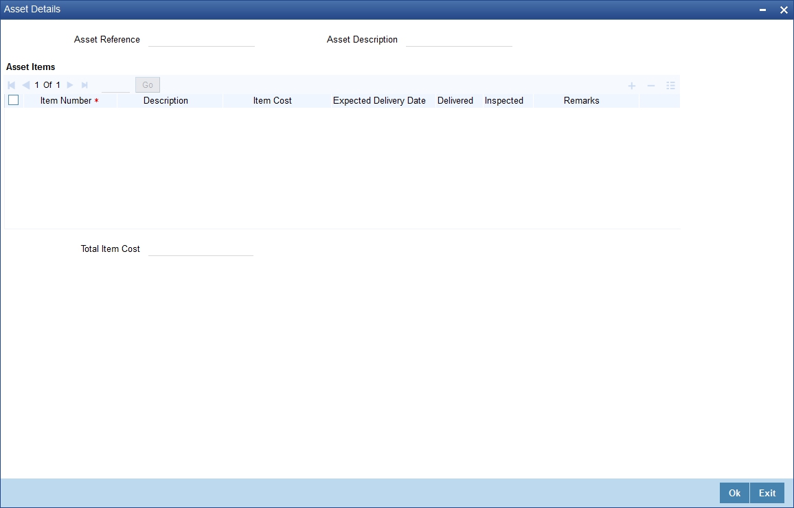

This screen is used to record individual item details under a single asset code in cases where many similar assets are grouped under one category.
To access this screen, click ‘Asset Details’ button in the ‘Islamic Assets – Asset Capture’ screen.
In this screen you are allowed to add or delete an asset from the asset group.
Specifying the Item Identification Number
You need to enter a unique number for the asset to identify the particular asset.
Indicating the Cost of the Asset
You need to specify the cost of the individual item.
Note
Take care that the sum of all item costs does not exceed the asset cost.
You can record the general information regarding the asset in the description field.
Specifying the Delivery Date for the Asset
Mention the date on which the item is scheduled for delivery.
Note
Ensure that the delivery date is not less than the capitalization date.
Indicating the Delivery Status of the Item
Check the box if the delivery of the asset has been carried out. Keep the box unchecked to indicate that the asset has not been delivered.
Indication the Status of Inspection
If the asset has been inspected then check the box. Leave it unchecked to indicate that the asset has not undergone inspection.
Note
You will also be able to perform queries about assets delivered but not inspected and assets inspected but not capitalized, based on the delivery date and status.
Specifying the Remarks for the Asset
In this field you can enter general remarks for the asset for future reference.

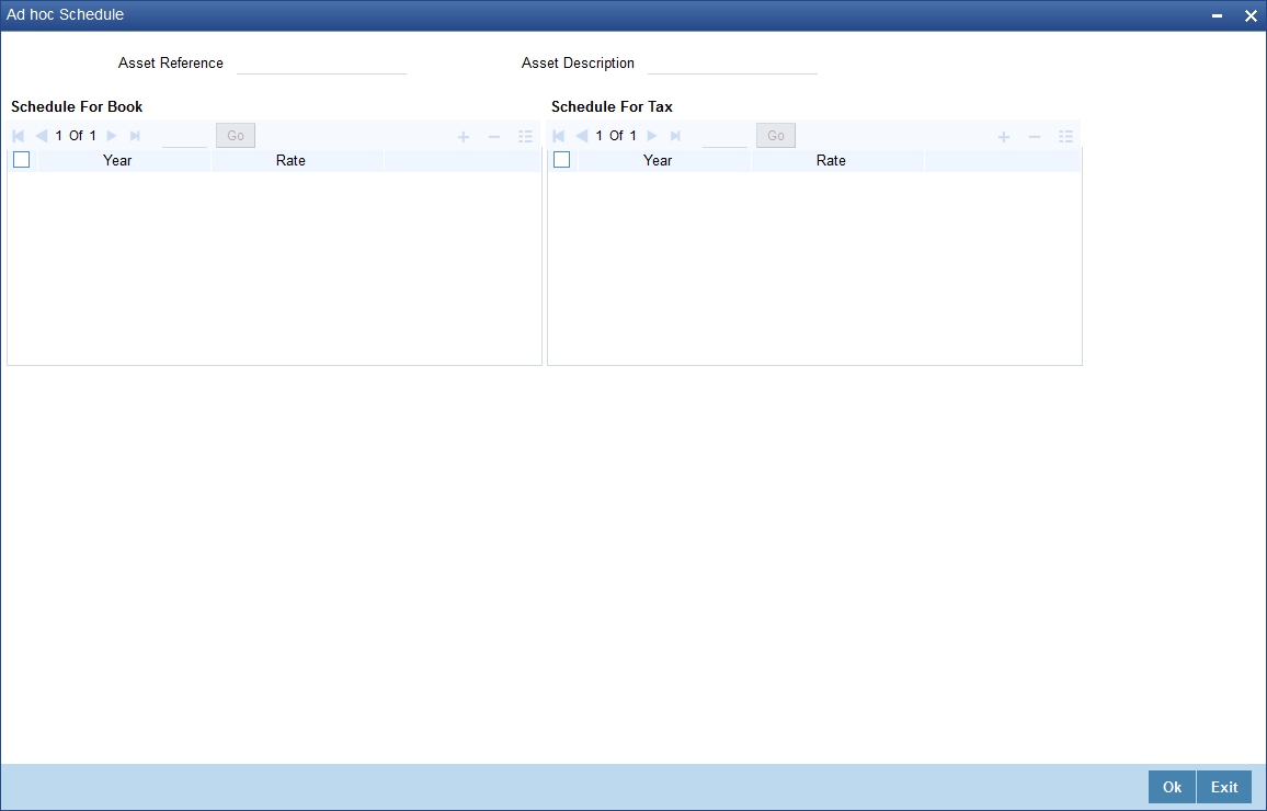

You will be able to define different rates for depreciation. This is exclusively done for adhoc type of depreciation.
To access this screen, click on ‘Adhoc Schedule’ button in the ‘Islamic Assets – Asset Capture’ screen.
Displaying the Asset Reference Number
The reference number of the asset and its description is defaulted from the contract input screen. You will not be able to modify this number.
Maintaining Depreciation Schedule for the Asset
You need to maintain the depreciation rate for the asset across the useful life of the asset.
Note
The depreciation rate will always be in percentage terms per annum.
You have to maintain the depreciation schedule for the asset if you have chosen ‘AD-HOC’ as the’ Depreciation Type’ in the ‘Asset Category Rule Mapping’ screen.
If the useful life is in months, then also, the adhoc depreciation schedule needs to be recorded in terms of years.
Additionally, you have to ensure that you have maintained depreciation rates for all the years of Useful Life.

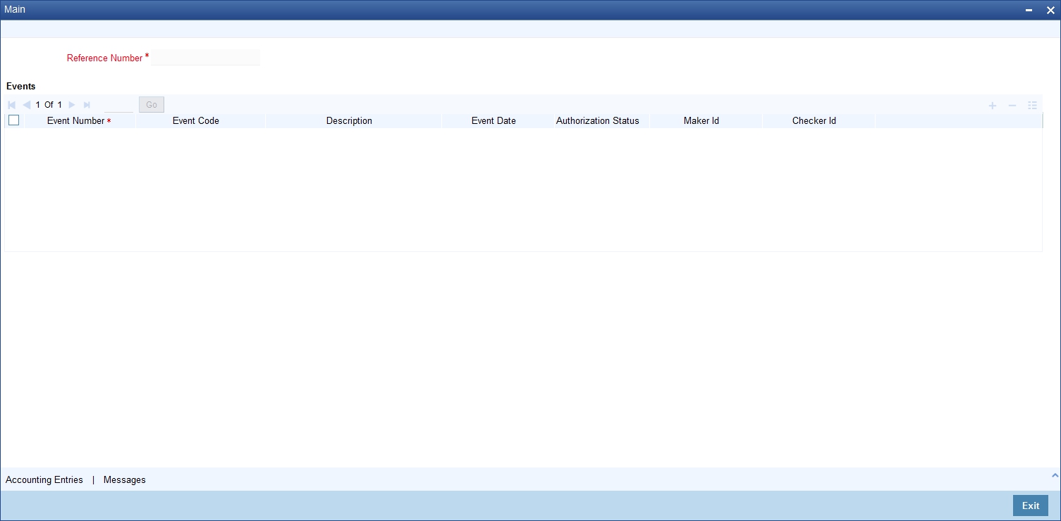

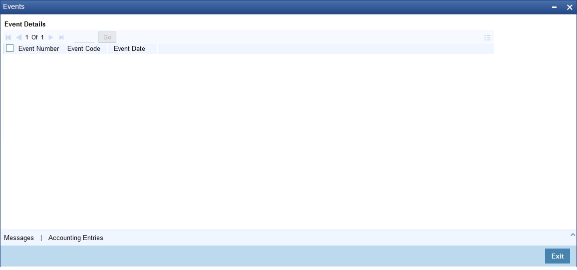

Events are maintained through the ‘Events’ screen. Click the ‘Events’ button in the ‘Islamic Assets – Asset Capture’ screen to invoke this screen.
For more information on specifying Event Details, refer ‘Products’ User Manual under ‘Modularity’.

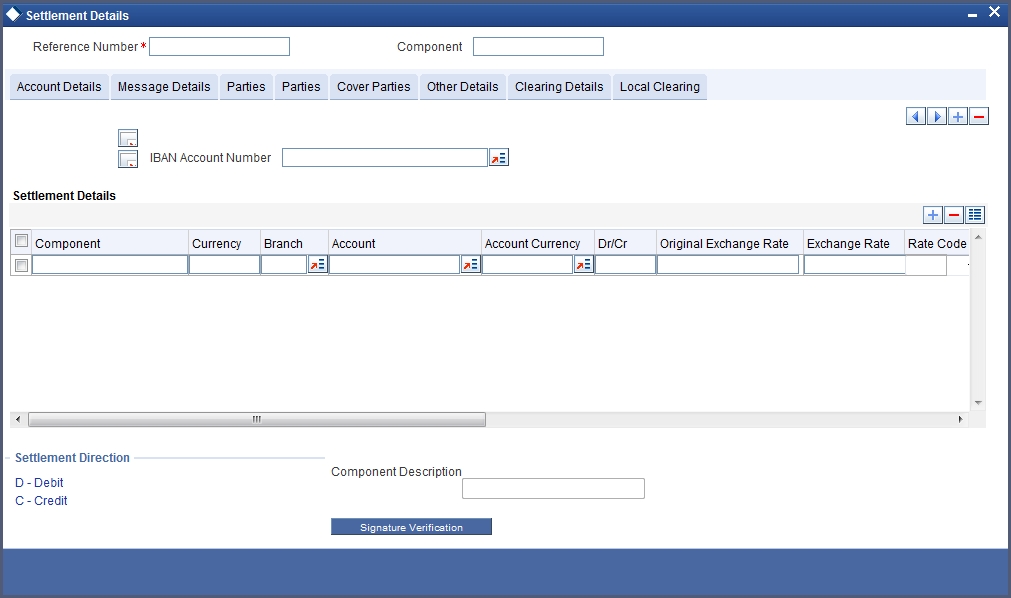

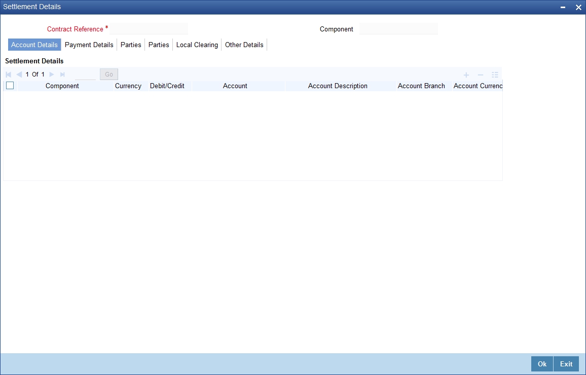

Through the settlement screens, you can view the fund accounts to which entries for the applicable charges and taxes are posted. These details are available in the ‘Settlement Details’ screen.
Click the ‘Settlement’ button in the ‘Islamic Assets – Asset Capture’ screen to invoke the ‘Settlement Details’ screen.I
For more information on specifying Settlement Details, refer ‘Settlements’ User Manual under ‘Modularity’.

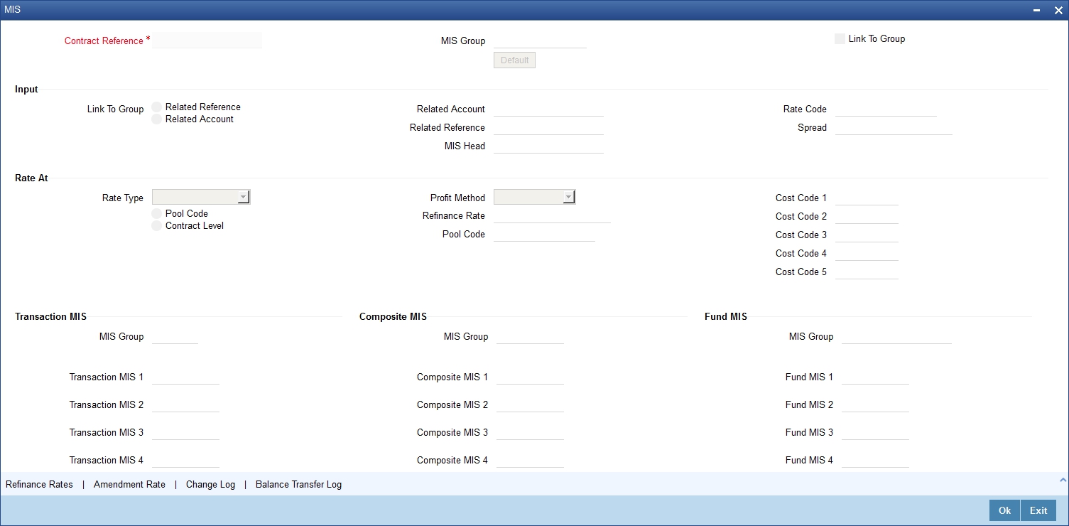

Click the ‘MIS’ button in the ‘Islamic Assets – Asset Capture’ screen to invoke the ‘MIS’ screen.

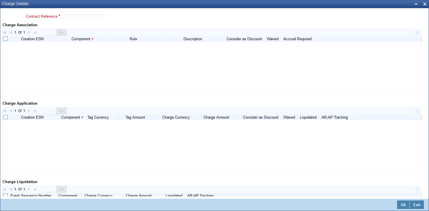

Click the ‘Charges’ button to invoke the ‘Charge Details’ screen. Through this screen you can manage charge details you are creating.

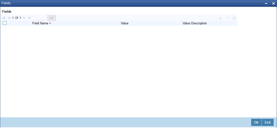

Click the ‘Fields’ button to invoke the ‘Fields’ screen. Through this screen you can manage user defined field details you are creating.
In the ‘Fields’ screen, you can specify the Field Name. Select the Field Name from the option list provided.

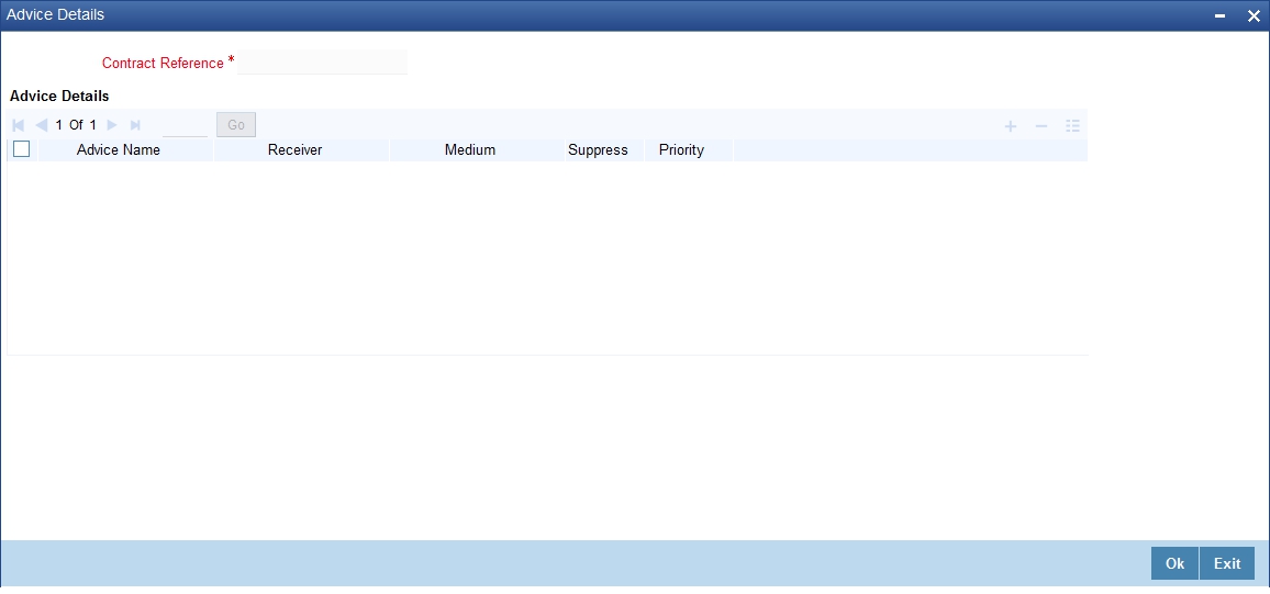

Click the ‘Advices’ button to invoke the ‘Advice Details’ screen. Through this screen you can manage user defined field details you are creating.

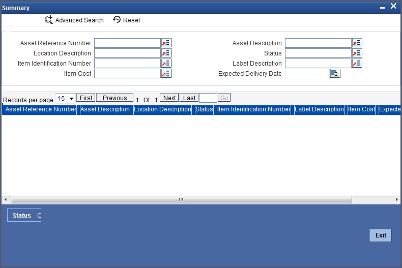

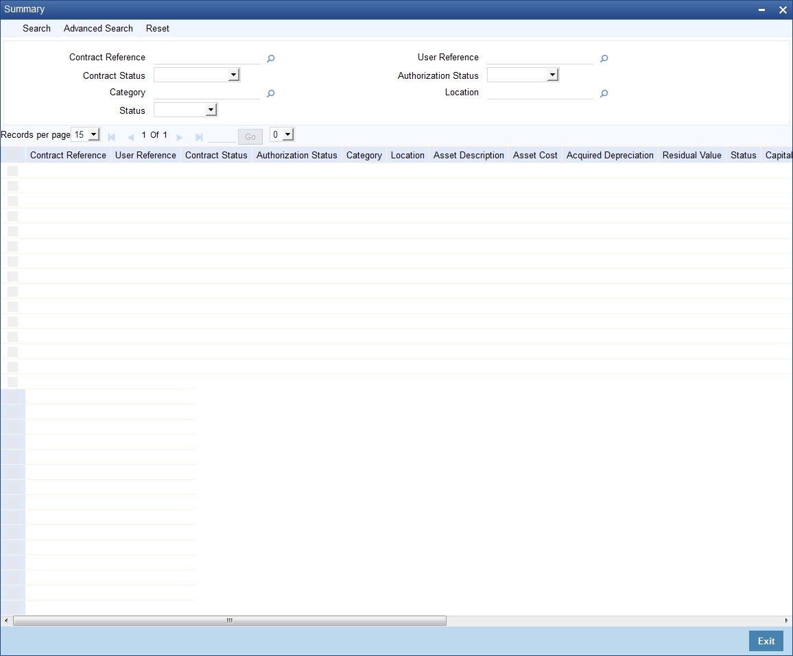

You can view the summary of all the Islamic fixed assets contracts using ‘Islamic Fixed Asset Capture Summary’ screen. You can invoke this screen by typing ‘FISTRONL’ in the field at the top right corner of the Application tool bar and clicking the adjoining arrow button.
A screen giving all the details of the contracts is displayed.
A contract can be deleted only by the user who entered it. If a contract has to be deleted and the user who input it is not around to do it, you can reassign the contract to another user so that the other user can delete it. Typically, this situation may arise during End of Day operations when a contract that is not authorized has to be deleted and the user who input it has left office for the day. The access rights to reassign a contract are usually allotted to a senior user in the department.

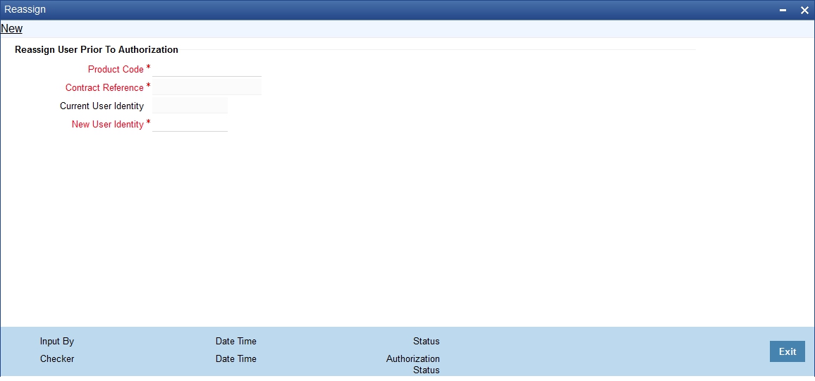

You can perform the reassigning operation through the ‘Islamic Reassign Contract’ screen. You can invoke this screen by typing ‘IBDTREAS’ in the field at the top right corner of the Application tool bar and clicking the adjoining arrow button. The screen is displayed below.
Product
Specify the product for which you want to reassign the user. The adjoining option list displays all the products maintained for Islamic fixed assets through the ‘Islamic Fixed Assets Product Maintenance’ screen.
Contract Ref No
Specify the contract reference number for which you wan to reassign the user. The adjoining option list displays all the contracts maintained for the product selected.
Current User Id
Current user ID is displayed in this field.
New User Id
Specify the new user to whom you want to reassign the contract.
Click ‘Ok’ button to save the details you entered. Click ‘Delete’ button if you do not want to save the details.

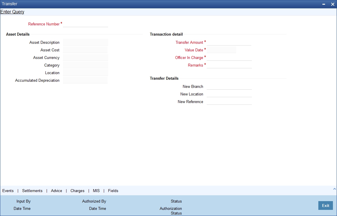

Through the Transfer of Fixed Asset screens you can transfer a Islamic fixed asset to a different branch/ location. All the necessary details such as date of sale/transfer/write off, sale price, transfer details etc is captured through these screens.
You can invoke ‘Islamic Assets –Transfer Details’ screen by typing ‘FIDTRTFR’ in the field at the top right corner of the Application tool bar and clicking the adjoining arrow button. The screen is displayed below:
The process of transfer is automated and the transferred Islamic asset is automatically created in the branch/location on saving the transfer.
Transfer value of the asset will be the current book value of the asset itself and cannot be modified. Book Value is arrived by subtracting the accumulated depreciation from the asset cost.
Note
At least one of the two (new location and branch) must be different than current location and branch of the asset. Oracle FLEXCUBE will display an error message if this condition is not met.
The reference number of the asset is defaulted from the ‘Islamic Fixed Asset Capture Online’ screen. You will not be able to modify this number. To move to the next asset or previous asset, use the Up and Down arrow keys in the keyboard.
Select ‘New’ from the Actions menu in the Application tool bar or click new icon to make a new entry for sale/write off.
Depending on the reference number you choose, the details for the asset will be defaulted in the following fields:
Note
Any transfer has to be authorized before the end of day.
Indicating the New Reference Number
This is the asset reference number of the asset created in the new branch/location and you will not be allowed to modify the number.
This number is automatically generated by the system when you save the contract.
Specifying the New Branch
This is the branch where the asset is to be transferred. This field is mandatory for asset transfer. Select the branch from the option list.
Specifying the New Location
This is the location to which the asset is to be transferred. This field is mandatory for asset transfer. Select the branch from the option list.
The following conditions are mandatory for asset transfer –
The new asset created will be automatically authorized once the transfer of the asset is authorized. Till such time, the new asset cannot be modified independently. After authorization of the transfer, the new asset created will be independent of the original transferred asset.
On deletion of the transfer, the new asset created will also be deleted.

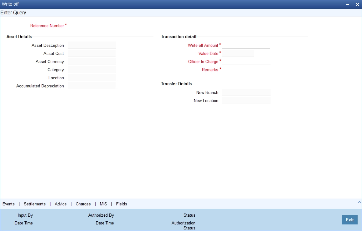

You can write off the bad assets using the ‘Islamic Assets - Write Off Details’ screen.
You can invoke this screen by typing ‘FIDTRWRF’ in the field at the top right corner of the Application tool bar and clicking the adjoining arrow button.
Indicating the Reference Number of the Asset
Click on the ‘New’ icon in the toolbar or select ‘New’ from the Actions menu to make a new entry for sale/write off.
Depending on the reference number you choose, the details for the Islamic fixed asset will be defaulted in the following fields:
You can specify the following details here:
Indicating the Value Date
This is the date on which the asset is written off. This date will always be the system date and you will not be allowed to modify this date.
Specifying the Value of the Sale/Write-off
For a Write off, this value will be the current book value and is not modifiable.
Identifying the Officer in Charge
For write off, you have to mention the name of the officer in charge of the sale or transfer of the asset. This data is recorded for general information purpose.
Remarks
You can enter general remarks for the asset in this free format text field for information purposes.
Note
Any write off has to be authorized before the end of day and Write off is not allowed for fixed assets ‘Financed by Loan’.
Events are maintained through the ‘Events’ screen. Click the ‘Events’ button in the ‘Islamic Assets - Write Off Details’ screen to invoke this screen.
Click the ‘Settlement’ button in the ‘Islamic Assets - Write Off Details’ screen to invoke the ‘Settlement Details’ screen.
Click the ‘MIS’ button in the ‘Islamic Assets - Write Off Details’ screen to invoke the ‘MIS’ screen.

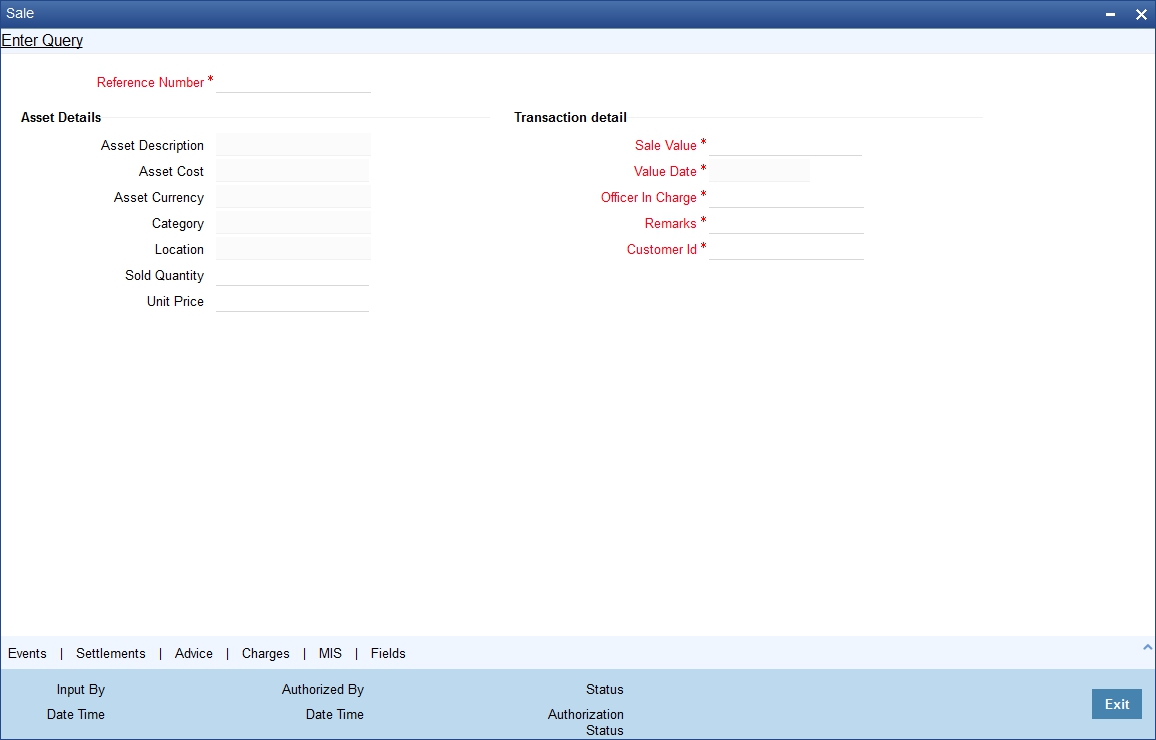

You can sell the Islamic fixed asset by using ‘Islamic Asset – Sales Details’ screen. You can invoke this screen by typing ‘FIDTRSLE’ in the field at the top right corner of the Application tool bar and clicking the adjoining arrow button.
Customer
Specify the CIF id of the customer to whom the asset is sold and the SALE event will be fired for selected customer.
Value Date
This is the date on which the asset is sold. In case of a sale, the default date will be the system date and you can choose to change this date.
This is the net sale value of the asset. This field is mandatory if the asset is being sold.
Officer in Charge
For sale of an asset, you have to mention the name of the officer in charge of the sale or transfer of the asset. This data is recorded for general information purpose.
Remarks

Events are maintained through the ‘Events’ screen. Click the ‘Events’ button in the ‘Islamic Asset – Sales Details’ screen to invoke this screen.

Click the ‘MIS’ button in the ‘Islamic Asset – Sales Details’ screen to invoke the ‘MIS’ screen.

You can view the details of the Islamic fixed assets delivered but which are not yet inspected using ‘Islamic Assets Delivered but not inspected’ screen.
You can invoke this screen by typing ‘FISQDLIN’ in the field at the top right corner of the Application tool bar and clicking the adjoining arrow button. The screen giving all the details of the fixed assets which are delivered but not inspected is displayed.
You can perform the following operations using this screen:
