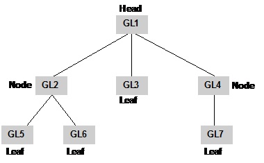

Oracle FLEXCUBE supports a multilevel structure for your bank’s Chart of Accounts. You can create broad groups of accounts in the categories of assets, liabilities, income, expenses, etc., and further divide these groups into several levels. The groups at each of these levels are referred to as GLs. For instance, you can create a three level GL structure as follows:
The GLs at the lowermost level are referred to as Leaf GLs. The balances and turnovers of leaf GLs are consolidated at higher level GLs called Node GLs. The GL at the top of the structure is referred to as the Head GL.
In the GL reporting hierarchy, a GL is a parent GL for GLs reporting to it. For instance, GL2 is the parent of GL 5 and 6, and GL1 is the parent GL for GLs 2, 3, and 4. The reporting GLs, GLs 5 and 6 in the first instance, are referred to as child GLs of GL 2. Similarly, GLs 2, 3, and 4 are child GLs with respect to GL1.
This multilevel GL structure can be maintained in the Chart of Accounts screen by the branch marked as the Head Office of your bank.
In Oracle FLEXCUBE, the GL balances are stored as currency wise balances as well as overall balance in LCY on GL level. This enables currency-wise break up of each GL account. However overall balance in local currency is also available.

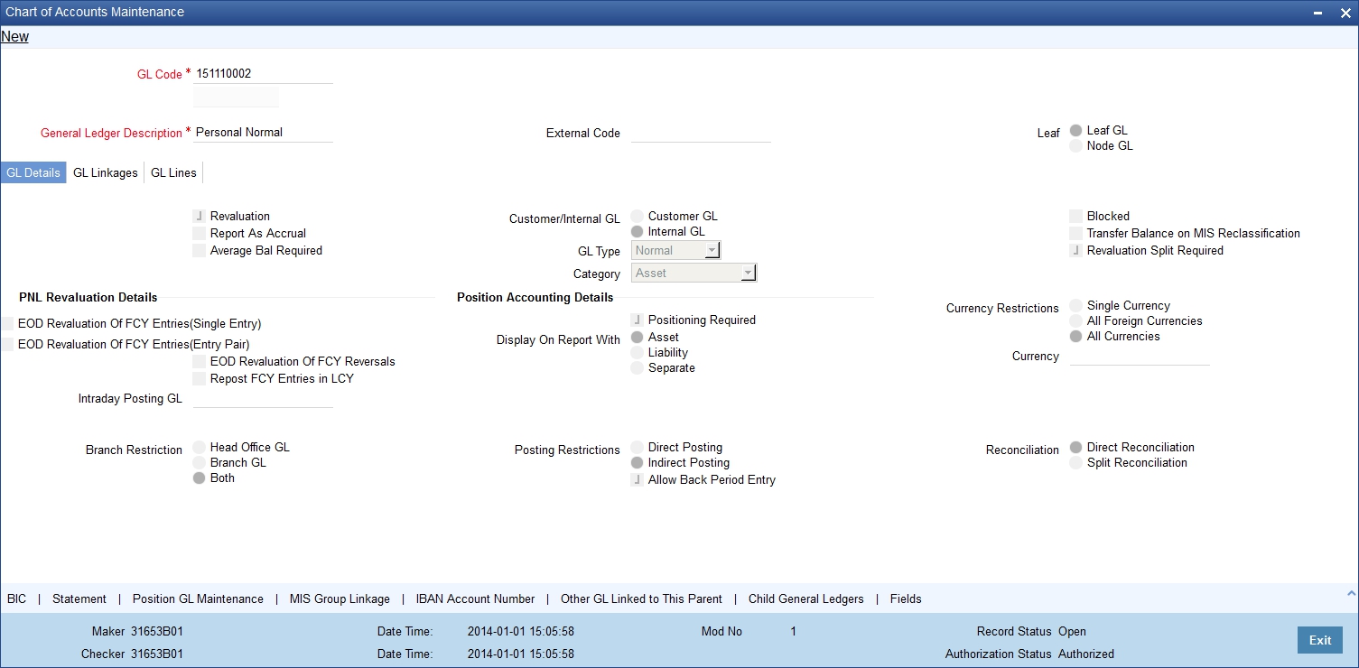

3.1.2 GL Details Tab
To define details for a GL, click on the tab titled GL Details. The details that you can specify for a GL depend on the type of GL that you create. If a particular field is disabled, it means that the field is not relevant to the type of GL that you are creating.
You can capture the GL Details in the following fields:
GL Type
For both customer and internal GLs that you create, you should indicate the type. The GL type is indicative of the type of accounting entries that are posted into the GL. For a customer GL, the GL type could be Normal, Misc. Debit, Misc. Credit, and Nostro. For an Internal GL, the GL type could be Normal, Misc. Debit, misc. Credit, cash, and inter-branch.
Those GLs in which a debit entry is to be offset with multiple credit entries or a credit entry to be offset with multiple debit entries should be assigned the Misc. Debit and Misc. Credit type respectively.
Miscellaneous debit and credit entries should be associated with an instrument number. This will ensure proper reconciliation of the debit and credit entries made to the GL. Choose this option to indicate that the GL should cater only to entries related to your bank s account with another bank. All cash transactions, like in the Data Entry module, are posted directly into a GL by linking the GL with the Till ID. Choose this option to indicate that only interbranch related accounting entries can be posted to the GL.
The debit or credit entries of accounts that do not fall into any of the other types can be assigned to the Normal Type GL. The leaf GLs that you create will be taken as Normal Type by default.

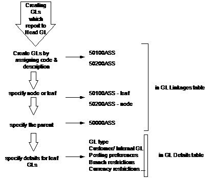

GL Category
GL category can be specified only for a GL head. A Head GL can be assigned any of the following categories:
Two Head GLs can have the same category. All GLs that fall under a Head GL will essentially belong to the category defined for the Head. Each category can have any number of GLs under it. But, the category allocated to a GL should be assigned at the head of any GL stream; all nodes and leaves by default take the category of the Head GL to which they report.

As indicated above, you can post direct entries (i.e., link it to your bank’s internal accounts) only to internal leaf GLs. For internal and customer node GLs and customer leaf GLs, you would associate accounts with them.
Avg Bal Required
Oracle FLEXCUBE will compute and store average balances for customer GLs on a daily basis. However, the average balance computation is performed on the basis of transaction dated balance and any value dated adjustment will not be considered for this computation.
If a working day is followed by any holiday(s), the average balance computation will be done as per the specifications defined in the GL Branch Parameter Maintenance screen. That is, the balance will either include the accumulated balance for the number of days inclusive of the following holidays or the system will compute the balance on the next working day.
Note
The system will compute and store average balances for customer GLs only if you select the Avg Bal Required option. You will not be allowed to modify this option at a later date. The balances will be computed on a daily basis and will be based only on booking dated transactions.
The system will store debit, credit and net average balances in FCY as well as in LCY.
Note
In the case of back dated transactions, the system will not update the average balances of previous periods.
You can query the average balances of customer GLs in the GL Average Balances screen. The query can be done using the following, either individually or in combination:
Note
Report As Accrual
Check against this field if you want the system to calculate the accrual entries posted to this GL independently for displaying during the online query of FX positions. Depending on your selection in this field, system will arrive at the cash and accrual positions.
Revaluation
Specify whether currency revaluation is applicable to the GL. Check against the Revaluation option to indicate that the GL should be revalued. Leave it unchecked to indicate otherwise.
You can revalue the balances of asset, liability, contingent asset, and contingent liability GLs. You can also revalue the balances in Income / Expense GLs. If you indicate that revaluation is applicable, Oracle FLEXCUBE will revalue the GL when the End of Day (EOD) process is run.
Note
If transaction entry happens on STANDARD rate then the system does not post any reval­uation, even though you have enabled revaluation for the GL002C
Transfer Balance on MIS Reclassification
Indicate whether the MIS balances in the GL must be transferred, upon MIS reclassification, into the new MIS code.
A batch process performs the transfer of balances upon reclassification, for each GL for which this option has been set.
Blocked
Oracle FLEXCUBE offers you the option to temporarily mark the status of the GL as Blocked. During this period, no entries can be passed into the GL. You can open a GL marked with blocked status by unchecking the blocked status box.
This feature is useful as you need not close the GL. Blocking is temporary whereas closure is permanent.
Reval Split Required
You can choose to break-up revaluation profit/loss for the GL you are defining into:
The following example compares the accounting entries posted when you do not choose to split revaluation profit/loss and when you do.
Note
The revaluation splitting is done for revaluation-into GL’s also.
Refer the chapter ‘Account Revaluation Maintenance’ in the Core Services User Manual for further details about revaluation.

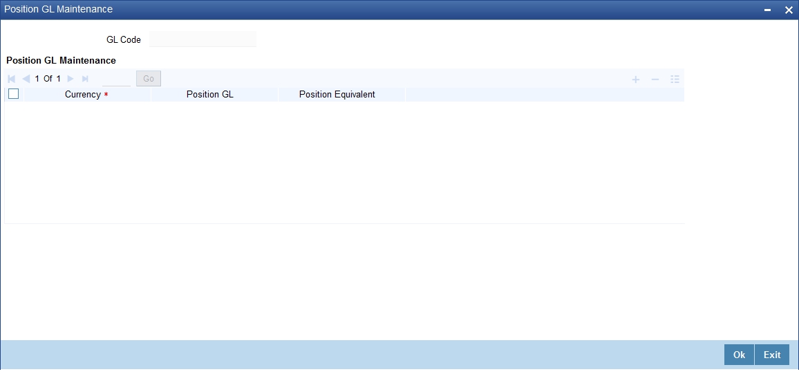

3.1.2.2 Indicating Position Account Details
Positioning Required
You can retrieve the position of a foreign currency, any time, by opting for Position Accounting in your bank. When you opt for position accounting, you maintain a Position GL and a Position Equivalent GL for every foreign currency maintained in your bank. The Position GL reflects the current position in the currency. You can opt for position accounting while indicating your preferences in the Bank-Wide Parameters screen.
If you opt for position accounting while defining Bank-Wide Parameters, you can maintain Position GLs and Position Equivalent GLs for every foreign currency that your bank deals in. When maintaining the GLs in your bank, you can opt to link the different currencies, associated with the GL, to:
In the GL Category field, indicate if you are maintaining a Position GL or a Position Equivalent GL.
The position accounting happens event and entry pair-wise. Each entry is considered. If any currency mismatch is found then position accounting for each posting pairs are considered for position accounting.
Example
You have initiated an FT transaction where account is denominated in USD but the transfer amount is EUR. Charge is calculated in USD. In this case, the system will pass position entries for transfer amount as well as charge amount.
If transfer happens in USD from an USD account while charge is settled in EUR from an EUR account number position entry will be posted as no currency mismatch exists.
Display on Report With
When you maintain a Position GL, you can define the manner in which you would like the currency position to be reported in the Currency-Wise Position report.
In the Display on Report With field, under Position Accounting Details, indicate if you would like the currency position to be reported under one of the following:

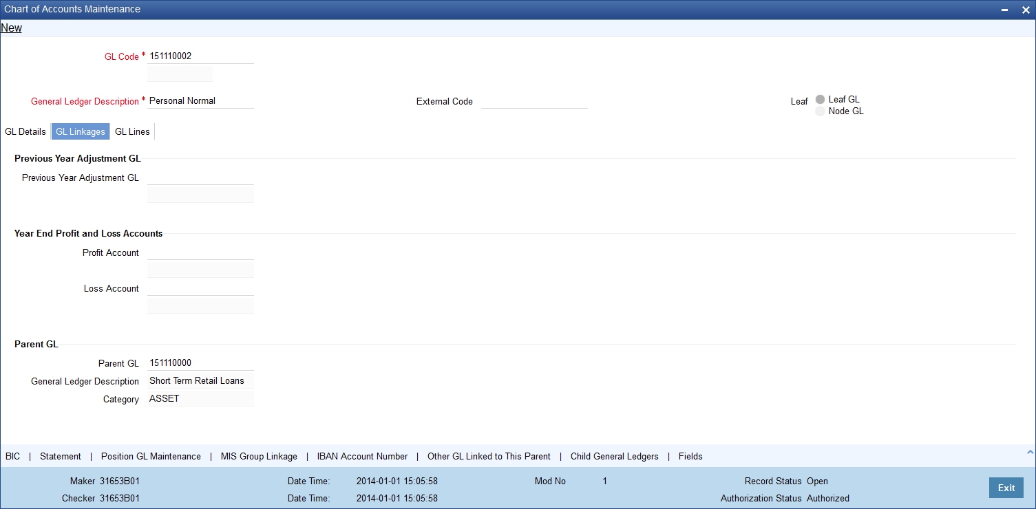

3.1.3 GL Linkages Tab
Click the tab titled GL Linkages from the Chart of Accounts screen to define linkages for the GL that you are defining.
In the GL Linkages screen you maintain the following:

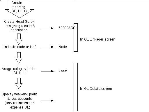

3.1.3.1 Indicating Parent GL
Parent GL
You can indicate the GL to which the current GL should report. This GL in effect becomes the parent of the current GL. You can select a parent GL from the option list available. The option list will contain only a list of Node GLs that you have already created.
Category
You can assign a Category only to a Head GL (a GL that does not report to another GL). If the GL that you indicated as the parent GL, is a Head GL the category assigned to it is also displayed.
3.1.3.2 Indicating Year-End Profit & Loss Accounts
Profit A/C
You can specify the accounts into which the year-end profit or loss entries for the GL should be posted.
The profit account is the account into which all income GL account balances are posted at the end of the year. On the last day of the financial cycle all balances from the account are posted into the year-end profit account. You can select an account code from the option list available.
Loss A/C
The Loss account is the account into which all expense GL account balances are posted at the end of the year. On the last day of the financial cycle, all balances from the loss accounts are posted into the year-end loss account.
You can specify the same GL for posting both your profits and losses.
3.1.3.3 Identifying Previous Year Adjustment GL
Prev Yr Adj GL
You can indicate the GL to which the previous year’s adjustment entries for unrealized income and expense are to be posted. As a result the system automatically posts adjustment entries between Unrealised Income/Expense GL and an Adjustment GL for the interest/commission accrued in the Previous year, as these would already have moved to the year-end P and L GL during financial closure.
Adjustment entries are passed at the contract level to the effect that the improper balances on Revaluation Income/Expense GL’s on account of Reversal of Previous Day’s Revaluation entries (if there was a financial movement in between), get corrected.
Note
Revaluation of unrealized P and L GLs is performed only for interest and commission en­tries and is therefore applicable for the Money Markets, Trade Finance (LC, BC), Securi­ties and Derivatives modules of Oracle FLEXCUBE.

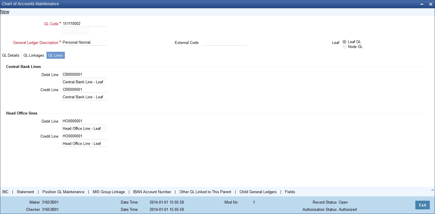

3.1.4 GL Lines Tab
To understand the sequence of steps involved in creating a new reporting line structure, let us take the following example:

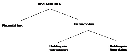

Requirement
Assume you need to create a reporting line for your Head Office, representing investments of your bank. Under the head Investments, your Head Office wants information classified under financial investments and business investments.
Further, under business investments, you require to report holdings in subsidiaries and holdings in associates.
Solution
To create this new reporting structure, invoke the Reporting Lines Maintenance screen. First create the Head Reporting Line. In our example, it is Investments and assign it a description and a category - asset. Leave the parent details blank, since this does not report to another line.
Then create the lines at the second level, Financial investments, and Business investments. Indicate Investments as the Parent line for both these lines.
Thereafter, create the third level of GLs holdings in subsidiaries and holdings in associates respectively. Specify their parent line as Business investments. The category assigned to the Parent Line is defaulted.
The hierarchical structure of this Head Office reporting line would be as follows:
After you have defined Central Bank and Head Office lines, you can indicate the leaf GLs that should report to the line. While creating a GL, you can indicate the Central Bank or Head Office line to which it should report.
Click on the ‘Reporting Lines’ tab on the ‘Chart of Accounts Maintenance’ screen to indicate the reporting lines to which leaf GLs should report. A GL that you create can report to Central Bank and Head Office reporting lines.
3.1.4.1 Associating GL with Central Bank Reporting Line
For Central Bank reporting purposes, you should associate a GL with a debit and credit reporting line.
Debit Line
The Central Bank debit line indicates the line to which an account under a GL should report, if in debit.

3.1.4.2 Associating GL with Head Office Reporting Line
In order to include a GL under a Head Office reporting line, you should associate it with debit and credit reporting line.
Debit Line
The Head Office debit line indicates the line to which an account under a GL should report, if in debit.
Credit Line
Similarly, you can indicate the line to which an account under a GL should report, if in credit.
You can select a reporting line from the option list. The option list will contain a list of all the lines maintained in the Reporting Line Maintenance screen. The description of each specified reporting line appears alongside the line number. The debit and credit reporting lines you define for a leaf can be the same. After you have made the required entries save the entries.

For example, let us assume that your GL Head of Overdrafts is structured as follows:
Suppose AS190100 is on display in the field GL Code. On choosing the other GLs linked to this parent option, the following list will be displayed:
GL Code
GL Description
AS190200
OD Retail Lending
AS190300
OD Clean
AS190400
OD Others
If you click on Child GLs for the Current GL the following list will be displayed:
GL Code
GL Description
AS190101
OD Stocks
AS190102
OD Book Debts
Thus by clicking on the second option under hierarchy level, you can view the list of GLs that report to the current GL.
To understand the sequence of steps involved in creating a new GL structure, let us take an example:
For example, assume you are creating an asset Head GL for bank balances held with other banks.
Your GL mask is defined as NNNNNAAAD in the Bank-wide Parameters screen. You assign a GL code 50000ASS D to the Head GL. D is the last element of the code, which is system generated and is called the check digit. It will be an alphabet of the English language if it is represented in the mask as d and will be numeric if it is represented as D.
Under GL 50000ASS, you want to create two sub-GLs - 50100ASS representing balances with Federal Reserve Bank and 50200ASS representing balances with Commercial banks.
Under sub-GL 50200ASS stand two GLs -- 50201ASS and 50202ASS representing balances with commercial banks in local currency and foreign currency respectively.
The hierarchical structure of this GL tree is as follows:
To create this new GL structure, invoke the 'Chart of Accounts' screen, the 'GL Linkages' screen is displayed. Click new icon. A new screen with no prior inputs will be invoked.
You can click on any of the four broad heads listed atop the screen to activate that screen. Follow the given sequence of steps:
Step 1:
Step 2:
Step 3:
and so on...

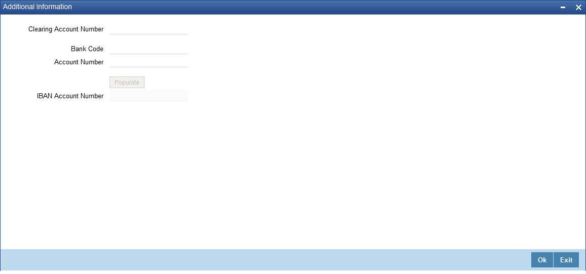

3.1.7 IBAN Account Number Button
For an internal Leaf GL you can maintain the Clearing Account number to be used for outgoing payments where the internal GL is the remitter account. Click ‘IBAN Account Number’ button in the ‘Chart of Accounts’ screen.
The ‘Additional Information’ screen is displayed.
In this screen, you can specify the Clearing Account Number for the GL and the Bank Code of the GL. If a Clearing Account maintained for a GL is found in an uploaded incoming payment the System resolves the actual GL for the payment as per your maintenance in this screen.
Click 'Populate' button to default the IBAN Account Number based on bank code and account number. If the IBAN Number maintained for a GL is found in the incoming payment the System resolves the actual GL as per your maintenance in this screen.
3.1.8 Position GL Maintenance Button
When defining a GL in the Chart of Accounts, you must link all the foreign currencies linked to a GL to a Position GL, and a Position Equivalent GL if you have opted for position accounting in the Bank Wide Parameters screen.
If you do not want position accounting for a particular GL, do not choose the Positioning required option under Position Accounting Details in the Chart of Accounts. Click ‘Position GL Maintenance’ button in the ‘Chart of Accounts’ screen. The ‘Position GL Maintenance’ screen is displayed.
In this screen, you can:
You can choose to retain the Position GL that defaults (according to your specifications in the Currency Maintenance screen), or indicate a Position GL of your choice.
Note
You should maintain Position GLs before you can identify one for a GL that you are main­taining.
