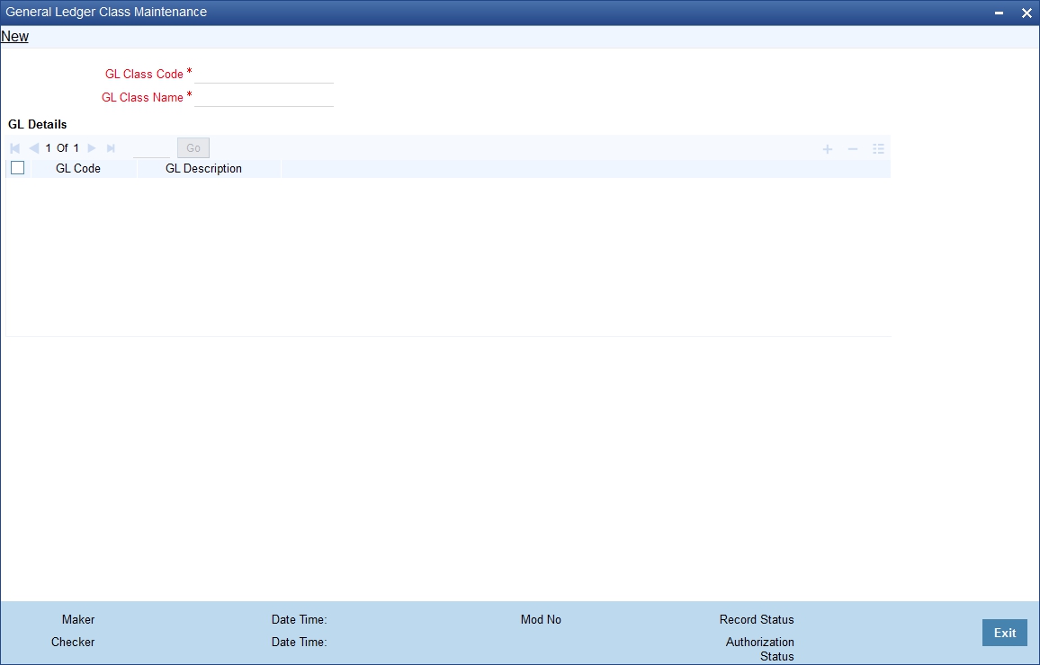

You can group GL charts of accounts that belong to the particular business entities through the ‘General Ledger Class Maintenance’ screen. You can invoke the ‘General Ledger Branch Parameters Maintenance’ screen by typing ‘STDGLCMT’ in the field at the top right corner of the Application tool bar and clicking the adjoining arrow button.
GL Class Code
Specify the unique code given to the specific group of GLs. You can enter a maximum of 3 alphanumeric characters.
GL Class Name
Specify the GL Class Code name. You can enter a maximum of 255 alphanumeric characters.
GL Code
Specify the GL code. The adjoining list displays all the GL codes maintained in the system. You can choose the appropriate one.
GL Description
The system displays the GL account description.
