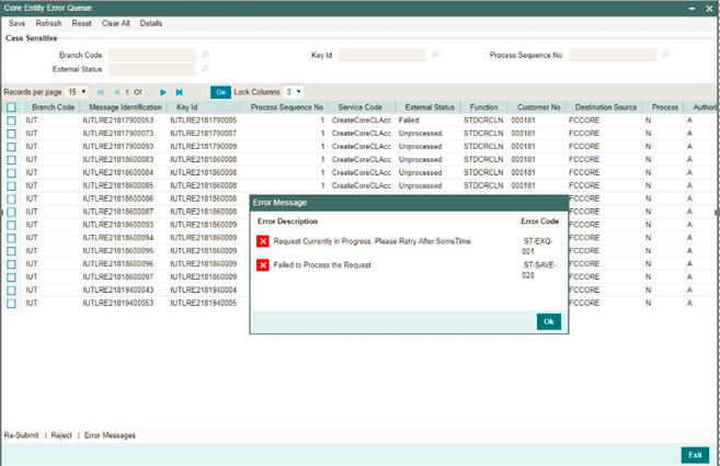

You can query and perform manual actions on requests using the ‘Core Entities Processing Queue’ screen. You can invoke this screen by typing ‘IFDCRERQ’ in the top right corner of the Application toolbar and clicking the adjoining arrow button.
Core entity request is moved to Timed out status based on the time out parameter maintained. If no response is received from the external system within the given time, status is marked as timed out.
In the above screen, you can base your queries on any or all of the following parameters and fetch records:
By default all error records shall be displayed.
Select any or all of the above parameters for a query and click ‘Search’ button. The system displays the following records meeting the selected criteria:
You can click ‘Resubmit’ and ‘Reject’ buttons in the bottom of the screen to process the error records. External status field will display the type of error like Timeout, Failed etc.
You can submit the record for processing again by selecting single or All records and clicking ‘Resubmit’ button. If the record fails, then the error details can be viewed by clicking ‘Error Messages’ button.
You can also reject such records by clicking ‘Reject’ and can manually create these records in Core.
The records that failed due to processing should be handled operationally.
