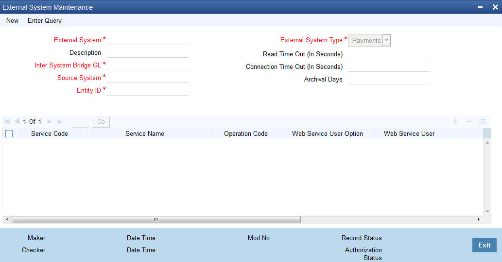

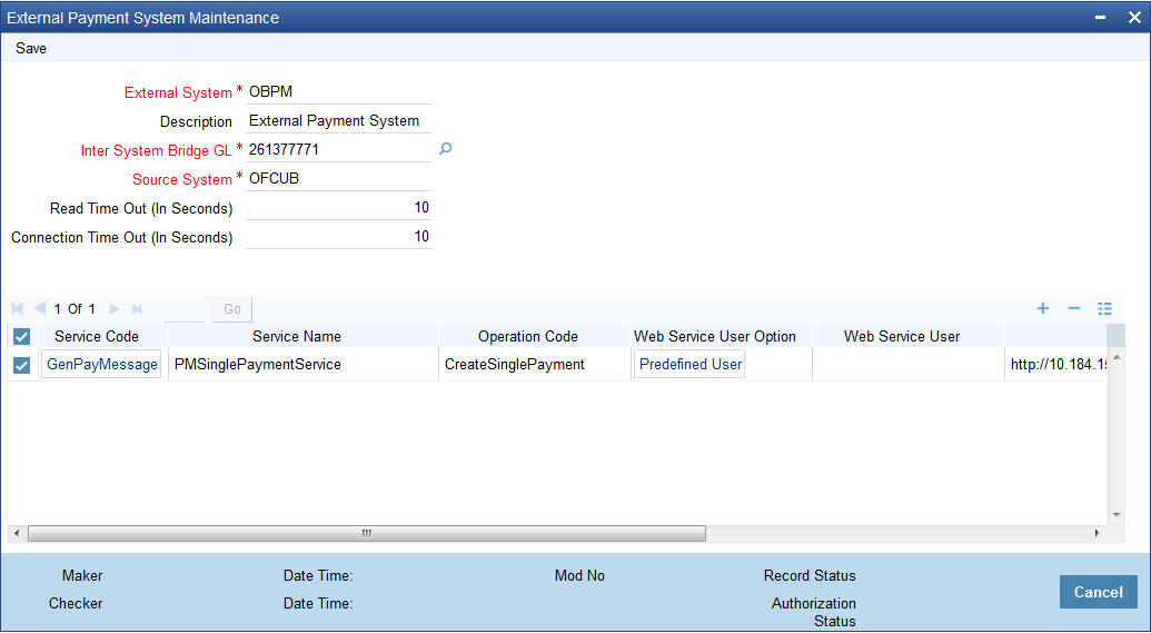

Maintaining External System
You can capture the details of external payment system in External System Maintenance screen. You can invoke this screen by typing ‘IFDEPSMT’ in the top right corner of the Application toolbar and clicking the adjoining arrow button.
You can maintain the following details in this screen:
External System
Specify the name of the External Payment System.
Description
Give a brief description on External Payment System specified.
Inter System Bridge GL
Specify the Bridge GL account for Inter System Accounting. Alternatively, you can select the Inter System Bridge GL from the option list. The list displays all valid options.
Source System
Specify the name of the source system.
Entity ID
Specify the entity ID. Current Entity value is defaulted and this value can be changed
External System Type
Select the type of external system from the drop-down list. The list displays the following options:
Read Time Out (In Seconds)
Specify the web service read time out in seconds.
Connection Time Out (In Seconds)
Specify the web service connection time out in seconds.
Archival Days
Specify the number of archival days required.
Service Code
Select the service code from the drop-down list. The list displays the following options:
Note
The options GenPayMessage, GenInstrIssue and GenDDMessag can be selected only if the External System Type is selected as ‘Payments’.
Service Name
Specify the web service name.
Operation Code
Specify the web service operation code.
Web Service User Option
Select the web service user option from the drop-down list. The list displays the following values:
Web Service User
Specify the web service user ID. This field is applicable only if ‘Web Service User Option’ is selected as ‘Predefined User’.
Web Service URL
Specify the web service URL.
You can view the external payment system maintenance details in ‘External Payment System Summary’ screen. You can invoke the summary screen by typing ‘IFSEPSMT’ in the top right corner of the Application toolbar and clicking adjoining arrow button.

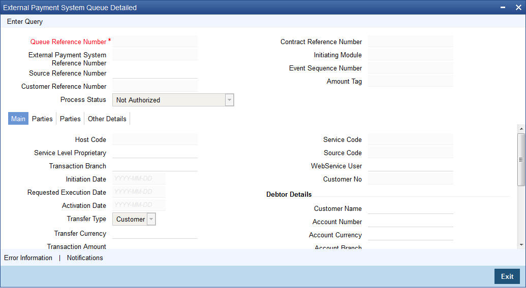

External Payment System Queue
You can view the details of payment request sent or to be send to an external payments system through ‘External Payment System Queue’ screen. You can invoke this screen by typing ‘IFDEPSQU’ in the top right corner of the Application toolbar and clicking the adjoining arrow button.
Queue Reference Number
Specify the queue reference number and click ‘Execute Query’ to view the details of payment request sent to external payment system.
Process Status
The system displays the process status. The list displays the following options:
Process Status
Description
Not Authorized
Contract initiated and the payment request is unauthorized
Un Processed
Payment request pending for processing
Web Service Con­nection TimeOut
Web service call, timed out during payment request processing
Payment Approved
Payment request initial validation is successful and request is accepted
Payment Rejected
Payment request initial validation is failed and request is rejected
Payment Pro­cessed
All payment processing is completed and request is successfully processed
Repair
Payment request moved to repair queue due to exception in payment life-cycle
Contract Cancelled
Contract initiated and the payment request is reversed
Future dated
Payment contract not yet initiated. Future value dated payment request.
Payment Cancelled
Payment contract cancelled from one of the queue in external payment system
Acknowledgement Received
Acknowledgment (ACK) received from payment network
Negative Acknowl­edgement Received
Negative acknowledgment (NACK) received from payment network

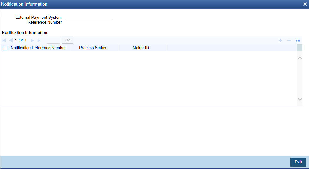

Click ‘Error Information’ button to view Error Information screen.This screen displays the error or warning codes and messages received as response for the payment request.
Click ‘Notifications’ button to view the notifications screen.This screen displays the notification details received from the external payment system
Process Status
The system displays the process status. The drop-down list displays the following options:
Process Status
Description
Un Processed
Notification is pending for processing
Processed
Notification processed successfully
Processing Failed
Notification processing failed due to unex­pected failure
Improper Notification
Notification received is not in proper format
Empty Notification
Empty notification received

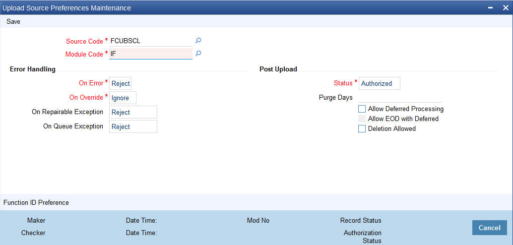

FCUBS-OBPM Integration Maintenance for Outgoing Payments and Message Generation
Oracle FLEXCUBE supports integration with Oracle Banking Payments (OBPM) for outgoing payments and message generation. You have to maintain the following details in FCUBS for integrating with OBPM for outgoing payments and message generation:
The following scheduler jobs configured for the integration should be run during the integration:
For maintenance required for OBPM, please refer the Oracle Banking Payments Manual ‘Co-deployed Setup User Guide’.

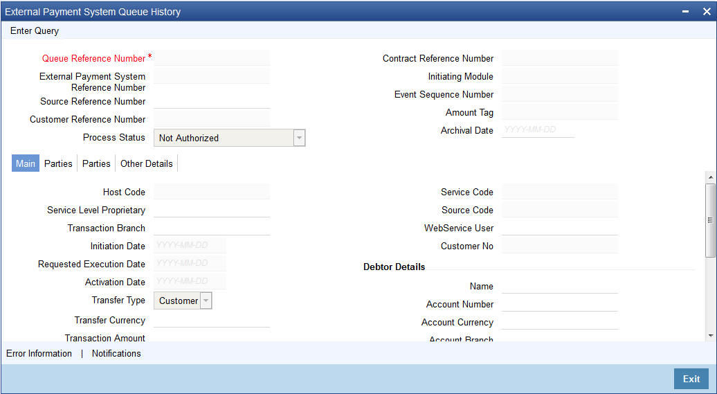

External Payment System Queue History
You can view the details of external payment request in ‘External Payment System Queue History’ screen. You can invoke this screen by typing ‘IFDEPSQH’ in the top right corner of the Application toolbar and clicking the adjoining arrow button.
Click ‘Enter Query’ to view the archived records along with the archival date.
