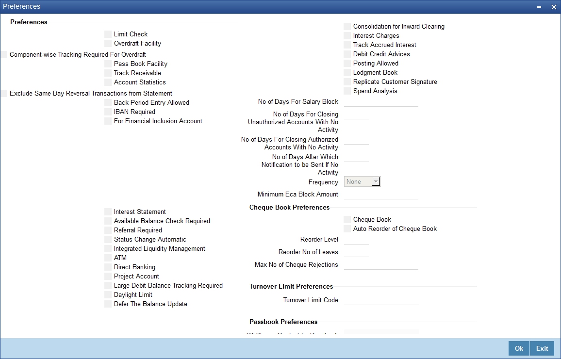

You need to maintain certain parameters before you define account structures for integrated liquidity management process. They are:
You can use the Account Class feature in Oracle FLEXCUBE to create a set of accounts which have the same characteristics. You can invoke the ‘Account Class Maintenance’ screen by typing ‘STDACCLS’ in the field at the top right corner of the Application tool bar and clicking on the adjoining arrow button. Click on the ‘Preferences’ button in the ‘Account Class Maintenance’ screen to invoke the ‘Preferences’ screen.
You are required to input the following details in this screen:
Integrated LM
Check this option to indicate that accounts created under this Account Class should be part of an ILM Structure. If the option is checked, the system creates system accounts (internal accounts) for each account that is linked in a pool/sweep structure and tracks the balances on both the actual accounts as well as these system accounts. It also calculates interest on these system accounts.

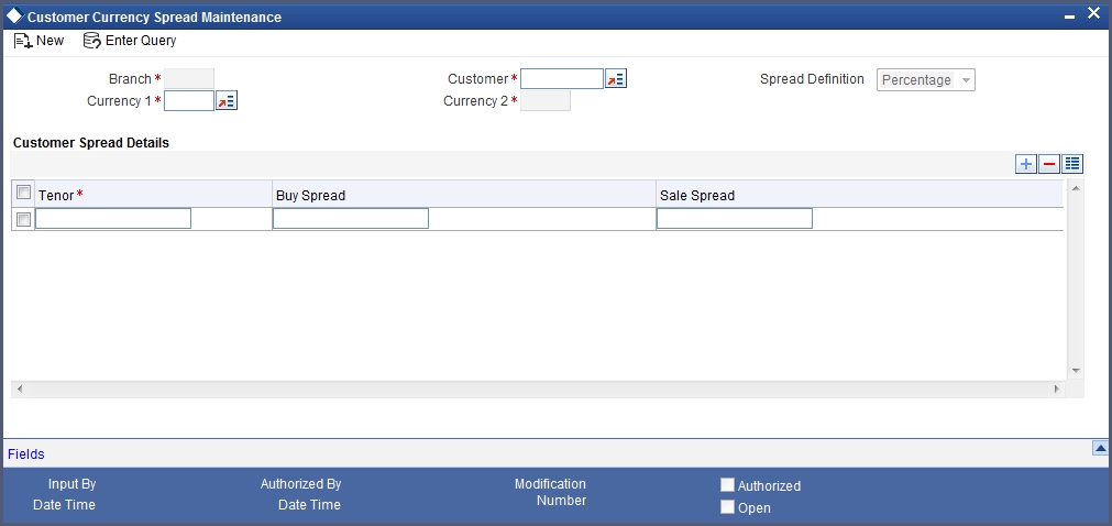

For a given customer and currency pair, you can define buy and sell spreads in different tenors (in days). The system defaults the spread to zero if you have not maintained any spread for a customer.
You can maintain spreads for a customer in the ‘Customer Currency Spread Maintenance’ screen. You can invoke the ‘Customer Currency Spread Maintenance’ screen by typing ‘CYDCUSPR’ in the field at the top right corner of the Application tool bar and clicking on the adjoining arrow button.

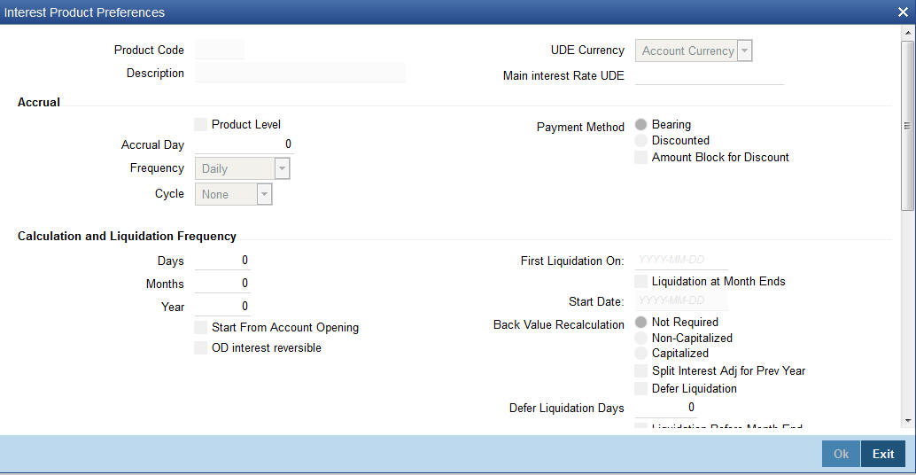

You can invoke the ‘Interest And Charges – Interest Product Preferences’ screen by clicking ‘Preferences’ button on the ‘Interest And Charges Product Maintenance’ screen. You can invoke the latter by ‘typing ‘ICDPRMNT’ in the field at the top right corner of the Application tool bar and clicking on the adjoining arrow button.
You can input the following details in this screen:
Integrated LM
Choose this option if you want to use the product for Integrated Liquidity Management processing.
Integrated LM Type
Specify the type of System Account to which the product ought to be linked. It can be:
Refer the chapter ‘Annexure A - Accounting Entries’ in this User Manual for suggested IC products.

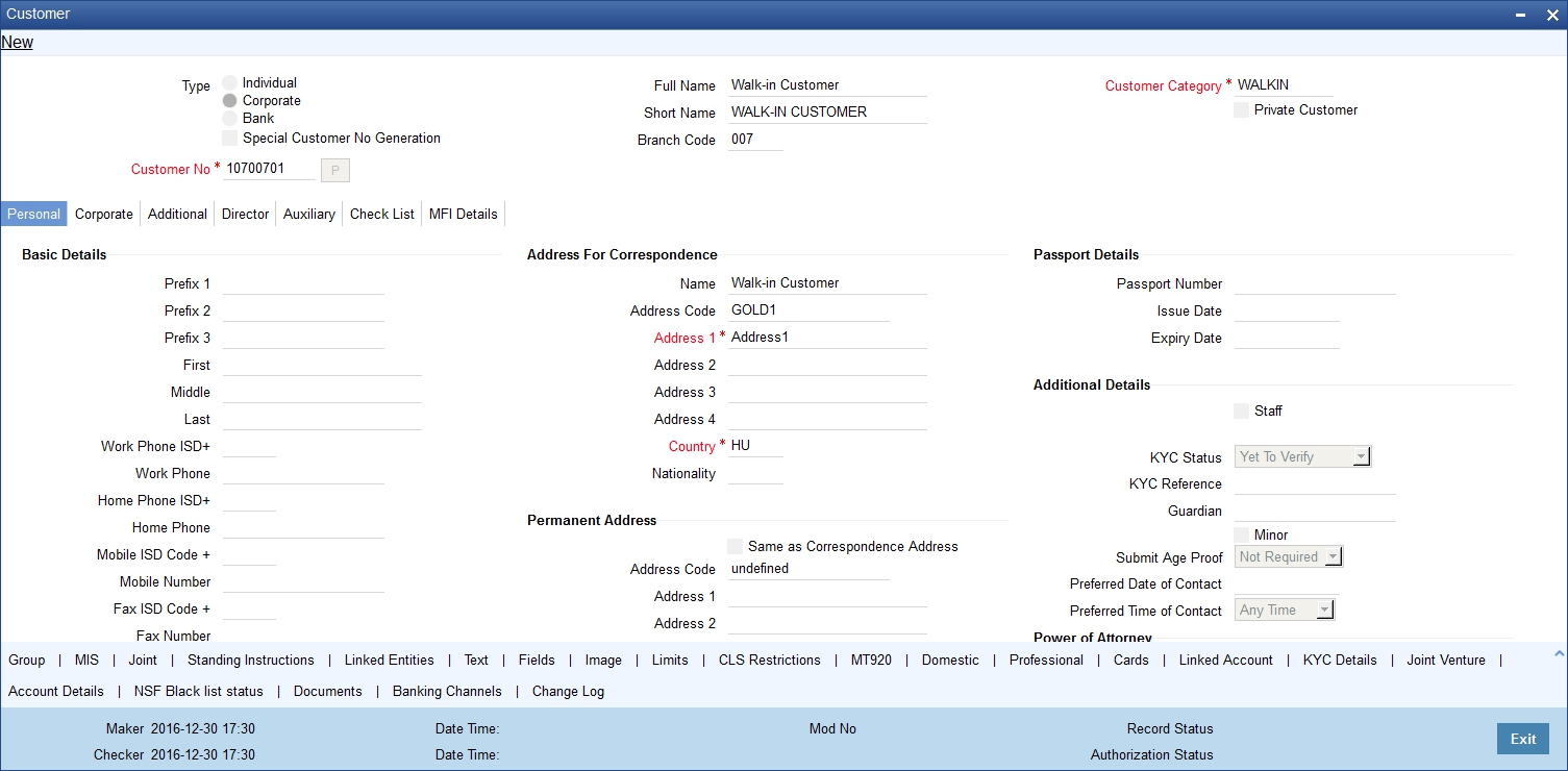

You can invoke the ‘Customer Maintenance’ screen by typing ‘STDCIF’ in the field at the top right corner of the Application tool bar and clicking on the adjoining arrow button.
Apart from serving as a means to collect basic information about a customer, the ‘Customer Information Maintenance’ screen also reflects the hierarchy existing between a Parent company and its various subsidiaries. The subsidiaries take on the Customer Number of the parent company as their Liability number.

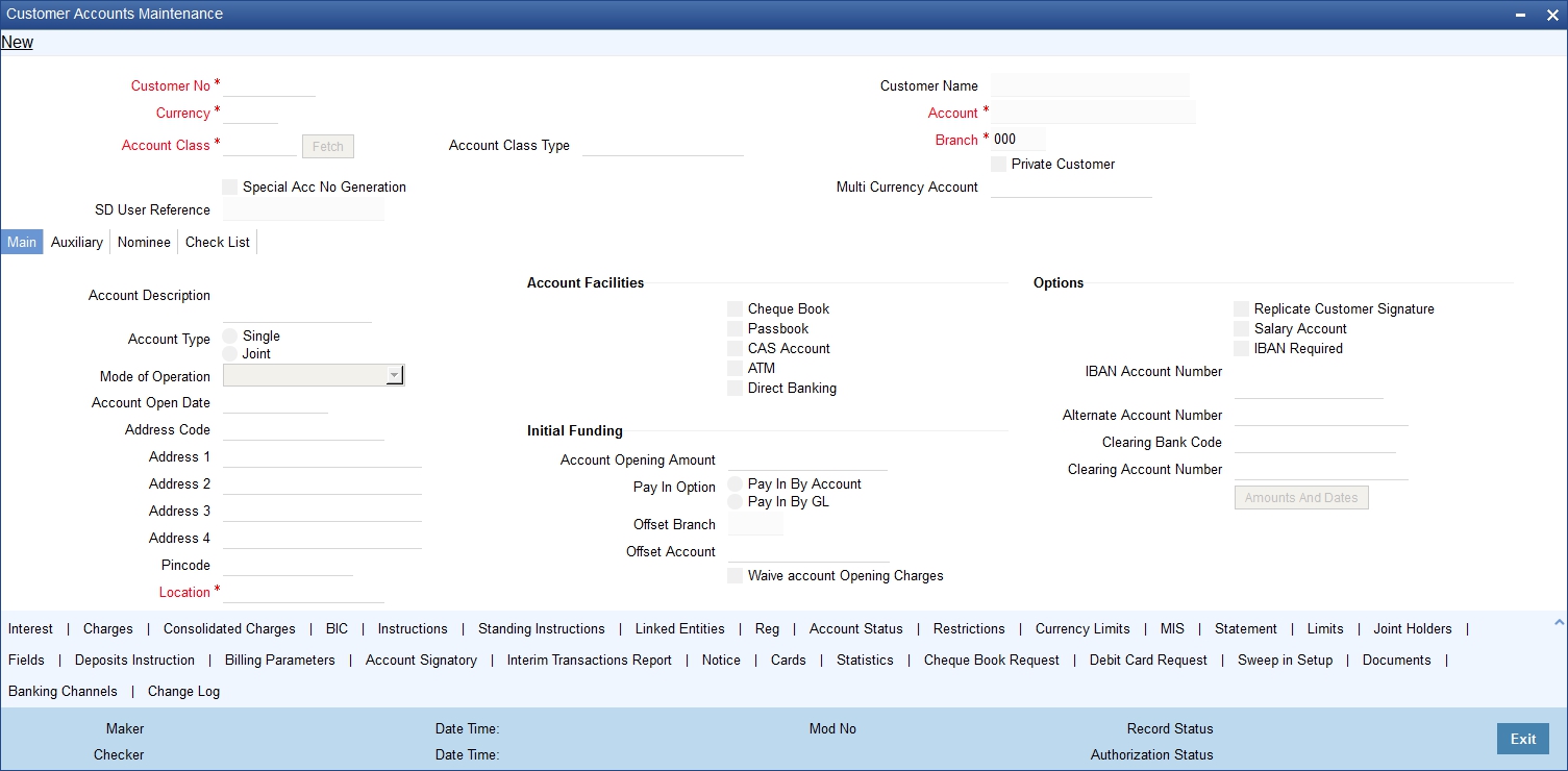

The ‘Customer Accounts Maintenance’ screen is used to create accounts for a given Customer using the desired account class and currency combination. You can invoke the ‘Customer Accounts Maintenance’ screen by typing ‘STDCUSAC’ in the field at the top right corner of the Application tool bar and clicking on the adjoining arrow button.

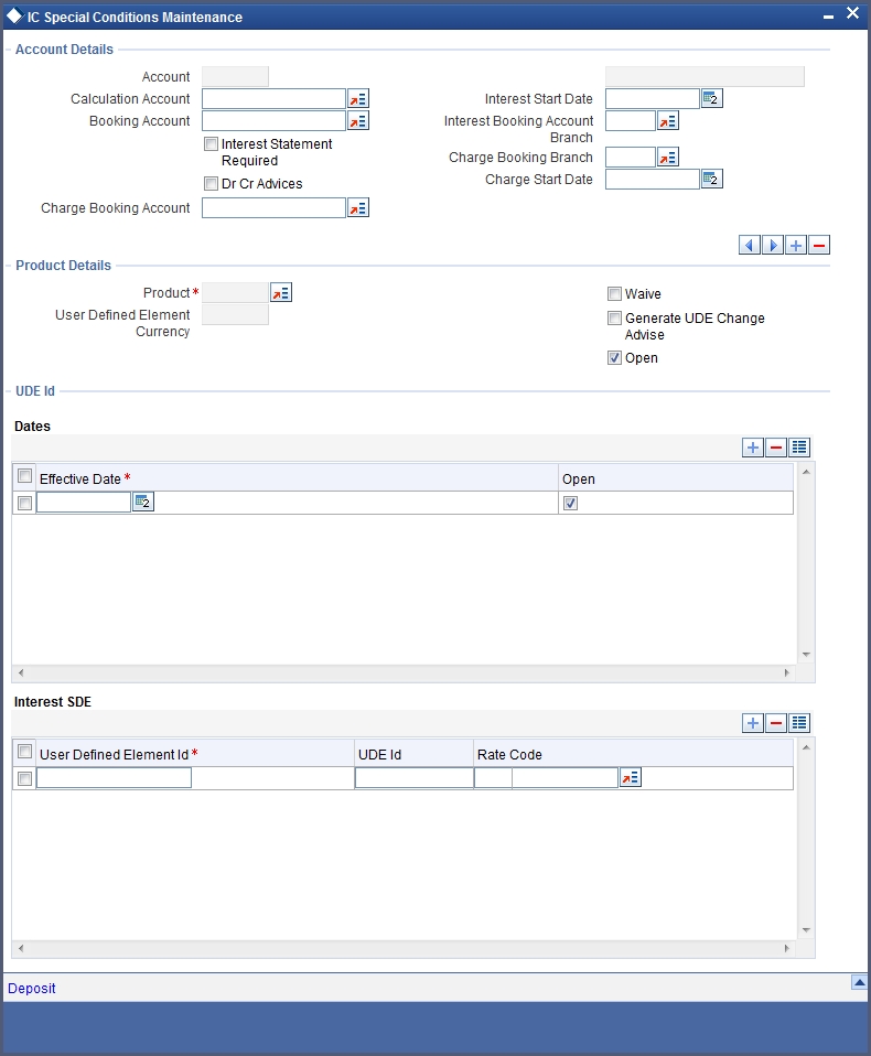

Click ‘Interest’ button in ‘Customer Account Maintenance’ screen to invoke ‘IC Special Conditions Maintenance’ sub-screen, where you can maintain IC special conditions for ILM accounts.
The system displays the following fields on the basis of your choice in the IC Rule and IC Product screens.
Integrated LM
The system defaults the value specified in the product screen from based on product selected from the option list.
Integrated LM Type
The system displays the value on the basis of your choice in the IC Rule and IC Product screens.

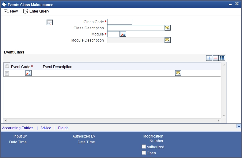

When you define an Events Class, you choose, first of all, the set of events that would belong to the class. Events are, usually, unique to a module.
The events that you would like to include in an Events Class can be identified through the ‘Events Accounting Entries and Advices Class Maintenance’ screen. This screen is invoked from the Application Browser.
You can invoke the ‘Events Class Maintenance’ screen by typing ‘CSDACTCL’ in the field at the top right corner of the Application tool bar and clicking on the adjoining arrow button.
You can maintain the following details in this screen:
Class Code
An Events Class is identified with a unique Code and a Description. This indicates the name of the event class to which the events for ILM processing will be linked.
Description
You need to enter a brief description for the class code.
Module
Events are, usually, unique to a module. Specify the module as IL to define the events for Liquidity Management module.
Events Description
Once you specify the class code and module, click on add icon. The system will display the events associated with the Integrated Liquidity Management module.

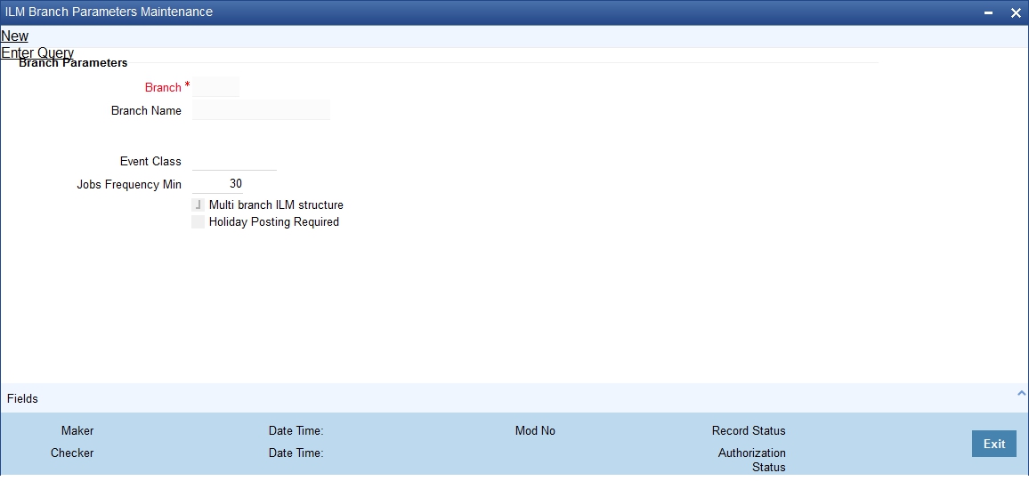

After you define the accounting entries that need to be passed for a set of events, you need to associate the event accounting entries to the branches of your bank.
You can invoke the ‘ILM Branch Parameter Maintenance’ screen by typing ‘ILDBRPRM’ in the field at the top right corner of the Application tool bar and clicking on the adjoining arrow button.
You are required to input the following details:
Event Class
Choose the event class that you wish to associate to the branch.
Multi branch ILM structure
Check this option to indicate that multi-branch ILM structure is applicable for this branch. In case you wish to modify the option by un-checking it, the system allows it only if there are no existing active groups for the multi-branch.
Job Frequency Min
Specify the frequency for the processing of MBCC Jobs for a branch. The default value of Jobs Frequency is 30.

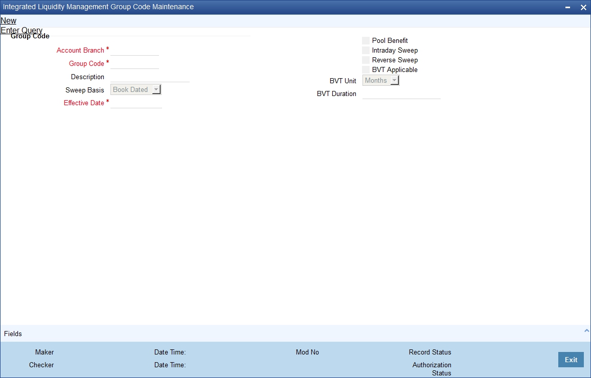

In Oracle FLEXCUBE, you can bring together several accounts to form a ‘Group’ for ILM processing. You can then link this group code to the Header Account maintained as part of Account Structure. In Oracle FLEXCUBE, group codes allow you to uniquely identify a given account structure for ILM processing.
You can invoke the ‘Integrated Liquidity Management Group Code Maintenance’ screen by typing ‘ILDGRPCD’ in the field at the top right corner of the Application tool bar and clicking on the adjoining arrow button.
Group Code and Description
Enter a unique code to identify the group code in the system. Enter a brief description.
Effective Date
Specify the date from which the group will become active in the system. You will not be allowed to input Back Valued Dates (BVT) here.
Sweep Basis
You need to indicate if the sweep should be performed on Book Dated balance or Value Dated Balance for the entire structure falling under the group. If BVT support is required, it must have ‘Value Dated’ option.
Pool Benefit
If you select this option, interest re-allocation is carried out for the child accounts involved in the group.
Reverse Sweep
Indicate whether reverse sweeps should be performed during BOD batch.
BVT Applicable
Specify if BVT processing is applicable for a group
BVT Unit
Indicate the unit the system should consider while calculating the BVT date. This can be Days/Months
BVT Duration
This indicates the number of BVT units allowed as back period from today’s date while calculating BVT date.
For instance, to indicate 30 Days input ‘Days’ as BVT Unit and ‘30’ in the BVT Duration fields. Similarly, to indicate 2 months, the BVT Unit should be ‘Months’ and the BVT Duration ‘2’.

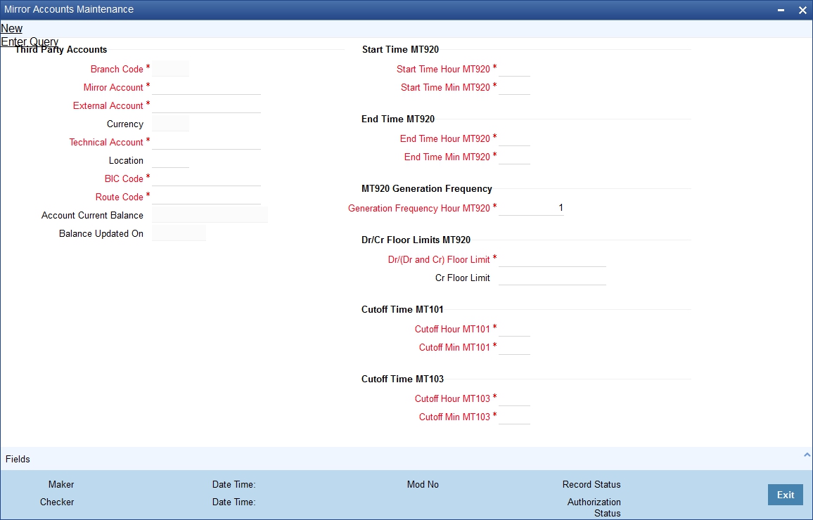

A Third Party Account is an account which is located in another bank which is not part of your bank, but is part of the Liquidity Management Account Structure maintained with your bank. The funds can be moved from or to the Third Party accounts. To establish a relationship between the accounts in Oracle FLEXCUBE and the third party accounts, you first need to maintain a mirror account of such accounts as normal CASA accounts in Oracle FLEXCUBE and then capture the parameters of the Third Party Accounts in the ‘Mirror Accounts Maintenance’ Screen.
The Mirror accounts can be created at your branch in the country where the Third Party Account is located/your branch in the country where the Header account of the Group is located. The funds to be moved to/from the Third Party Account will be routed through this CASA account.
The Mirror Account will be used to capture parameters for message generation. The balance information obtained from the Third Party Bank will be stored in the Mirror Account.
The Third Party Account details are maintained in the ‘Mirror Accounts Maintenance’ screen. You can invoke the ‘Mirror Accounts Maintenance’ screen by typing ‘ILDMIRAC’ in the field at the top right corner of the Application tool bar and clicking on the adjoining arrow button.
You need to maintain the following parameters in this screen:
Mirror A/c
This indicates the account number in Oracle FLEXCUBE.
External A/c
You need to indicate the account number in the third party bank.
Currency
The system defaults the account currency.
Technical A/c
This indicates the CASA account linked to the mirror account.
Location
This indicates the location of the third party bank.
BIC
Indicate the BIC Code of the third party bank.
Route Code
Specify the route code based on which the system will pick up the settlement instructions from ARC settlement instructions maintenance for third party accounts, for the generation of payment messages.
Account Current Balance
The system will display the balance of the external account sent by the last MT 942 message.
Balance Update On
The system displays the date on which the last MT942 message was received.
Start Time MT920
Here, indicate the time at which the first MT920 message for a day should be generated.
End Time MT920
You need to specify the time at which the last MT920 message for a day should be generated.
MT920 Generation Frequency
Here you need to indicate the interval (in hours) at which MT920 should be generated.
Dr/(Dr and Cr) Floor Limit
Specify the debit floor limit of the account. If the credit floor limit is not separately specified, this will indicate both the debit and the credit floor limits.
This value indicates 34F tag value of MT920.
Cr Floor Limit
Specify the credit floor limit of the account. This value indicates 34F tag value of MT920.
Cutoff Time MT101
You need to indicate the time at which MT101 should be generated for sweeping in funds from the Third Party Account.
Cutoff Time MT103
You need to indicate the time at which MT103 should be generated for sweeping out funds from the Parent Account.

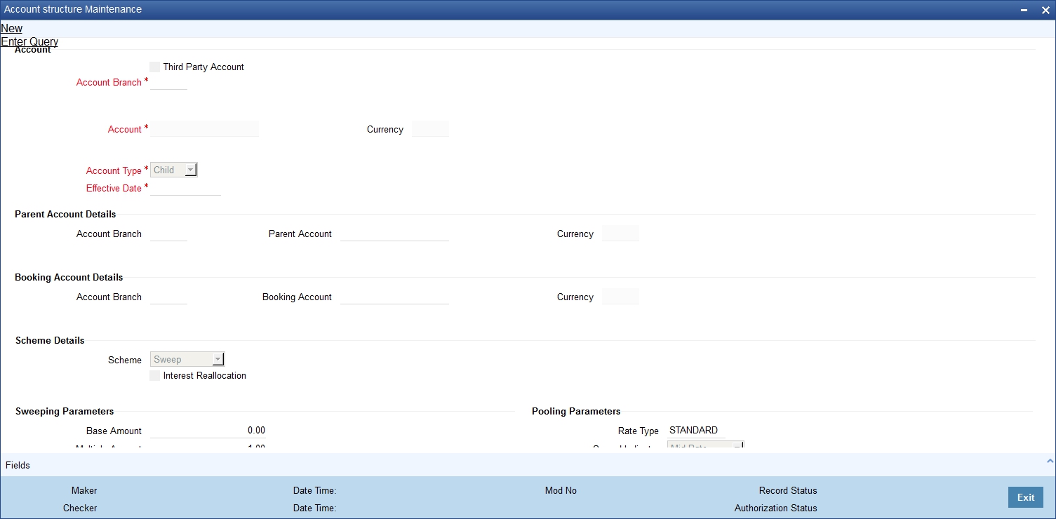

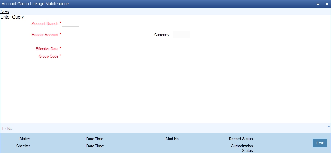

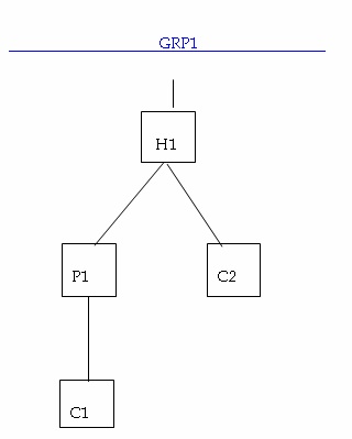

In Oracle FLEXCUBE, you can define a structure for the various accounts participating in the ILM process and set up a hierarchy for the accounts - establish the relationships or links among the accounts that are to be part of the Group.
You need to define the account structure and the hierarchy for ILM processing in the ‘Account Structure Maintenance’ screen. You can invoke the ‘Account Structure Maintenance’ screen by typing ‘ILDSWEEP’ in the field at the top right corner of the Application tool bar and clicking on the adjoining arrow button.
You can define the following parameters as part of maintaining the account structure for ILM processing:
Specify the following details.
Third Party Account
If the account that you have specified is a mirror account of an account held with another bank, you need to indicate it by selecting this option. If you select this option, the system will allow you to select the Technical CASA account that is linked as part of Third Party Accounts Maintenance.
Account
First, you need to specify the account (main or affiliate account) which has to be part of the account structure.
Account Type
You need to indicate whether the account that you have specified is a main account or secondary account. The account type defines the relationship between the accounts.
You will not be able to link the accounts at the same level in an account structure.
If you de-link a parent account from a structure or link it to another parent in the same structure, the associated child accounts linked to it will also follow the parent account.
Effective Date
You need to indicate the date from which the account structure is available in the system for ILM processing. However, if Intraday Sweep Batch is run for the branch for any group, you cannot change the structure on the same effective date.
Parent Account
This is applicable only if you are maintaining a child account. You need to indicate the parent account for the child here.
Note
You cannot link a child account to more than one parent account.
Booking Account
You need to indicate the account to which the interest amount is to be booked during interest reallocation (after interest is calculated).
Note
The booking account linked to the account should have the same currency as the account.
Scheme
Indicate the type of structure for which the link is being defined. The following types are possible:
Note
Interest Reallocation
Check this option to allow interest to be re-allocated to this account.
Sweep Type
This indicates the sweep type of the parent and child account. The sweep type can be either of the following:
Base Amount
The amount depends on the sweep type that you have selected.
Multiples Amount
This indicates the multiples amount in which the system performs sweeps.
Rate Type
This indicates the exchange rate type that would be used by the system to convert child account balances to the currency of the parent account. The system will not allow you to specify the rate type if you have specified the scheme as ‘Sweep’ as the system supports only single currency sweeps.
Spread Indicator
Specify which spread will be applicable - Mid or Buy/Sell. The system default value is ‘Mid’.
If you choose the ‘Buy/Sell’ option, the system applies the ‘Buy’ rate when debiting the customer account and the ‘Sell’ rate when crediting the customer account.

The following steps explain how to close an account in a given account structure. Let us assume that, in the structure shown below, we need to close account P2 and attach account C2 directly to H1.
The steps to be followed for the closure are:
After the structure change has been carried out, the new structure appears as shown below:
In the new structure (i.e. after the change), account C2 will have a new ‘System Account’ associated with it.

You can link the account structure to the group codes that you have maintained in the ’Account Group Linkage Maintenance’ screen. You can invoke the ‘Account Group Linkage Maintenance’ screen by typing ‘ILDGRPLN’ in the field at the top right corner of the Application tool bar and clicking on the adjoining arrow button.
In this screen, you need to specify the following:
Header Account
The system will display the parent accounts maintained as part of account structure maintenance. Select the account which you want to link to the group.
Effective Date
Indicate the date on which the structure under the group should come into effect.
Group Code
Indicate the group code to which you want to link the account structure.
For example, the following structure may be defined for a Group Code ‘GRP’
HACC (Header Account)
-- PACC1 (Child to HACC)
-- CACC1 (Child to PACC1)
-- PACC2 (Child to HACC)
-- CACC2 (Child to PACC2)
-- CACC3 (Child to PACC2)
In the above structure, PACC2 is the Child Account in the link HACC – PACC2 whereas Parent Account in PACC2 – CACC.

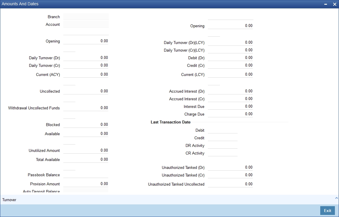

Click on ‘Amounts & Dates’ section in ‘Customer Account Maintenance’ screen to view the current days Sweep Eligible Balance which is available for Sweep Out/ Interest Calculation.
