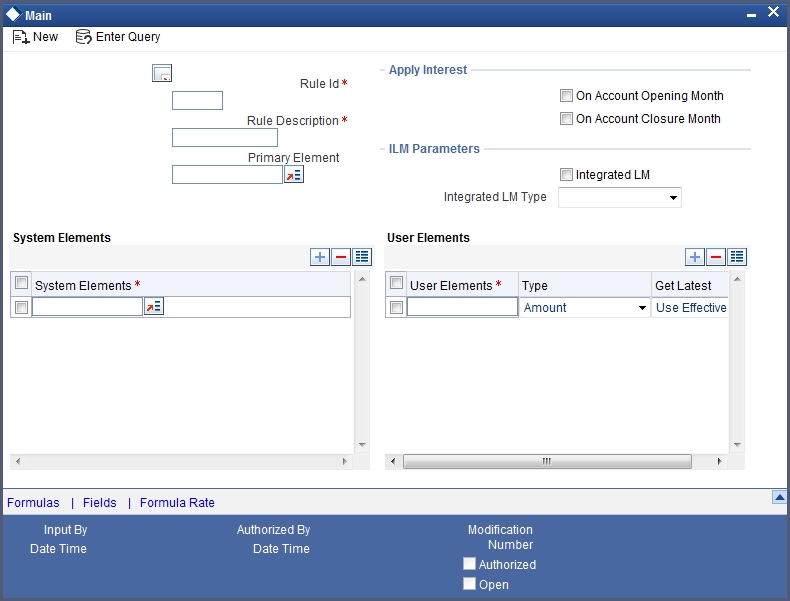

In addition to specifying how the SDEs and UDEs are connected through the formulae, you also define certain other attributes for a rule using the ‘Interest and Charges Rule Maintenance’ screen. You can invoke this screen by typing ‘ICDRLMNT’ in the field at the top right corner of the Application tool bar and clicking the adjoining arrow button.
For details about the screen, refer the chapter ‘Maintaining Interest Rules’ in the Interest and Charges User Manual.
You can maintain rules for the following:
Specify the following details:
On Account Opening Month
Check this box.
On Account Closure Month
Check this box.
SDE
Maintain the following SDEs:
UDE
Maintain the following UDEs:
Type
For each of the UDEs, select the option ‘Rate’ from the adjoining drop-down list.
Get Latest
For each of the UDEs, select the option ‘Use Effective’ from the adjoining drop-down list.

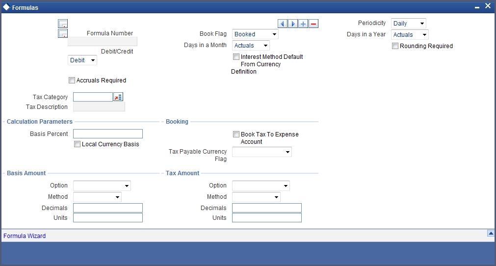

Click ‘Formulas’ button and invoke the ‘Formulas’ screen.
You need to maintain two booked and two tax formulae.
Book Flag
Select ‘Booked’ from the adjoining drop-down list.
Periodicity
Choose ‘Daily’ from the adjoining drop-down list.
Debit/Credit
Select ‘Debit’ from the adjoining drop-down list.
Days in a Month
Select ‘Actuals’ from the adjoining drop-down list.
Days in a Year
Select ‘365’ from the adjoining drop-down list.
Accrual Required
Check this box.
Rounding Required
Check this box.
Click ‘Formula Wizard’ button and invoke the ‘Formula Wizard’ screen.
Specify the following expressions:
Case |
Result |
ILVD_UTL_DR_BAL>0 |
( ILVD_ULT_DR_BAL * DR_RATE * DAYS )/36500 |

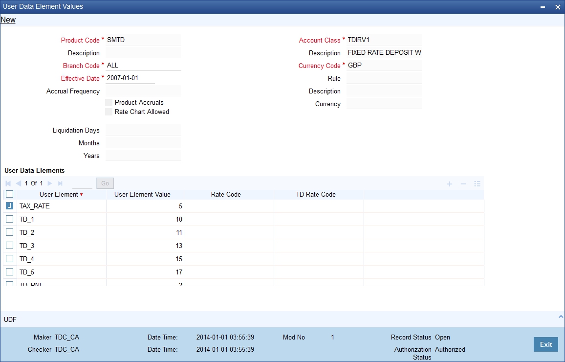

You can maintain UDE values for the rules using the ‘Interest & Charges User Data Element Maintenance’ screen. You can invoke the ‘Interest & Charges User Data Element Maintenance’ screen by typing ‘ICDUDVAL’ in the field at the top right corner of the Application tool bar and clicking the adjoining arrow button.
For details about the screen, refer the chapter ‘Giving UDE Values for Condition’ in the Interest and Charges User Manual.
In this screen, you need to maintain the following UDEs for the different IC products. Assume that you have maintained the following IC products:
You need to maintain values for the following UDEs under this product:

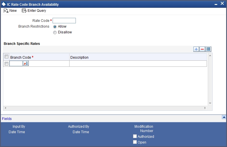

You can maintain rate codes for branches using the ‘‘Interest & Charges Branch Availability Maintenance’ screen. You can invoke this screen by typing ‘ICDRESTR’ in the field at the top right corner of the Application tool bar and clicking the adjoining arrow button.
You need to maintain the following rate codes for all branches of your bank:

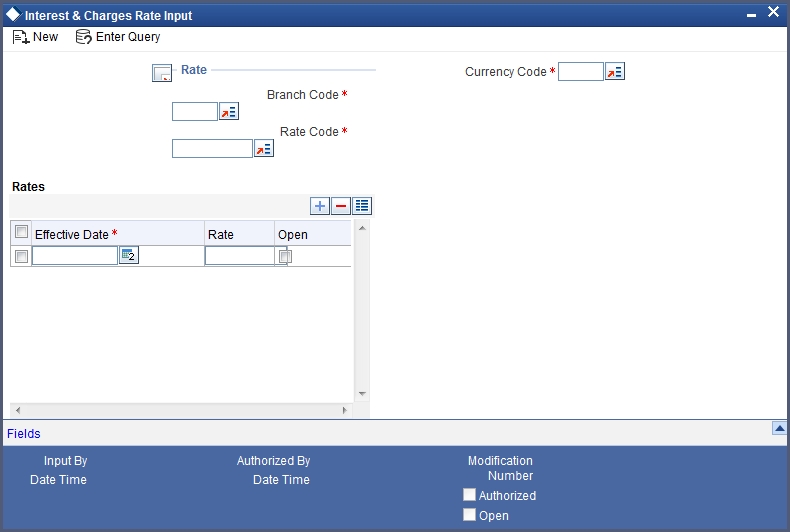

For the aforesaid rate codes, you need to maintain rates and effective dates in the ‘Interest and Charges Rate Input’ screen. You can invoke the ‘Interest and Charges Rate Input’ screen by typing ‘ICDRATES’ in the field at the top right corner of the Application tool bar and clicking the adjoining arrow button.
These rates are picked up by the TD module while processing interest applicable on a TD account.
Refer the chapter ‘Floating Rate Codes for IC Module’ for details about rate maintenance
