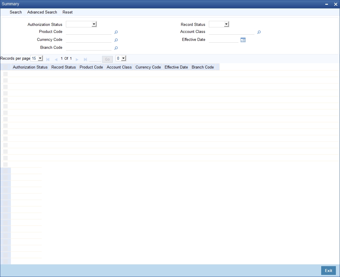

5.1.2 Printing UDE Values
You can print out UDE values. You can invoke the ‘Interest & Charges User Data Element Summary’ screen by typing ‘ICSUDVAL’ in the field at the top right corner of the Application tool bar and clicking the adjoining arrow button.
From the summary screen specify the necessary criteria and click ‘Search’ button to view the search results. Double-click to open a record for printing and then select ‘Print’ from the Actions menu in the Application tool bar or click print icon.
In the screen, which appears select a checkbox to have the corresponding field in the print out. Then click arrow seen alongside to view the screen.
Now, once more select ‘Print’ from the Actions menu in the Application tool bar or click print icon at the top left corner of this screen to print it out.

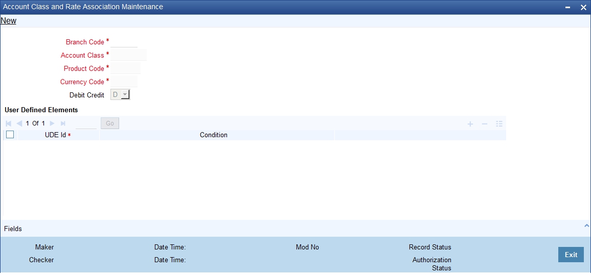

To recall, you associate an account class to a specific IC product through the ‘Interest & Charges – User Defined Element Values Maintenance’ screen. The rates applied are based on the IC rules maintained. Along with the different UDE rates defined in this screen, you also need to maintain whether a particular UDE applies for a credit interest rate or for a debit interest rate. Through this maintenance, the debit or credit rate for a particular account class and currency combination can be found.
It is through the ‘Account Class & Rate Association Maintenance’ screen that you maintain the above specifications. You can invoke the ‘Account Class & Rate Association Maintenance’ screen by typing ‘STDACRMT’ in the field at the top right corner of the Application tool bar and clicking the adjoining arrow button.
Here, you specify the following:
Branch Code
The code of the branch for which a UDE is maintained.
The branch code is displayed based on the Common Branch Restrictions for ICRATES for your branch. The branches that are allowed for your home branch are displayed in the option list for Branch Code. This occurs only if ‘ICRATES’ has been maintained as a Restriction Type in the ‘Common Branch Restrictions’ screen. Otherwise, all branch codes are displayed including the ‘ALL’ option.
If your home branch is HO, the ‘Branch Code’ option list displays ‘ALL’ in addition to the list of branches allowed for your home branch.
Account Class
The account class to which a UDE applies to. Only the following account class types are made available here:
For more information on account classes, you can refer to the section ‘Maintaining Account Classes’ in the chapter titled ‘Maintaining Mandatory Information’ in the Core Entities (CE) User Manual.
Product
The IC product name associated at the User defined Elements Maintenance for the chosen account class. For a given account class, only one IC product should be associated.
Currency Code
The currency for the chosen account class and IC product combination. The list of all currencies maintained through the ‘Currency Definition – Detailed’ screen is made available in the option list provided.
User Element Identification
The relevant UDE name for the chosen account class and IC product combination. The UDEs here are made available from the ‘Interest and Charges – User Defined Element Values Maintenance’ screen.
Debit Credit
The type of UDE. It could be either associated to a debit interest rate or a credit interest rate.

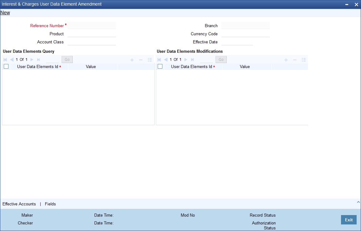

To recall, when you associate an interest product with an account class, you have to define the values for the user data elements (UDEs) identified for the product. The values specified for the UDEs would apply on all accounts that are part of the account class. However, your bank may want to change the UDE values for select accounts. Oracle FLEXCUBE allows you to change UDE values for specific accounts, based on specified criteria.
You can modify UDE values in the ‘User Defined Elements Values Maintenance’ Query screen. Invoke this screen from the Application Browser. You can invoke the ‘Interest & Charges User Data Element Amendment’ screen by typing ‘ICDUDEUL’ in the field at the top right corner of the Application tool bar and clicking the adjoining arrow button.
Reference Number
Reference number is auto generated by the system. First three characters are taken as current branch.
Branch
This indicates the branch code for maintaining Interest and Charges User Defined Element Values. It gets defaulted to the current branch.
The branch code is displayed based on the Common Branch Restrictions for ICRATES for your branch. The branches that are allowed for your home branch are displayed in the option list for Branch Code. This occurs only if ‘ICRATES’ has been maintained as a Restriction Type in the Common Branch Restrictions screen. If not, all Branch Codes are displayed including the ‘ALL’ option.
If your home branch is HO, then the Branch Code option list displays ‘ALL’ in addition to the list of branches allowed for your Home Branch.
If you try to maintain a UDE value for a specific branch, the system will check if the UDE value has been first maintained with Branch Code ‘ALL’. If it has not been maintained, an error message will be displayed forcing you to first maintain the UDE value for the Branch Code ‘ALL’.
The Rate Code option list will show all the rate codes maintained in the IC Rate Code Branch Availability screen. During UDE maintenance for a specific branch, if the Rate Code chosen is not available for the specific Branch, then a configurable override will be displayed.
In this screen, you can specify that the customer accounts:
should be queried and retrieved for the application of new values for calculating interest.
It is not necessary for you to indicate all the three conditions. For example, if want to change the interest calculation parameters only for accounts belonging to a particular account class, specify only the account class.
Note
At the time of selecting the account class and currency, the system will display only the account classes and currencies associated with the interest product (this is only if you have specified an interest product).
You also need to specify the date from which the new values have to become effective.
In the ‘Query’ section of the screen, click on option list in the ‘User Data Elements’ field. The user data elements associated with the interest product will be displayed. (If you have not specified an interest product, UDE’s associated with all the interest products will be displayed). Select the user data element whose value has to be changed and enter the value of the UDE that has to be changed.
In the ‘Modifications’ section of the screen, select the UDE again and specify the new value for the UDE.
To modify the interest calculation parameters, make the following entries:

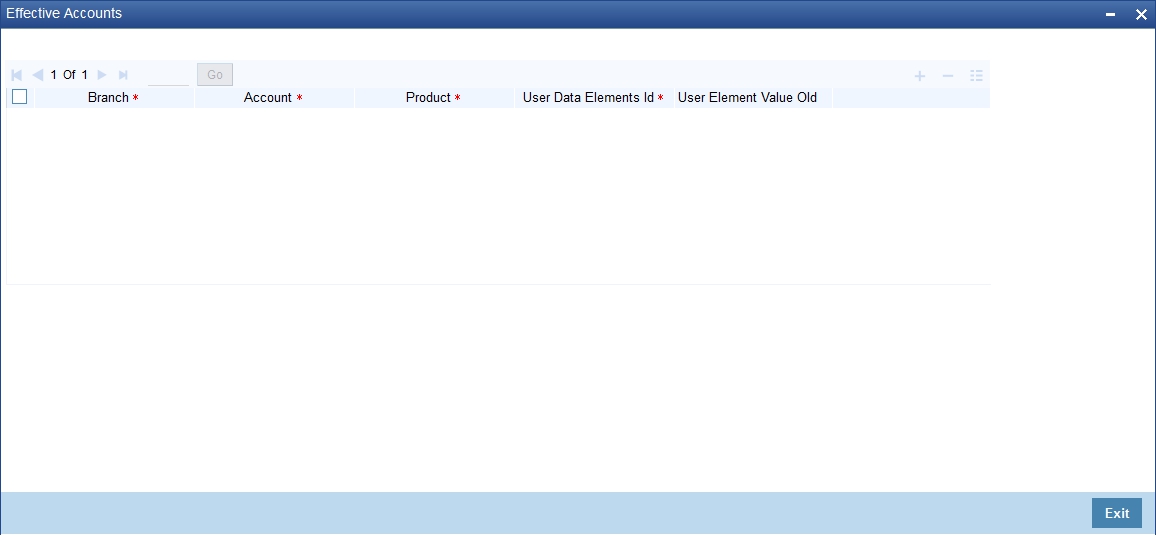

System will check all the customer accounts and displays the accounts that will be affected because of the change in the value of the interest calculation parameters. Click ‘Effected Accounts’ to view the accounts that have been affected.
The system will display a message if the new value of the interest calculation parameters has not affected any accounts.
